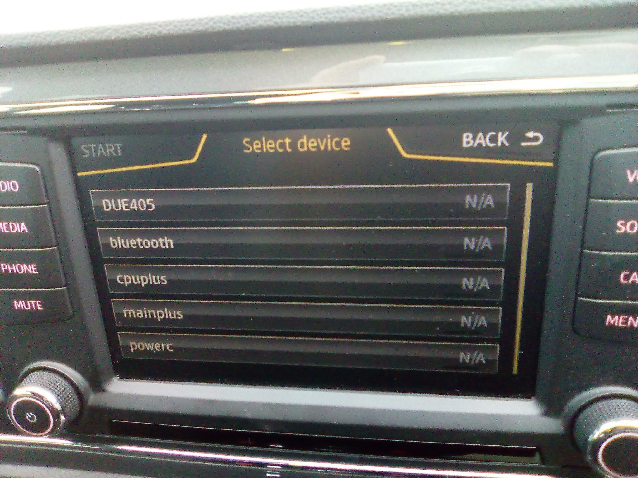

I have successfully installed the firmware update.
Now trying to install the patch, when the car scans the SD card I get the screen below.
All the components are marked N/A and the start button is greyed out, so I can't press it.
Any ideas?

May as well just buy a better unit with two slots.
There is no sd card patch for technisat single slot.
I have done this one time in the SWDL Mode also Manual forced Install and IT was working
Or modifd SWDL with ToolBox, i Dont know it any more
But i think it was Always an Error in the Log.
And how does he install the toolbox on a single slot unit ? only emmc or usb2hsd method is the option. Both a pain in the backside.
