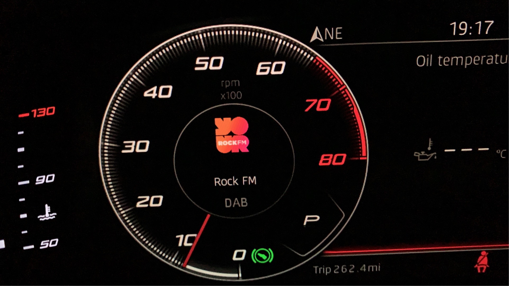

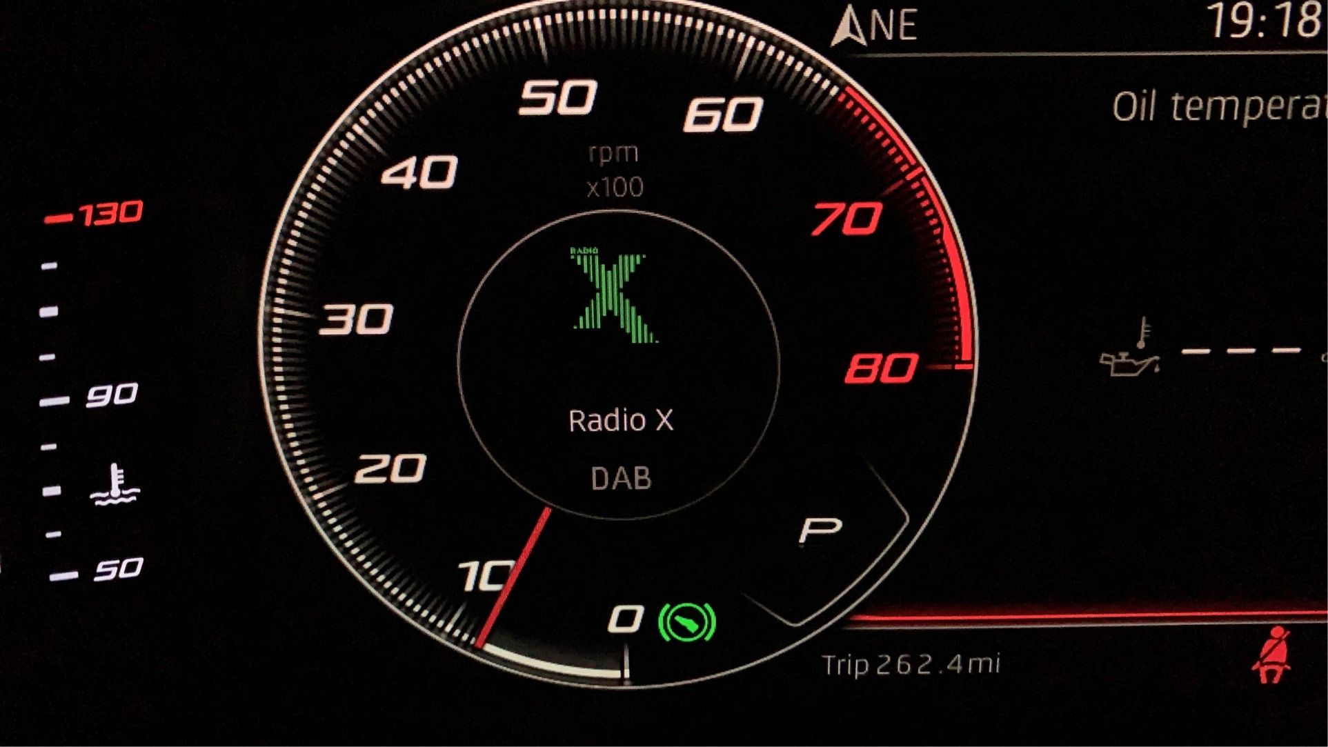

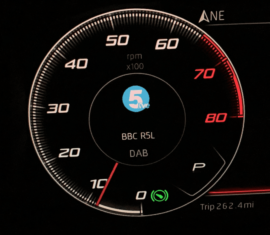

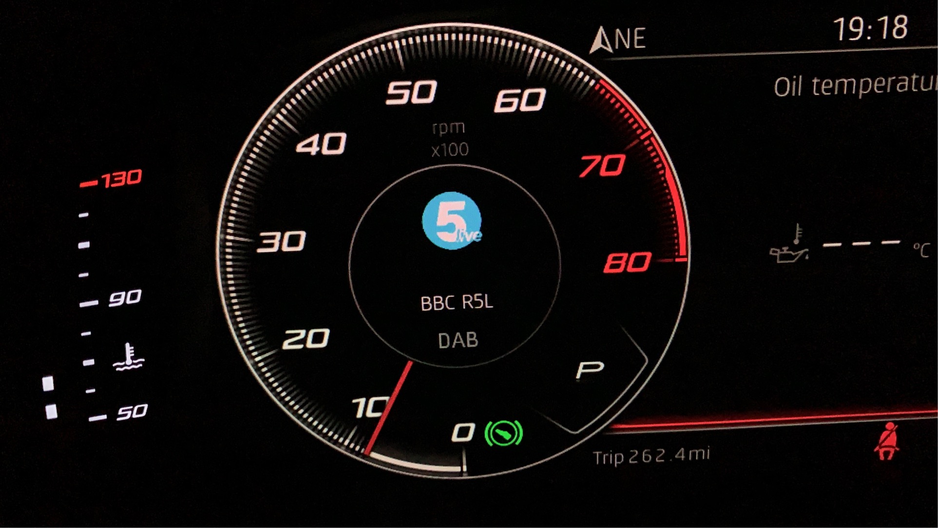

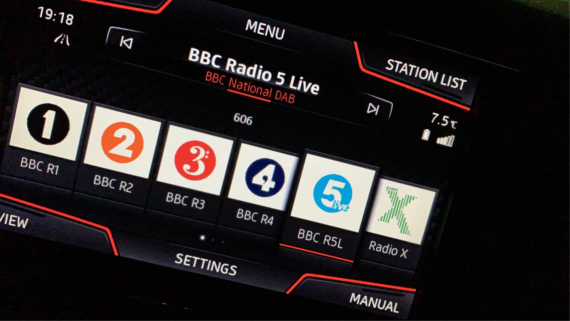

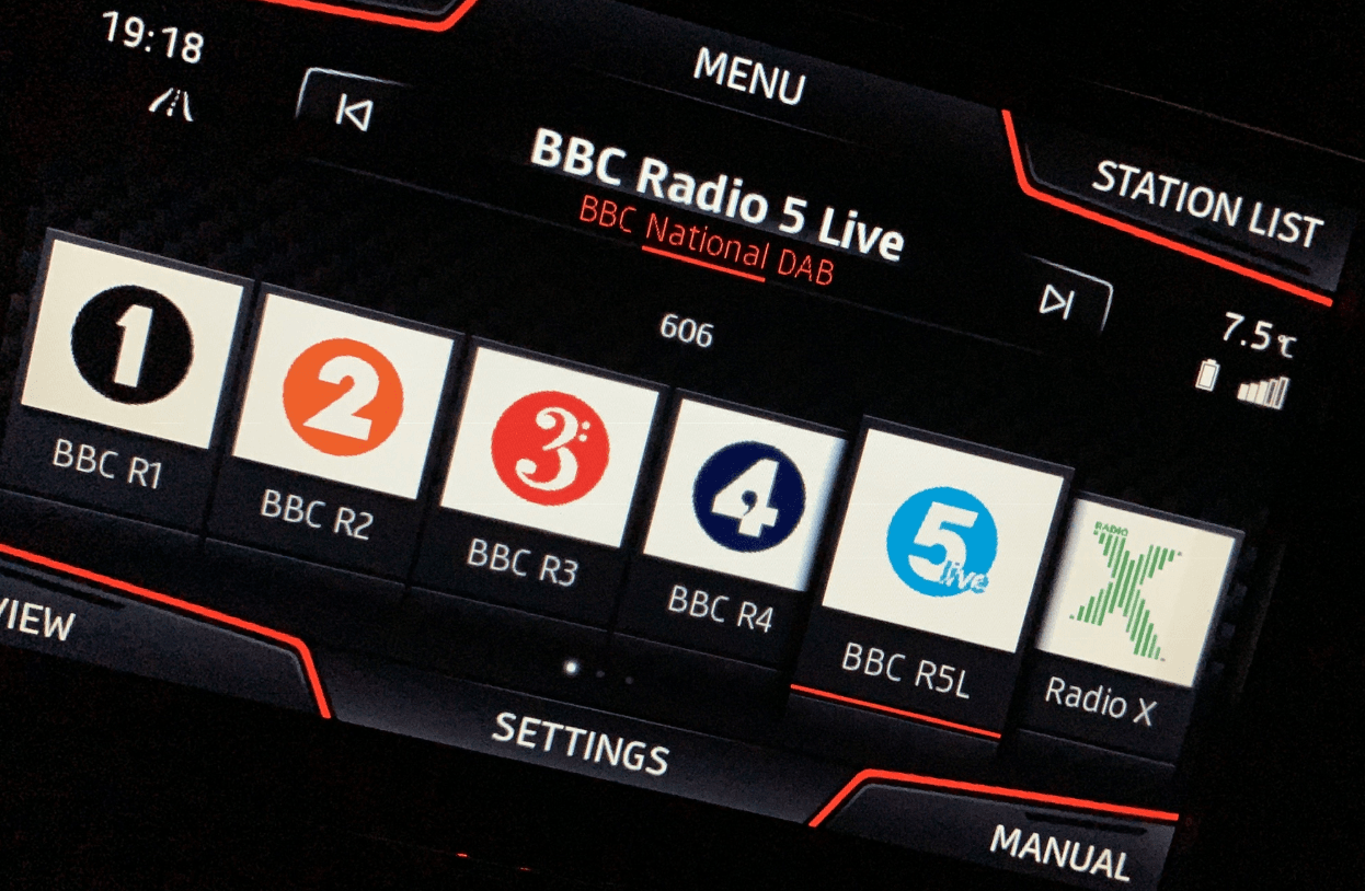

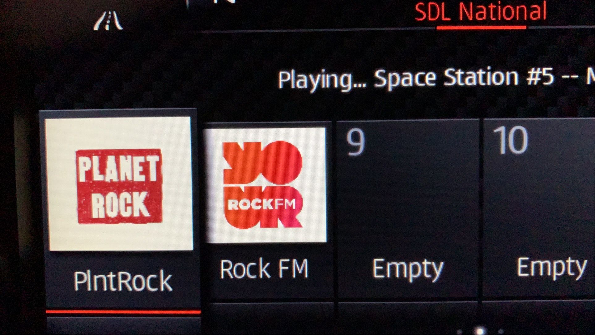

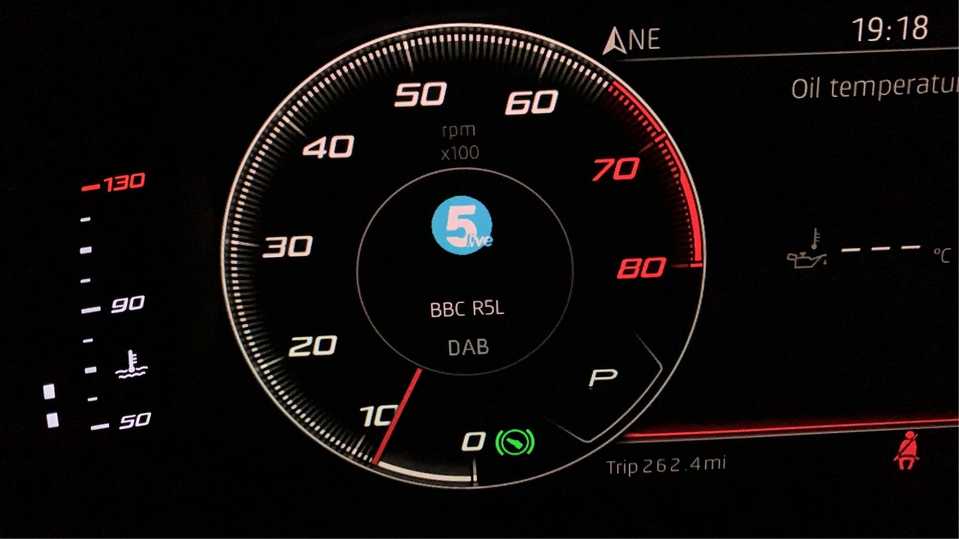

This is a link to the ones I created. I did a lot of different sizes to try and avoid any border at all, but sadly it didn't work so I gave up. Then when I got the Carbon Edition with the VC, I realised it was far better to make transparent ones, so they look their best on the VC, and just put up with the white background on the 8" screen...
Sadly I can't remember which size looked the best, so zipped them all.
Examples of the ones on my car...
Main screen:
Virtual Cockpit:
