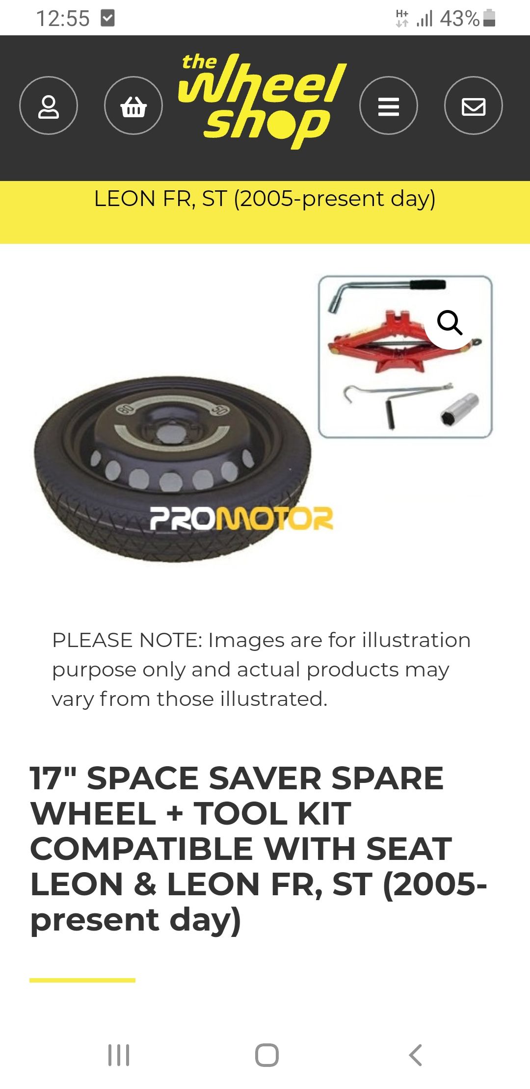

Hello,
I have bought a space saver wheel and tool kit for my leon fr 2017. I already has a kit retained which has a pump and a few other things I assume come standard with the car.
With the space saver kit and wheel I can't seem to figure out how to retain the wheel with the kit provided. Firstly I don't have a retaining bolt but they're easy to get hold of. Can't find no videos on YouTube or anything threads on here.
Has anyone got any ideas at all?
Any threads that I haven't found?
Thank you

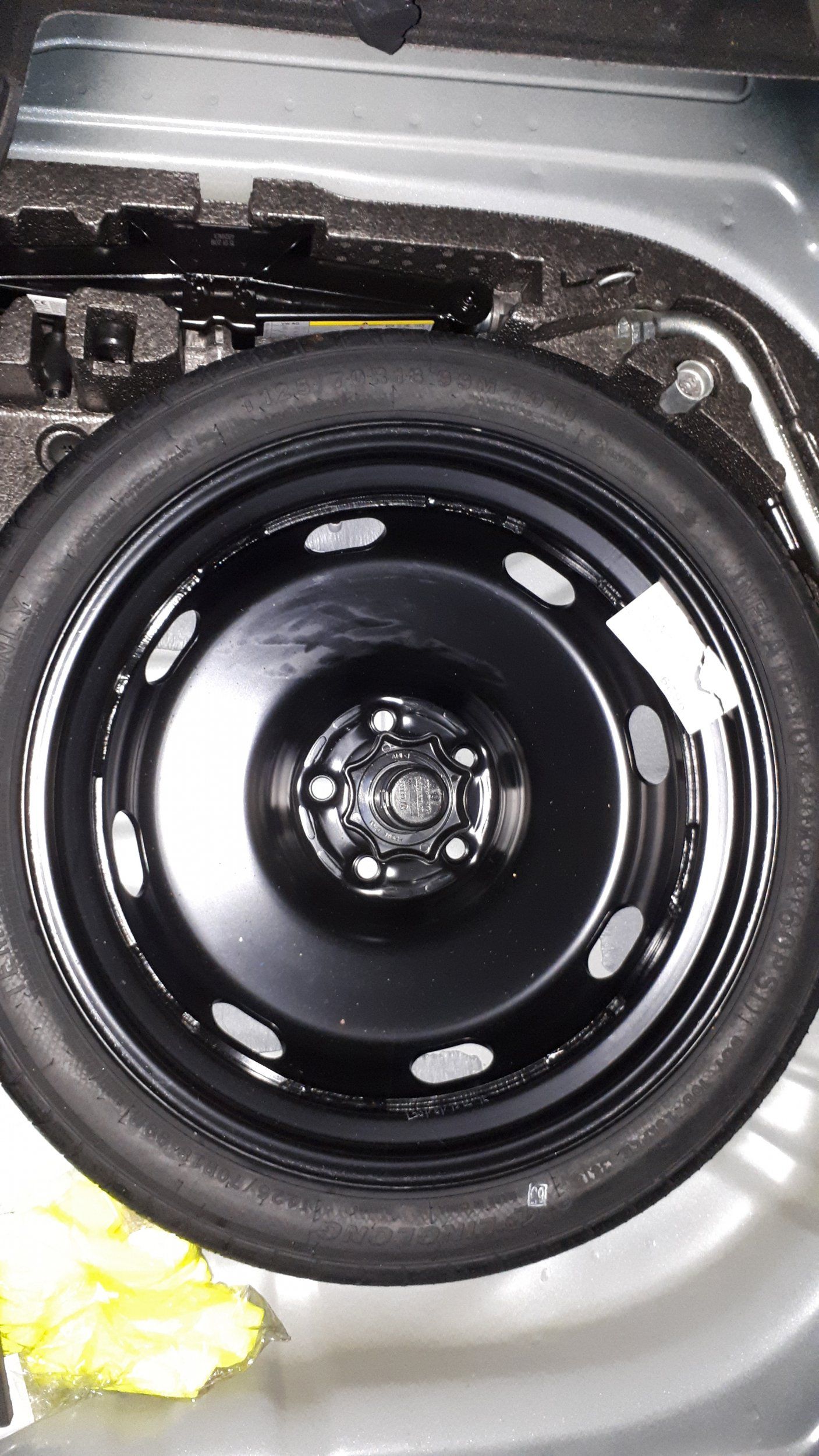

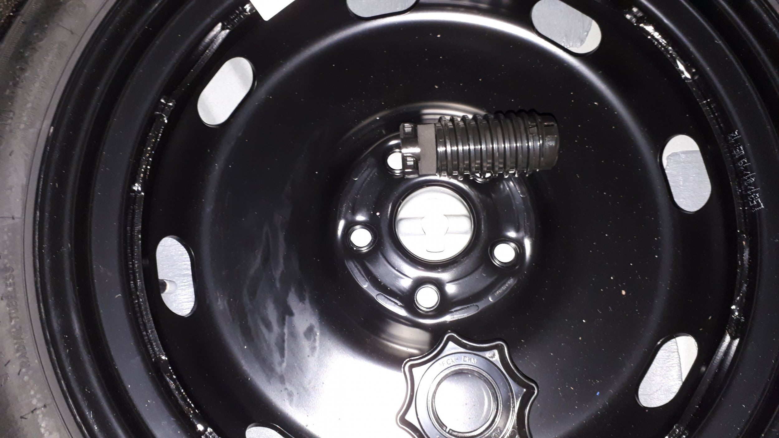

Here are pics of my spare wheel kit. The spare is retained by the large screw and nut. The screw pushes in the floor and twists 90 degrees to retain it then
screw the large nut down to retain the spare

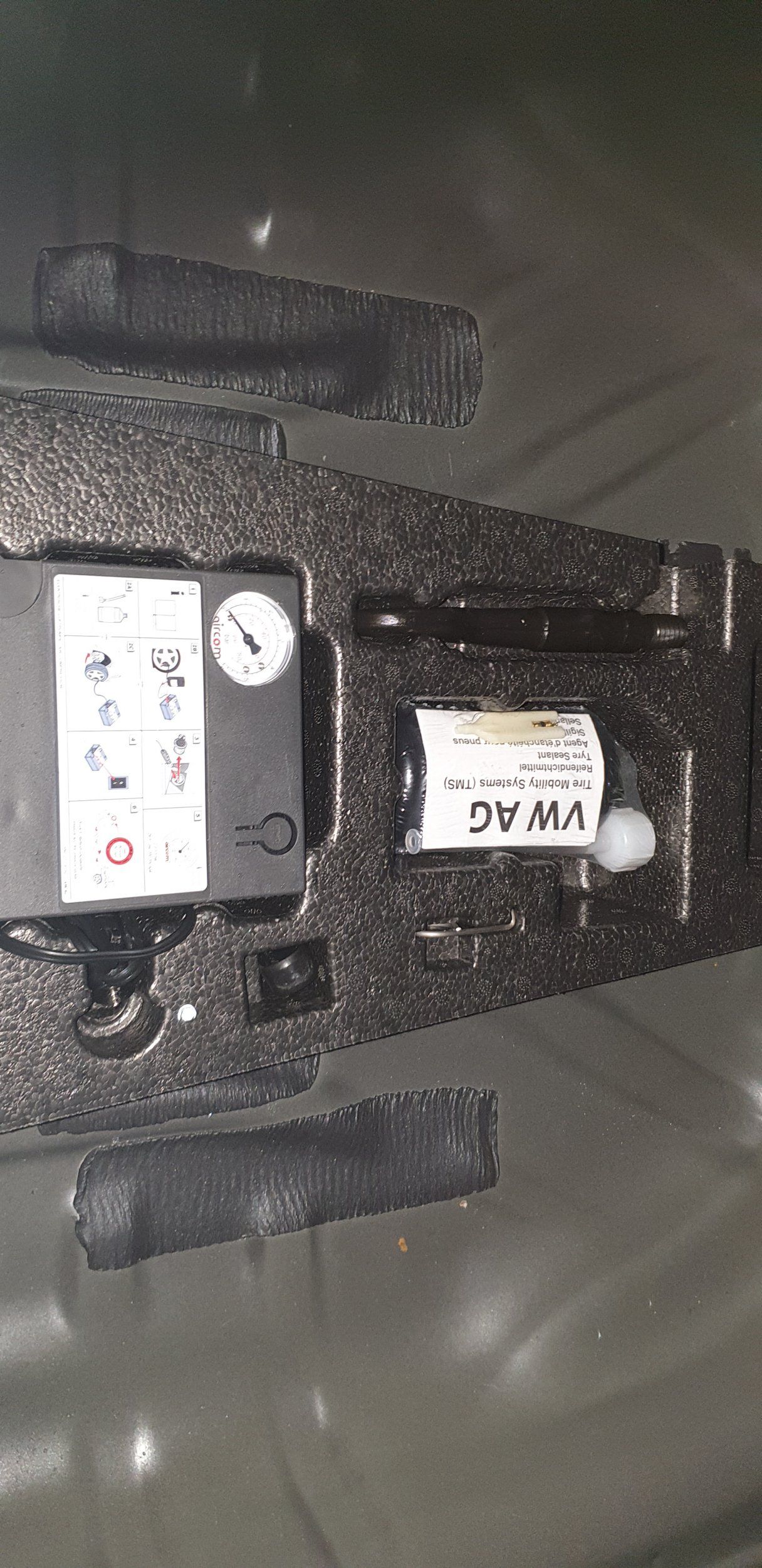

Hello,
Yes I will attach a picture of the kit I bought. I have the same mount as in the other reply I received. I've ordered a holding bolt off ebay. I have the housing that includes the puncture repair kit but I was hoping to get some foam housing to go around the spare tyre

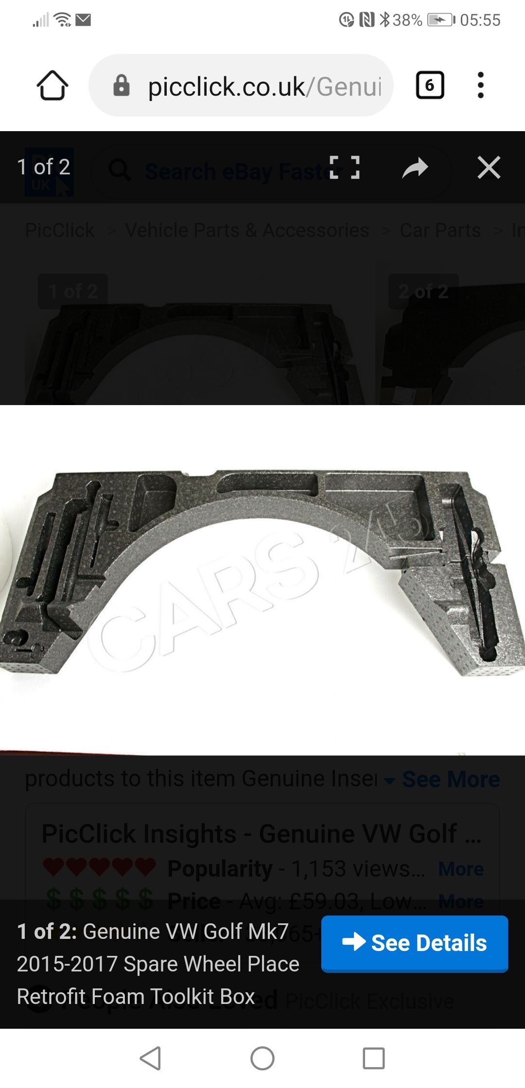

Just found a similar item but it's for a Mk7 golf

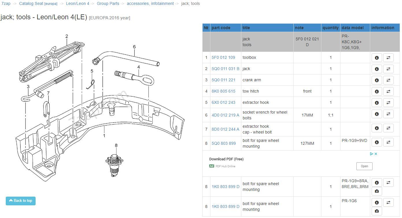

@Wilto I have replied to message. I haven't checked number yet...its a bit dark but found this...5F0012109 on the web.
