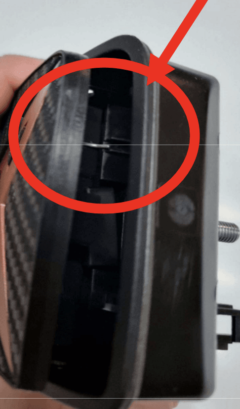

Found this in a search, my MK3 Cupra boot latch was sticking so gave this a try the weekend. Pretty much the exact same process except no screws in the boot trim - it all just pulls off.
I did get stuck reassembling the badge, it was just loose and floppy. Just me having a moment, but for future reference, this picture really helped positioning the spring when I put it back together:
