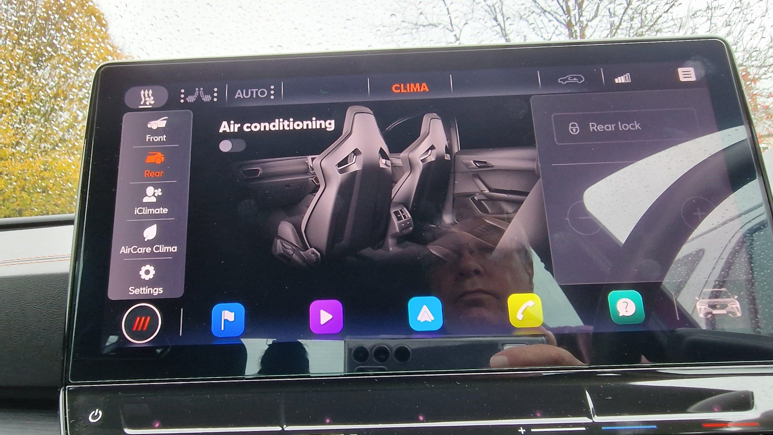

Hi, If you go into the Air Conditioning you should see the screenshot below. Select 'Rear' down the lefthand side and you can switch it on or off there. If there's just you in the car it should only be supplying the drivers side automatically and show 'Eco' on the screen fir the passenger side. There will still be a small amount of flow on the passenger side and the rear though.

The short answer is yes.
This is with the system set to 'Auto' as shown in my screenshot above:
If there is just the driver in the car the passenger side a/c is off (Eco) and the rear will be off. The drivers side will be at whatever temperature you set.
If you add a passenger to the front the passenger side a/c will become active and the temperature can be set independently of the drivers side or it can be synced to the drivers side. The rear will be off.
If you add a rear passenger the rear a/c will turn on and the rear passenger can set the rear temperature independently using the touch buttons.
You can override all the above and adjust the temperature and flow direction, or indeed switch the rear a/c off using the Air Conditioning screen. I always leave mine in Auto.
