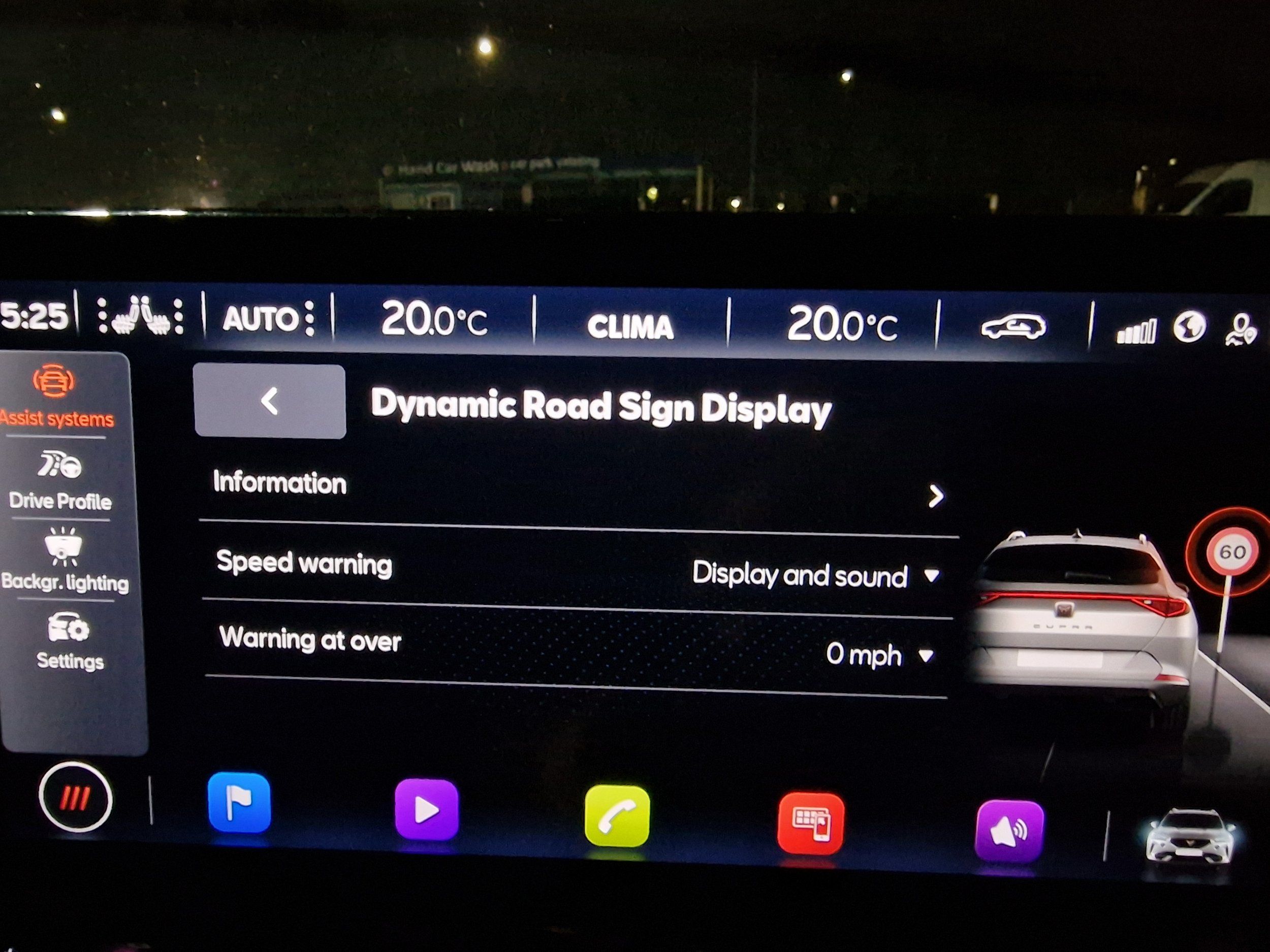

Vehicle > assist systems > driver alerts > dynamic road sign display
This is for older formentor.

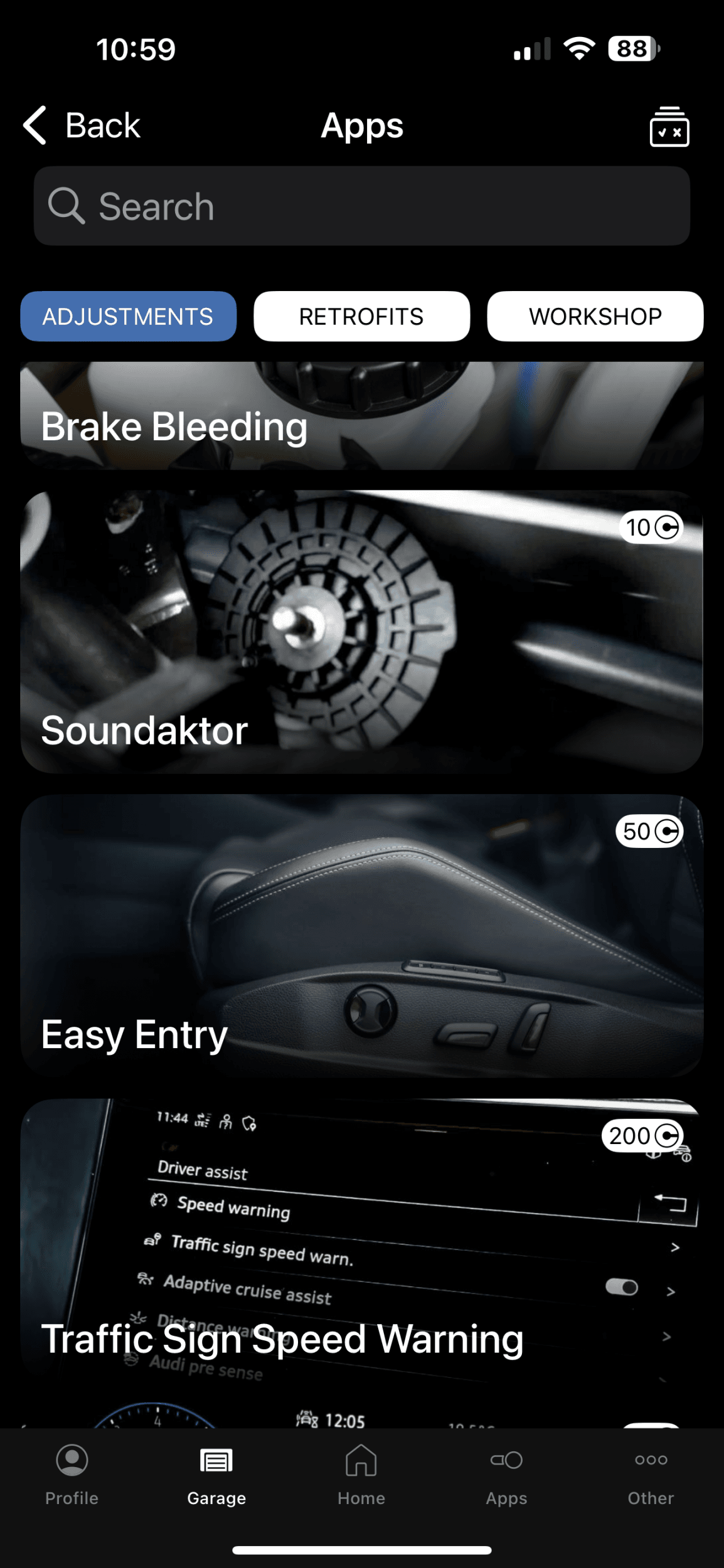

press connect as normal and go to apps you will find the app at the bottom please look at photo below.
it 200 credits and you will need to turn off the ignition and then turn it back on and then open the bonnet.
the app first time said not supported if this happens try turning off the ingnition and opening the bonnet again
this worked for me.
there will be a warning that the SOS will not work this is normal.
I have try it and it does work and even better in my plug in the annoying brake system, for example when you go from a 40 to 30 the car if you are costing will slow it self down this has now gone and is back as normal car.
