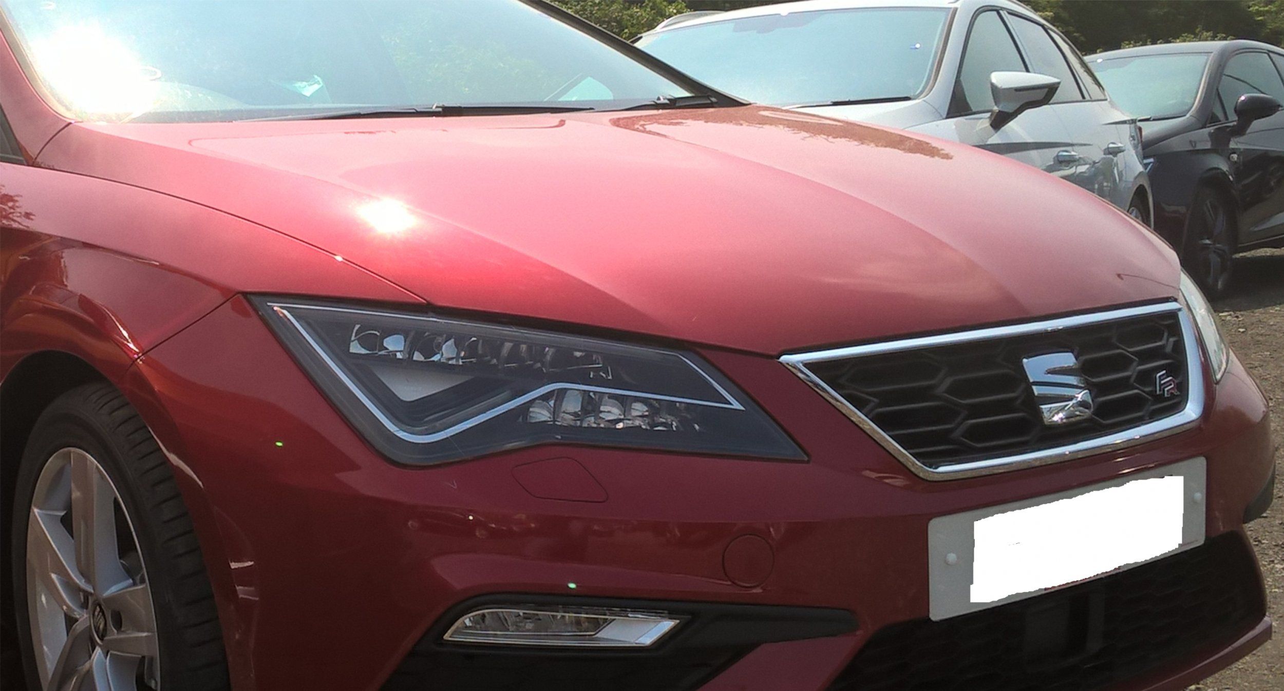

OP, If it helps, this is how it should look. Here's ours shortly after being delivered to the dealership. Your's clearly is not right, nor acceptably within tolerance

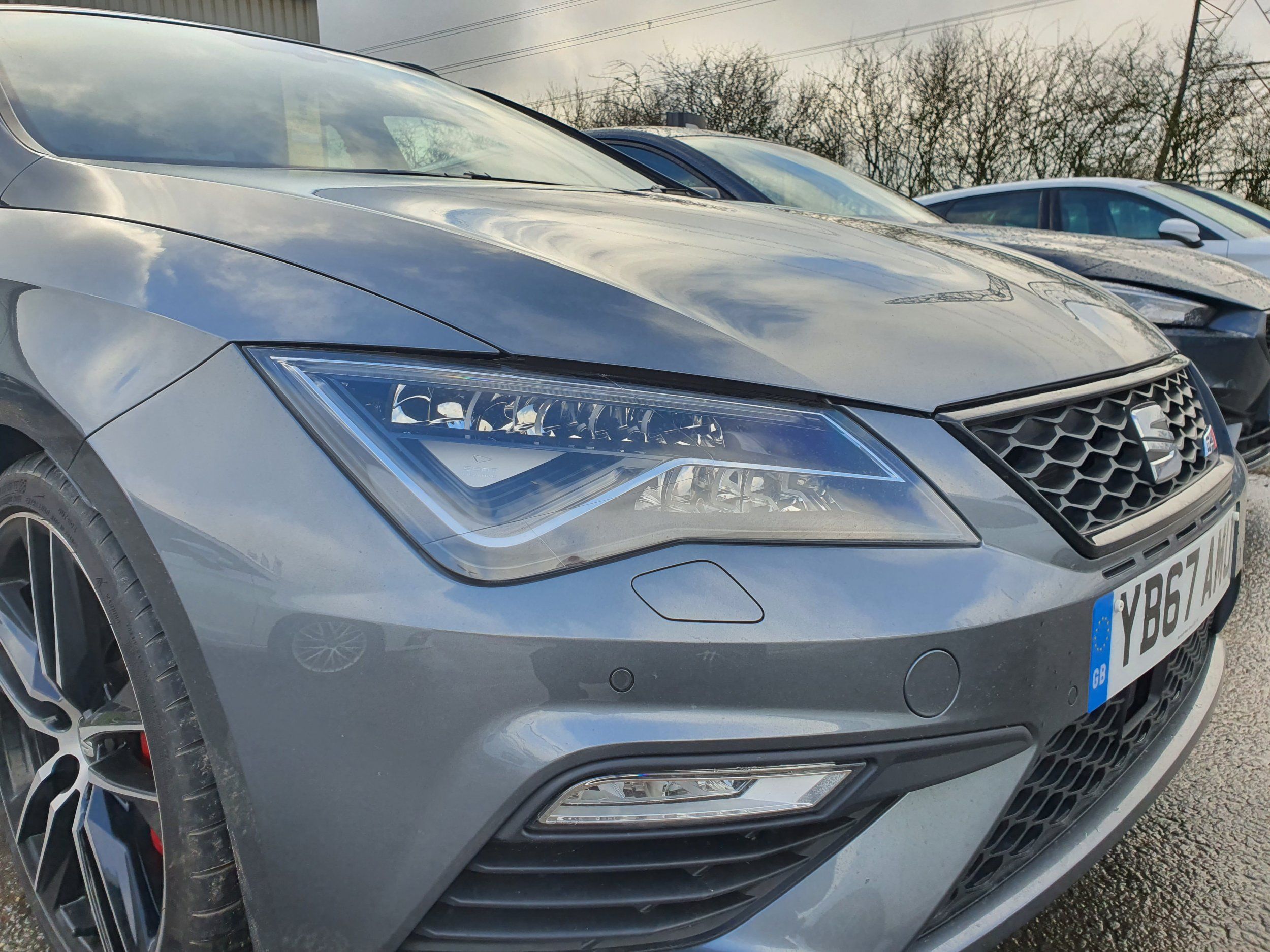

I dropped it off this morning so they could look at adjusting the bonnet, I told them it still wasn't good enough when they said it was sorted! It's going back next Friday but I stopped at the Cupra dealer on the way home and took a few pics so I could show the body shop next week.

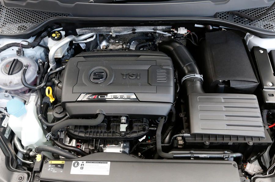

Unlucky for them I'm finding more and more alignment issues now. I've also just popped the hood and there's something missing, I know nothing about engines but I'm guessing plenty of you guys do.
Seriously?
Apr 20, 2018
1,477
1,071
The intake shroud is missing, as is the battery cover maybe (although I think not all cars have the piece that covers the top of the battery)
Is it my eyes or is the coolant on the minimum also?
Reactions: beasty54
beasty54
Jul 23, 2020
45
27
I don't think there was ever a cover on that battery so I'm not concerned about that. You're right about the coolant though, it is on minimum and I'm wondering if it was leaking at some point since they had to replace the radiator.
Seriously?
Apr 20, 2018
1,477
1,071
OK, if the rad was changed it could just be that it needs topped up now the everything has settled. But I'd deffo be keeping a careful eye on it just in case that's another job they bodged.?
