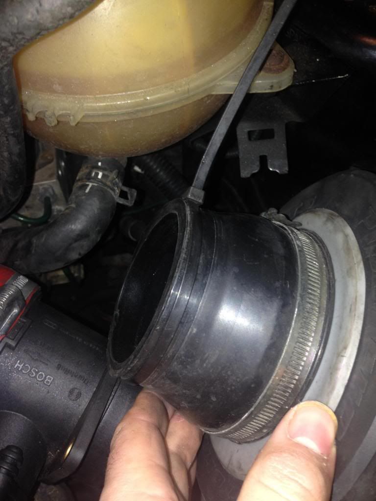

Over tightened clip on air filter and split the reducer hose..

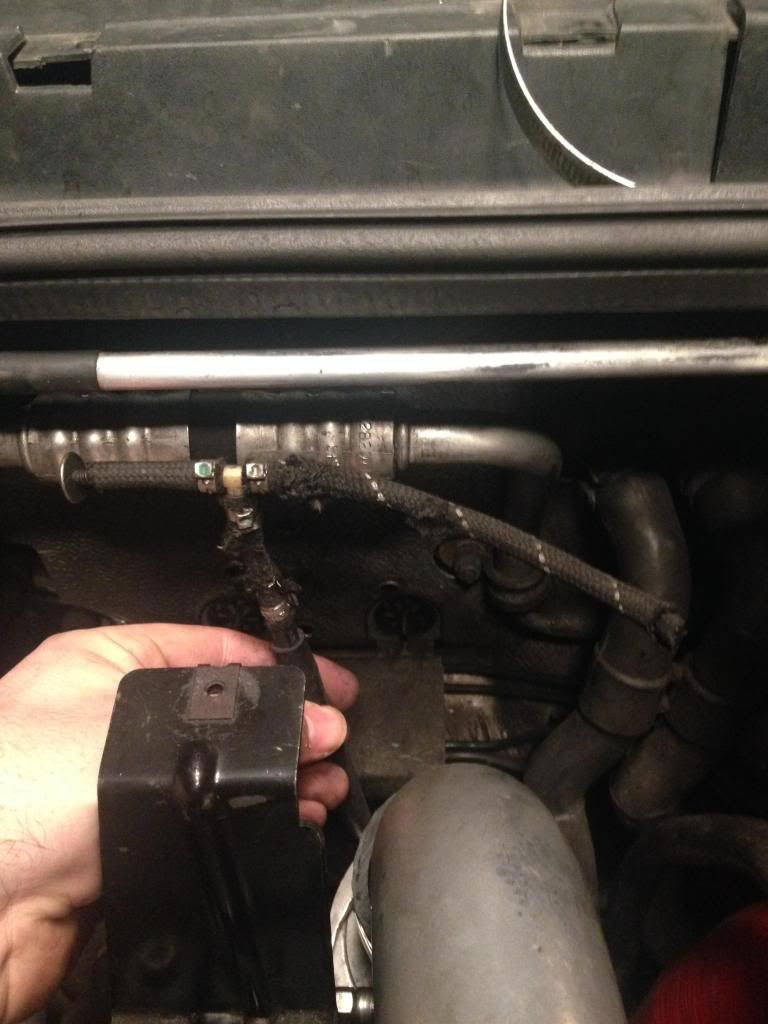

Hhmmmm.. I don't know where this pipe goes, so I'll just put it on the AC hard pipe VAC point.... :whistle:

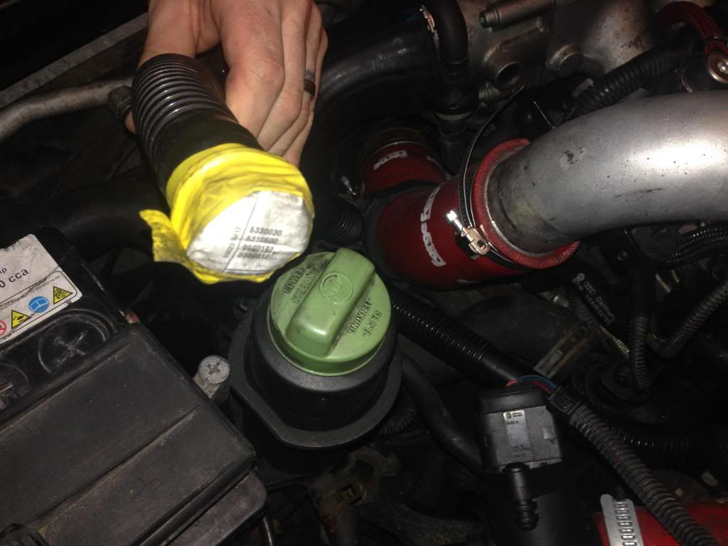

Can anyone tell me what this is?? My thoughts are it goes to the original air box?

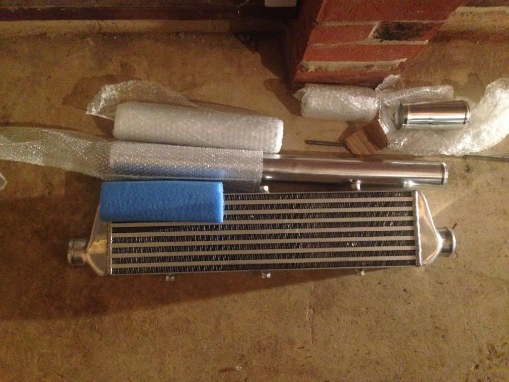

FMIC ..

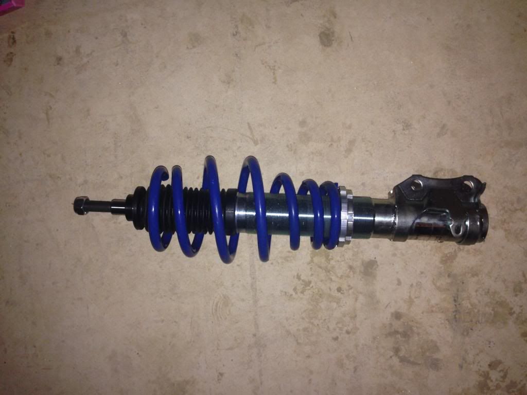

Coil Overs

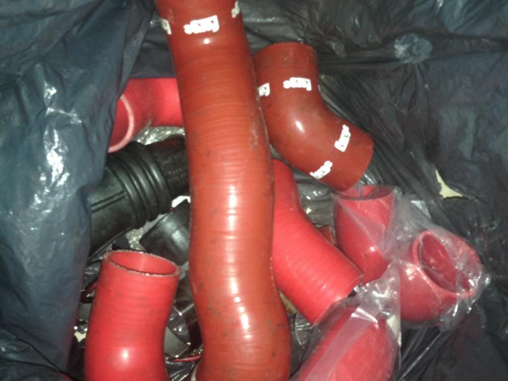

Forge Hoses..

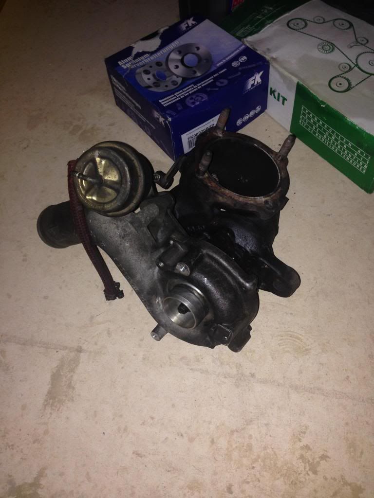

K03 Turbo

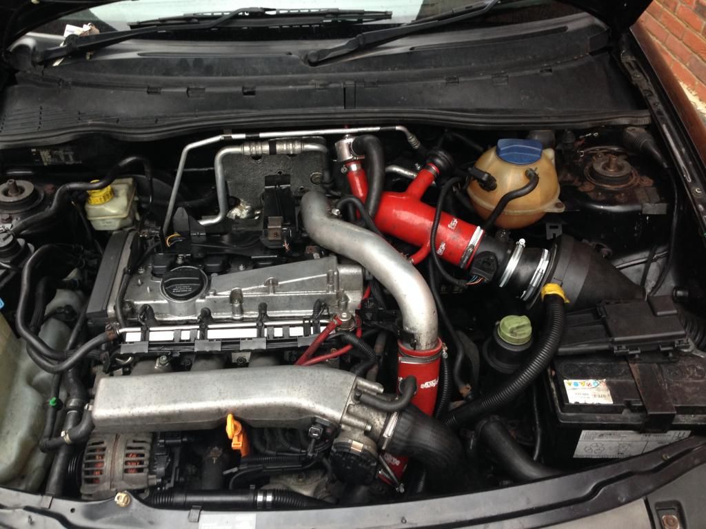

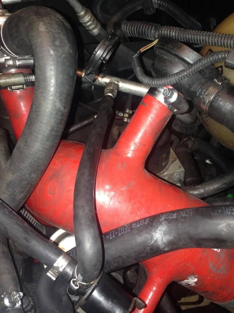

Yesterday I decided to sort out all the VAC pipe work & locate all boost leaks...
Got everything connected up, cleared all fault codes.. Nothing returned so looked good. Took a drive down the road expecting to have full boost again.. Nope. Still a huge leak
Returned home & set about investigating what was wrong.. Found the TIP had no jubilee clip on & was half off the compressor wheel.
Pulled it off as it didn't want to go back on properly and found it looking like this..
Looks to be trimmed too close to the bend & not cut straight.. Every time I tried to tighten the clip it just pulled itself off the turbo as the TIP wouldn't sit at the right angle..
Ended up making a little sleeve up from some left over pipe from another build I've done..
Doesn't look too pretty but has done the job.. Back to full boost, although still doesn't feel quite right.
Anyone with a K03s tell me if it doesn't feel quite right until mapped?

Is it not mapped at all? It should be 'ok' without a specific map (or stage 2)
Looks like a proper homebrew **** up when you picked it up!
Just get miles of new vac hose, and set about replacing

Nope not mapped at all.. It feels 'ok' but just seems to lack something... It was a mess when I picked it up.
The 3 way valve next to the TIP has the top long pipe blanked off.. Is that right?

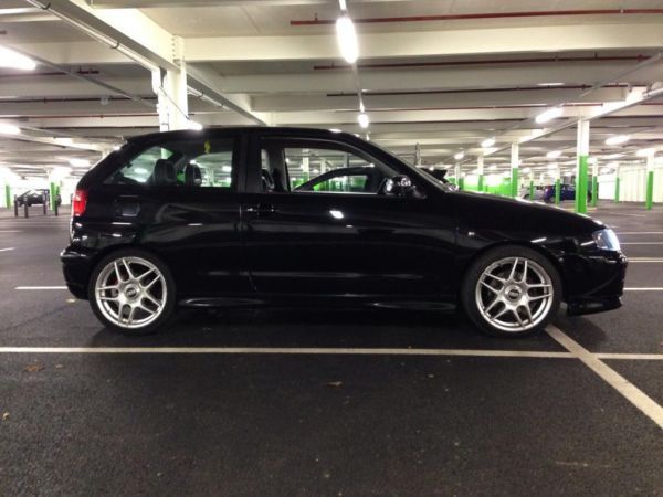

Had an hour or so free today so fixed the rest of the boost leaks sorted the ride height & fitted rear spacers...
Much better :)

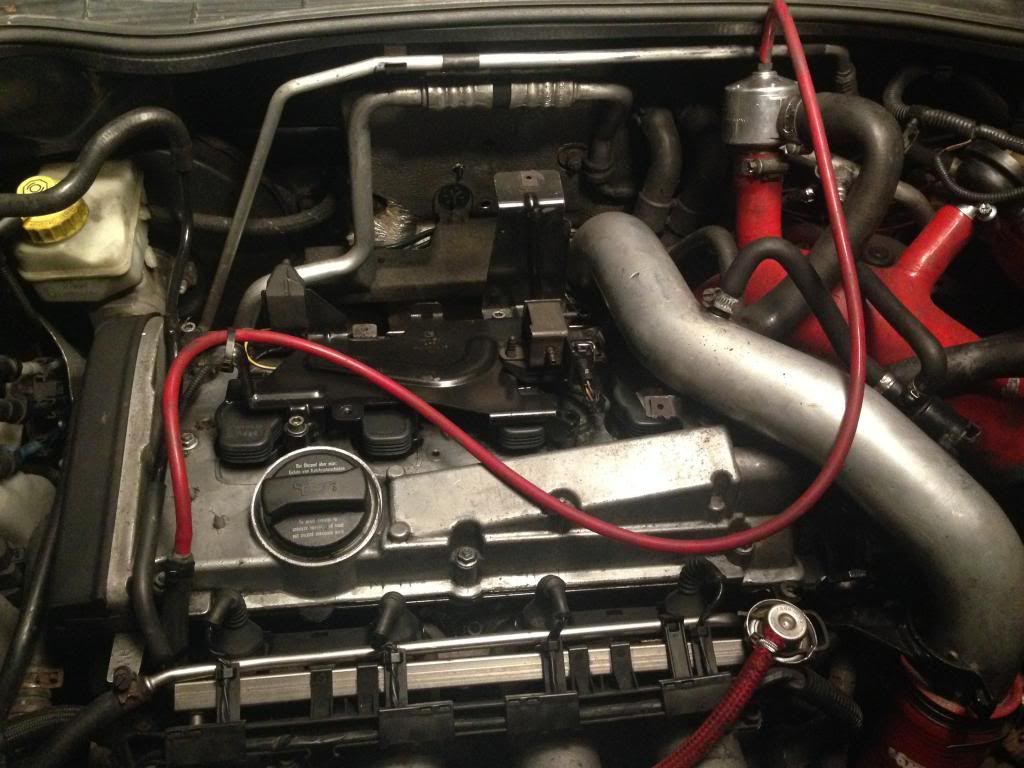

Had 20 mins to fill so tided up the engine bay pipe work a little -

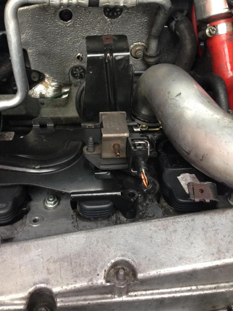

Also, can anyone tell me what this valve is & what it does please?? Also knowing what pipes should be going to/from it would be helpful! -
