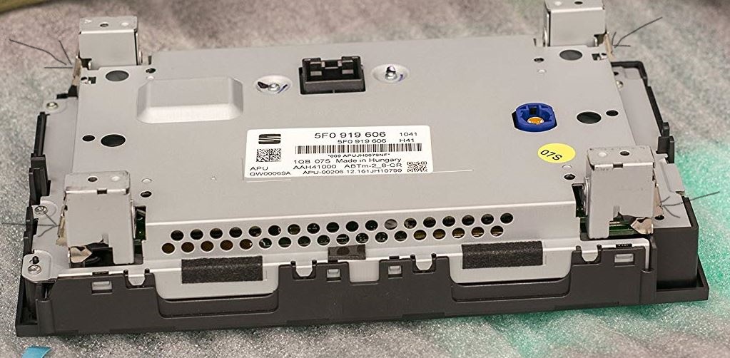

Now I don’t like going aftermarket etc so bought a genuine Seat stereo Unit that has the 8 inch screen - part number: 5F0 919 606
This is from a 2018 Seat Leon MK3.5
I also got the SEAT EASYCONNECT MMI in the glove box to go with the screen - MIB2 as far as I understand.

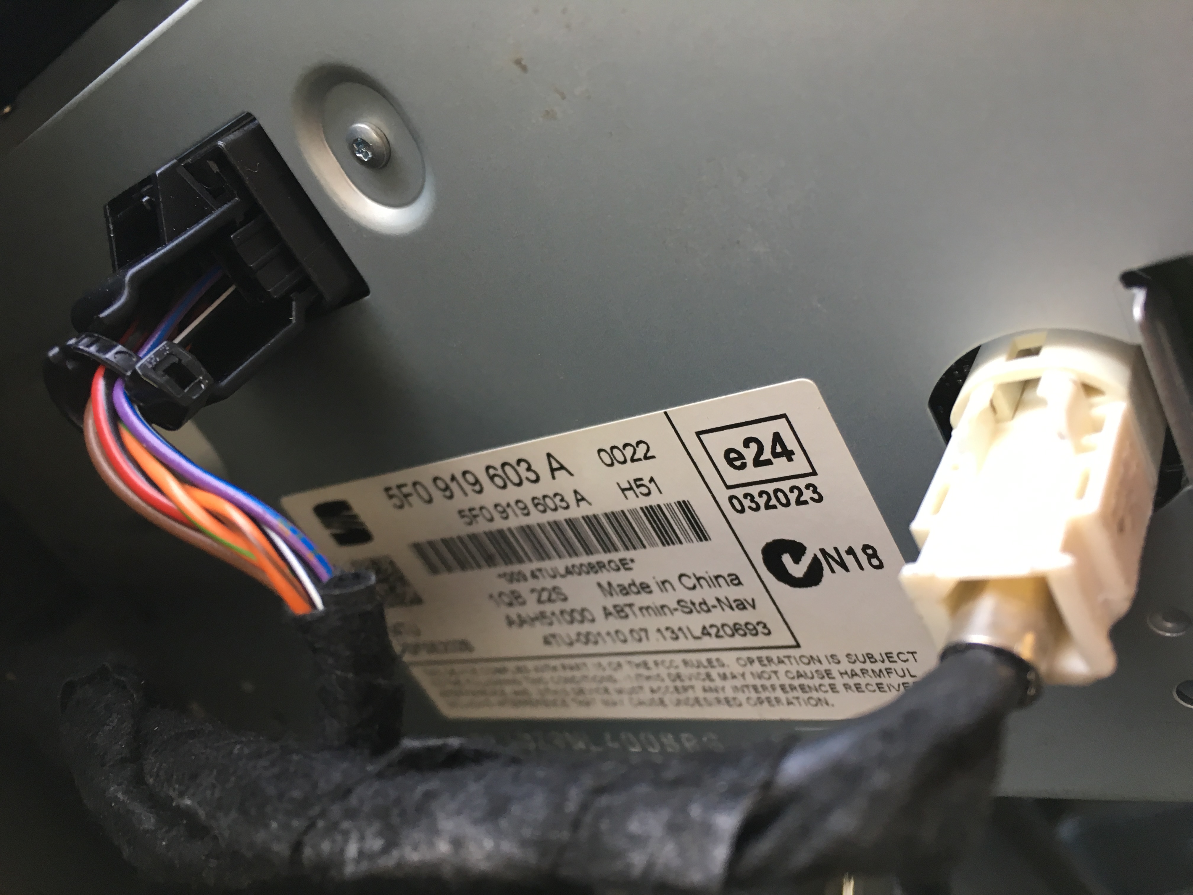

The fitting was pretty straight forward - took the old bits out, and everything was plug and play - except one of the wires that connect to the rear of the screen. I had to modify the connector slightly - very easy - and it was all up and running. CP WAS REMOVED BY THE SELLER. Happy days!

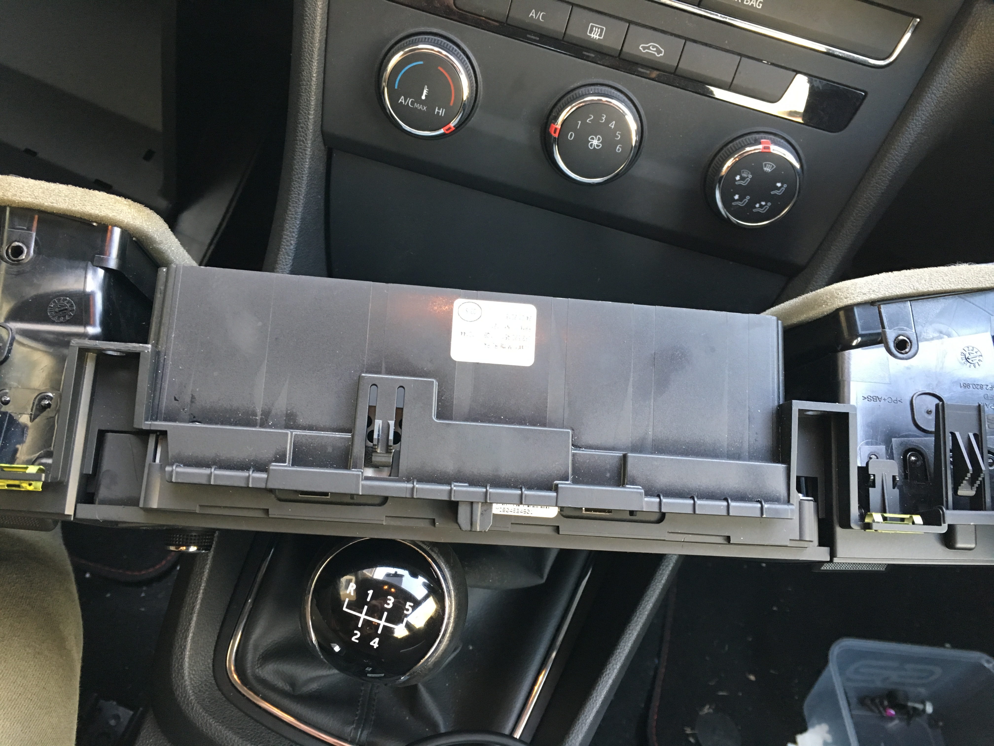

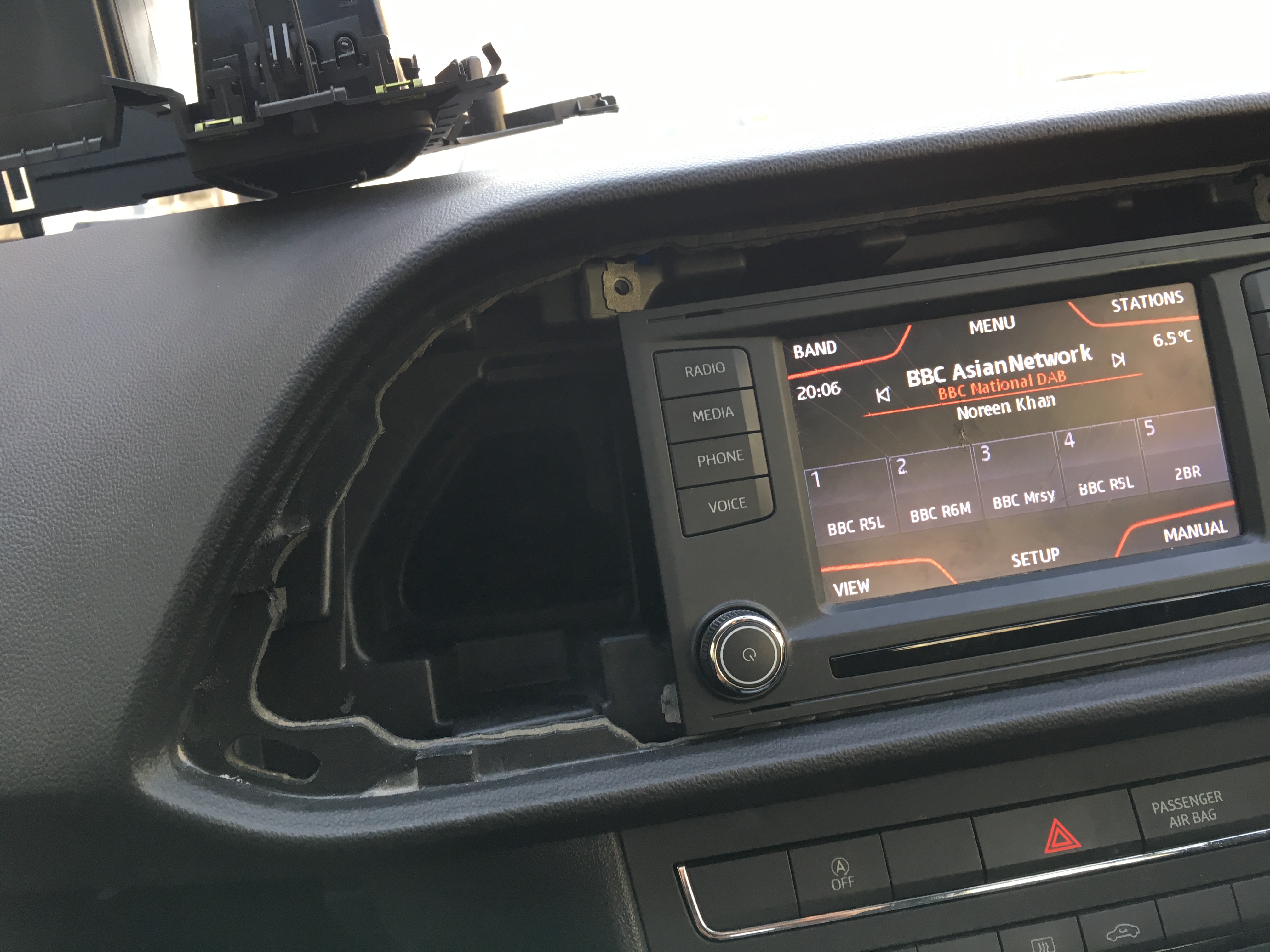

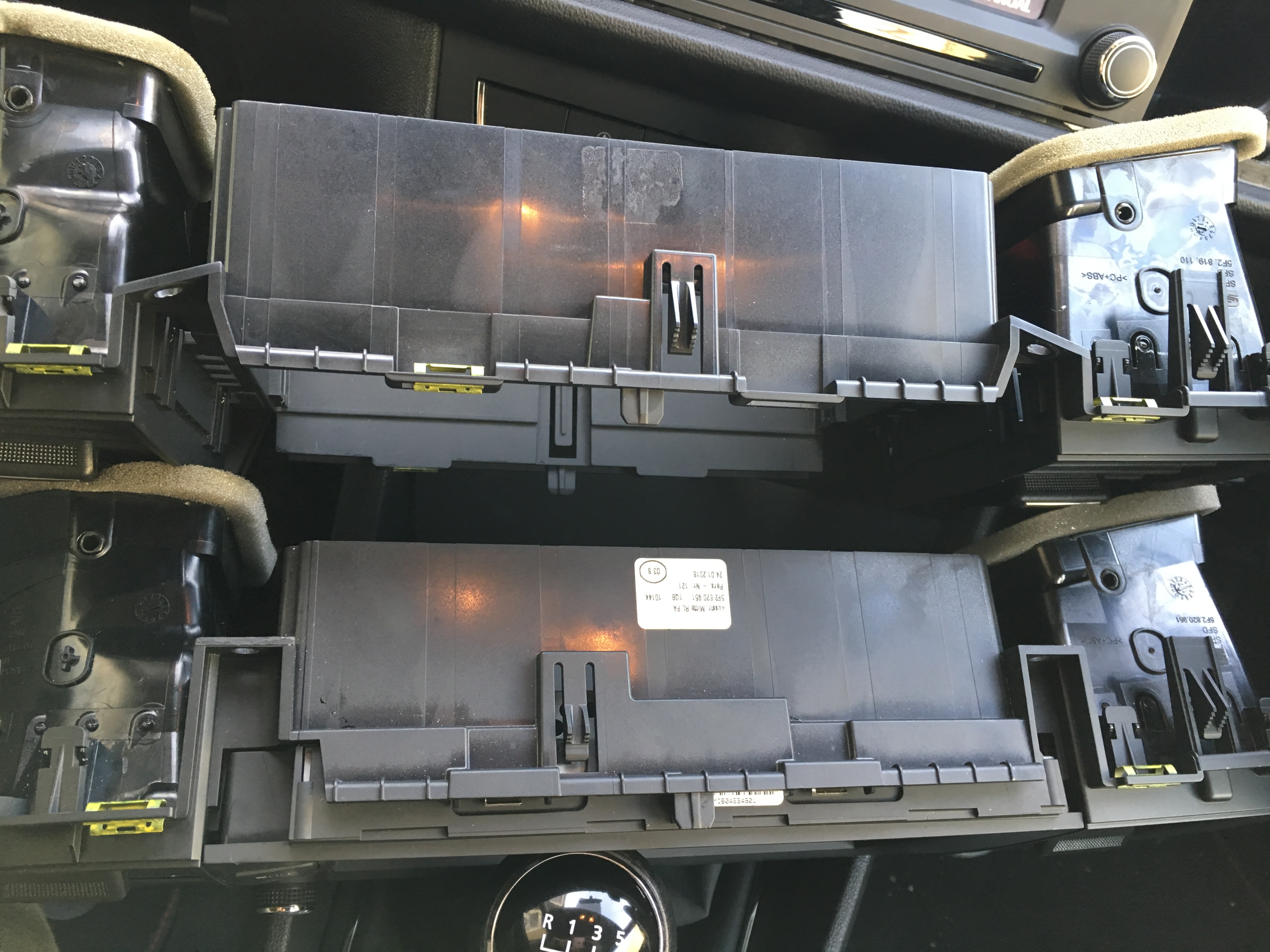

Now the issue I have is that the cage that the new screen sits in is slightly different to the original one.
I can’t seem to figure out how to take the new screen out of the cage?? Any ideas?
The full heater cage sticks out quite a bit.
Or should I just modify the new cage?

When I changed my screen from 6.5 inch to 8 inch I also purchased it with the heater vents etc and then found like you that it wouldn't fit so I had to modify the existing screen aperture to enable the 8 inch screen to fit.
Unlike the 6.5 screen the 8 inch screen does not have the slots to enable easy removal, you have to release the it from the rear of the screen, if you look at the photo you can see the four tabs that have to be pushed inwards to release, I found that I could do one at a time.

Thanks for the reply! So what I’ve understood from your experience is that to remove the 8 inch screen, there are some plastic tabs that need to be ‘unclipped’. I didn’t dare try as I didn’t want to break the housing but I will give it a shot and get back to you. Will the 8inch screen fit in the original housing?
Thanks
Thanks
If you look at the picture I have arrowed the tabs that need to be pushed back (they are metal not plastic), the original housing will need to be cut about to remove bits so the new screen will fit. Try using Google, there was a video of it being done.

Just a quick update -
I’ve managed to fit the 8inch screen in to the original mk3 housing. Pictures are attached. I used a multi tool to remove the plastic ‘lip’ on the heater housing.
The hardest bit of it is getting the MIB 2 to fit back into the glovebox compartment
