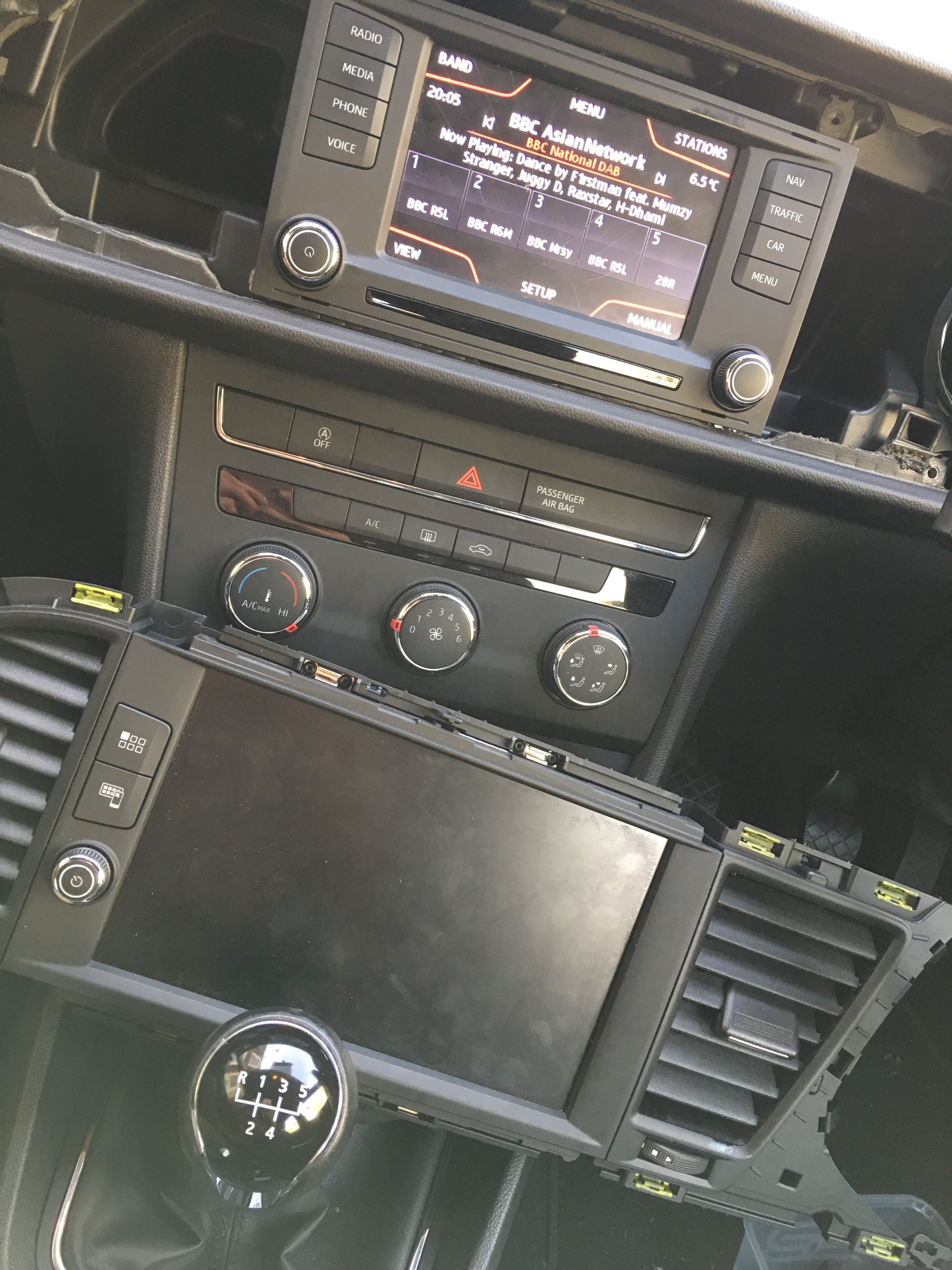

Now the issue I have is that the cage that the new screen sits in is slightly different to the original one.
I can’t seem to figure out how to take the new screen out of the cage?? Any ideas?
The full heater cage sticks out quite a bit.
Or should I just modify the new cage?

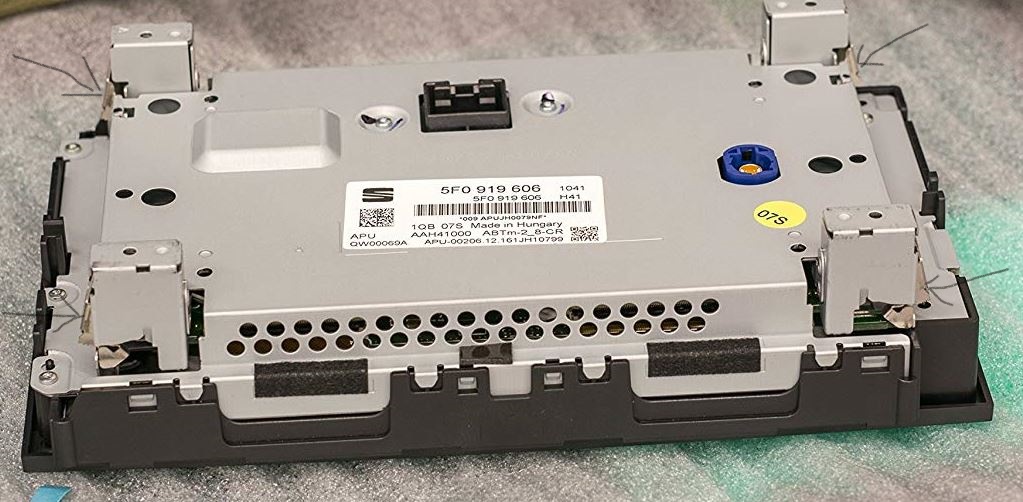

I’ve managed to fit the 8inch screen in to the original mk3 housing. Pictures are attached. I used a multi tool to remove the plastic ‘lip’ on the heater housing.
The hardest bit of it is getting the MIB 2 to fit back into the glovebox compartment
If anyone ever wants to do the conversion and needs any help let me know and I’ll be happy to help.
When I changed my screen from 6.5 inch to 8 inch I also purchased it with the heater vents etc and then found like you that it wouldn't fit so I had to modify the existing screen aperture to enable the 8 inch screen to fit.
Unlike the 6.5 screen the 8 inch screen does not have the slots to enable easy removal, you have to release the it from the rear of the screen, if you look at the photo you can see the four tabs that have to be pushed inwards to release, I found that I could do one at a time.

How do you remove the display again if its attached on the panel and there are no clips for easy removal?
You have to remove the whole vent assembly with the screen attached then release the 4 push-in clips, as shown in the picture on your quoted post, then push the screen out.

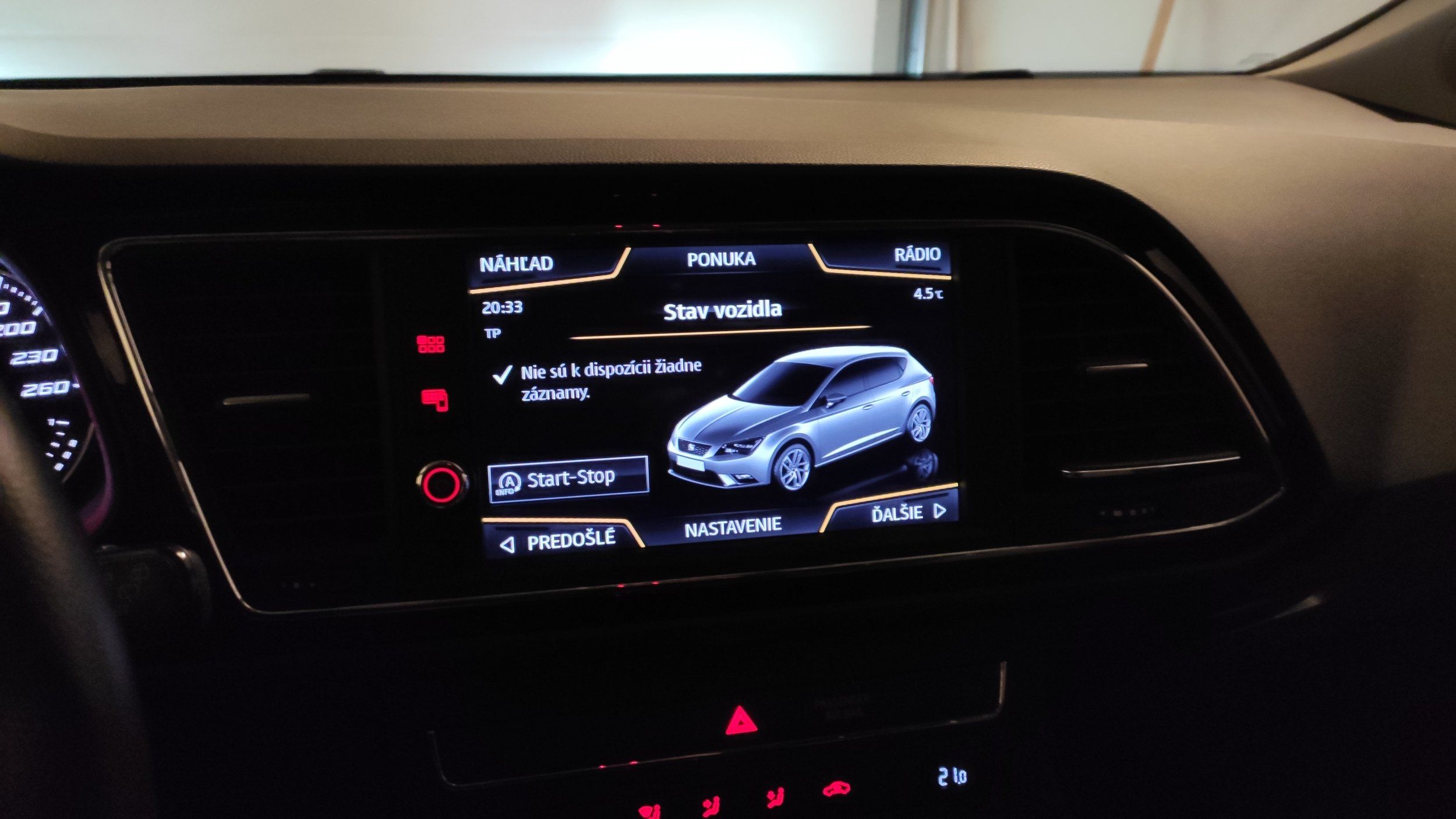

Hello all, i've also changed the unit in glovebox for 5QA035824 and display 5F0919606, the protection was removed and all other stuff was activated fulllink etc.
But the unit was from 1.4TSI car Hatchback is it possible to change the picture or the vehicle using vcds or its in the firmware?
I have a ST with 1.6 tdi without START STOP (ecomotive version)
Yes, it can be done with VCDS, I did it on my unit, but I cannot remember how at the moment. If I can find my notes I will let you know.
Edit, I think it's 5F controller, byte 18, value 3 = Ecomotive, not sure how to get the ST version.

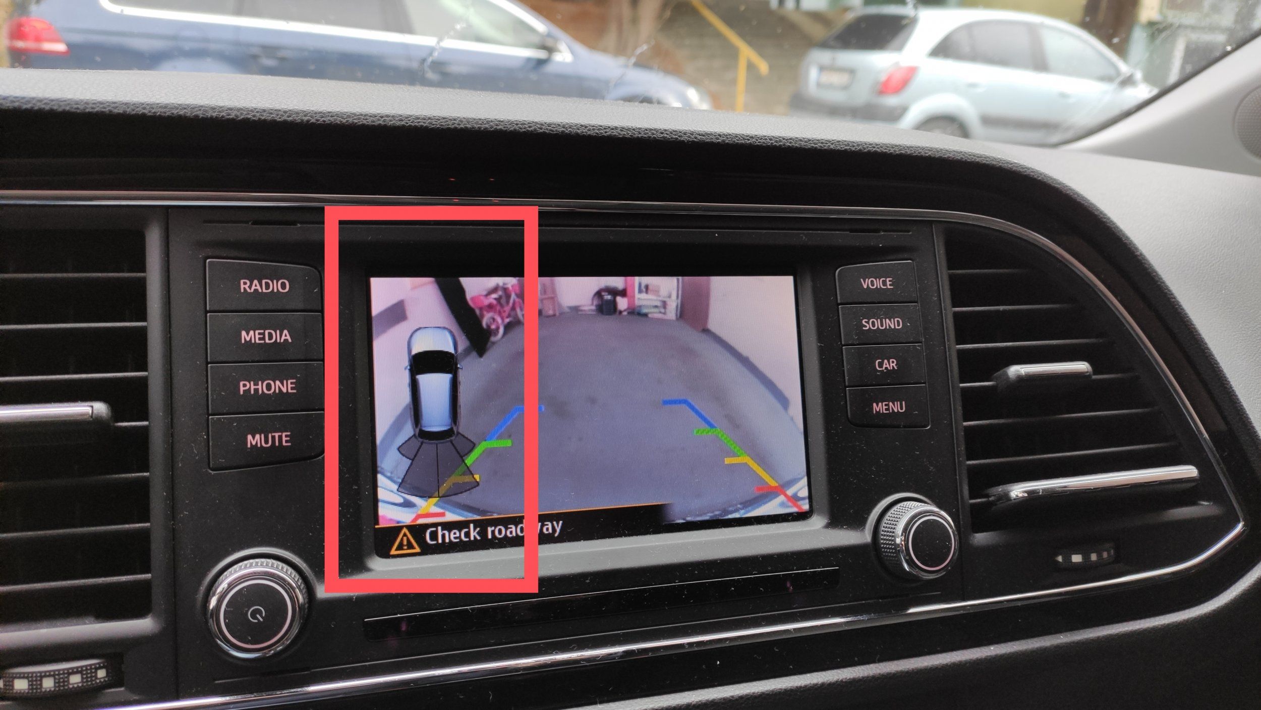

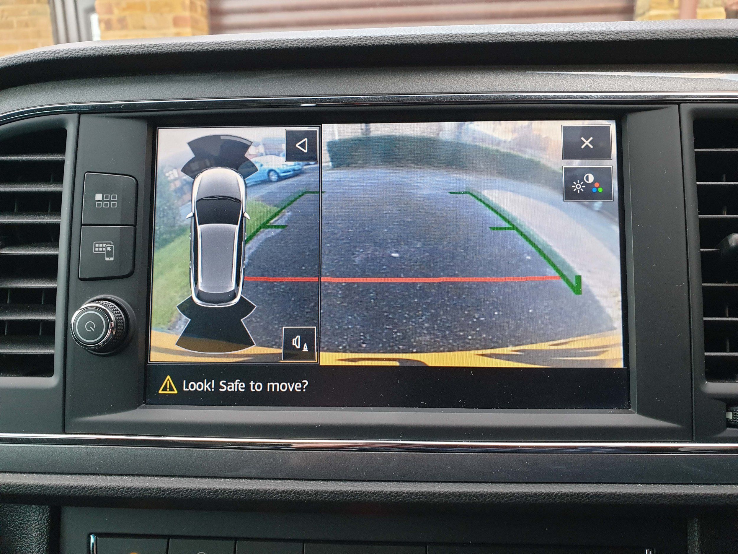

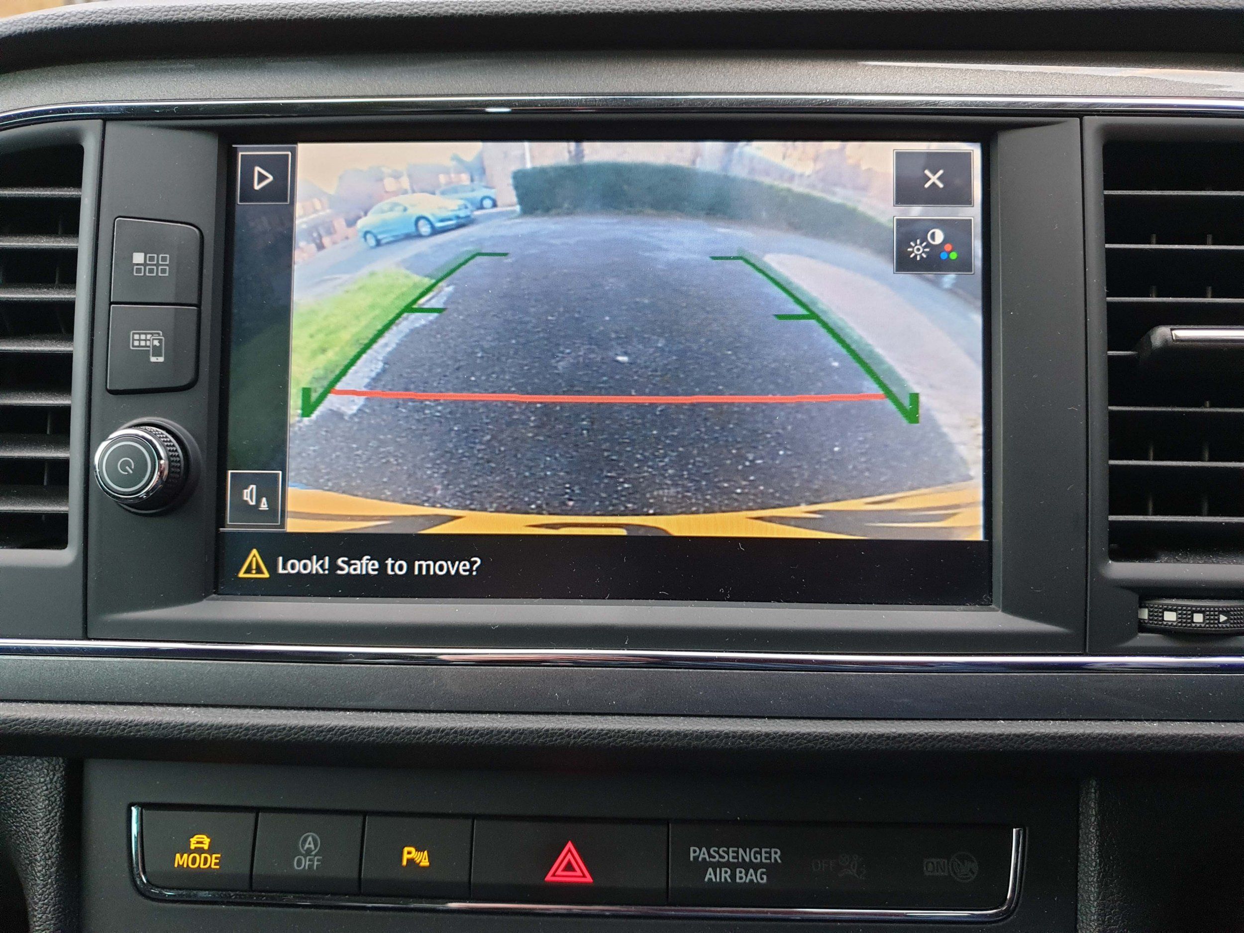

maybe one more question to you, when i had the old unit there was displayed the car with rear sensors (obstacles) now on the 8 inch screen i have just picture from the RVC, what can be the problem? is it because of the old pdc module or why its not showing?
Thank you @Walone i will have a look on that,
I'm not sure to be honest, perhaps the sensors need to be 'activated' (with VCDS?).
Here are the views of my screen when in reverse;-
