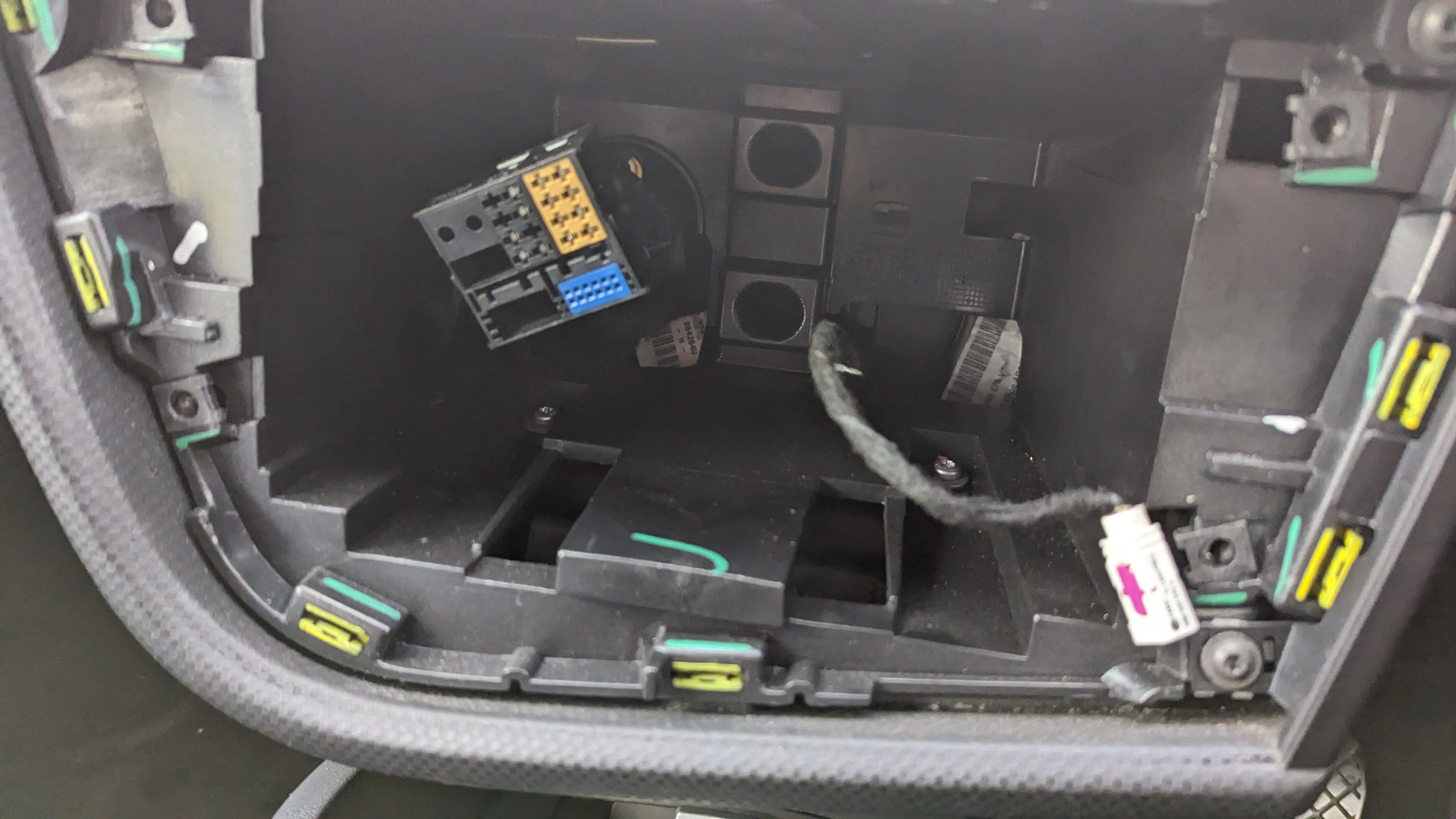

Hey, so the Sony headunit came with the but I also had to pick up a iso harness adapter, last issue is I'm not sure where the 2 switched live go into the standard block, I have attached what my block looks like and it has 5 connected to it, I know 2 of those but unsure which each of the 3 others are?
Hi I’m the big black block there will be a 12v constant live you’d need to cut that and join in your 12switched live from your fuse box.
You can just plug the iso in and fit it all together but normally the headunit wont turn off and will be constantly live on this plateform of car unfortunately. I’ll try getting a photo from my donar car tomorrow if I can get into the car far enough and should you the exact cable colour and location my my block.
