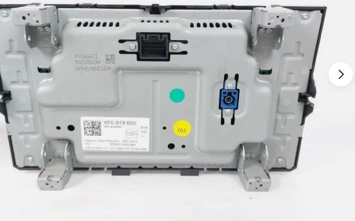

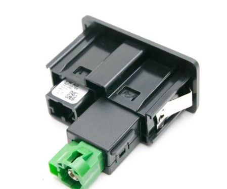

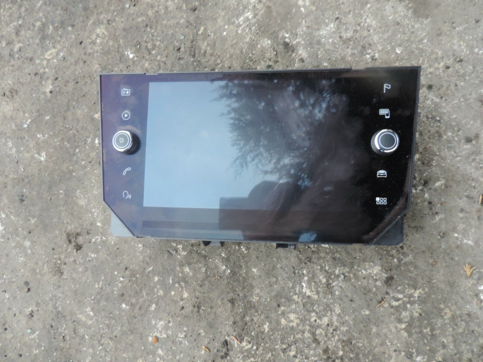

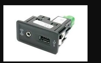

so my project is to upgrade with an OEM radio, planning to buy the follwing model:
Head unit : 5QA035824B
screen : 6F0 919 605
USB : 5G0 035 222 E
my request :
I need help with cables refrence and diagram how to connect all of these please ?
I need to know which cable and where to connect it

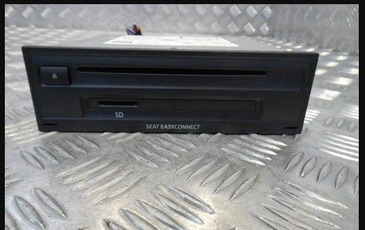

Radio wise, 5QA035824B is without DAB & GPS. Install 5QA035846 if you want GPS but no DAB, or 5QA035858 if you want DAB & GPS

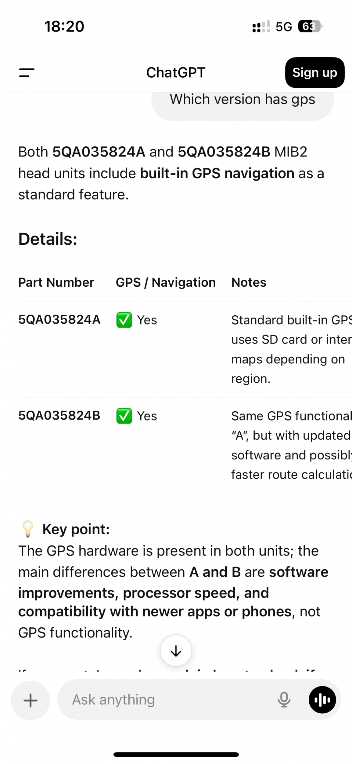

Buy one with GPS.. even if you disable it, it's easier to activate the unit than without GPS.
you mean the 5QA035824B is not easy to enable being a used item ?
is it doable ?
he
ChatGPT says so.. It's incorrect

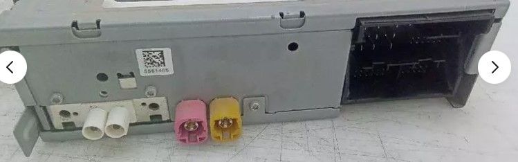

Single SD = no GPS
no blue FAKRA = no GPS
hello i just found the 5QA035858 A head unit , from a SEAT LEON 2012.
Are you sure it works with the IBIZA 2020 6F0919605 screen ?
I mean have you installed it or do you know for sure ?
please if you can confirm if you're sure 100% about it , i really appreciate your help, just don't want to lose some money ordering the wrong part , Thank you.
5QA035858 is an MIB2 unit from 2016 onwards
5F0035858 is an MIB1 unit from 2013 to 2016
We’ve installed hundreds of MIB2 systems. If you want the APP button to work on the display then you’ll need a newer unit to keep things simple.
The newer 5QA035858 units are 5QA035858A, 5QA035858B or 5F0035858C. No not buy C as it requires the same activation method as the non navigation systems.
