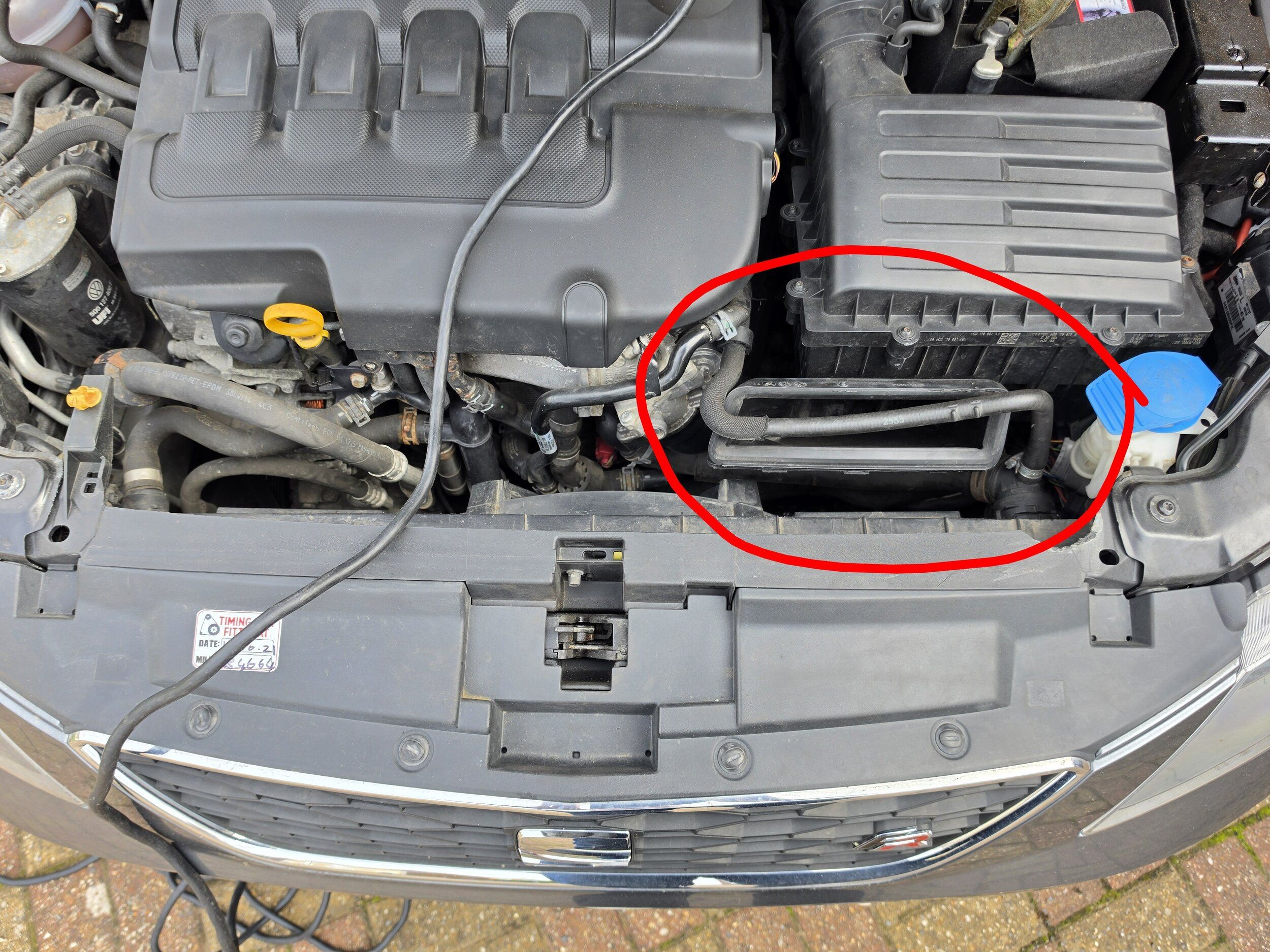

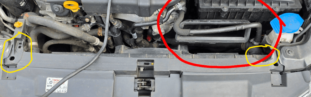

Hi all, need some help, I believe there is something missing in the red circled area maybe a bracket or hose to the air intake can anyone help tell me what it is? Thanks in advance.

Thank you i dont suppose you know a part number or have a picture of what I need?

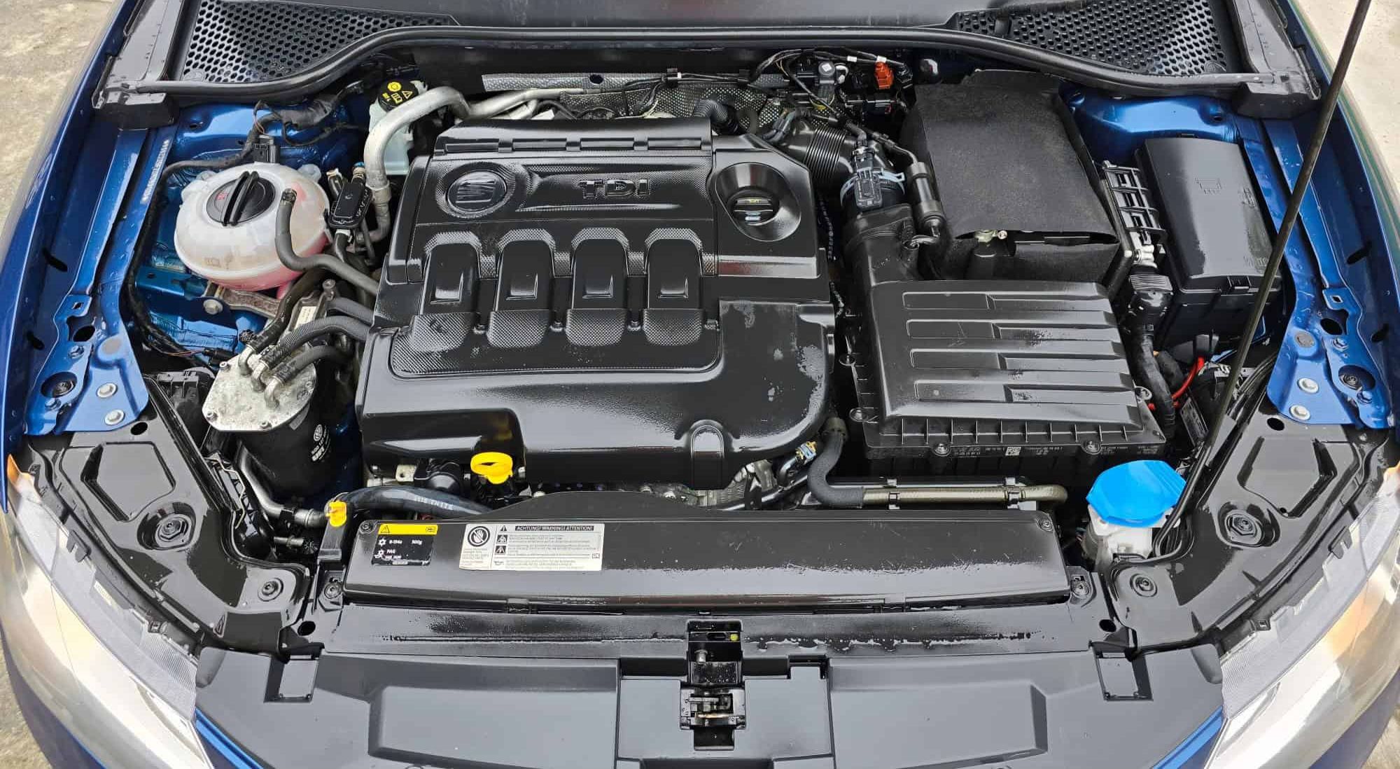

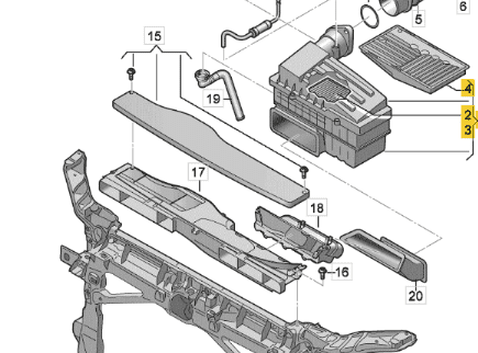

Comparing with the photo James provided, it looks like intake air duct cover and the air guides under it are missing.
I can provide part numbers but it would be better to look them up using the VIN of your car for exact ones, if you don't mind sending it over to me via a private message.
