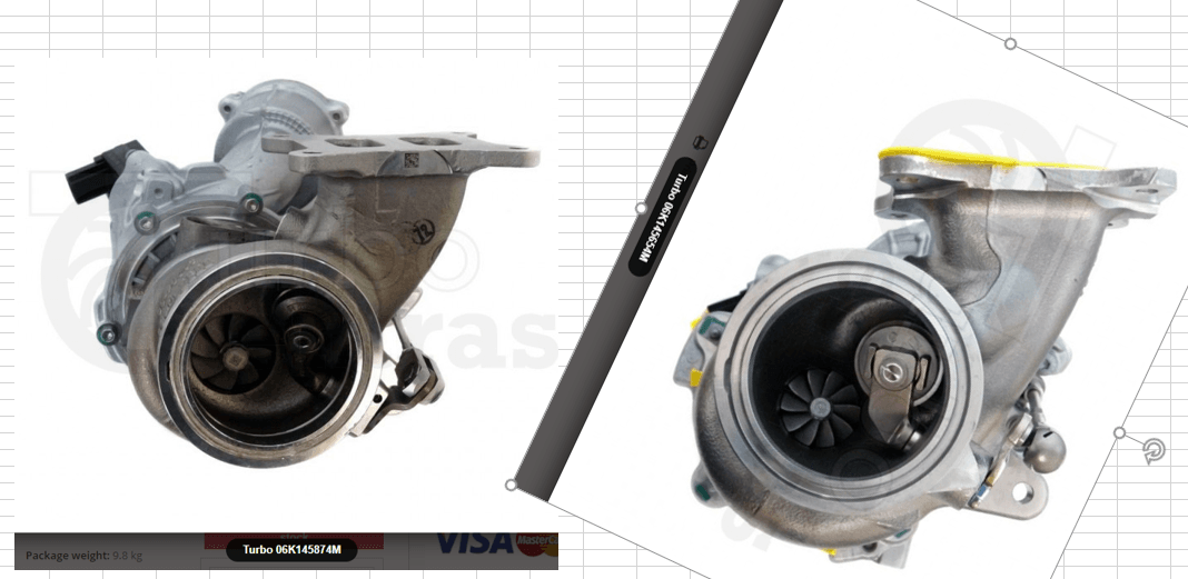

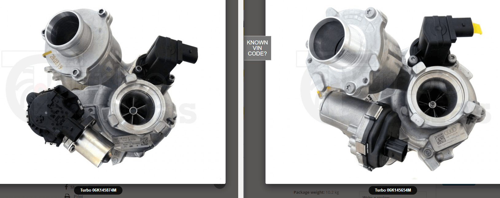

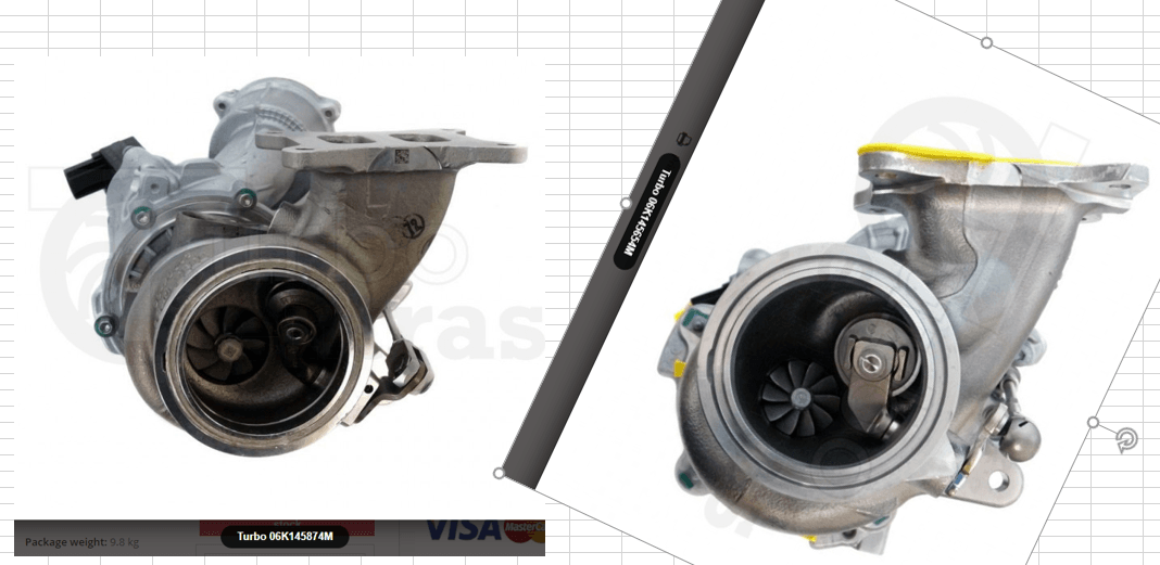

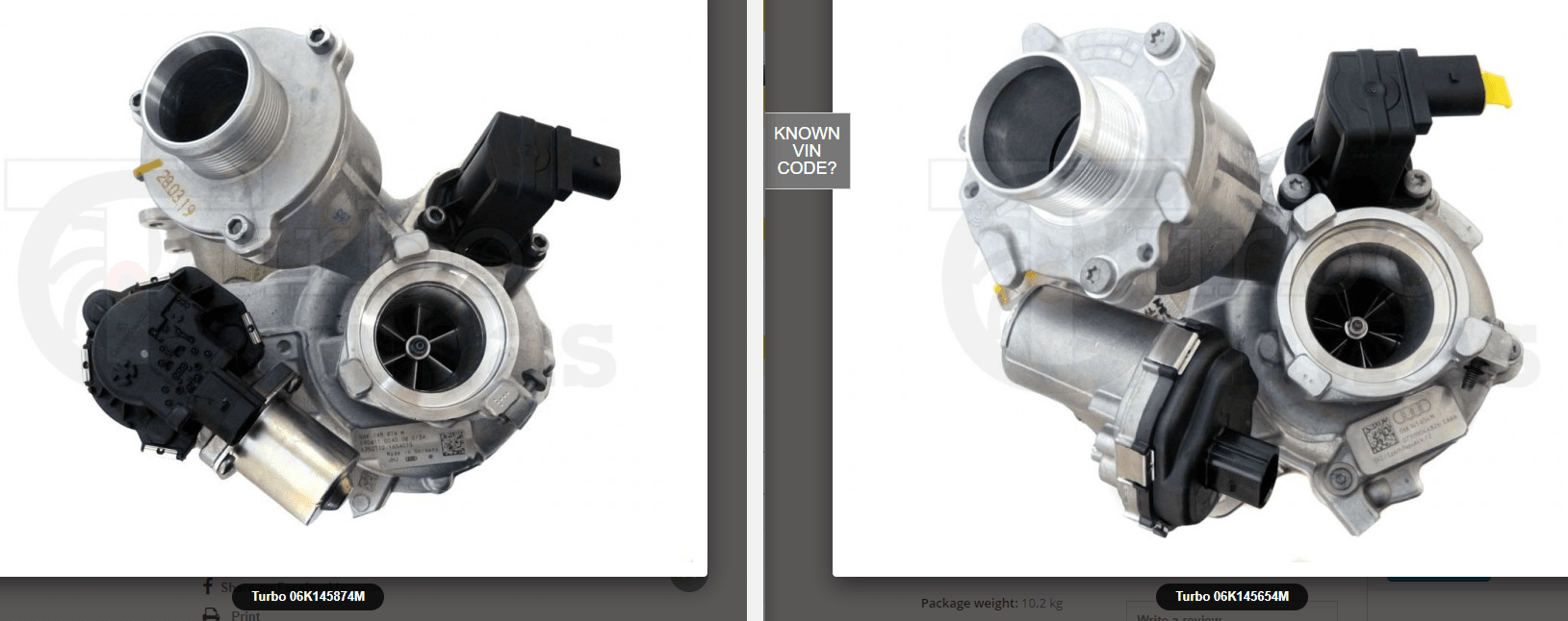

Sorry but it's not just a de-tuned GTI engine.
See my link I shared earlier - The ECO TSI 190 engine is the EA888 Gen3 B - and the B is important
There are many differences - one major one being compression ration 9.6:1 vs 11.65:1
It also has very different cylinder head which can also run miller combustion cycle with smaller inlet valves, smaller main bearings and runs 0w20 oil.
CHHA engine GTI turbo - different compressor and exhaust turbine
TURBO 06K145874M – DATA SHEET
Product ManufacturerIHI Turbo
Vehicle ManufacturerAudi, Volkswagen
DKZA ECO 190 TSI Turbo
TURBO 06K145654M – DATA SHEET
Product ManufacturerSVZ
Reactions: queen
