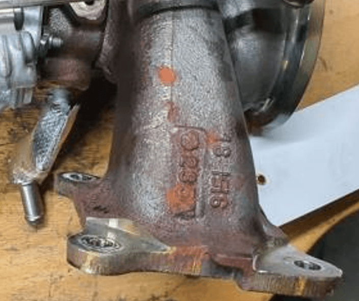

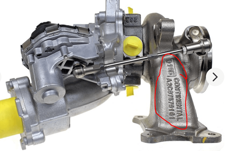

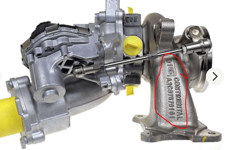

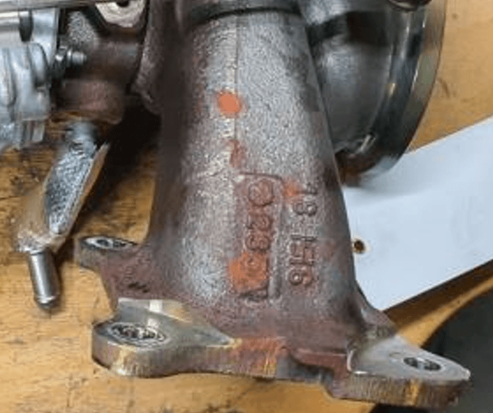

I stand corrected sorry!No, DKZA turbo part number in the Leon is 06K145654M which is a Continental not an IHI made turbo. See image below of this OEM part:
Haven't checked other models with this engine - or the CZPB.
Not that it matters who made the turbo! but just to confirm again - it is not a turbo from the GTI.

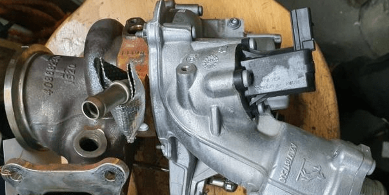

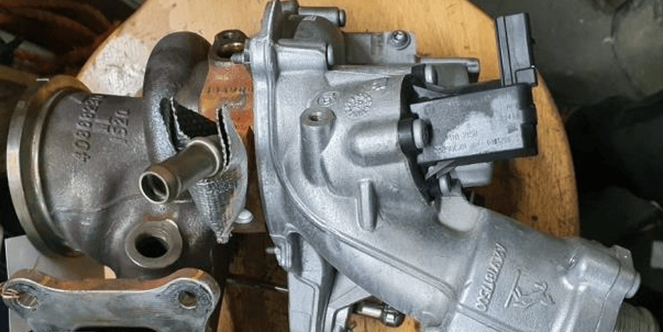

So I had a look under the bonnet for my routine weekly self inspections such as coolant and oil level. I did remember this conversation and I figured whilst I was there I'd do some real world investigation rather than spewing specs from websites. For the sake of information being available on this thread, I DO have a IS20 with my 2.0TSI 190ps DKZA Engine, which probably confuses the already confusing VW line up even more!
| DKZA | ||||
| >2019 | 06K 145 654 L | £ 1,116.00 | 06K 145 654 Q | £ 1,751.00 |
| 2019> | 06K 145 654 M | £ 1,209.00 | 06K 145 654 Q | £ 1,751.00 |
I'm glad you took it that way! Definitely wouldn't want to have upset you in any way!No, only love here
Checking the parts catalogue again and I can see a year break change - for 2019
DKZA >2019 06K 145 654 L £ 1,116.00 06K 145 654 Q £ 1,751.00 2019> 06K 145 654 M £ 1,209.00 06K 145 654 Q £ 1,751.00
The M and Q are both Conti - but checking 06K145654L it is marked IS20! So seems early DKZA had IS20 and later they superseded to Conti.
06K 145 654 L
But I can also see IS16? Image is the same turbo.
