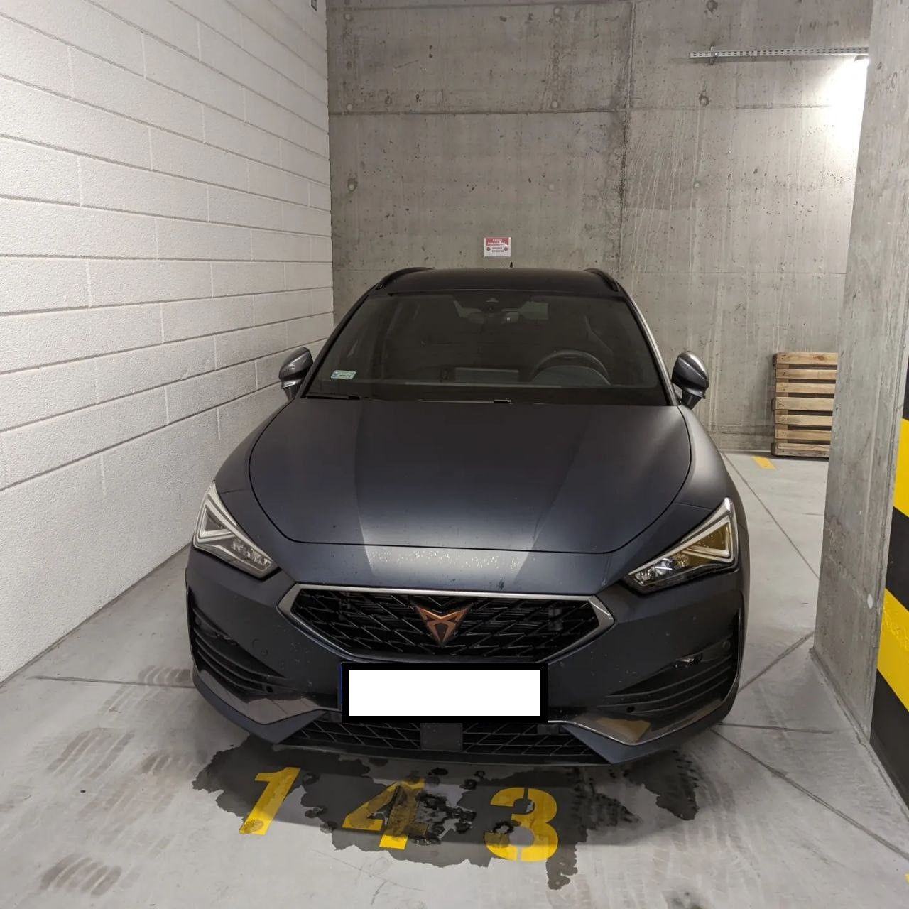

Today I've finally picked up Cupra Leon ST 310 hp after waiting for more than 10 months.
During my first ride I had several issues with my car.
1) Blind spots works only from the driver side. Ambient light works perfectly from both sides, but blind spots indicates only the car from the left side(yellow indicator).
2) Throughout all my trip Google maps were closing. I used them via wireless Android auto.
3) Every 1-5 minutes voice assistance asked me for a command. (I decided to switch off voice activation).
I would really appreciate it if someone advice me how to fix these issues.
