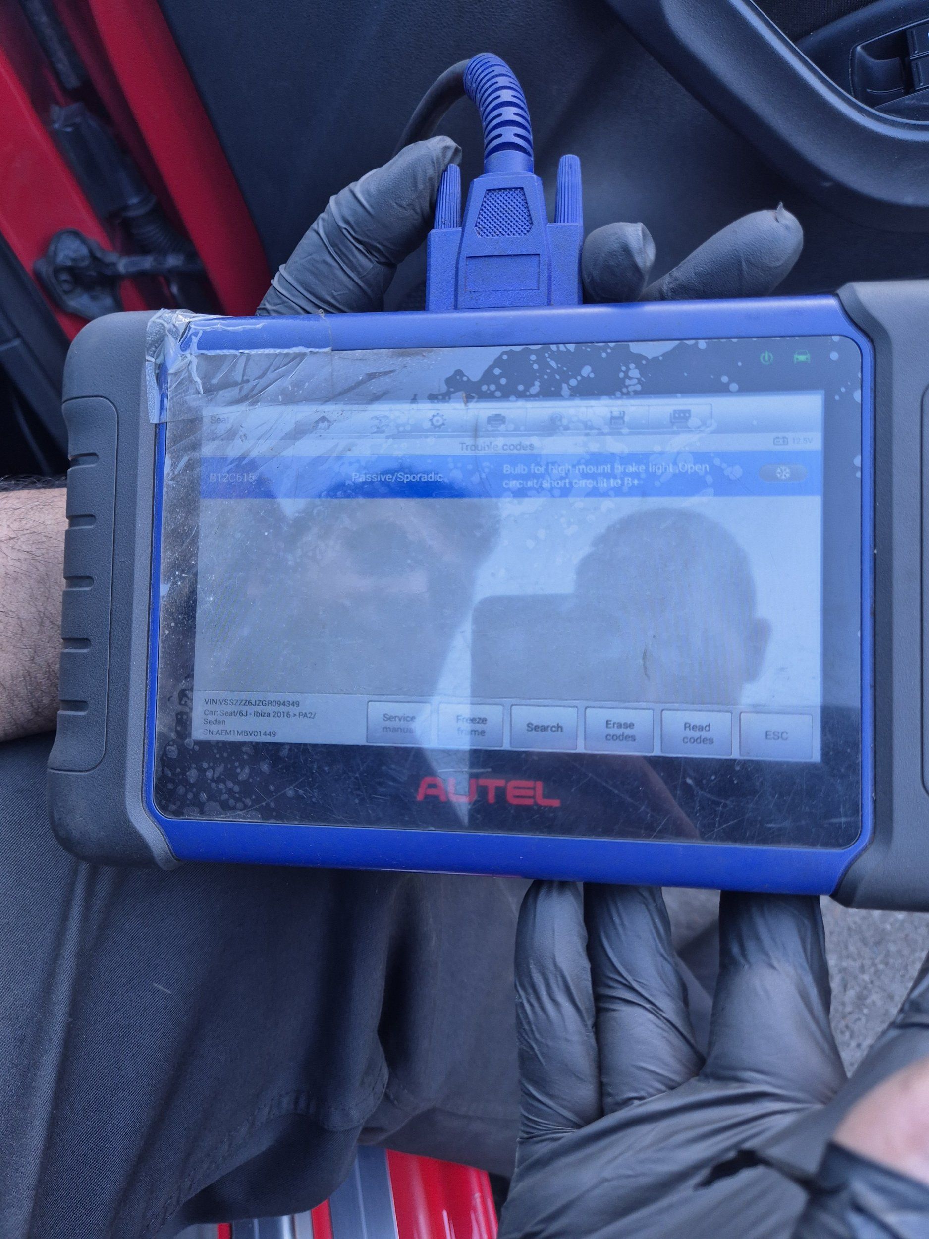

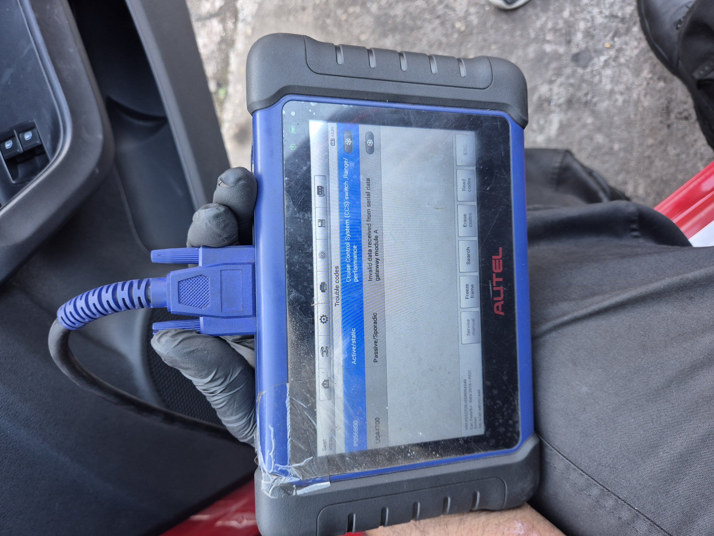

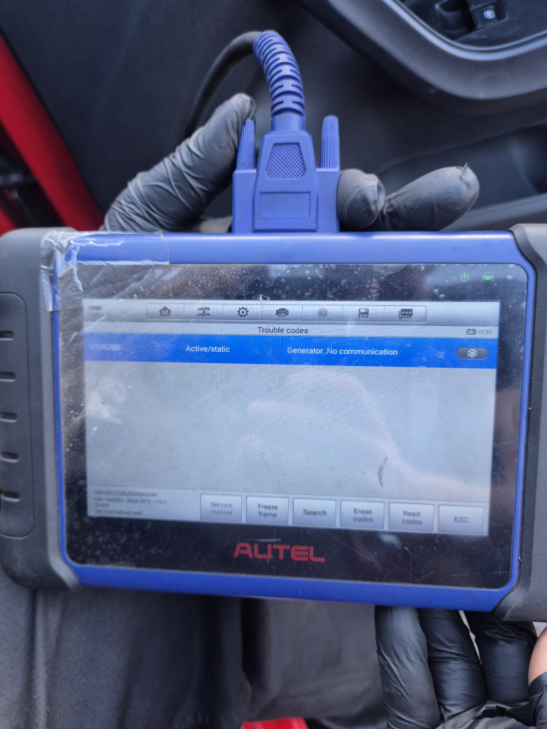

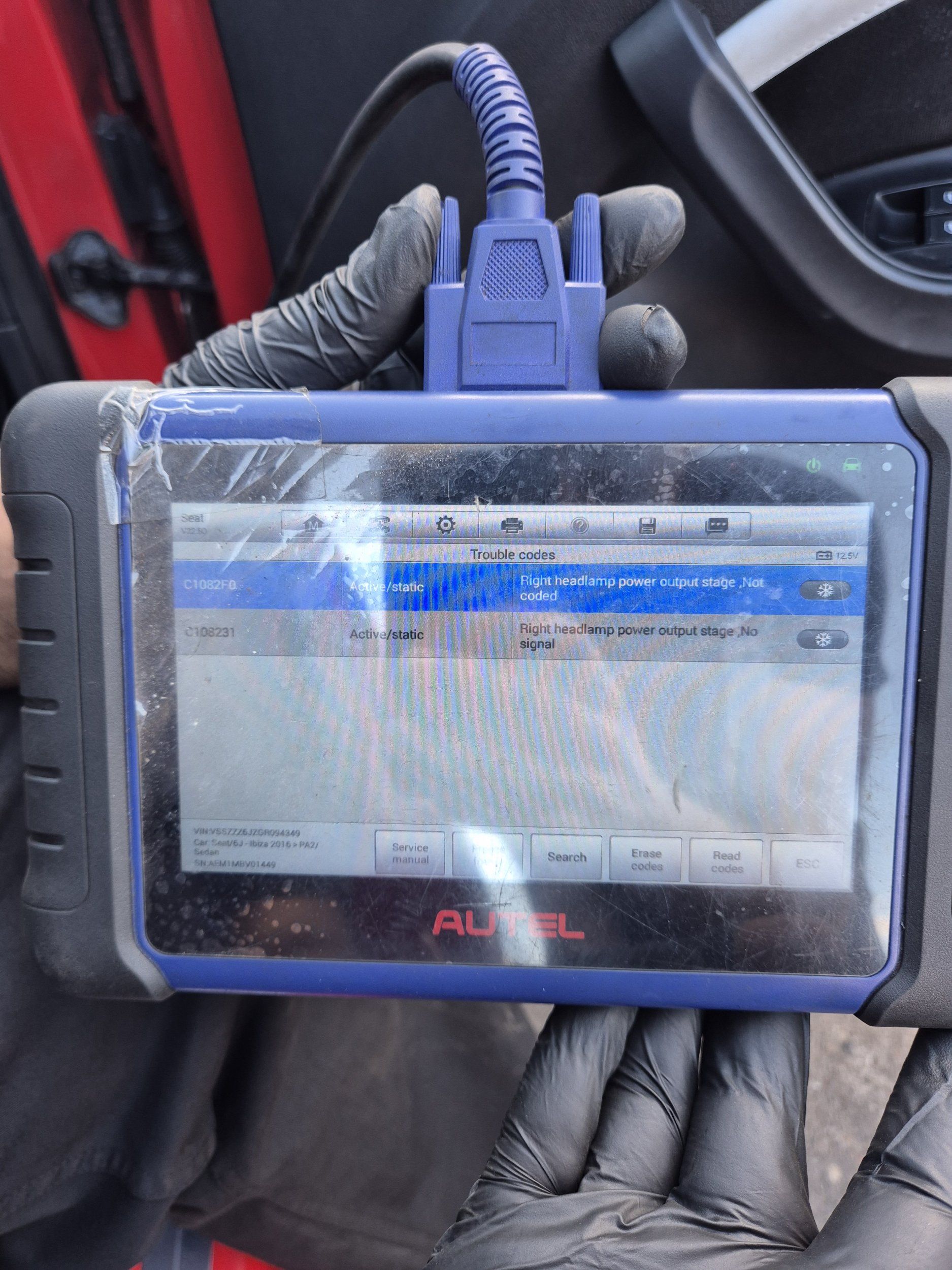

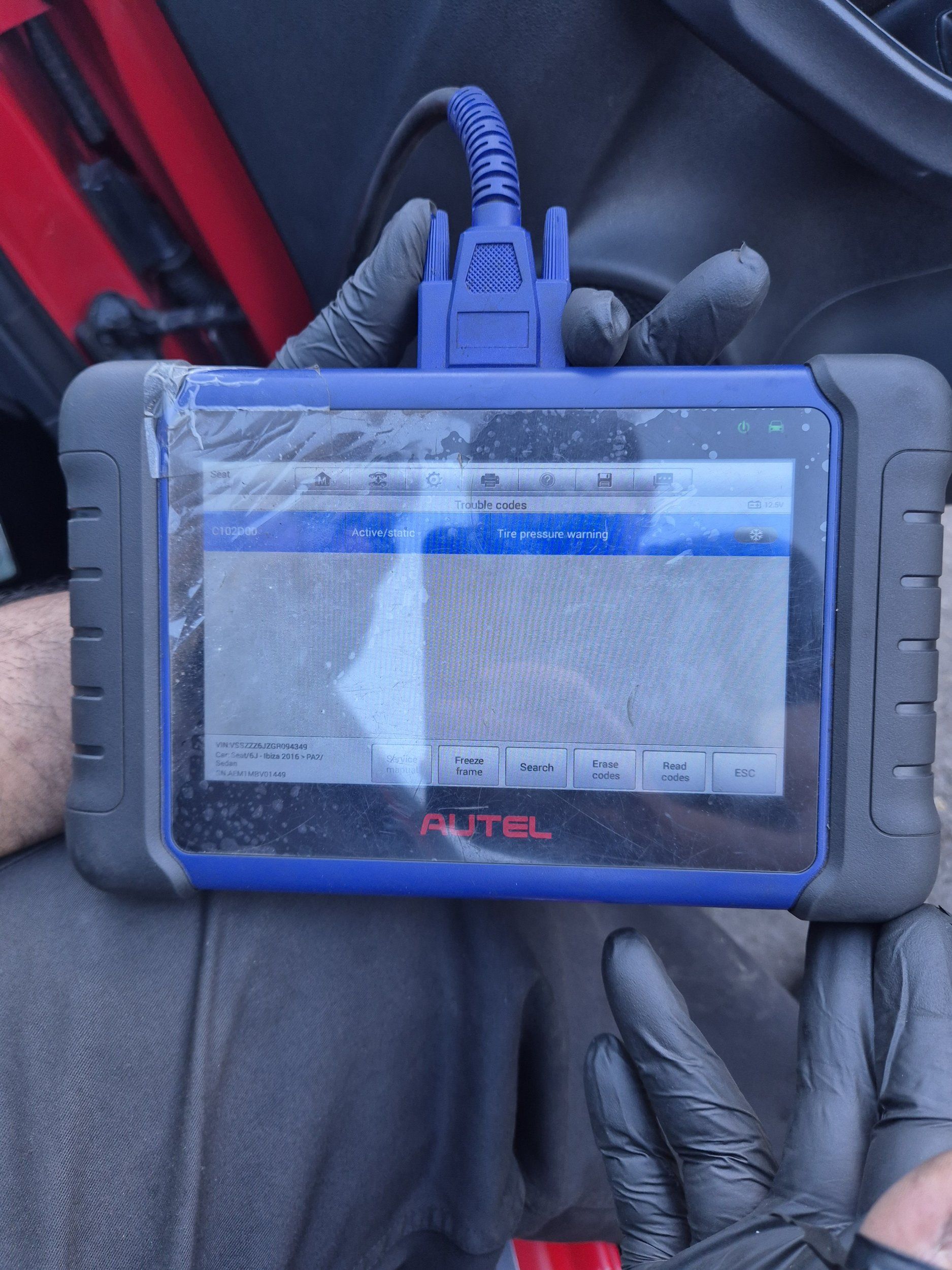

Hi all. Not long picked up a 2016 Ibiza Cupra. Noticed a few issues and have few error codes showing up, wonder if anyone can help identify causes?
Intermittent cruise control working, sometimes the cruise symbol comes on with an ! Next to it and won't work.
Left mirror unfolds all the way to the floor when using electric folding mirrors, guessing something inside has snapped so new mirror?
Got a headlight code but they seem to be working fine so not sure what that could be.
Scan from car reader app below if anyone can make sense of it

19. CAN Gateway19. CAN Gateway
DTCs: 1
197149 [0x03021D]
U105200: Generator, No Communication
Break_Down_LIN_Communication_Alternator
Status bits: 1
Priority: 2
Frequency: 4
Unlearning index: 249
Odometer: 90878 km
Date, time: 2025.08.04 14:36:47
Status: Test failed, Confirmed
09. Onboard supply control unit09. Onboard supply control unit
DTCs: 1
11274 [0x002C0A]
B12C615: Bulb for high-mount brake light, Open circuit/short circuit to B
Bremsleuchte Mitte-Unterbrechung / Kurzschluß nach Plus
Status bits: 1
Priority: 1
Frequency: 2
Odometer: 90878 km
Date, time: 2025.08.04 15:13:44
03. ABS control unit03. ABS control unit
DTCs: 1
00629 [0x000275]
Status bits: 1
Priority: 4
Frequency: 3
Odometer: 90878 km
Date, time: 2025.08.04 14:36:38
Status: Test failed, Confirmed, Warning indicator requested
01. Engine control unit01. Engine control unit
DTCs: 2
17187 [0x004323]
P056800: Cruise Control Set Signal
Status bits: 1
Priority: 2
Frequency: 1
Unlearning index: 255
Odometer: 90895 km
Date, time: 2025.08.04 15:55:22
Engine RPM: 912 rpm
Calculated engine load value: 66.67 %
Vehicle speed: 9.32056788356001 mph
Engine coolant temperature: 105 ℃
Engine oil temperature: 51 ℃
Barometric pressure: 14.358736062693 psi
Klemme 30 voltage: 14
Paramteric values: 20 96 28 41 6F 01 41 6D 01 43 83 30 01 41 6C 00 11 0E 03
Status: Test failed, Test failed (current drive cycle), Pending, Test failed since last DTC clear
21657 [0x005499]
U044700: Invalid Data Received From Serial Data Gateway Module "A"
Invalid Data Received From Gateway "A"
Status bits: 1
Priority: 2
Frequency: 2
Odometer: 90878 km
Date, time: 2025.08.04 15:12:12
Engine RPM: 780 rpm
Calculated engine load value: 30.98 %
Vehicle speed: 0 mph
Engine coolant temperature: 71 ℃
Engine oil temperature: 55 ℃
Barometric pressure: 14.5037738007 psi
Klemme 30 voltage: 13
Paramteric values: 20 96 28 11 0E 02 13 33 03 11 F0 07 72 13 33 03 11 AB 00 00 43 83 31 01

55. Headlights corrector55. Headlights corrector
DTCs: 2
5276400 [0x5082F0] Archive (inactive)
C1082F0: Right headlamp power output stage, not coded
Leistungsmodul Scheinwerfer rechts - nicht codiert
Status: Confirmed
5276209 [0x508231] Archive (inactive)
C108231: Right headlamp power output stage, No signal
Leistungsmodul fuer Scheinwerfer rechts kein Signal
Status bits: 1
Priority: 6
Frequency: 7
Unlearning index: 34
Odometer: 90878 km
Date, time: 2025.08.04 14:36:51
Status: Confirmed
