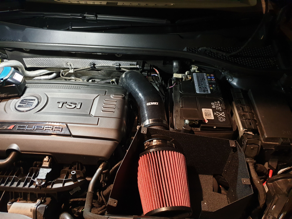

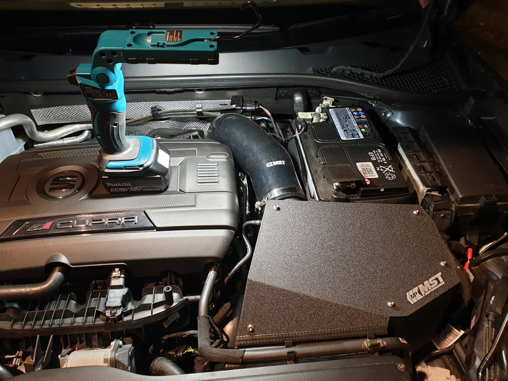

MST Performance Intake Kit and Turbo Muffler Delete
Bought and fitted by myself recently - I'm not a mechanic by any stretch of the imagination but can handle a spanner, this job is fairly easy to do. Though one top tip is to make sure you have a 7mm spanner, I had 6mm and 8mm but no 7mm. This made the jubilee clips on the hoses a pain to undo - there wasn't enough access for a 7mm socket - it had to be a spanner.
Why did I do this mod?
- I wanted to be able to hear the intake and turbo a little more
- I'm going to be tuning further for performance soon
Why did I choose this over other options?
- It was significantly cheaper than the equivalent full Racingline setup (especially as I got it at a discount).
- I also considered doing a stock intake mod instead with a new filter and the MST pipe work, this would have met the same level of performance but wouldn't have provided the same uplift in sound. It didn't actually cost me that much more to get the full MST kit because of the offer I had.
- It uses a cotton cone filter, which is longer lasting and a better filter (i.e. capturing dust) than foam. It just flows slightly less.
- It topped this guys tests for flow (so the cotton filter cant be holding it back that badly!)
I'm very happy with this purchase, quality is nice. Can hear a nice amount of intake on throttle now and the turbo muffler delete lets out subtle sounds when lifting off. No noticeable increase in noise when cruising gently though. Pics attached with and without the box cover (i'm running it with the cover).

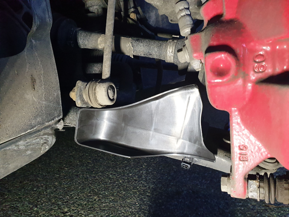

Audi RS3 Brake Cooling Ducts
So today, I fitted some cooling ducts for the front brakes, an Audi OE part for the RS3 that fits other MQB cars perfectly, part numbers are 8V0407811 and 8V0407812 (one for left, one for right). I got them direct from a local Audi dealer for £12.53 each... much cheaper than online resellers.
I have added these to provide additional cooling when pushing the car on the track... not sure they would be relevant on a 100% road car though.
Easy to fit - only tools required are those to take the wheels off and some pliers to cut the cable ties (which come with the ducts to secure them).
I also used the opportunity to give the front arches/brakes a bit of a clean... much easier than normal :D.

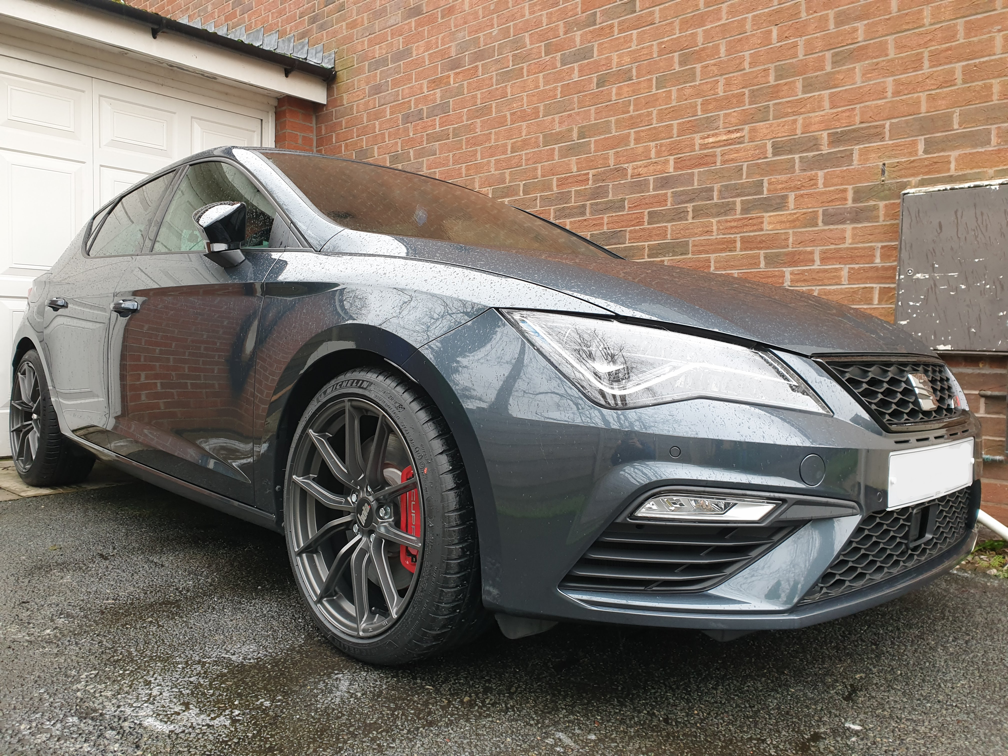

I now have new wheels fitted - a change i've been planning and researching for a little while now. Whilst I love the aesthetic of the standard wheels - they were not perfect for my purposes. I have laid out my considerations for this decision below:
  • The OEM wheels are diamond cut, which looks lovely when new, but is well known to degrade when exposed to our winter conditions. My new wheels have a more typical finish, which will be more durable and cheaper to refurb if required.
  • The OEM Wheels are really heavy, for normal road use this might not be a bother, but reducing this rotating and unsprung mass should deliver real benefits on the track. There should also be a small positive benefit on ride comfort and fuel economy. Total weight for my brand new wheel and tyre is 18.1kg, vs 22kg for the mostly worn OEM wheel and tyre.
  • My new wheels are 18in rather than 19in, allowing me to increase the sidewall (overall diameter is near identical). This has delivered an immediately noticeable improvement in comfort on the motorway and rough roads, and should also improve compliance in the wet. Sharpness in the dry will be slightly reduced vs a comparable 19in setup. Like for like tyres seem to be around 10% cheaper in my new size, and wheel replacement is around 20% less if ever required.
  • The wheel size I have gone with is 18x8.5 ET45. Aesthetically, this means the tyre contact patch is shifted out by 5mm each side and the alloy wheel face pokes out 11mm more than OEM. This minimises changes to the suspension geometry whilst still providing a more aggressive wider stance.

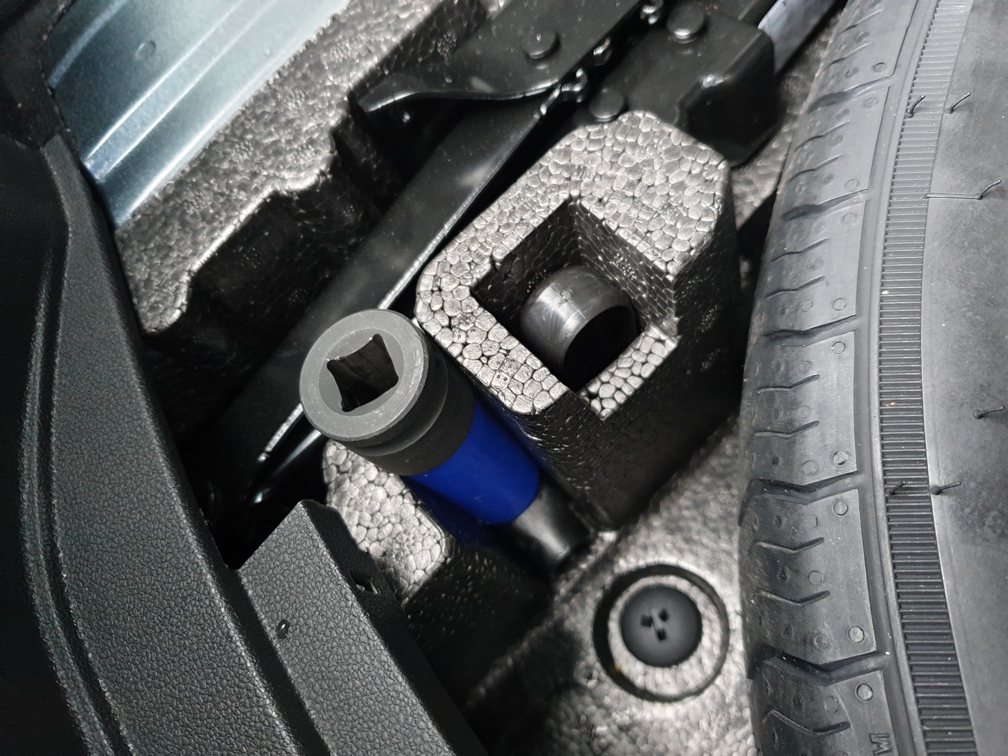

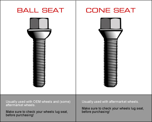

Something you should consider when buying aftermarket wheels is the wheel nut type. The OEM type is ball seat, but my new ones are cone seat. This is not a problem in day to day use, except for the fact that your new wheel nuts will not be an appropriate fit for your spare wheel. Because of this, I have put 5x of the OEM bolts in the spare wheel (using tape so they don't rattle). Should a roadside tyre change be required, the correct bolts are immediately on hand.
I have also purchased an impact socket which is sheathed in plastic to prevent wheel damage when removing them. This fits securely in the spare wheel foam surround as per the below image.

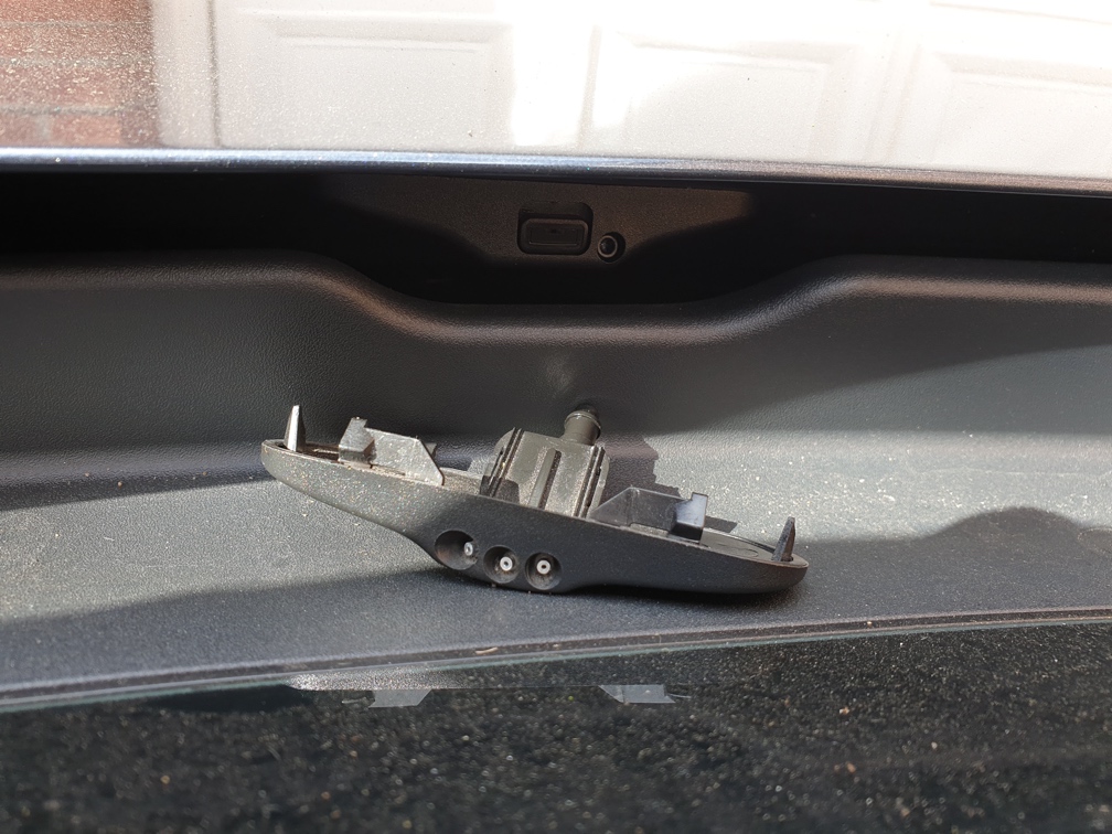

Fan Washer Jets
Theres not much I can say about these that is not already covered in this handy how to guide.
My car left the factory with pistol style washer jets (part numbers 5F0-955-985 and 5F0-955-986 for left and right).
Other VW Group cars come with a better fan style jet, which is a direct swap - 5M0-955-985-C-9B9 (same number covers both left and right).
Took me a couple of minutes to swap them over and another couple to adjust the height. I've not been able to use them on the go yet but they seem to provide broader and more even coverage of the windshield. Happy with the results.

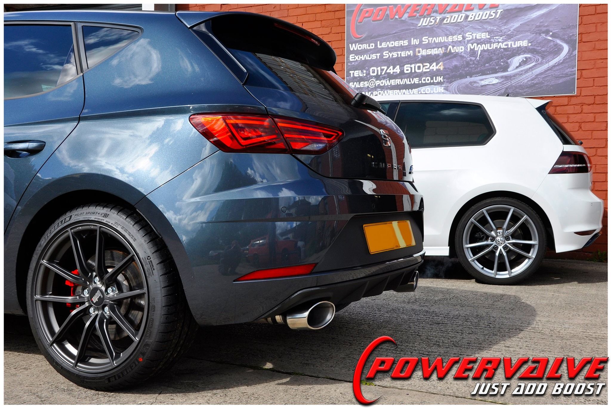

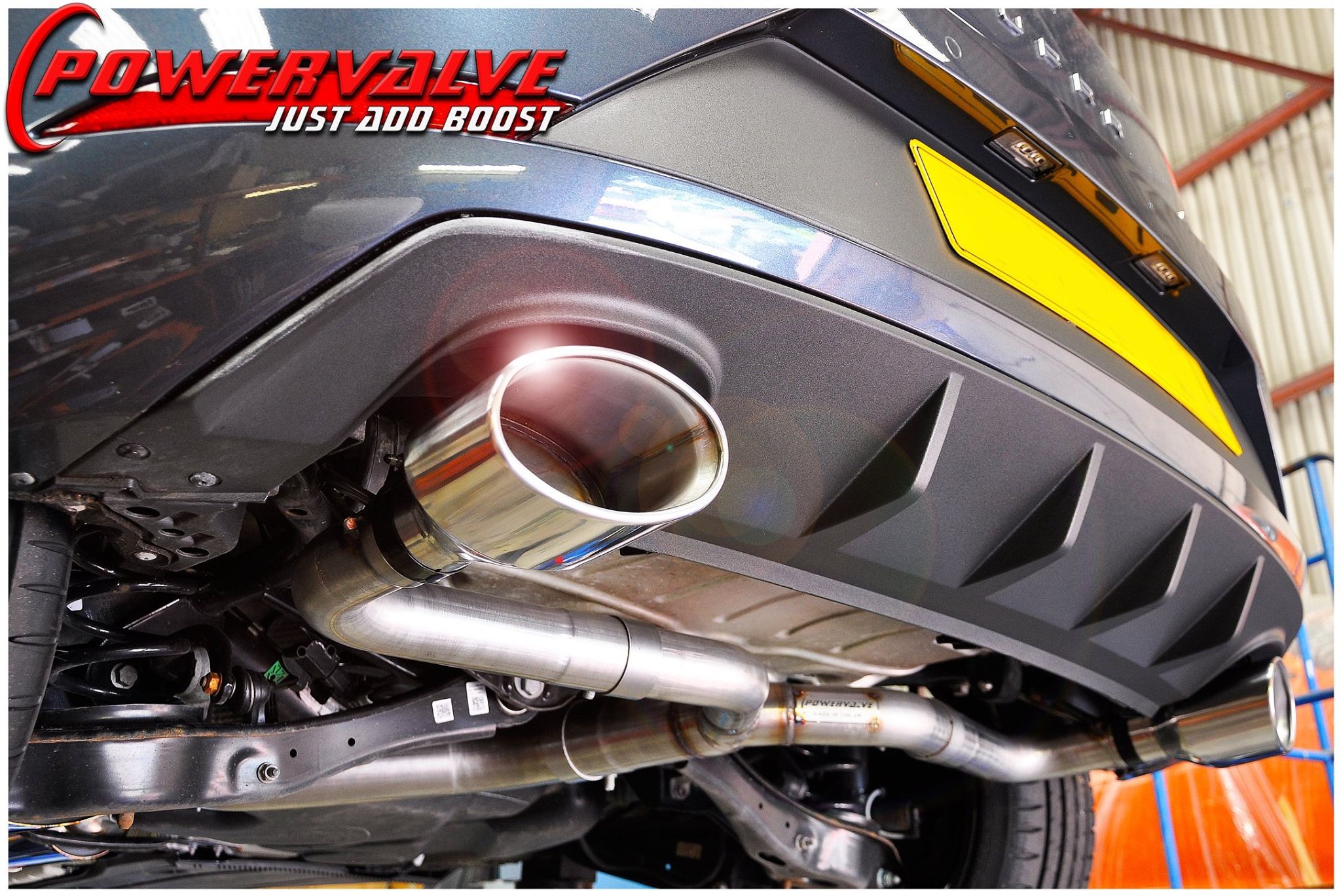

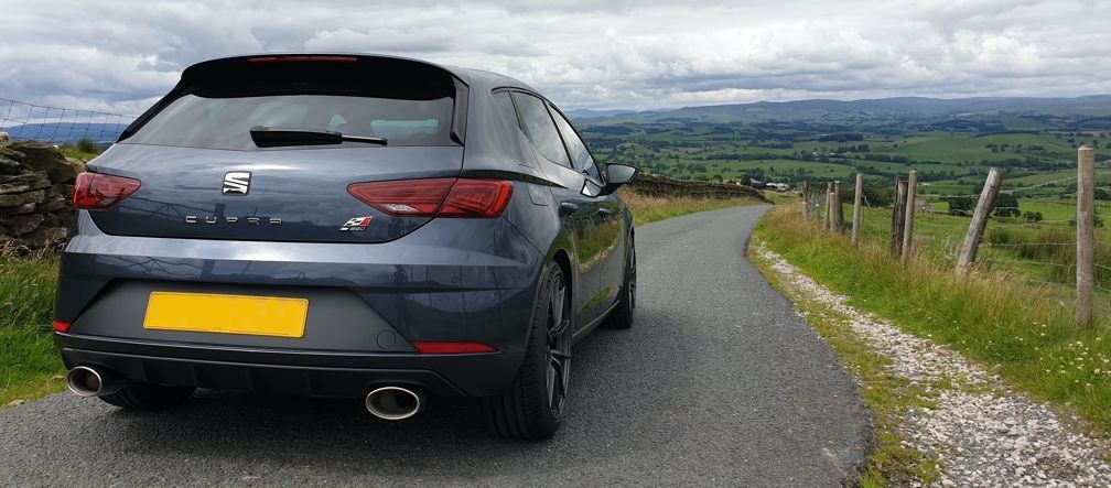

BCS Powervalve Exhaust
I think its fair to say that the exhaust note on the newer GPF equipped cars is muted, and, whilst I'm not a fan of really loud exhausts, I did want something with a bit more character.
I researched the usual names (Milltek, Scorpion etc), and whilst the products seemed OK, I'd picked up mixed reviews of the quality of their products.
Whilst looking, I saw some posters mentioning BCS Powervalve Exhausts, although I hadnt heard of them, I couldn't find a bad word about them or their products. Their prices are very competitive for the quality on offer. After a few detailed conversations, these are the guys I went with to build and fit my system.
The options you can get (and my choices) are as follows:
Valved or Non Valved -
  • A valved system is the party piece in BCS's offerings. Unlike similar competing products, which are controlled by an electrical switch, the BCS system opens and closes based on how much boost the turbo is generating.
  • They also offer non-valved systems, which are like a normal sports exhaust, and a bit cheaper.
  • I went for valved and am blown a way by how well it works, it is as quiet as OEM on the motorway but opens up the sporty sound when you put your foot down.
Presitge, Sport or WRC -
  • This is the sound profile, prestige being the quiestest (two fairly large silencers), WRC being the loudest (straight through), and sport offering a happy medium of the two.
  • This is purely going to be down to personal preference, I went for the prestige system because I prefer a more subtle note, and also need to ensure I stay within noise limits for track days.
  • The system sounds nothing short of amazing. It's deeper than the stock exhaust, and has much more range in the sounds it will make, you can hear more of whats going on at the engine, without it being overly loud or droney.
Decat, 100 or 200 cell catalytic converter -
  • What you go for here really depends on your car and how you use it, I didn't consider the decat option as my car is a road vehicle first and foremost.
  • The choice between the 100 and 200 cell cats is based on how far you want to push the power envelope, both should pass MOT emissions tests, but the 200 cell will get through it a bit easier. The downside of the 200 is that it creates a little bit more restriction, vs the 100 cell which in theory flows just as well as a decat (BCS can explain the science of this to you if you are interested!).
  • I went for the 100 cell.
Downpipe wrap -
  • An optional extra is having the downpipe covered in a thermal wrap. The purpose of this is to keep the heat in the exhaust and out of the engine bay, allowing the engine to breathe cooler air and perform at its best for longer. It's a nice to have and not something that is needed.
  • I opted to have the wrap as it's not too expensive, looks great in the engine bay and should give some performance benefit.
Tips -
  • The final option is what tips you have on the exhaust, BCS will talk you through the options suitable for your car, there will be something to suit any taste (round/oval/single/double/quad/black/silver etc).
  • I went for ovals, which are effectively a bigger version of the stock design for my car. There was obviously a lot of attention to detail in this (in the whole system to be honest!), the guys were talking about how they worked out the shape and the angle of the exit, to compliment the lines of the car. It really does show in the finished product - which lines up perfectly with the OEM rear bumper, and looks great from every angle.
As a final word on the exhaust, I'd highly recommend BCS to anyone, both the product and their customer service is top notch. The guys are clearly enthusiastic about cars, and will treat yours with the same care as they would their own.
Here are a couple of pictures to show off the system.

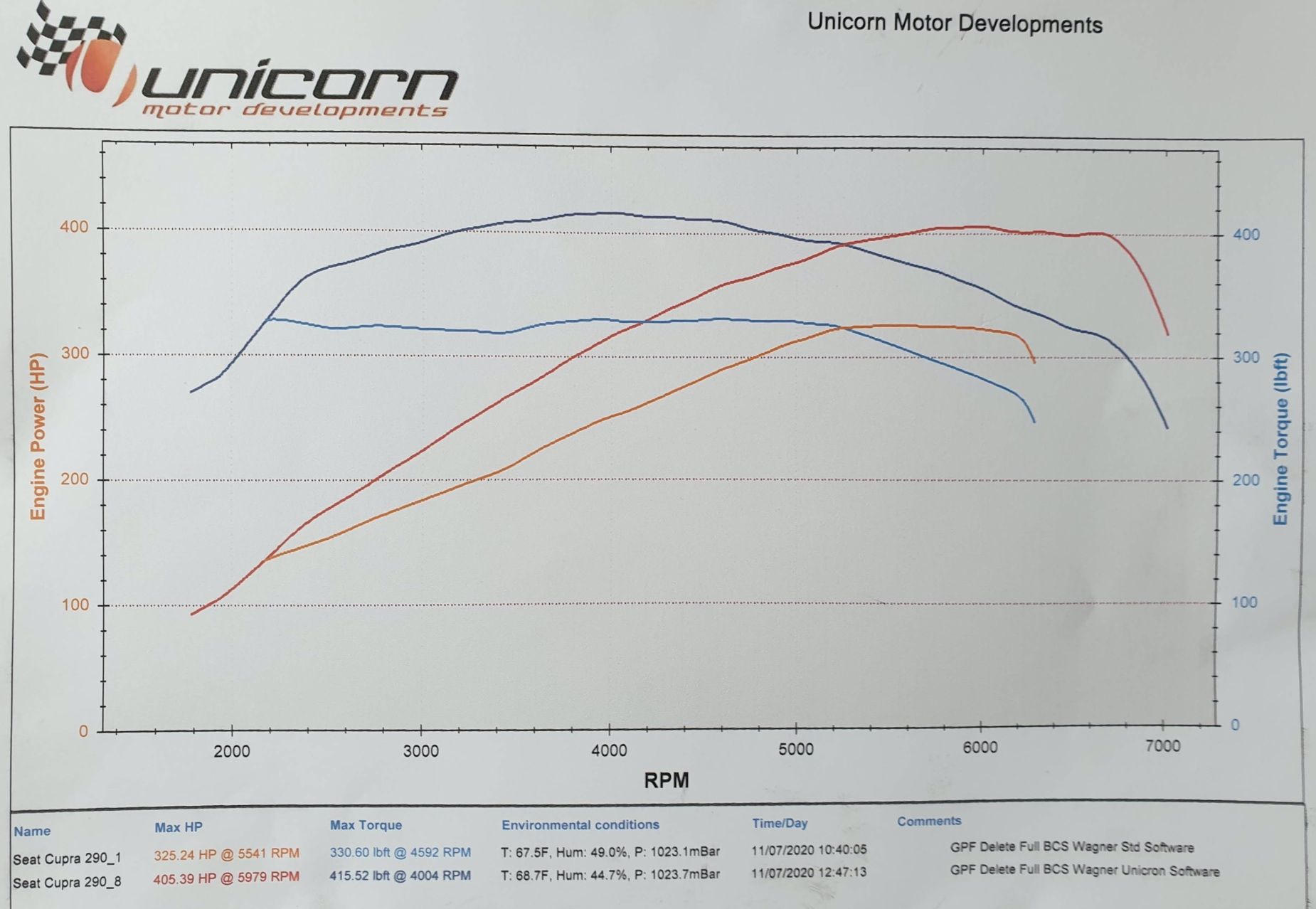

Unicorn Stage 2 ECU Software with DSG Map
All of the mods mentioned above have been building up to this!
I went with Unicorn because of their locality to me (although I would say they are worth travelling for!) and because of their excellent reputation for smooth, powerful maps. I prefer the idea of the map being tweaked for my car on the dyno as Unicorn do, rather than being a more 'off the shelf' flash of the ECU, such as those from Revo and the like.
On the flip-side, the likes of Revo's maps will have been tested on and applied to more cars, in a variety of conditions all over the world. There are definitely pros and cons to each option.
Here are the results:
Unfortunately, I didn't get a run done with the car completely stock, so it was already making good power (325hp, 330lbft) before the software was applied. The official stock numbers are 286hp and 280lbft.
With the map applied, the car pulled an incredible 405hp @ 6000rpm and 415lbft @ 4000rpm. Perhaps more importantly, the car holds over 400hp all the way from about 5600rpm to 6700rpm.
The car has been absolutely transformed and pulls like a train now. You can see from the graph, its not peaky anywhere - it's just a smooth build of power across the rev band, and you can really feel that driving the car. By 3700rpm it is making more than stock power and it just keeps building from there.
I got Unicorn's DSG map at the same time to support this, which increases the clamping pressures, improves the shifts, raises the redline and allows a true manual mode (no automatic up-shift, no kick-down).

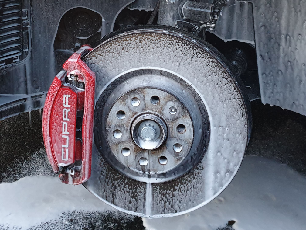

Thanks both :). Good question @Jbrad94 on further mods, to address suspension - I'm leaving it as it is for now, as it drives and corners well from the factory in my opinion. Asethetically, it would be nicer a bit lower, but theres some pretty bumpy roads I have to traverse regularly which make me appreciate the stock height. If I were to upgrade, I'm tempted by full coilovers of some description rather than just springs (I have reservations about how well the dampers will work and last with lowered springs).
Regarding brakes, I agree, the big brake kits look lovely. I am particularly taken by the Reyland kits (AP Racing 6 Pots + 362mm floating rotors specifically), however I am conscious that I am not on an unlimited budget with this car - and am also very much aware that doing one upgrade can make another necessary (e.g. because I have added power, and am going to be using the car on track, I may need to improve my oil and/or water cooling), raising the cost even further.

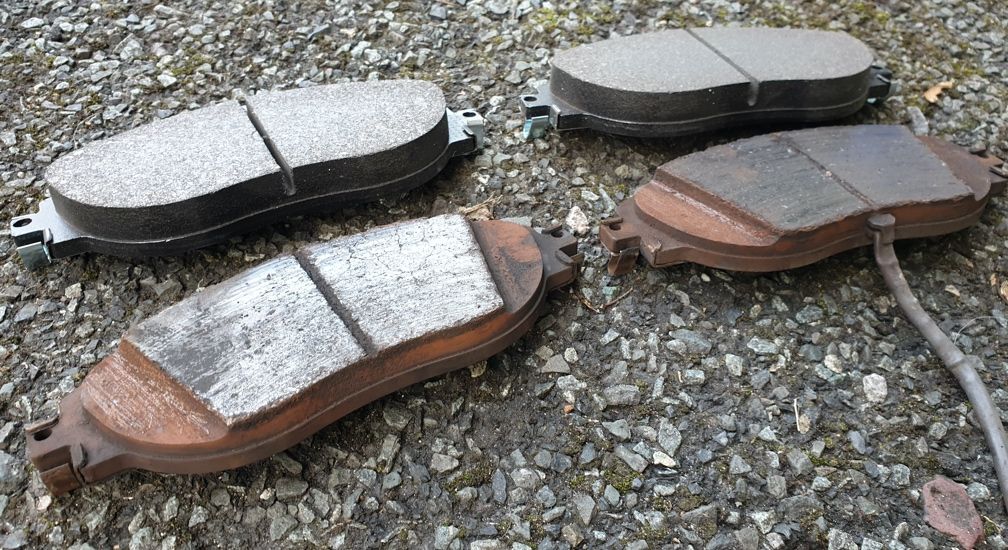

With that said, I do think the stock brakes could be improved, and I needed to replace the stock pads anyway after taking them way outside of their comfort zone and destroying them at Oulton Park (above). Rather than go straight to a BBK, I have decided to see how the stock braking system can perform with some modest upgrades - all of the below has been done both front and rear
Ferodo DS2500 Pads
These pads (part numbers FCP4425H for front and FCP4697H for rear) should offer an increase in performance over the OEM parts, although choosing the right set was really difficult - and I won't know if I have got it right until I have fully utilised these ones.
The OEM brake pads are designed to work well from stone cold - and survive only standard road use. This allows them to be made quite cheaply and still perform adequatly for the majority of customers.
On the other hand, high performance brake pads are designed to survive the hot conditions created on track (with some being fine to 1000c+). The problem with these are is that they are much more expensive, and most are not suited for road use - as they do not work optimally until they have been warmed up.
I needed to find a happy balance with my car doing double duty on both road and track, and so enters the DS2500 pad from Ferodo. This compound offers a better than OEM friction coefficient all the way from 20c to 500c (unfortunately, I dont have specs for OEM to compare - but this should be confirmed by their overall stopping power and resitance to heat).
Additionally, these come with a larger surface area to the OEM pads from the front, which should increase the amount the pads can clamp on the disc, and also help the pad to last longer.
It is worth noting that these do not come with a wear sensor. To avoid a warning light on the dash, I cut the plug off the old pads and joined the wires by hand, then reconnected to the plug on the car - easy job. I also had to use Carista to fully release the rear electronic parking brake - which is important to avoid damaging the mechanism when replacing the pads.
To confirm, I am still using the original discs that came on the car, as they still have life in them. I have inspected them for wear/cracks, and cleaned them up - before bedding in the new pads.

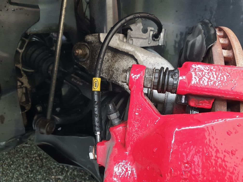

HEL Braided Brake Lines
Braided brake lines (part number SEA-4-209 used here) are a nice mod to do for any car driven hard. Whilst the brake fluid runs in hard lines all the way out to each wheel, the final leap from the chassis to the caliper must be done by a flexible line for obvious reasons (the caliper can move up/down/left/right relative to the chassis).
The OEM lines are rubber, cheap for the manufacturer and perfectly adequate for most drivers. The problem with this is that they can expand under hard braking, creating a softer pedal and reducing the pressure that actually gets transferred to the brakes.
Braided lines are still flexible, but a metal sheath stops them from expanding under pressure, creating a more direct braking feel, and allowing all pressure to get to the brakes. Their hard outer coating also improves durability over time vs rubber lines.
Motul RBF660 Fluid
The car is almost two years old, so it was sensible to replace the fluid anyway, but it was a necessity after replacing the lines and letting air in to the system. After doing a bit of research, I decided it worthwhile to replace the brake fluid to a more performance oriented specification OEM.
I'm not sure of the exact OEM specs, but to meet the DOT 4 specification, the dry boiling point (when the fluid is brand new) has to be at least 230c, and the wet boiling point (when the fluid has aged and absorbed water) 155c. Whilst I didnt boil earlier this year at Oulton, the ambient temps were cool and I may have been pushing them close to the limit. Boiling brakes are dangerous brakes (gas compresses, so when you press the pedal - all it does is compress the gas rather than press the pads against the caliper), stopping you from... stopping.
All of my research pointed to Castrol React SRF as the best, but it is very expensive. May be worth it in a BBK but with my stock brakes, I felt it overkill.
The next best seemed to be Motul's RBF range, available in a few different 'grades': 600, 660 and 700.
The key specs compare as follows:
NameDry Boiling Point (C)Wet Boiling Point (C)
Castrol React SRF310260
Motul RBF 600312205
Motul RBF 660325204
Motul RBF 700336205
I opted for Motul RBF660 as it was practically the same price as RBF600, whilst 700 was a jump up in price (for a minor spec bump I probably wouldnt use) and Castrol SRF as mentioned above is way more expensive.
I used a pressure bleeder kit to bleed the fluid and found it both easy and efficient to use, well worth buying and will hopefully serve me well for many changes to come :).
As an overall comment for all of these upgrades together, I can tell you that the brakes now feel sharper in initial bite, and the pedal is firmer when stepping on them hard. I look forward to giving them a proper go at the track.

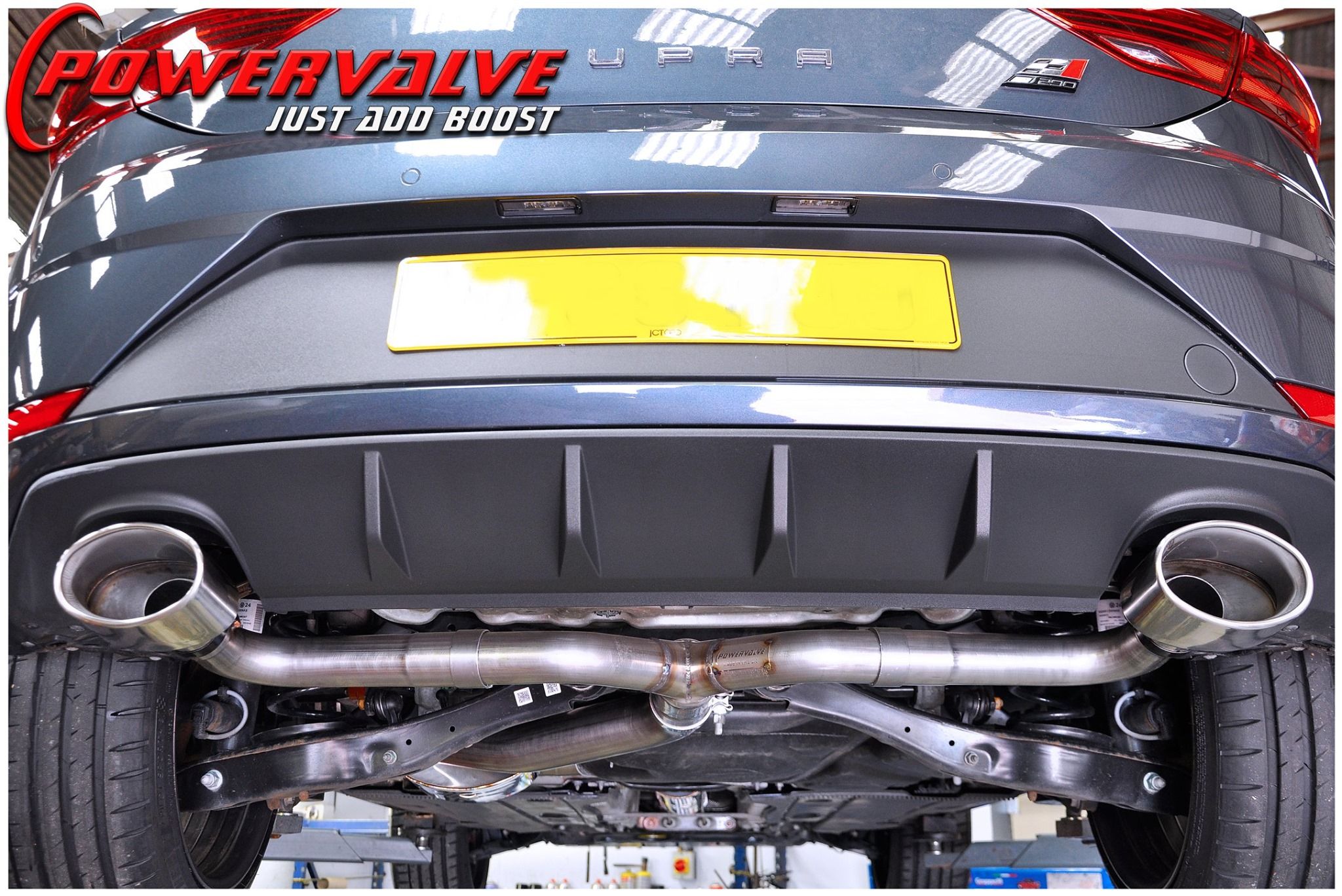

BCS Powervalve have recently took some clips to show off the new exhaust: http://instagr.am/p/CDThmVZHRpc/ Their photos look great too - heres a few:

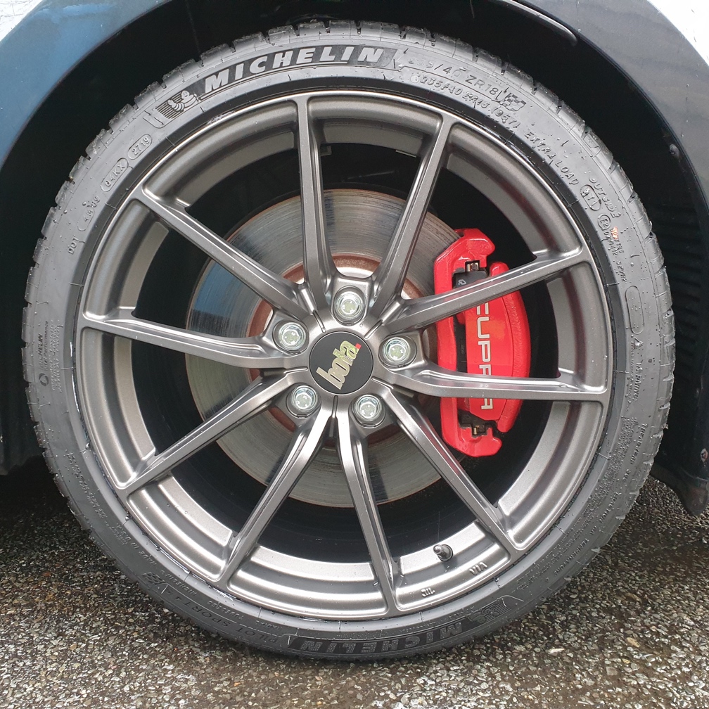

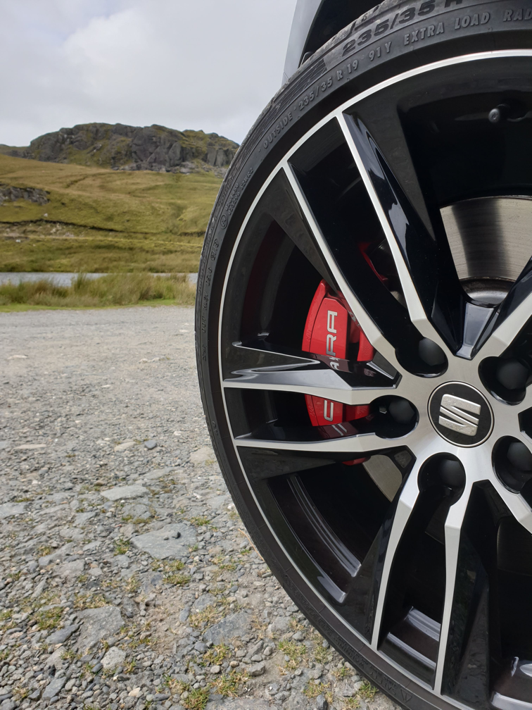

In other news, I completed my 2nd track day on Saturday, this time at Blyton Park. Even though it's a short track I was still able to utilise the cars new found powahhhh. It sounded sublime too, you can really hear the difference between my Oulton Park clip (posted above) and the lap from Blyton:
Overall, the car has come a long way since Oulton, and the best part is it doesnt feel compromised at all for day to day use.
The lightweight wheels and PS4S's made a difference, but you can tell the car would really benefit from a proper semi slick when on track.
The brake upgrades have provided a nice boost in stopping power, and the DS2500 compound seems to have held up much better with no noticeable fade in the stint lengths we wanted to do. Again though, you can tell a BBK would provide a lot of benefit.
Things got so hot around the brakes that I was able to melt my centre caps (only 1 survived) and valve caps (only the rears survived). I will run future days with these removed.
The engine didnt skip a beat, though even with short stints, oil temparatures were able to reach 127c, and water temps 110c (note that the standard read out stayed at 90 for water, you have to use an OBD reader to get the true temp). The Nanodrive oil I am using is rated to 125c operating / 150c max so the temp seen was not too scary.
I am starting to research and consider aftermarket cooling options for both the engine and DSG (I couldnt find a read out for DSG temp but I would presume it got just as toasty).
On track fuel economy is down from c.10mpg at Oulton (standard power) to 7.5mpg here (modified power)... no real drama but you do have to plan for it.
As a final note, I'd like to give a shout out to Carbon Collective for their Platinum Wheels product, I used this to coat my wheels from new, and it made the removal of the thick coating of brake dust after Saturday an absolute breeze, no scrubbing required.
