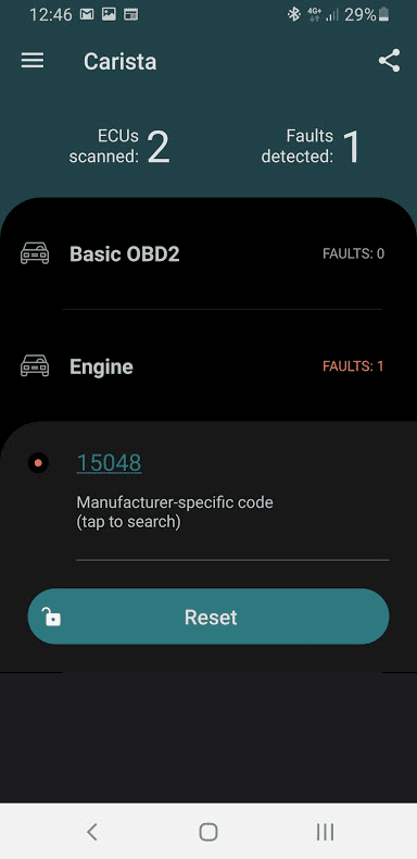

Additionally, I have found one engine fault code when scanning with Carista (15048) - I can't find any details for this online. There are no warning lights on the dashboard.
