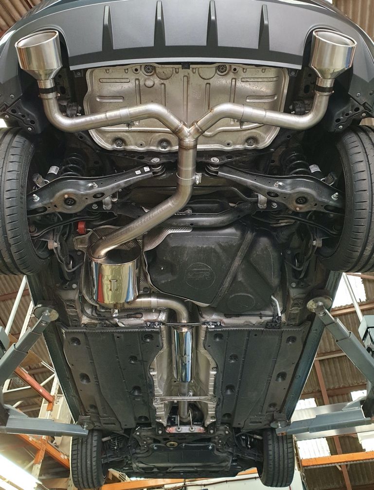

I think its fair to say that the exhaust note on the newer GPF equipped cars is muted, and, whilst I'm not a fan of really loud exhausts, I did want something with a bit more character.
I researched the usual names (Milltek, Scorpion etc), and whilst the products seemed OK, I'd picked up mixed reviews of the quality of their products.
Whilst looking, I saw some posters mentioning BCS Powervalve Exhausts, although I hadnt heard of them, I couldn't find a bad word about them or their products. Their prices are very competitive for the quality on offer. After a few detailed conversations, these are the guys I went with to build and fit my system.
The options you can get (and my choices) are as follows:
Valved or Non Valved -
  • A valved system is the party piece in BCS's offerings. Unlike similar competing products, which are controlled by an electrical switch, the BCS system opens and closes based on how much boost the turbo is generating.
  • They also offer non-valved systems, which are like a normal sports exhaust, and a bit cheaper.
  • I went for valved and am blown a way by how well it works, it is as quiet as OEM on the motorway but opens up the sporty sound when you put your foot down.
Presitge, Sport or WRC -
  • This is the sound profile, prestige being the quiestest (two fairly large silencers), WRC being the loudest (straight through), and sport offering a happy medium of the two.
  • This is purely going to be down to personal preference, I went for the prestige system because I prefer a more subtle note, and also need to ensure I stay within noise limits for track days.
  • The system sounds nothing short of amazing. It's deeper than the stock exhaust, and has much more range in the sounds it will make, you can hear more of whats going on at the engine, without it being overly loud or droney.
Decat, 100 or 200 cell catalytic converter -
  • What you go for here really depends on your car and how you use it, I didn't consider the decat option as my car is a road vehicle first and foremost.
  • The choice between the 100 and 200 cell cats is based on how far you want to push the power envelope, both should pass MOT emissions tests, but the 200 cell will get through it a bit easier. The downside of the 200 is that it creates a little bit more restriction, vs the 100 cell which in theory flows just as well as a decat (BCS can explain the science of this to you if you are interested!).
  • I went for the 100 cell.
Downpipe wrap -
  • An optional extra is having the downpipe covered in a thermal wrap. The purpose of this is to keep the heat in the exhaust and out of the engine bay, allowing the engine to breathe cooler air and perform at its best for longer. It's a nice to have and not something that is needed.
  • I opted to have the wrap as it's not too expensive, looks great in the engine bay and should give some performance benefit.
Tips -
  • The final option is what tips you have on the exhaust, BCS will talk you through the options suitable for your car, there will be something to suit any taste (round/oval/single/double/quad/black/silver etc).
  • I went for ovals, which are effectively a bigger version of the stock design for my car. There was obviously a lot of attention to detail in this (in the whole system to be honest!), the guys were talking about how they worked out the shape and the angle of the exit, to compliment the lines of the car. It really does show in the finished product - which lines up perfectly with the OEM rear bumper, and looks great from every angle.
As a final word on the exhaust, I'd highly recommend BCS to anyone, both the product and their customer service is top notch. The guys are clearly enthusiastic about cars, and will treat yours with the same care as they would their own.
Here are a couple of pictures to show off the system.
My next post will be about the software changes made to my car, to compliment the hardware changes already mentioned ;)
Couldn't agree more about the quality of the exhausts and the customer service provided by BCS, top quality all round.

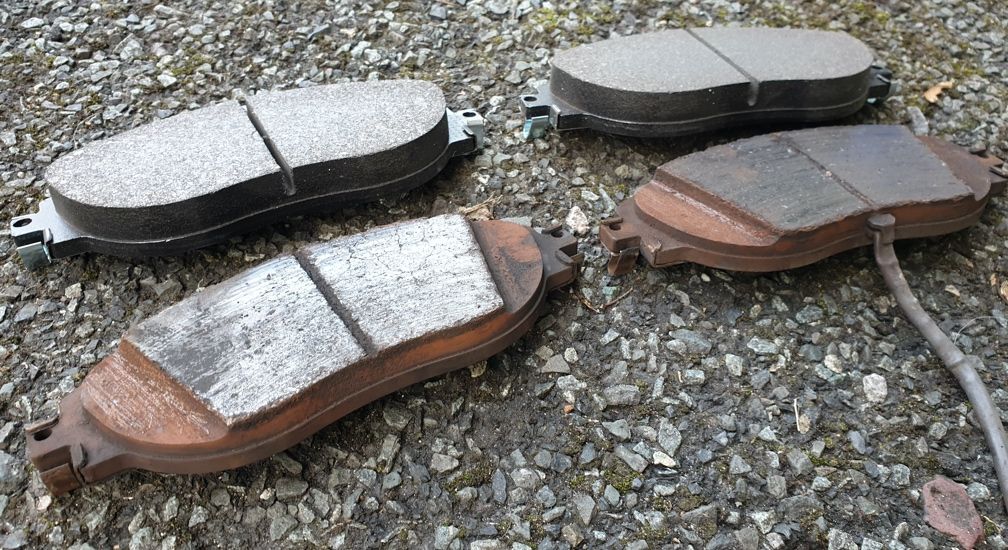

With that said, I do think the stock brakes could be improved, and I needed to replace the stock pads anyway after taking them way outside of their comfort zone and destroying them at Oulton Park (above). Rather than go straight to a BBK, I have decided to see how the stock braking system can perform with some modest upgrades - all of the below has been done both front and rear
Ferodo DS2500 Pads
These pads (part numbers FCP4425H for front and FCP4697H for rear) should offer an increase in performance over the OEM parts, although choosing the right set was really difficult - and I won't know if I have got it right until I have fully utilised these ones.
The OEM brake pads are designed to work well from stone cold - and survive only standard road use. This allows them to be made quite cheaply and still perform adequatly for the majority of customers.
On the other hand, high performance brake pads are designed to survive the hot conditions created on track (with some being fine to 1000c+). The problem with these are is that they are much more expensive, and most are not suited for road use - as they do not work optimally until they have been warmed up.
I needed to find a happy balance with my car doing double duty on both road and track, and so enters the DS2500 pad from Ferodo. This compound offers a better than OEM friction coefficient all the way from 20c to 500c (unfortunately, I dont have specs for OEM to compare - but this should be confirmed by their overall stopping power and resitance to heat).
Additionally, these come with a larger surface area to the OEM pads from the front, which should increase the amount the pads can clamp on the disc, and also help the pad to last longer.
It is worth noting that these do not come with a wear sensor. To avoid a warning light on the dash, I cut the plug off the old pads and joined the wires by hand, then reconnected to the plug on the car - easy job. I also had to use Carista to fully release the rear electronic parking brake - which is important to avoid damaging the mechanism when replacing the pads.
To confirm, I am still using the original discs that came on the car, as they still have life in them. I have inspected them for wear/cracks, and cleaned them up - before bedding in the new pads.

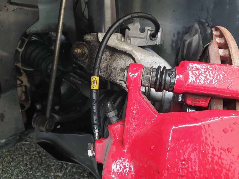

HEL Braided Brake Lines
Braided brake lines (part number SEA-4-209 used here) are a nice mod to do for any car driven hard. Whilst the brake fluid runs in hard lines all the way out to each wheel, the final leap from the chassis to the caliper must be done by a flexible line for obvious reasons (the caliper can move up/down/left/right relative to the chassis).
The OEM lines are rubber, cheap for the manufacturer and perfectly adequate for most drivers. The problem with this is that they can expand under hard braking, creating a softer pedal and reducing the pressure that actually gets transferred to the brakes.
Braided lines are still flexible, but a metal sheath stops them from expanding under pressure, creating a more direct braking feel, and allowing all pressure to get to the brakes. Their hard outer coating also improves durability over time vs rubber lines.
