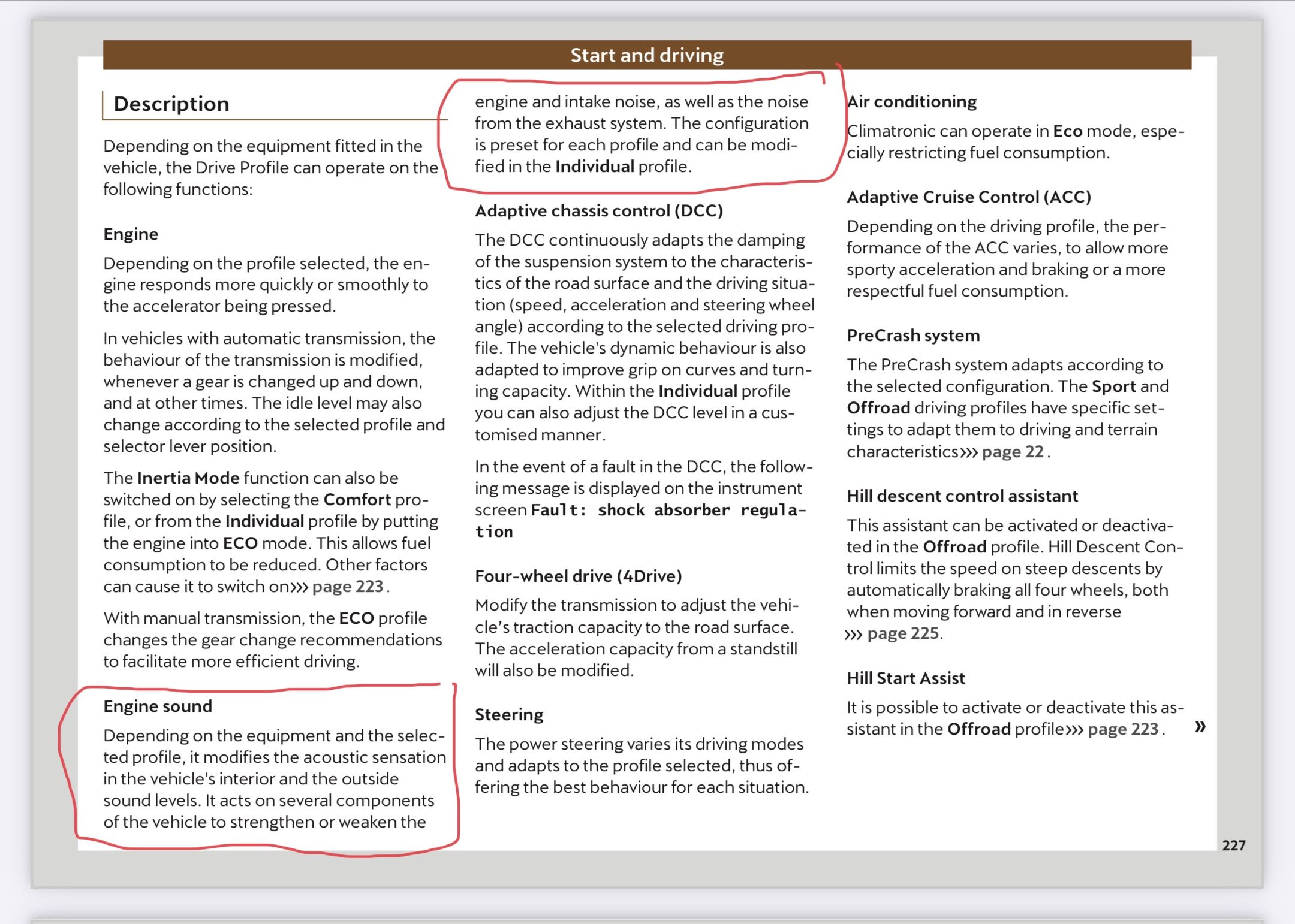

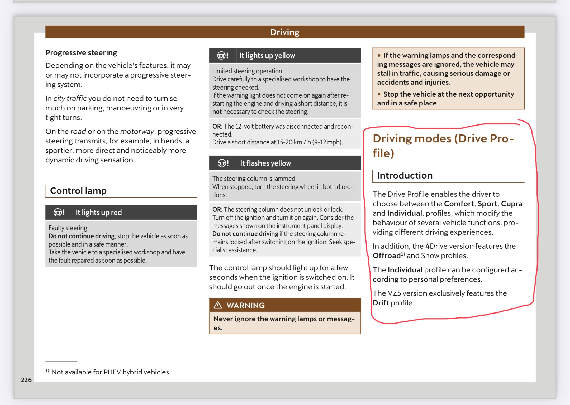

My VW has a soundaktor. I hate the fake engine noise but I have the option to reduce its volume in the car’s driving mode selections. Within ‘individual’ driving mode, I have three options for engine sound; sport, normal or eco; selecting ‘eco’ reduces the soundaktor volume to a level that IMHO isn’t at all obtrusive and I don’t even notice it (it’s the only thing that’s set to ‘eco’ in my car ? - did it on the day I got the car three years ago and it’s stayed that way ever since!)
@vectra - According to the owner’s manual, the Formentor also has selectable driving modes and it’s possible to adjust / turn down the soundaktor volume; see screenshots of the relevant pages (226-227) from the June 2021 version of the owners manual (maybe different page numbers in different print versions of the manual). Turning the volume down - or if it gives you the option in the Formentor, switching it off completely- is the answer to your prayers!
