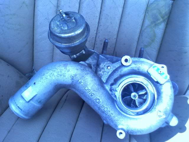

hey guys just looking for some advice thinking of buying this turbo but im not sure the blades look bent but some people say on some ko3s's they are like that
it may be fine in the sense of turning it into a hybrid if it's just the turbine that is bent and the housing is fine i.e. no cracks etc
although if the turbine is that bent....the housing and rest of the turbo would have taken quite a beating and would have been quite stressed, so best avoid the unit all together
