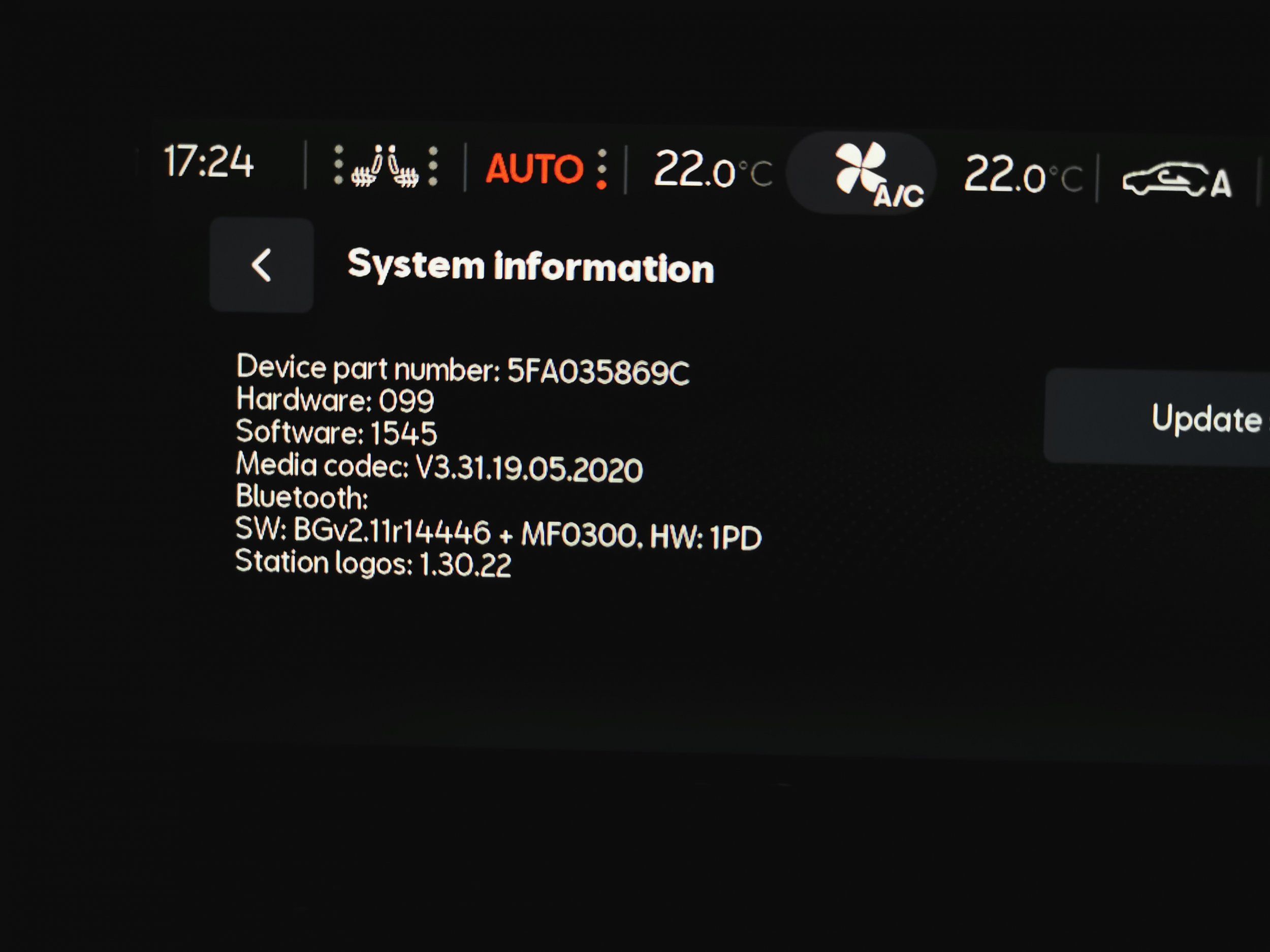

please take a photo of your system information radio. Your system has nothing to do with the 1969 update you know about
This is the picture. On the update menu, it says it is the last version, but as I read on this forum, there a lot of up to date, but they are 3-4 versions behind, at least. So I don't trust that
I see blank for bluetooth, but it is working just fine with my phone. I also use Seat connect, if it matters in any point.

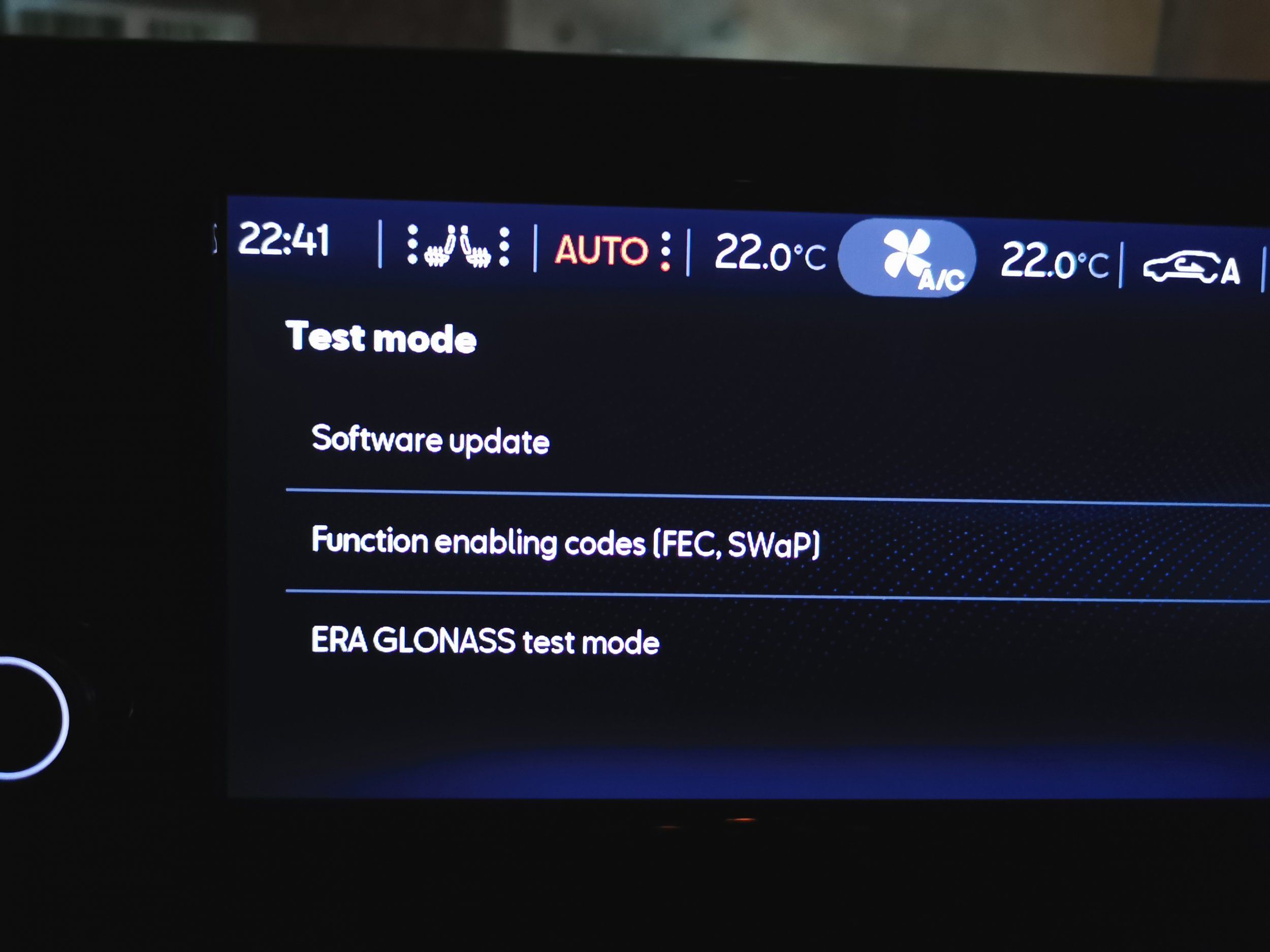

thank you, please press the menu button until you get to the hidden service menu, then click on update and state the exact firmware name or take photos please
This is the menu I got and the second screen for software update. Nothing to scroll for the second picture
In the service update menu is trying to search for an USB, but is nothing connected, so ...
PS: On the menu button, does nothing when I keep it pressed, the only "hidden" menu is on the button with the car on it, pressed for 5 seconds I think
