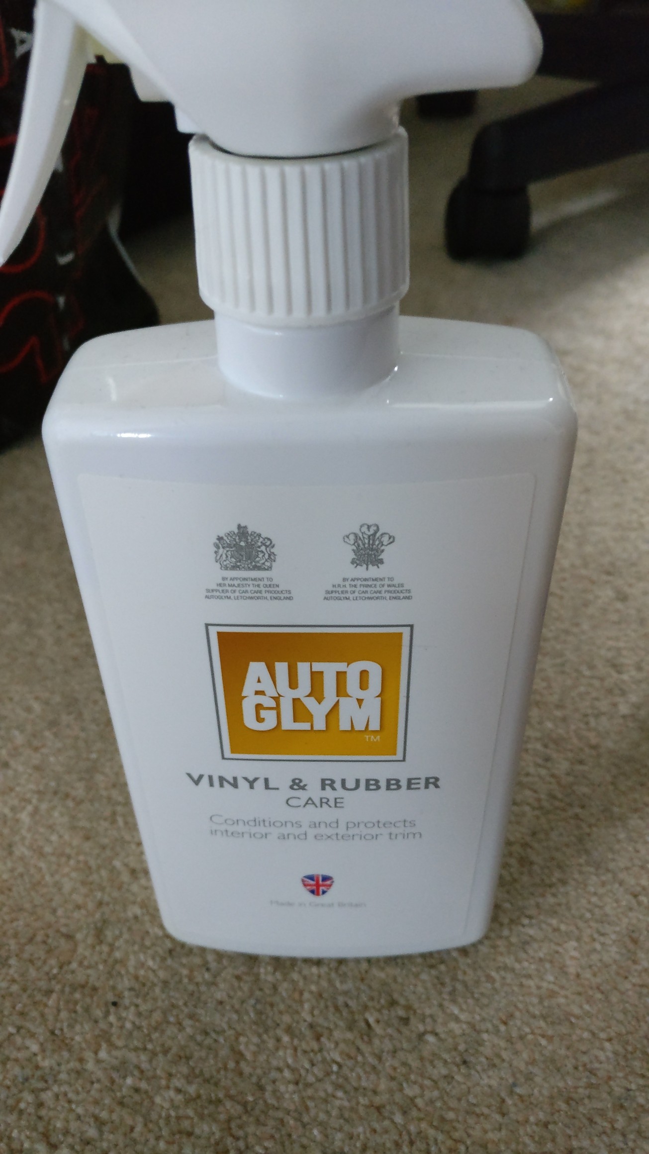

Do you treat your seals at all when you clean them? Maybe they're dry and not sealing correctly? There is many things to try but I used to use this and it worked pretty well. I just started using something else but it's too early to tell if it's working...
