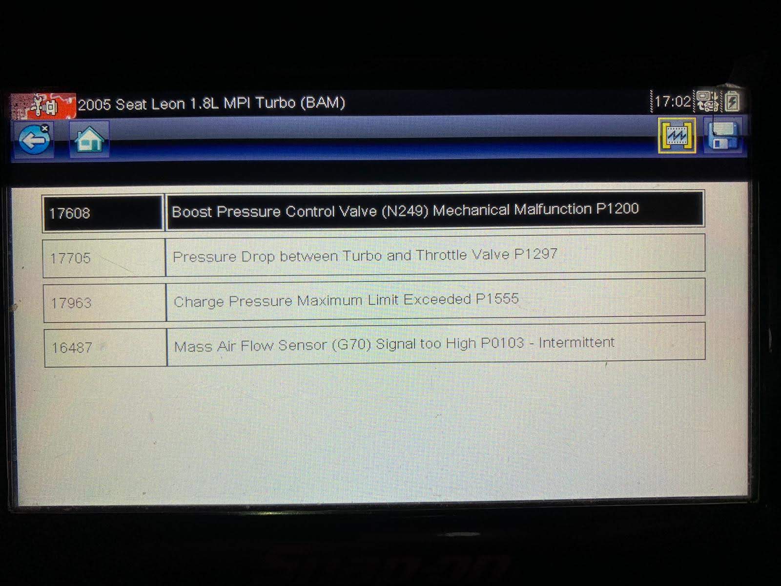

What are your fault codes?

Explains the limp mode coming in.

If it's the 17705 code then it should only happen from a cold start, and if you turn the ignition off and back on again it should come out of limp mode. If it happens from a warm start or happens again after cycling the igniton on and off, then it's something else.
As others have said, 95 octane won't cause limp mode, but the ECU will pull the timing back and you will lose performance. Even the standard engine should be run on V-power or other 99 octane fuel.

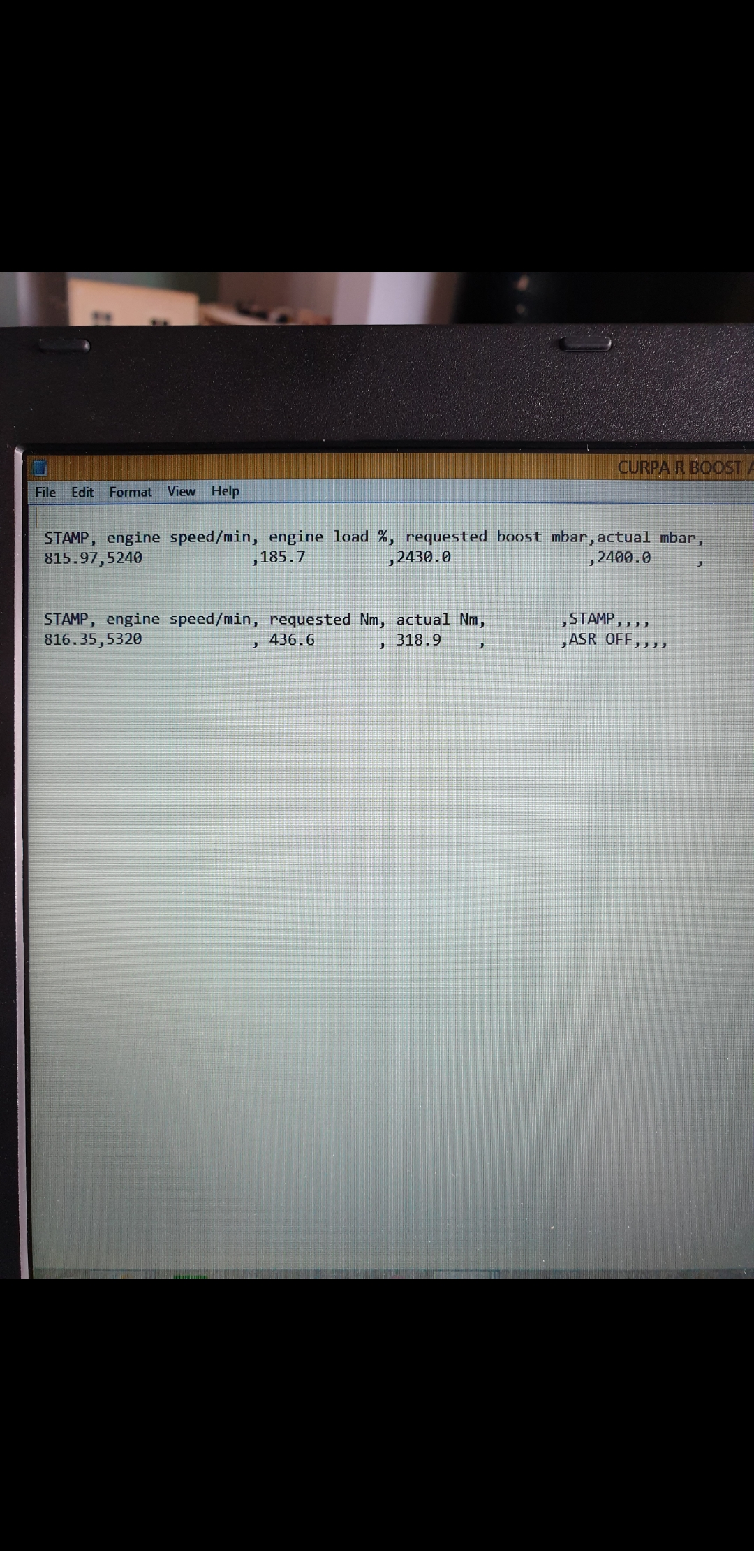

Hi guy's, been round the houses with this as I'm sure many of us have. Just an update and after some advice if possible. Changed n75 seemed a little better then started going back in to some sort of limp mode that it wouldn't come out of. Done diag at work misfire detected on 1 and 4 so changed plugs and coils as it was starting to stumble. At the same time took throttle body off and cleaned also replaced vac hose under the inlet manifold cleared codes. Seems to be running better and no surging on boost. Got vcds running again and took measuring blocks 115 & 120 and logged it. Couldn't make a graph out of the data as no excel on laptop so have extracted some and image attached.
Could anyone tell me if this is standard boost as it seems to be high I calculated it at just over 20psi??? Has it been remapped?
