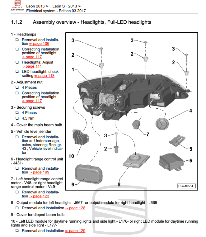

Ballasts are used on xenon headlights to give them a power surge to start up. SEAT refer to them as modules, and there's one for the DRL and one for the headlight. Not sure, but they may have to be programmed into the car to work. Are you able to swap the module(s) over from your old headlight, or are they damaged?

I'm not sure if they need reprogramming, but it was a thought as they're modules. Have a look under the 'Sponsors' section and contact East Yorkshire Retrofit Solutions. He'll be able to give you spot on advice.
Where you got that
Where did you get that image manual instructions??? And could you get more of different cars (seat)
