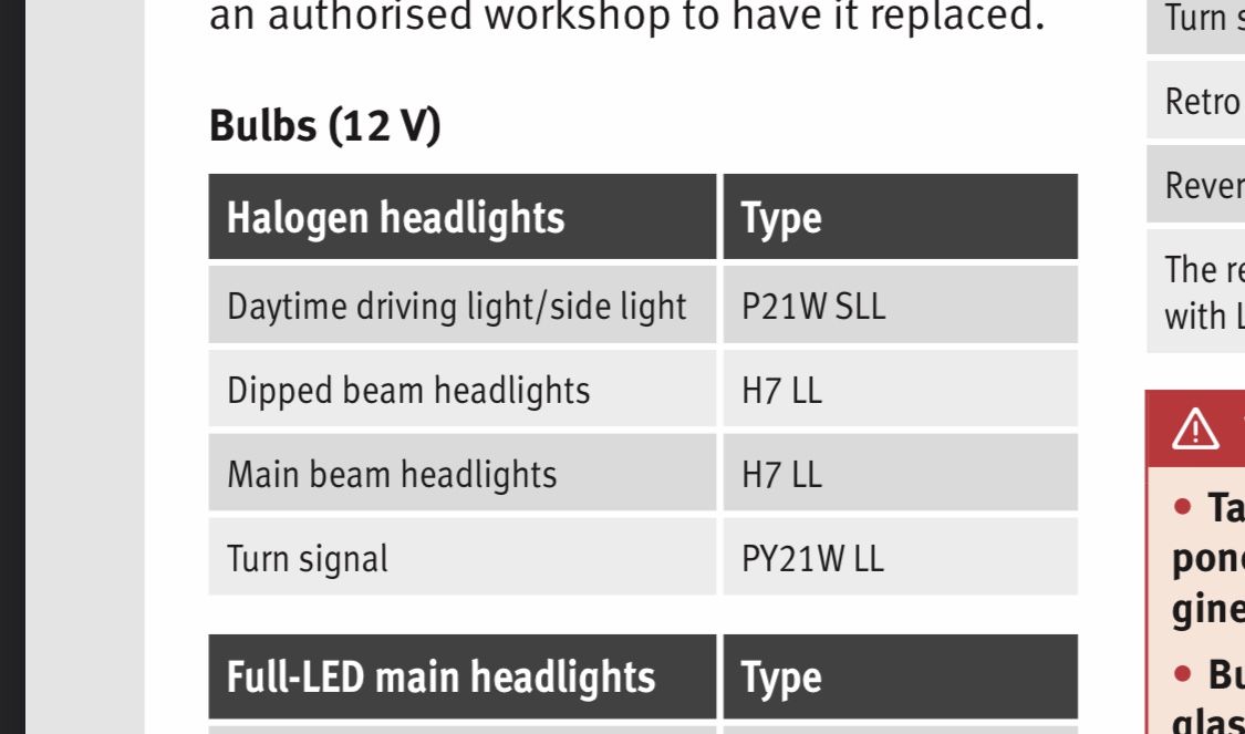

But I’m unsure if these will fit my car according the fitments in the manual

P21W is a totally different package and wattage to the 5W5 lamp you link. When retrofitting LED you also need to consider the available space - LED is usually bulkier/longer then the original lamp.
That site has several canbus P21W DRL lamps available, I'd suggest you first have a look inside the housing, to see how deep the lamp is set before choosing one.
