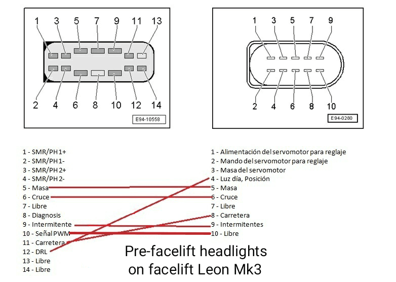

this week I purchased a set of LED headlights for my Leon (currently with halogens). There was a thread previously where someone changed fl halogens to pfl led lights (picture below). I’m wondering if the pinout of the pfl base headlights are the same as the facelifted one? I know that the LEDs are different but not sure about the halogens..
