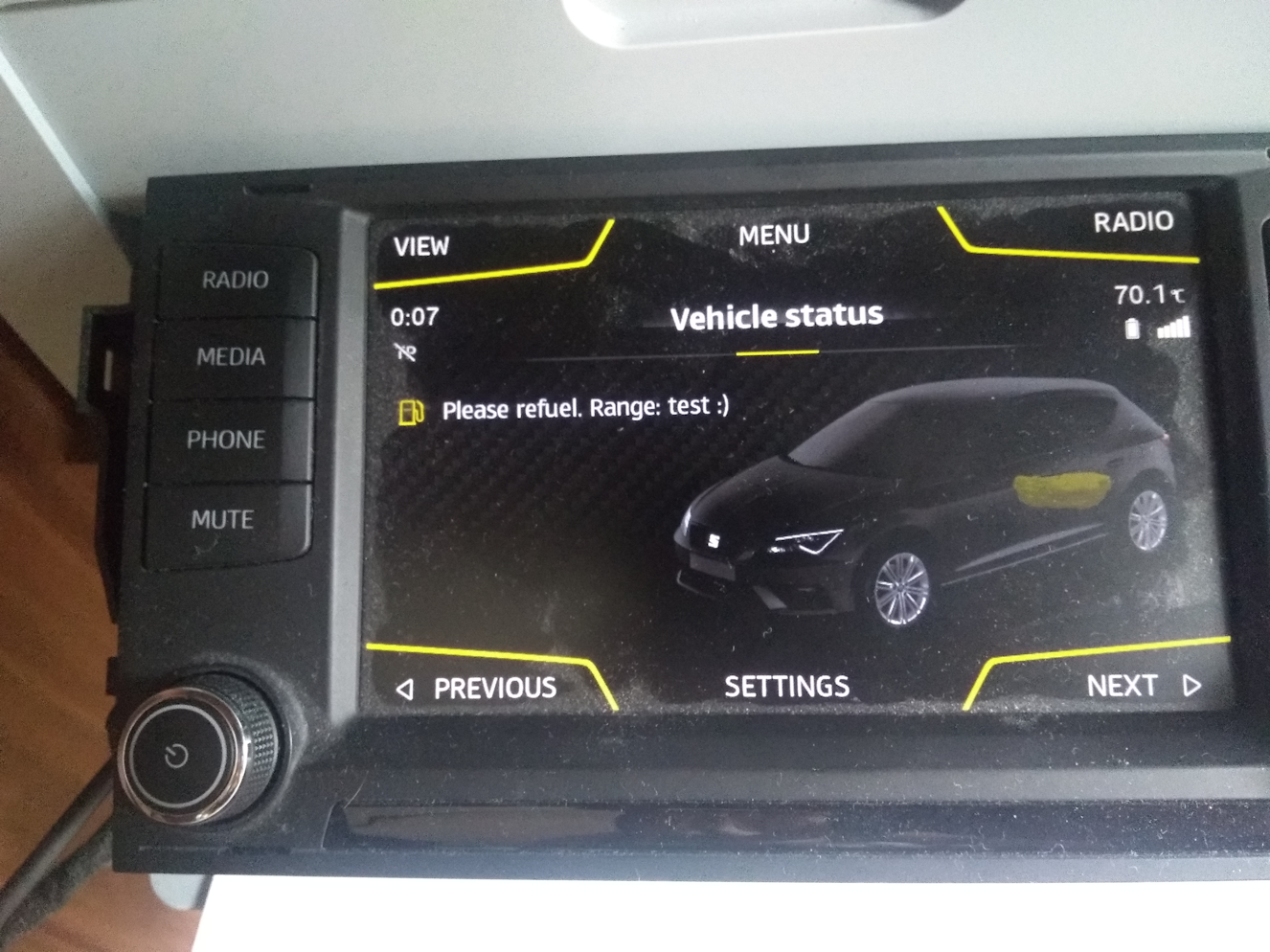

At the moment I am still working on bluetooth integration to MFA+ cluster, but on new functionality "vehicle status faults" too.
Vehicle status is main part of the mqb mib unit system so I want adopt and visualise system faults from PQ car to MQB unit.
Low fuel warn is working now :)

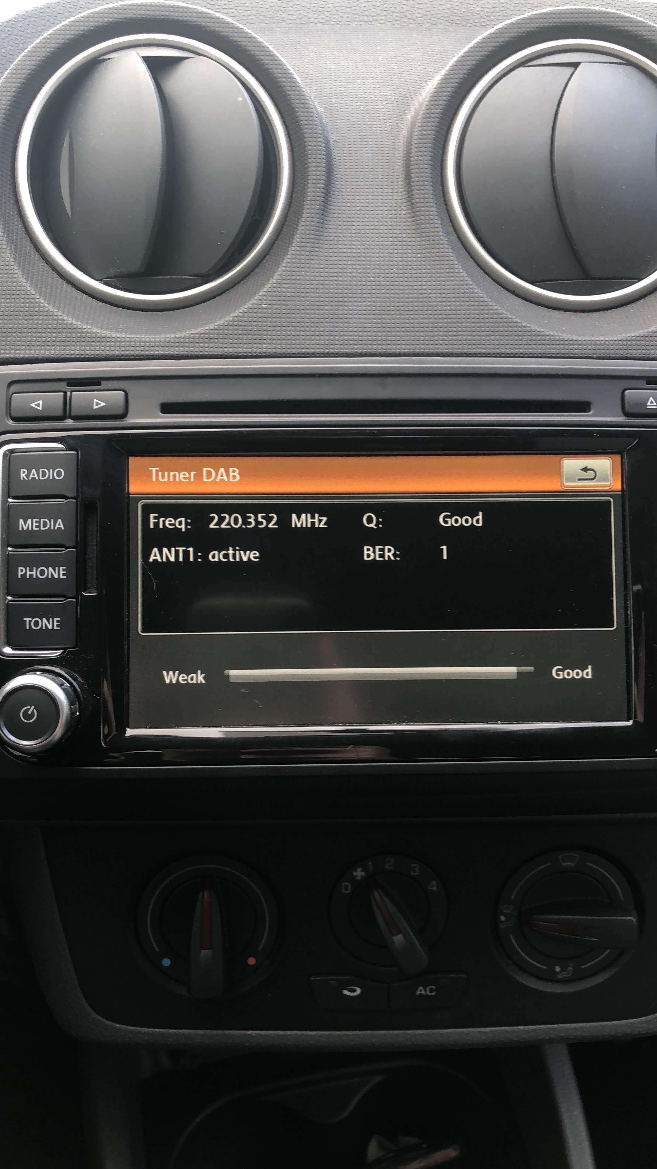

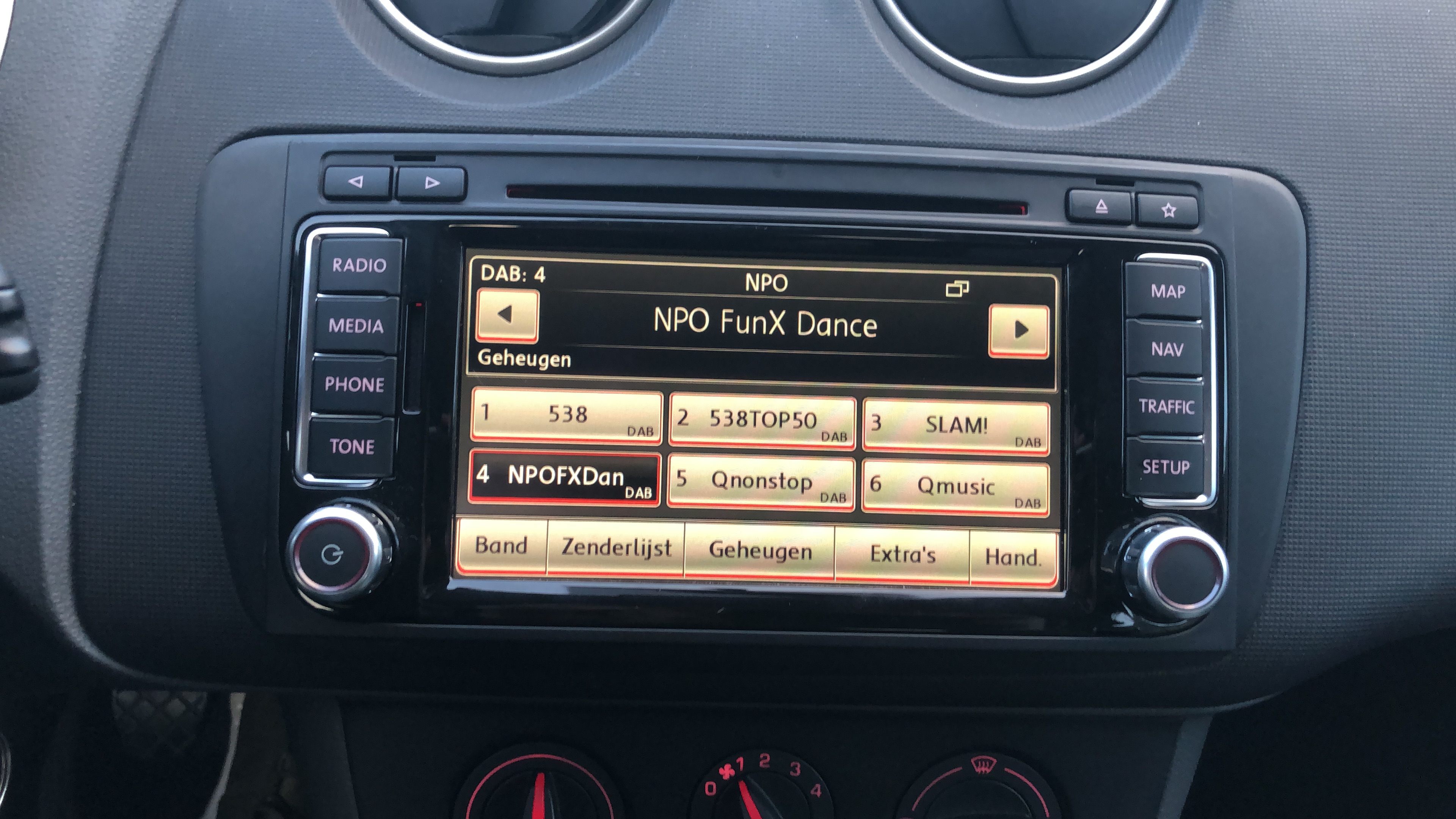

Very nice but not a easy mod. I have modded a RNS 510 (with DAB+) from a Toureg in my Ibiza. I have installed a MDI with bluetooth and a rear view camera on it. Everything works fine and 100% with the steering wheel unit by the steering wheel

The RNS platform starts from 2008 and is not very modern now these days but it is fully functional and not that hard to install. The only thing that that is stopping Ibiza 6j drivers to install a decent radio/navigation is the freaking odd dashboard. There is absolutely no good alternative for the OEM stereo. Here in Holland some guys modded a RNS 315 in it by cutting out the dashboard.
