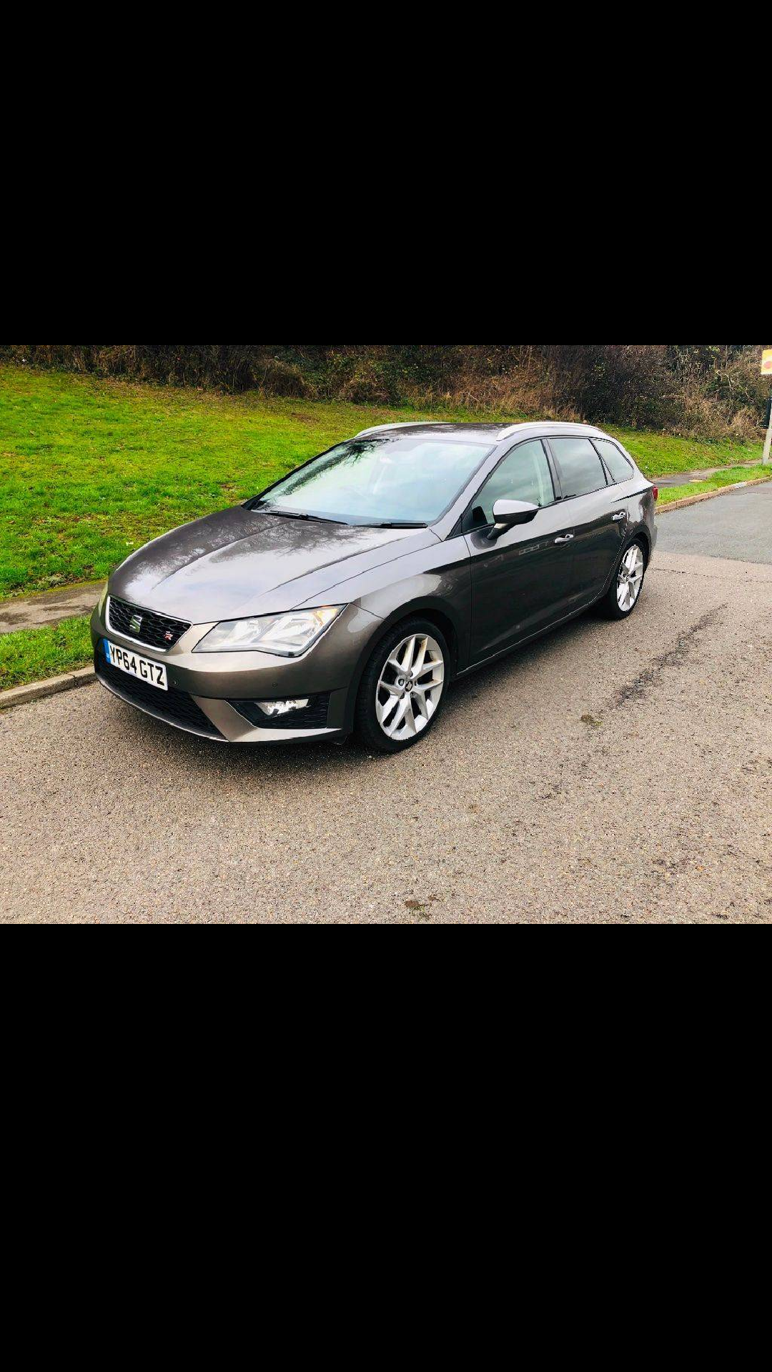

Hi all ex mechanic of 15 years and always been into my cars, this is the first form I have been a part of and first ever log of my car/plans and updates, I will try and post as much as I can

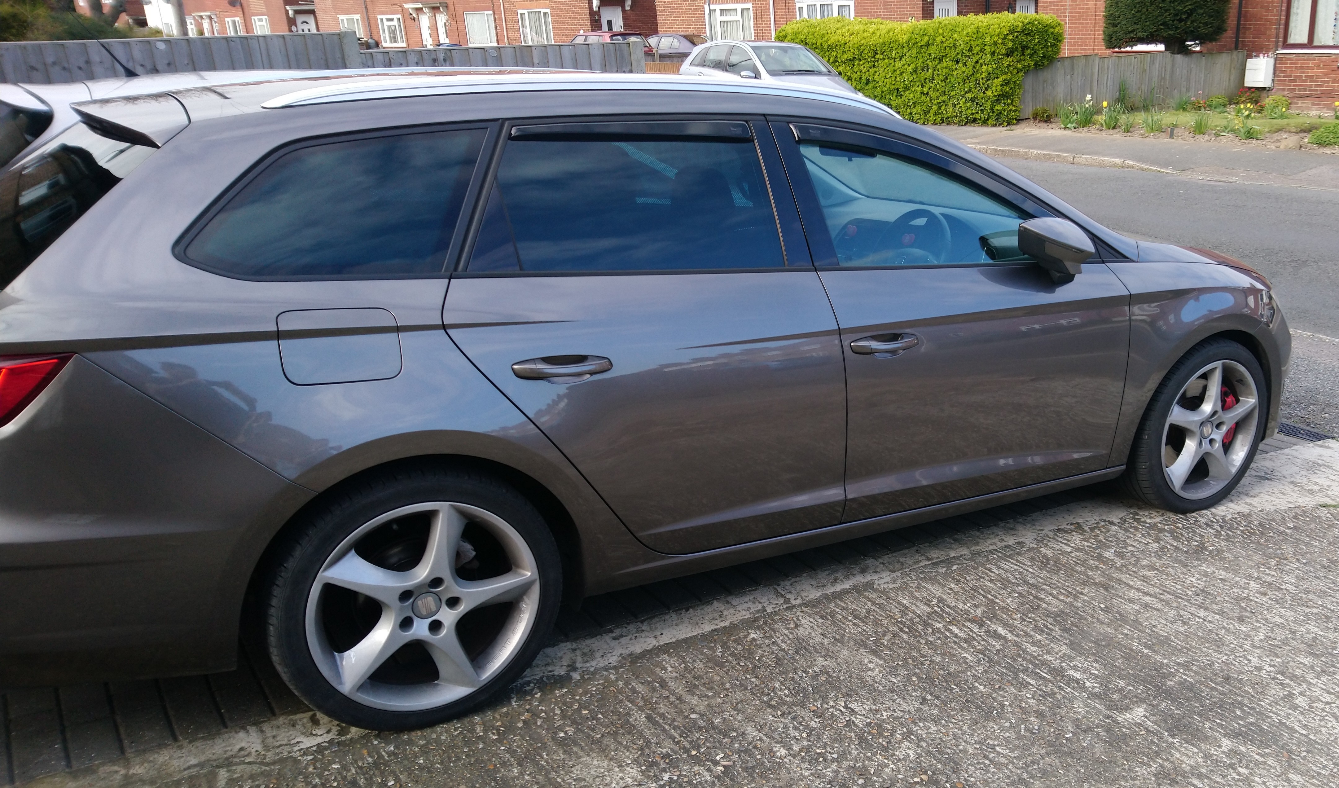

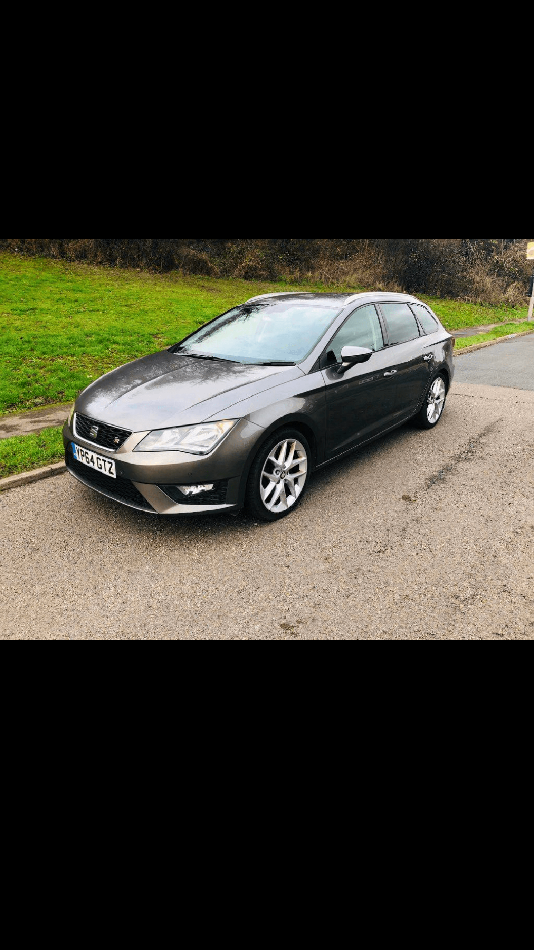

Down to the car, I brought a 2014 leon st fr (150bhp tdi) slight high mileage of 160k but with what's planned I'm not fussed with this, and the price I paid I definitely got the deal I wanted,
First things I done was to put my wheels from an old car on nothing special but all good tyers so why not, sizes are 18" with an 8j front 9j rear and et of 45/42 I think

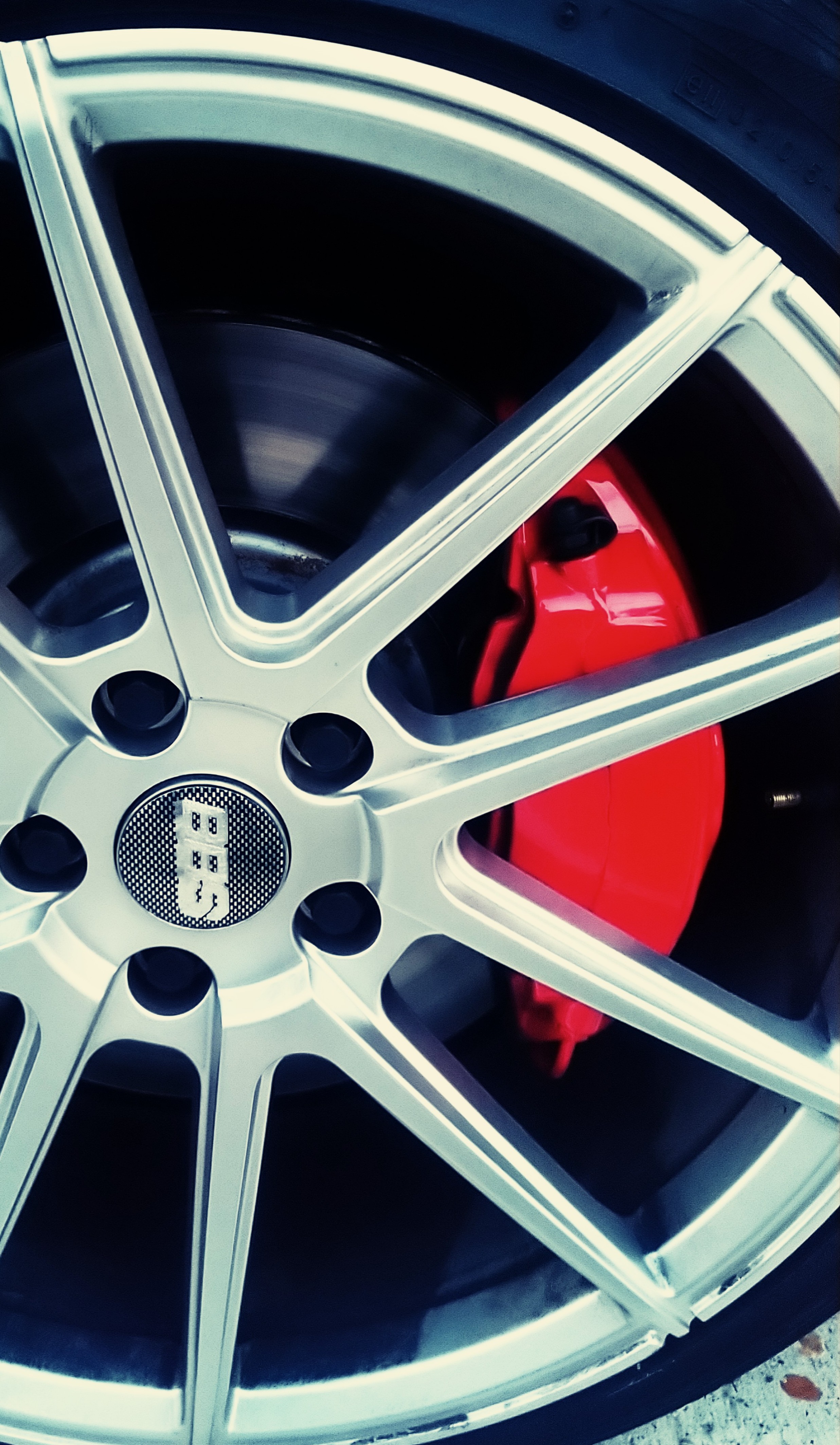

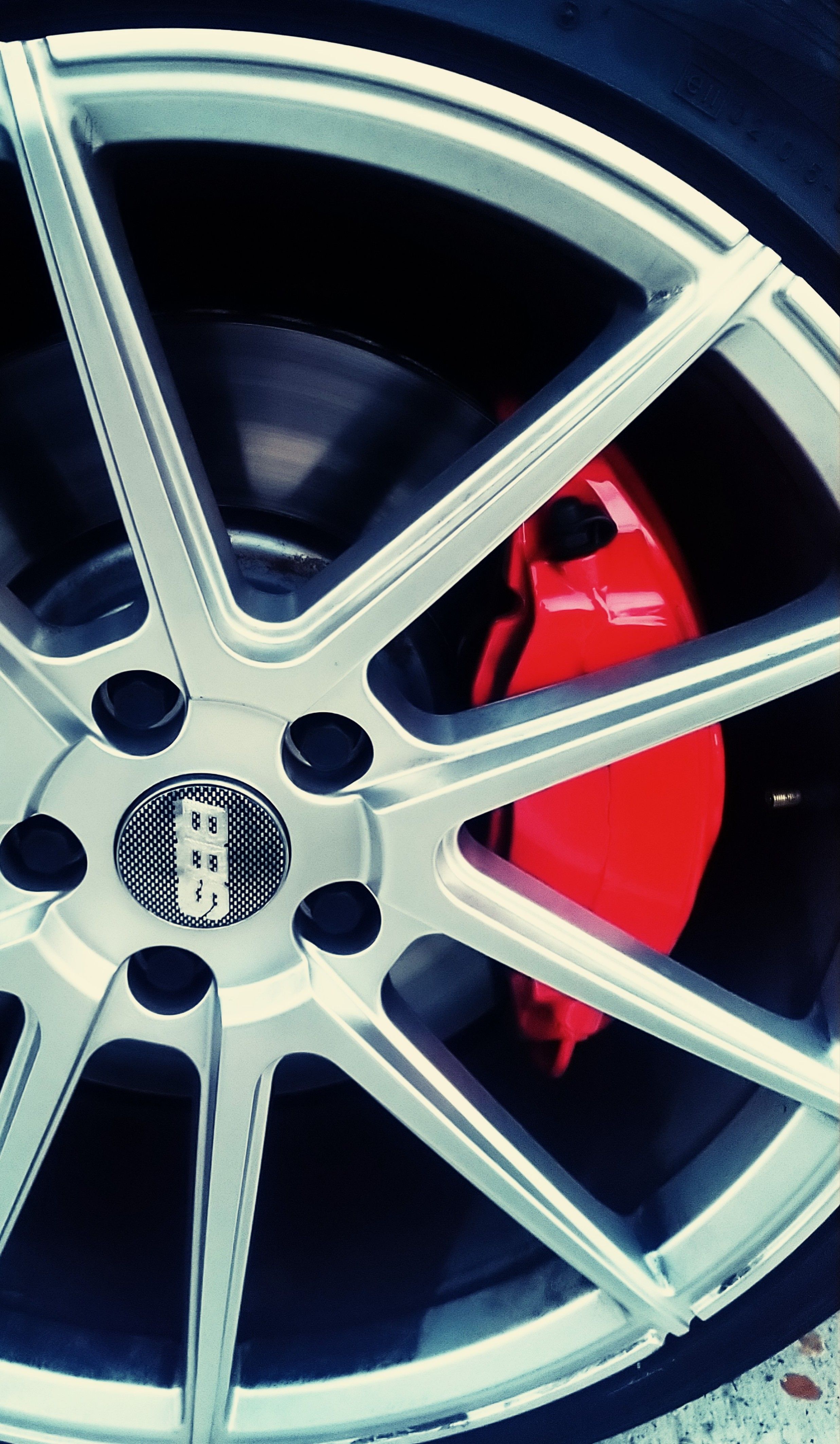

Next up was stopping the car I had previously had brembo 18z on a different car a gd Caliper for the price but I didn't want something so big and to be honest after running for 2 months front discs was worped so If your looking for a Caliper just for looks then it's OK, if you want stopping power I'd look else where, so what I did with the leon I went down the route of a brembo 4 pot from the audi ttrs running a 340mm disc, this kit come with a nomal brembo disc which I have used but once I need to replace I will be going for the club sport disc's with a saving of 900g per side, rears are stock 232mm soild disc, I do have a set of 310mm vented rear setbut not fitted yet, and have gone to a 5.1 dot brake fluid

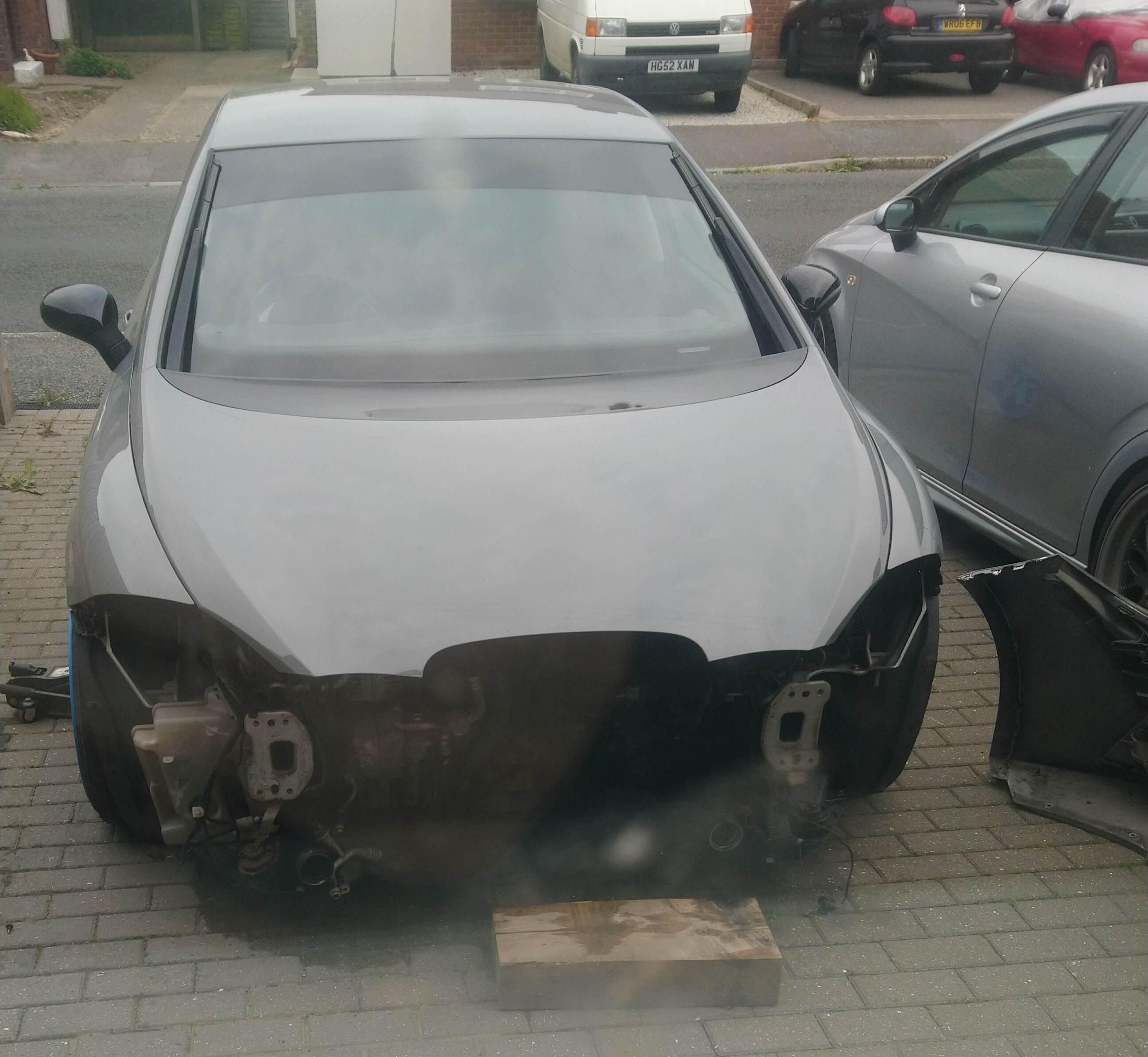

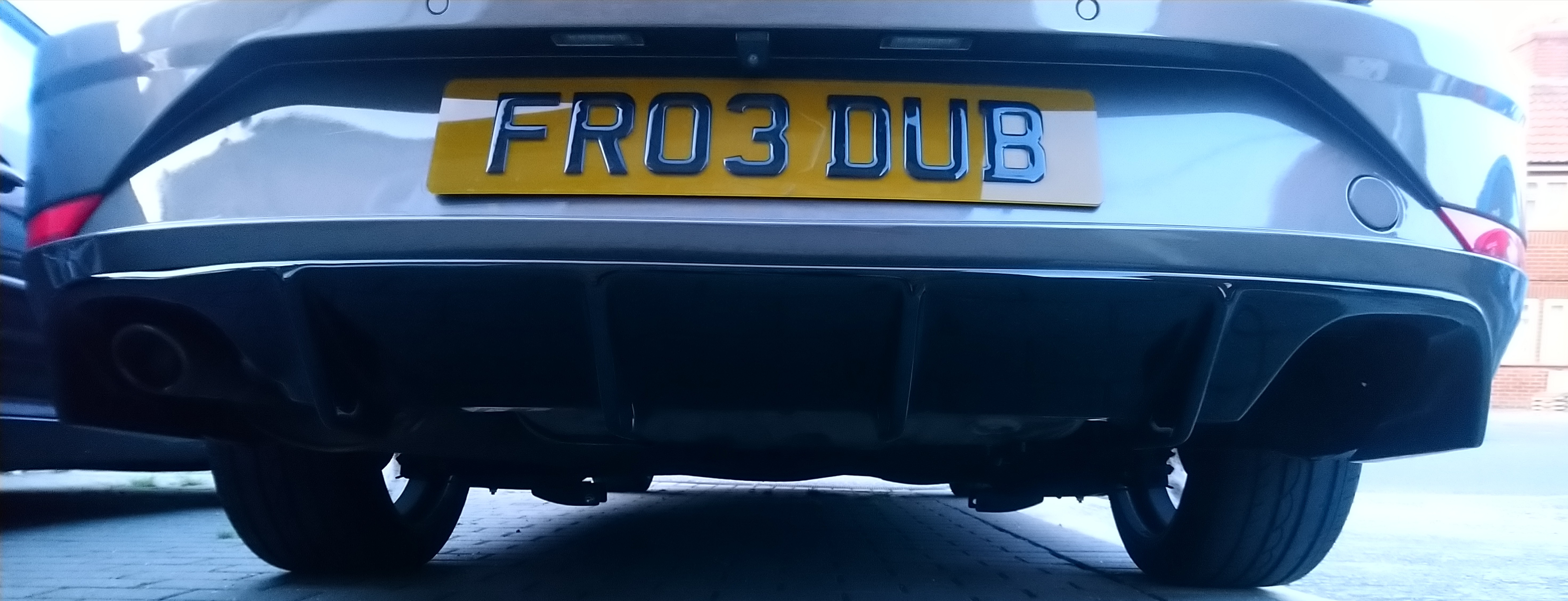

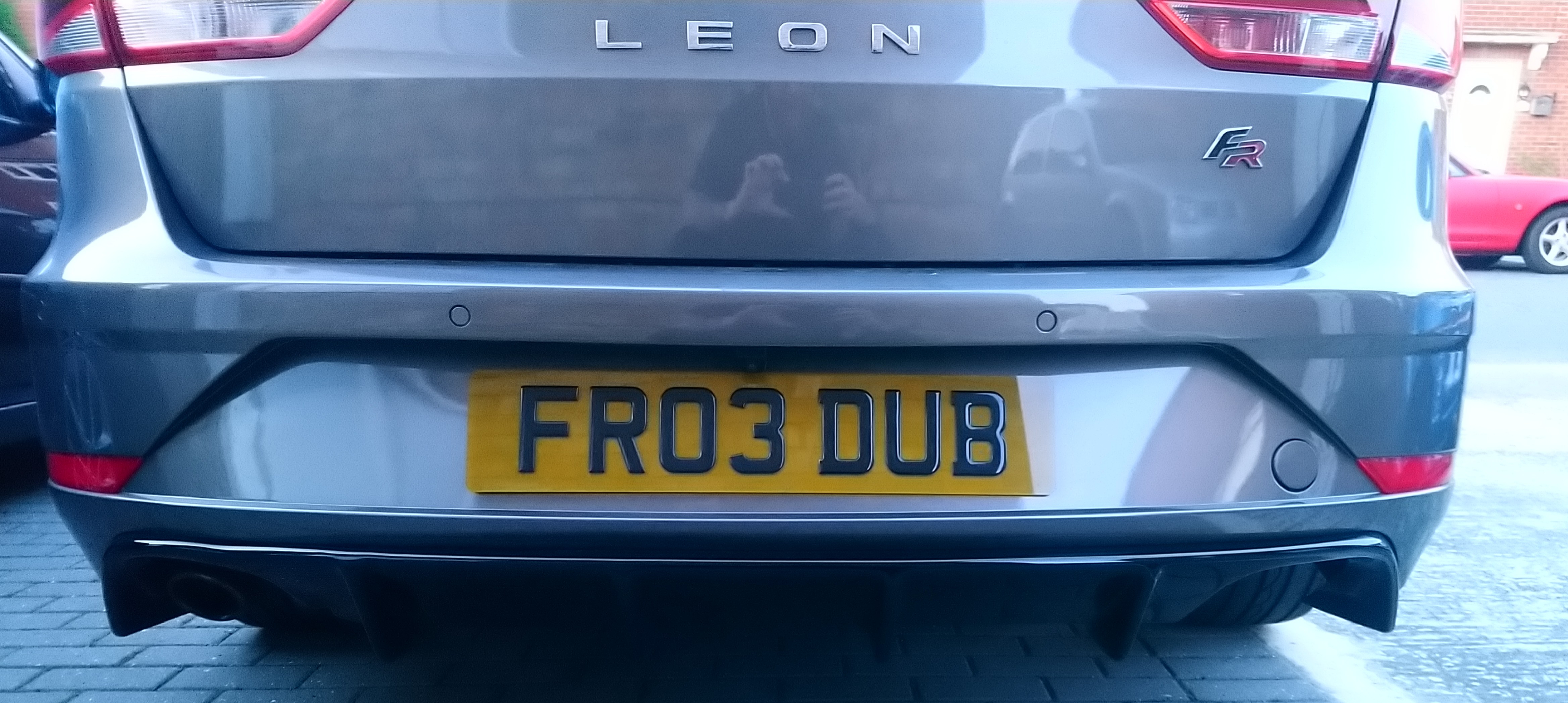

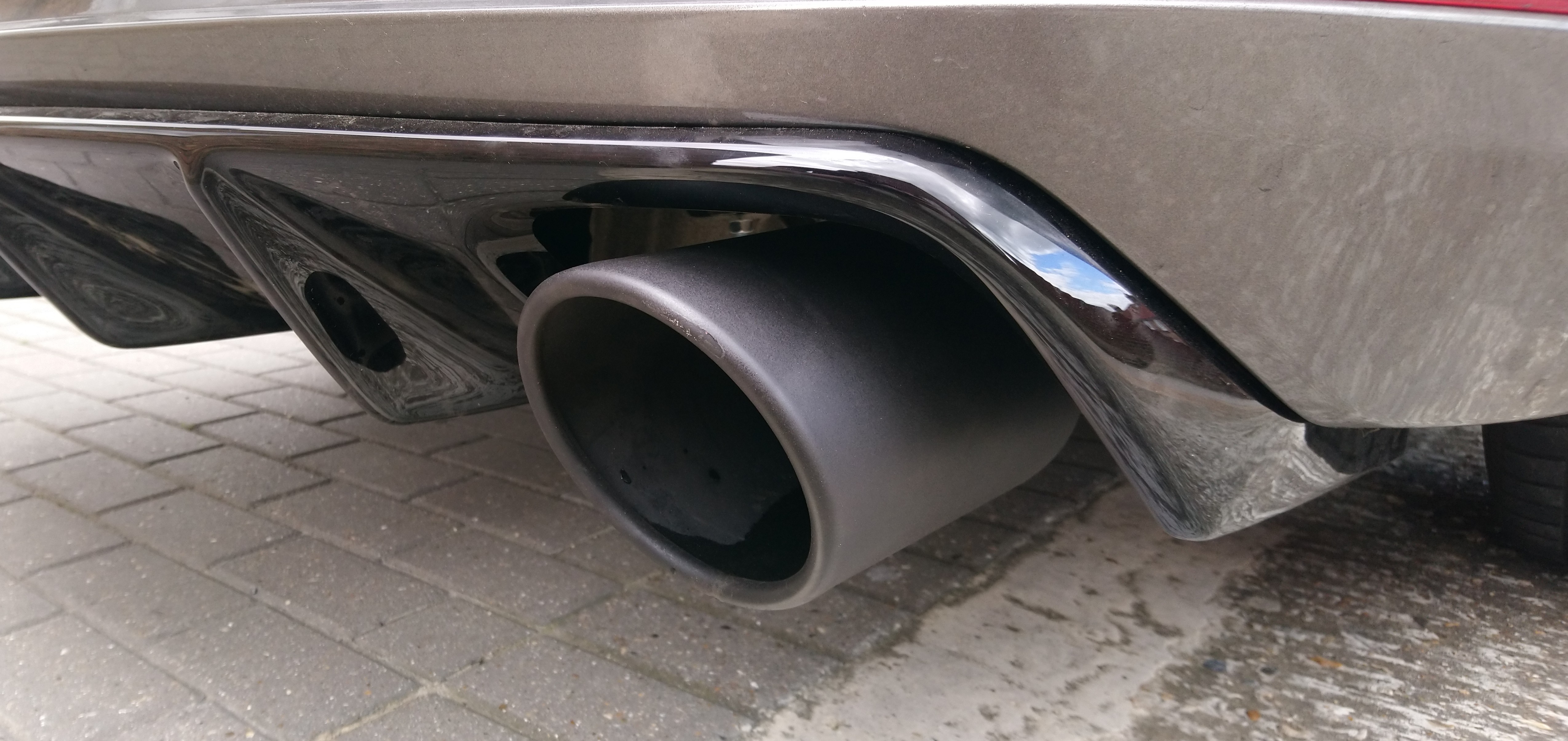

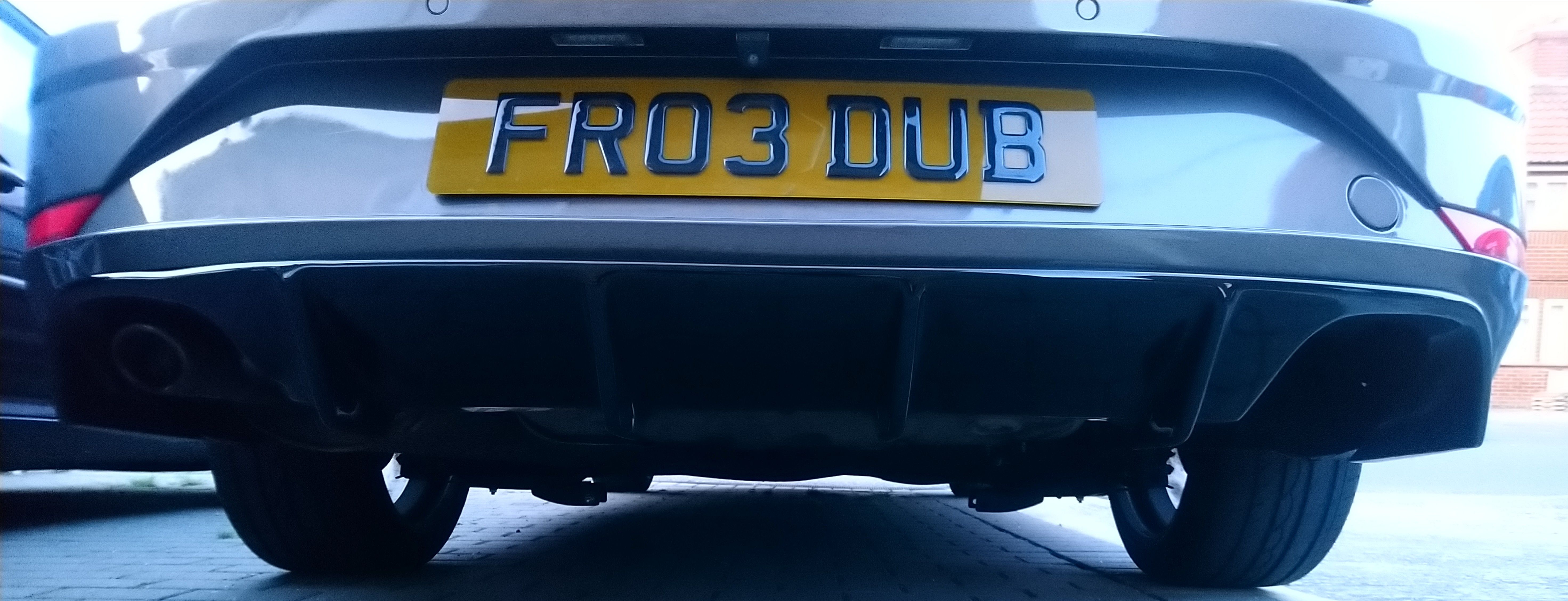

Now this brings me up to last week, my standard rear bumper was the bumper tiper where there was no interchangeable rear splitter/Diffuser so I have brought a face lift cupra rear bumper and fitter the rieger cupra Diffuser and I have seen some ppl questions if the face lift bumper will fit the pre face lift model I can confirm on the leon st it does fit and had no problem fitting it, apart from the standard exhaust I had to removed one of the tail pipes to clear Diffuser (not a problem as I'm not using the car untill new exhaust is fitted) while I was fitting have changed to led number plate lights and fitted a rear camera for future radio upgrade, so now just waiting till beginning of September to have custom exhaust made up

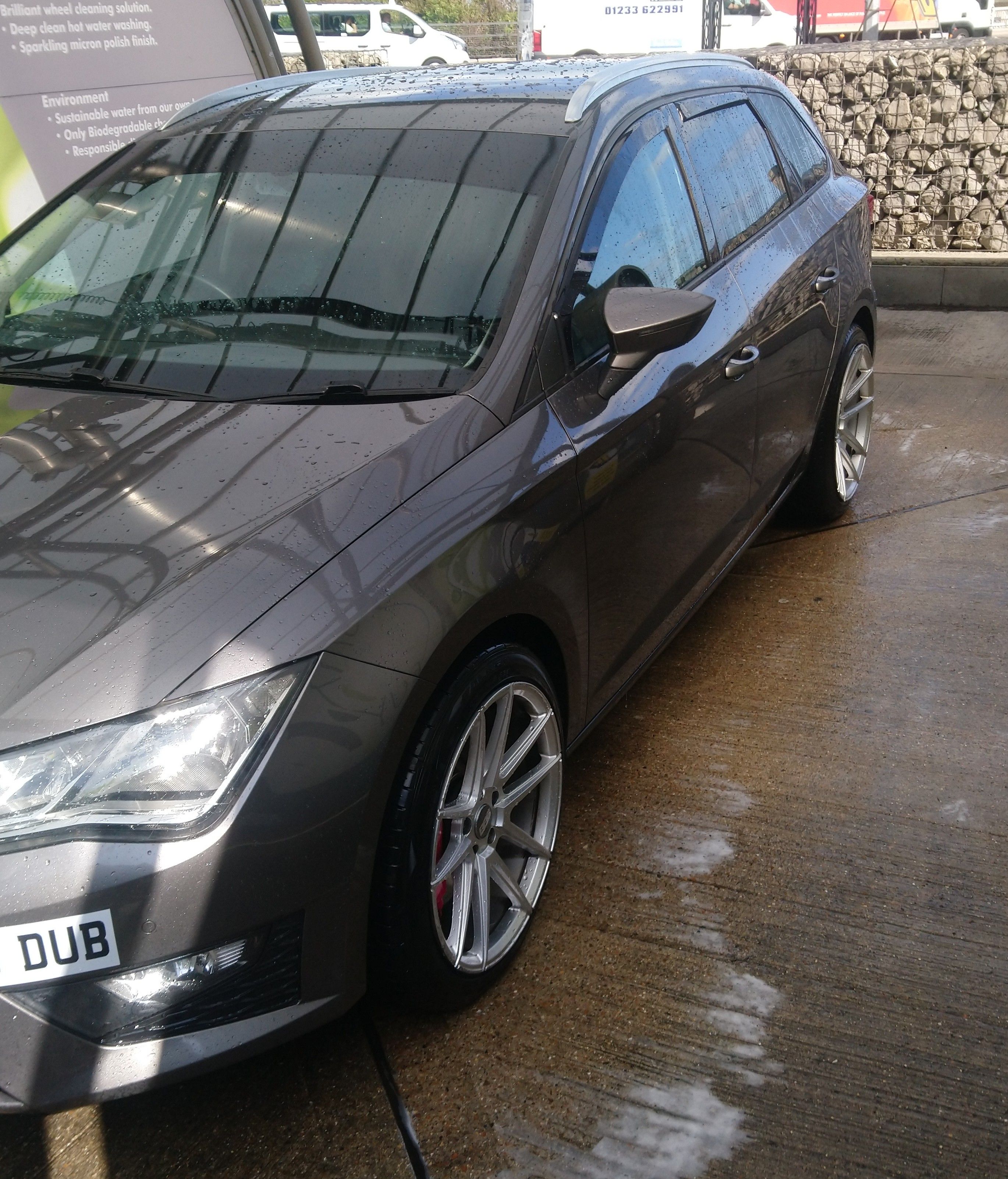

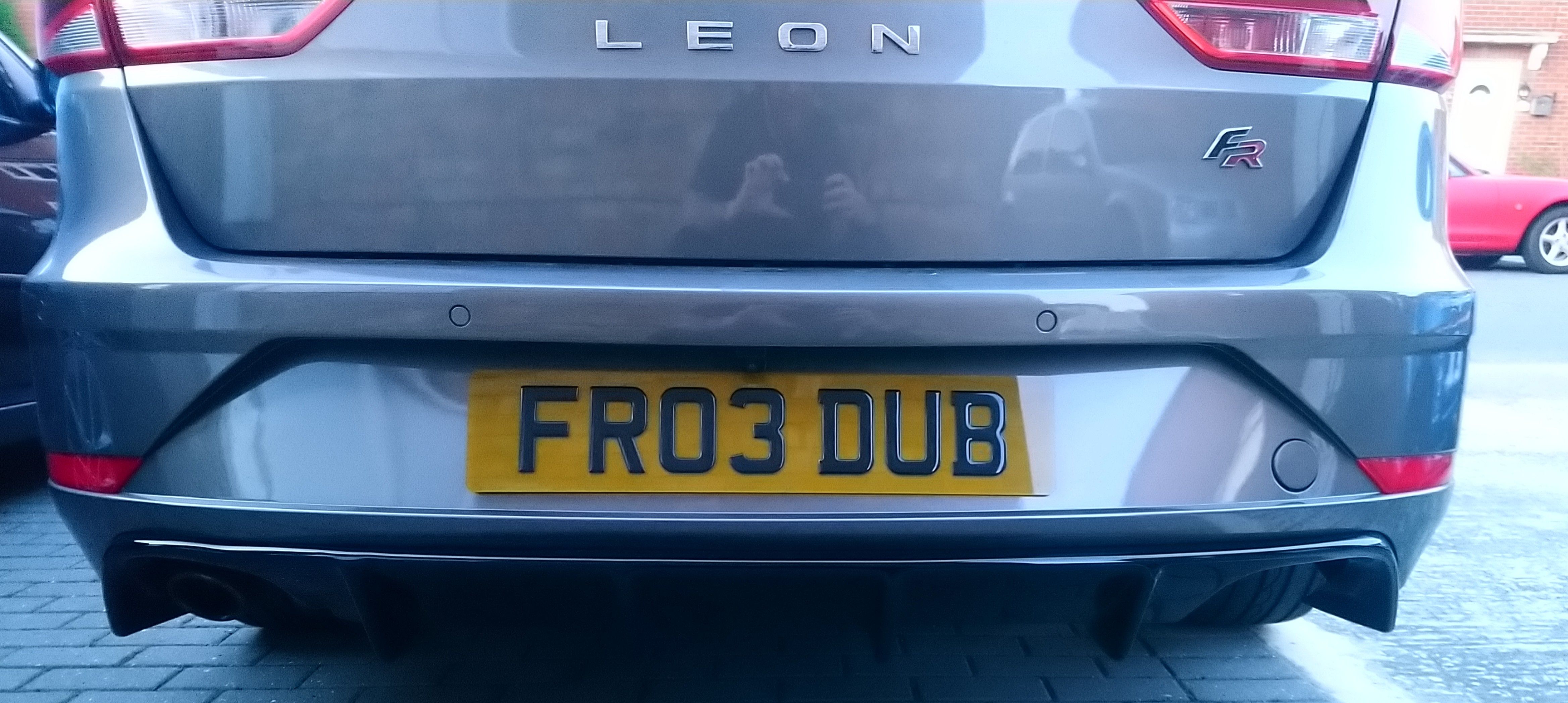

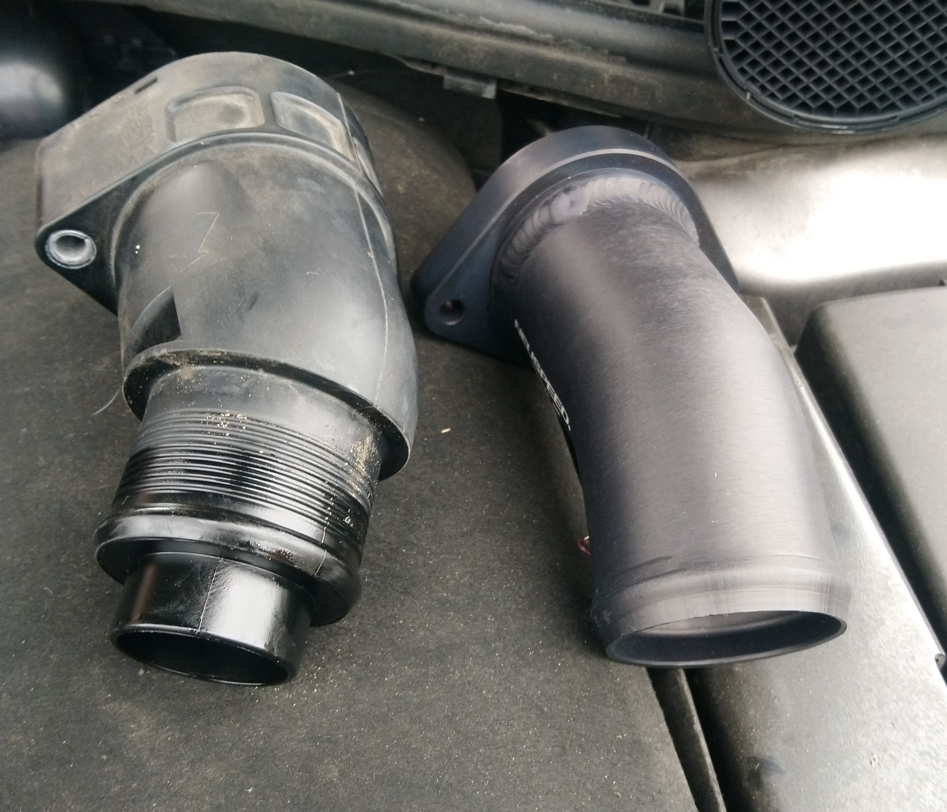

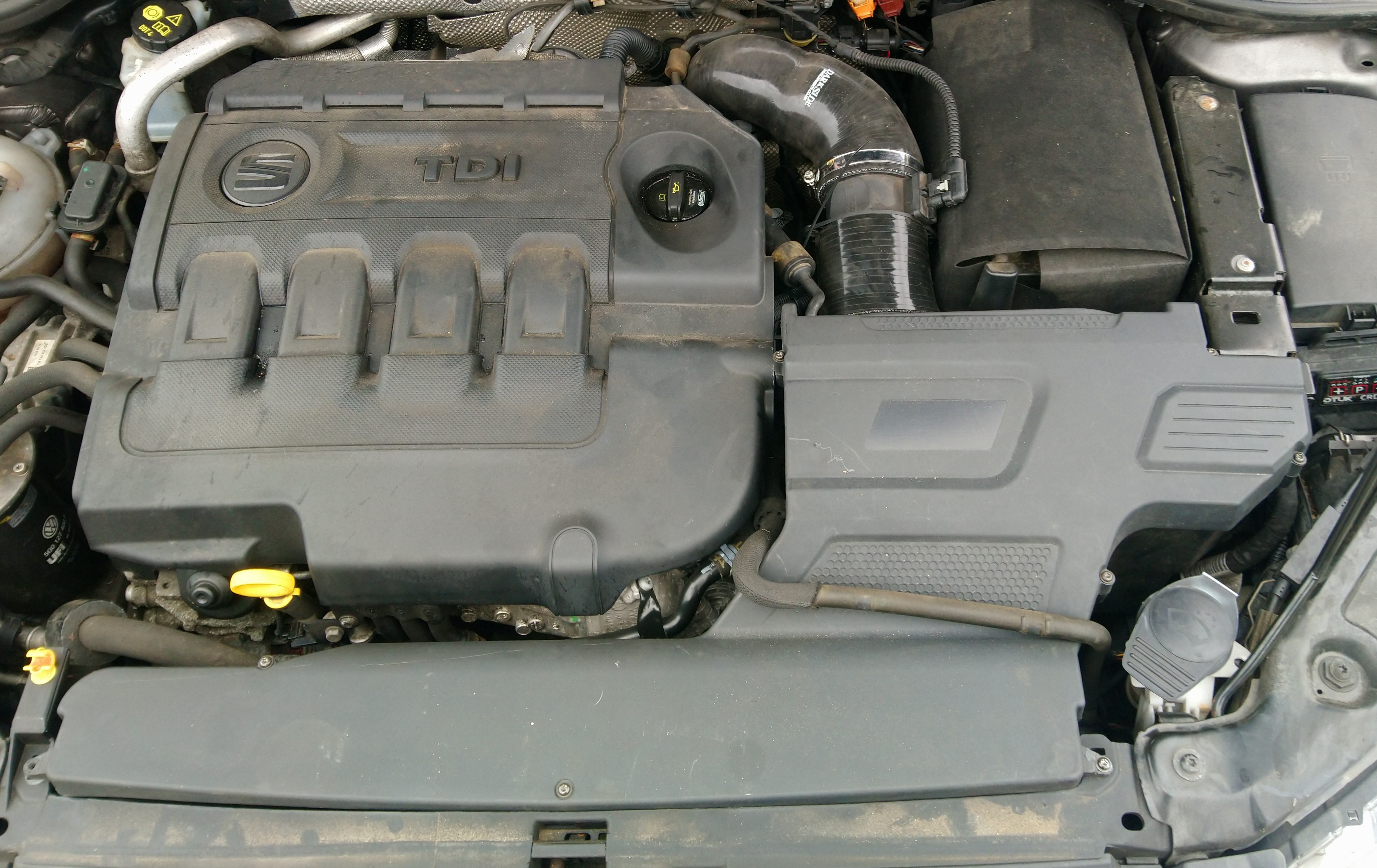

Have changed the air intake system and fitted
-racingline r600 airbox and filter
-Darkside development air mass to turbo pipe
-Neuspeed turbo discharge pipe

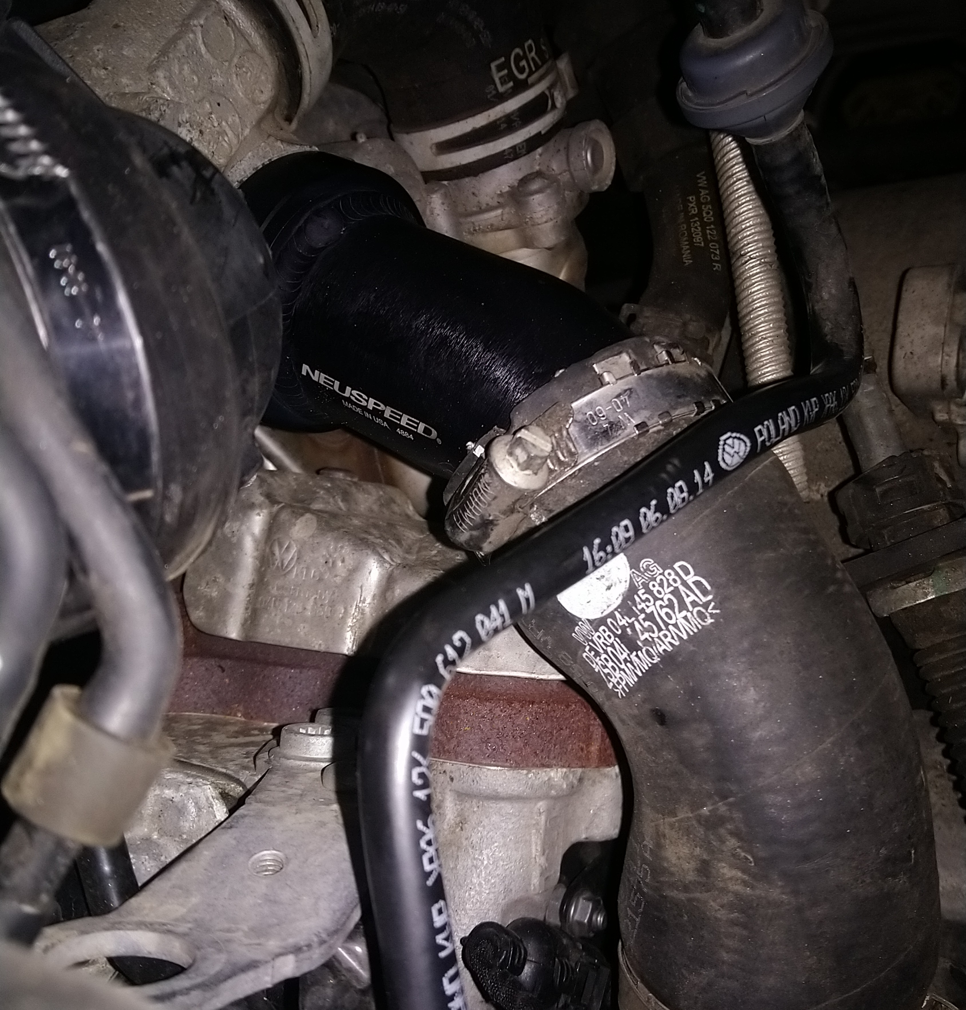

OK so this wasn't a straight forward fit as everyone I have spoken to list's the r600 intake only for petrol engines, the base of the filter fits fine a little tight with the coolant pipe (which I am going to change) the filter it's self I had to take around a inch off the pipe connection to shorten, off cut of pipe to allow to connect filter to airmass and finally top part of the filter onlt thing needed to do was remove a small amount of plastic for the two front screws,
Neuspeed pipe was a really nice fit come with new bolts have to use the old seal of the old pipe part brought from awesome gti

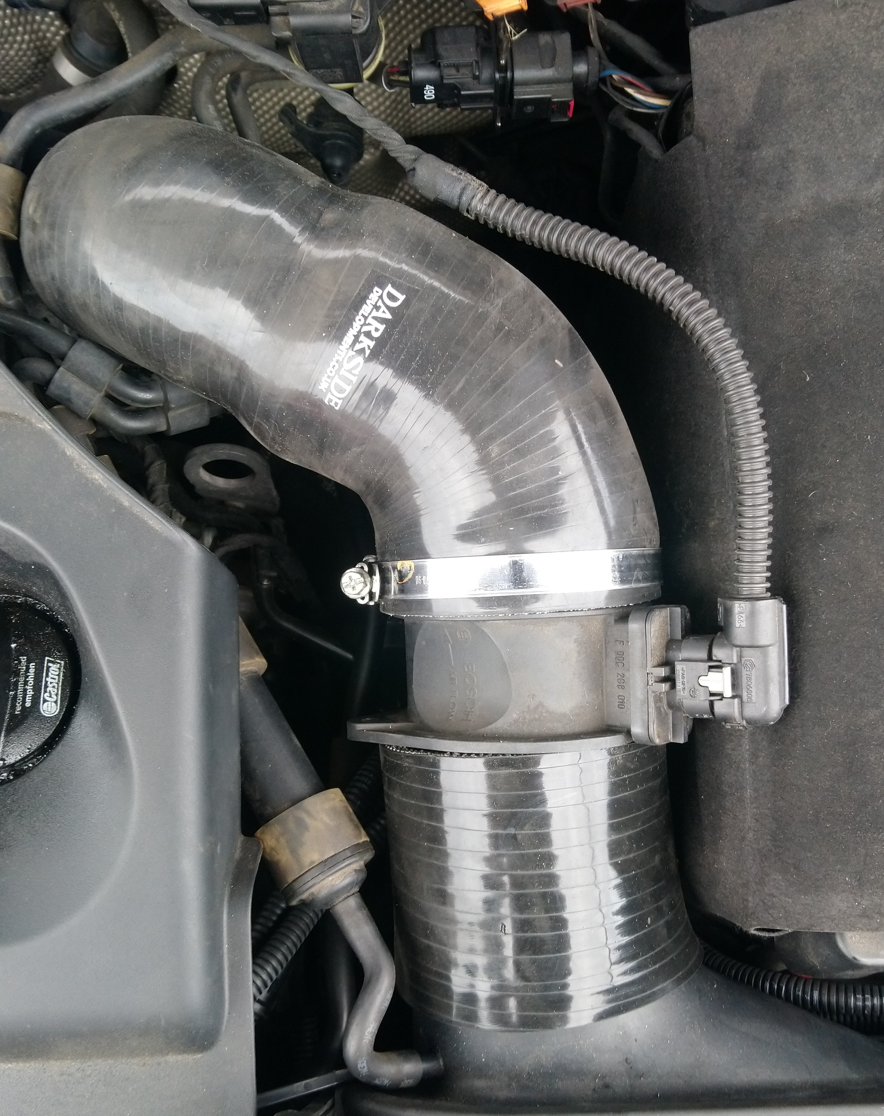

Darkside development pipe, ni d replacement part, no clips anymore for vacuum pipes so have tucked underneath the pipe to reduce movement,

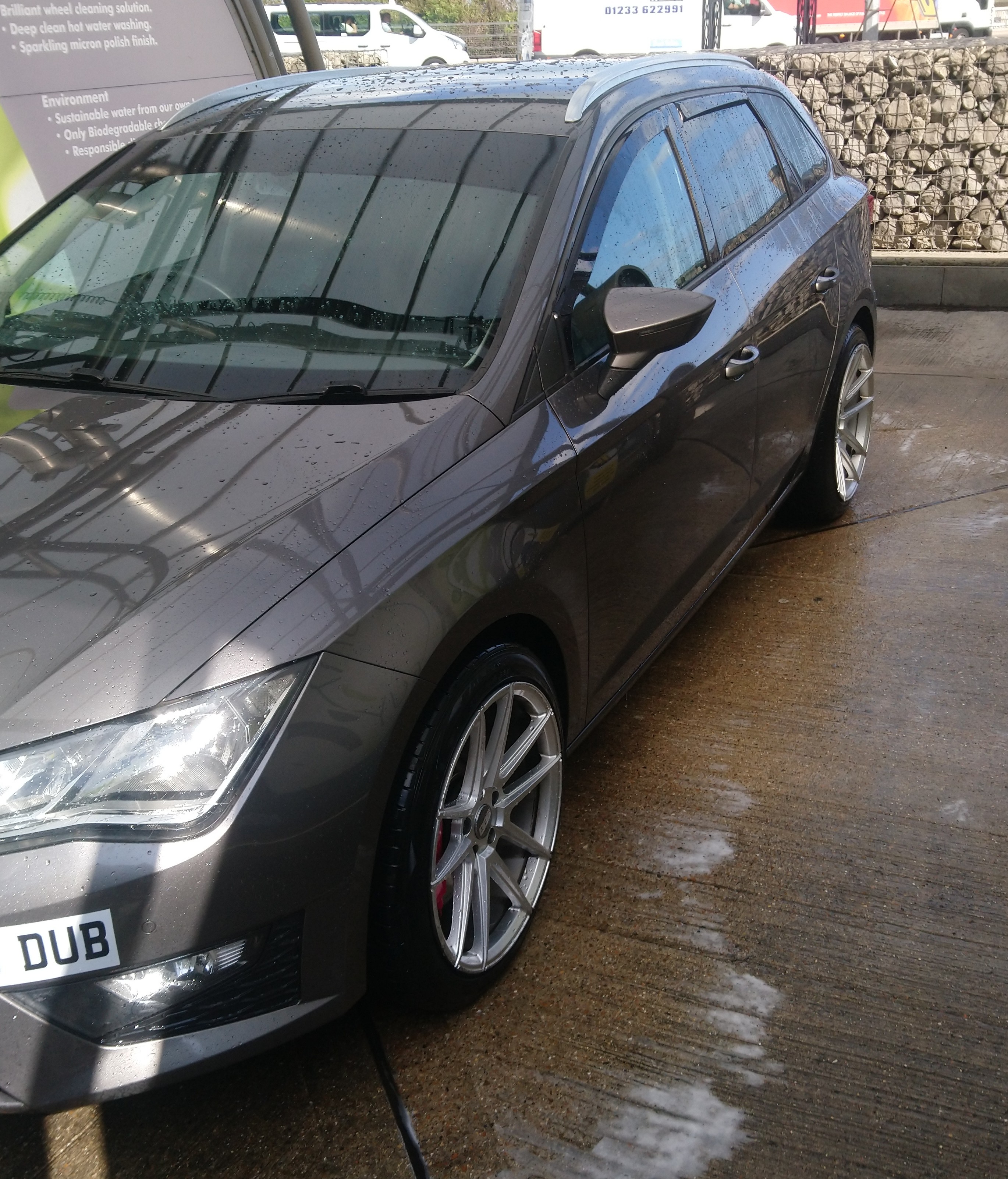

OK been a busy couple of months with a little man addition to the family, the st has now become the family car and iv brought a new car
Gone bk to bkd engine no need to worry about dpf/emissions and be able to get desired bhp (300/350)
Wheel swap between the 2 cars and going to move over the ttrs calipers,

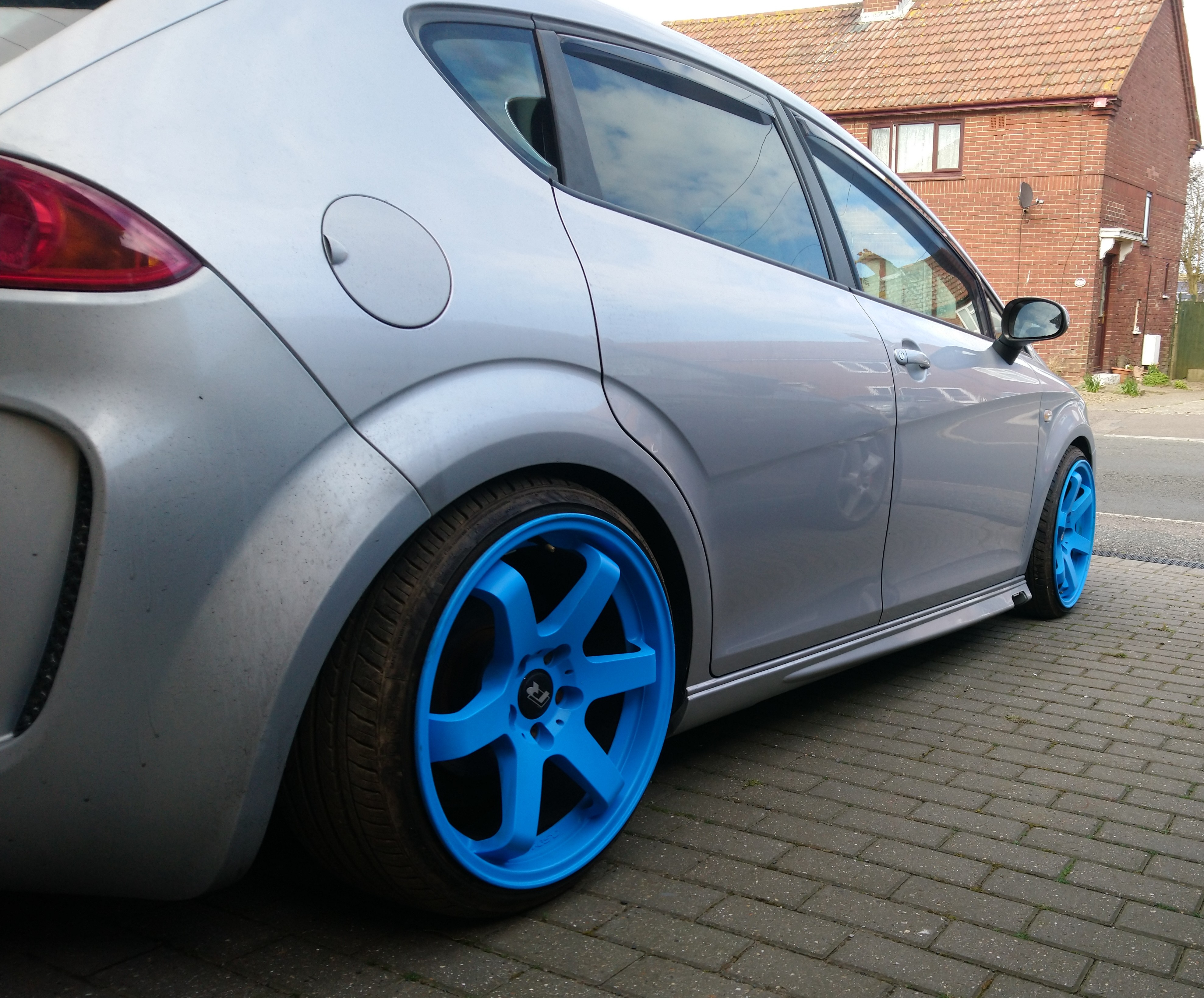

Both 18" seat sport wheels on the st now 225/45/18 and Bola b1 8.5j on the btcc 205/30/18 at the mo but not happy with this and going to have a play around with tyers,

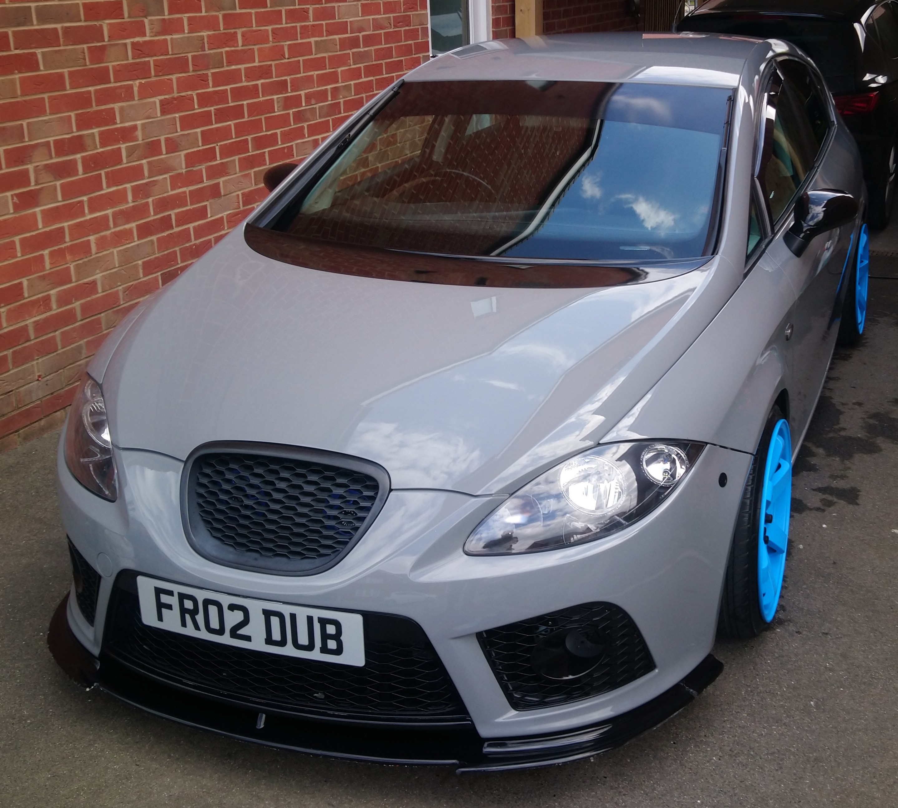

OK so iv done it agen lol , I've brought myself another car, so the btcc is now up for sale and iv changed it for a mk2 fr (tdi)
After getting it home work iv done so far is a/c full removal, darkside oil cooler fitted, oil change and fuel, egr delete and egr cooler delete and swapped the wheels from the btcc,changed coilovers to stance +_20200606_212432.JPG

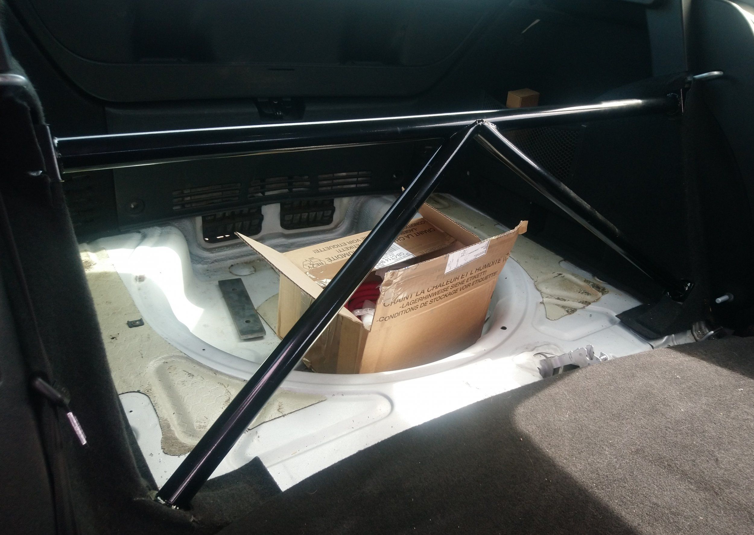

Little update on bits done, rear seats now out the car and brace bar in its place, this was off baf-motorsport bar looks good but if I'm honest the fit isn't, to large of a gap so welded in some plates to take this up,

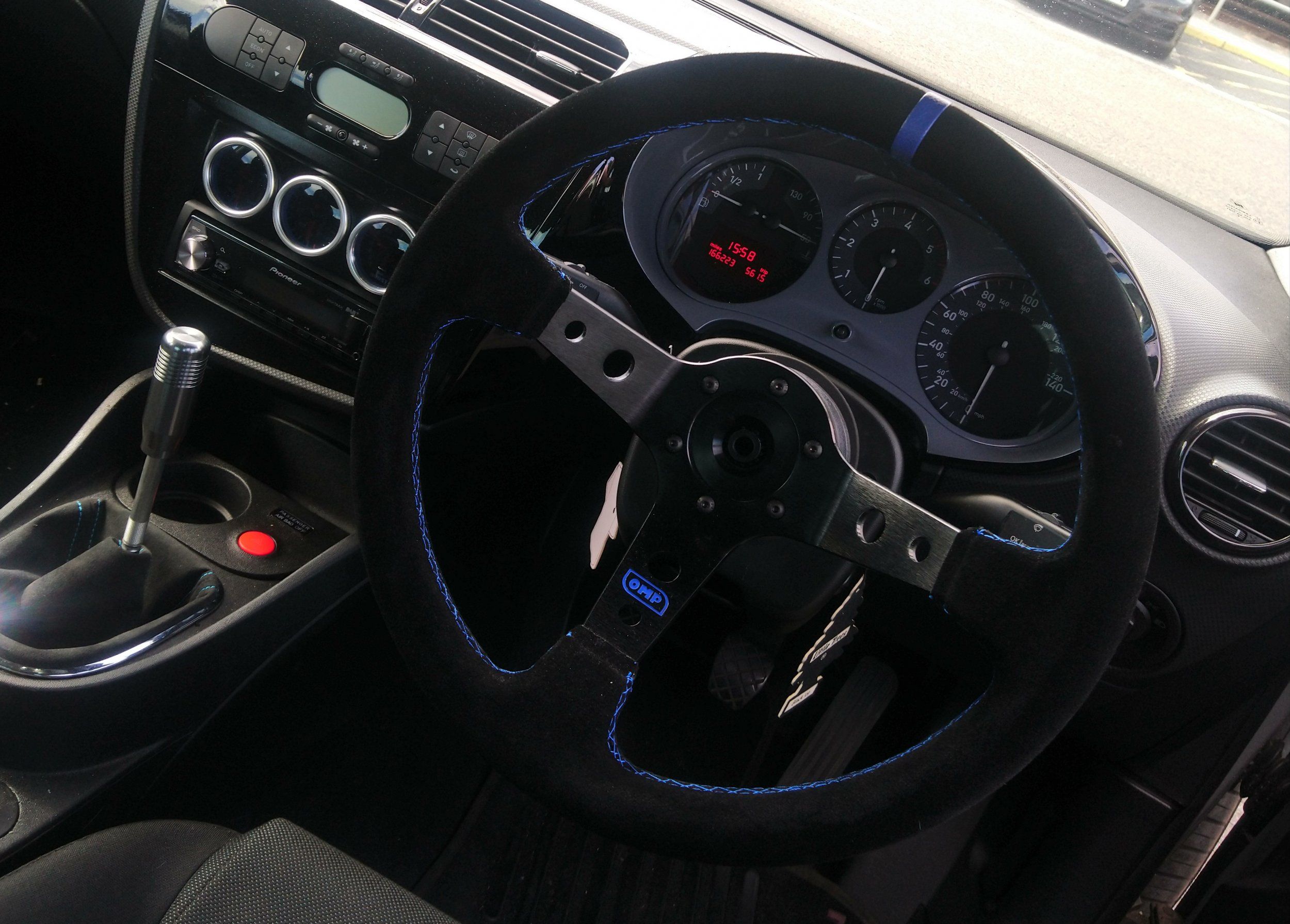

Omp steering wheel with quick release (just need to sort horn wiring)

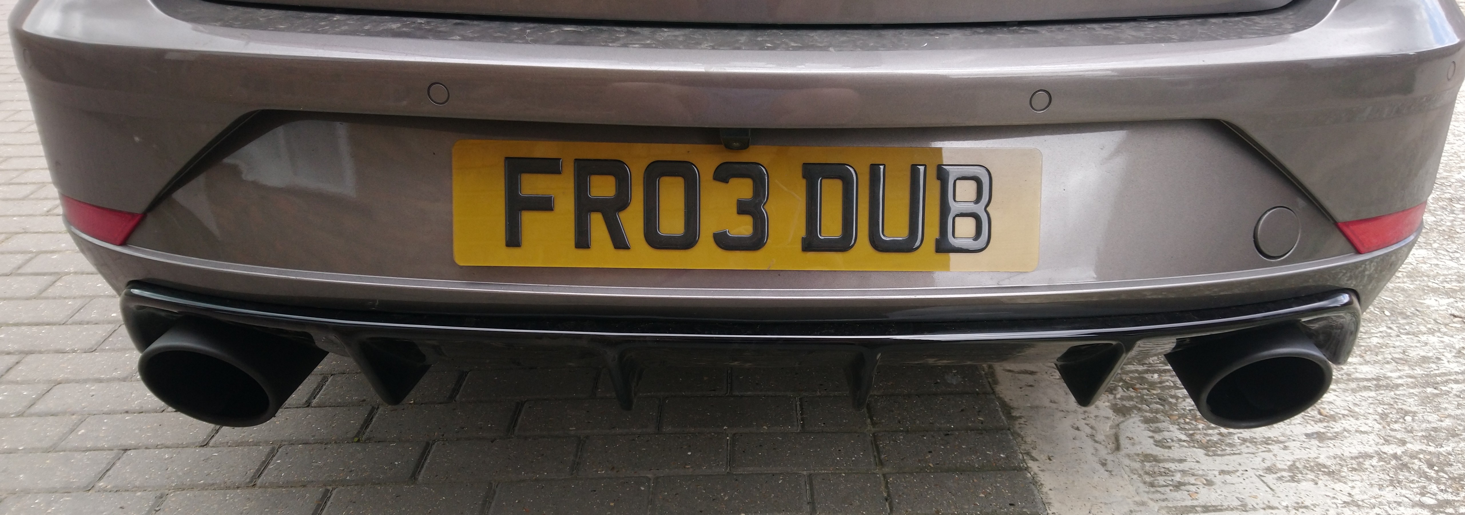

Exhaust is now on, full 2.5" no silancers and stealth tip for now until I get tips finished off,

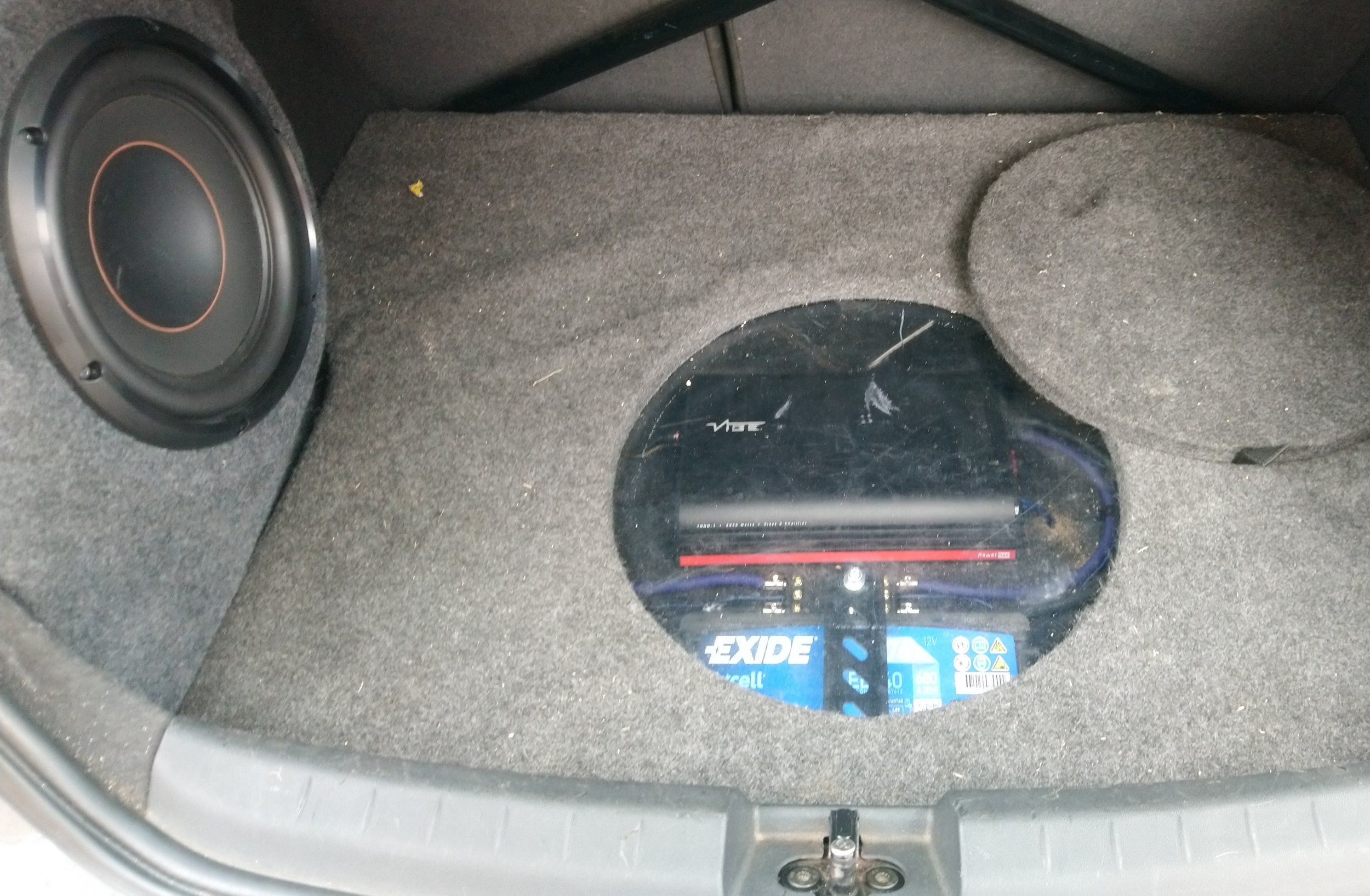

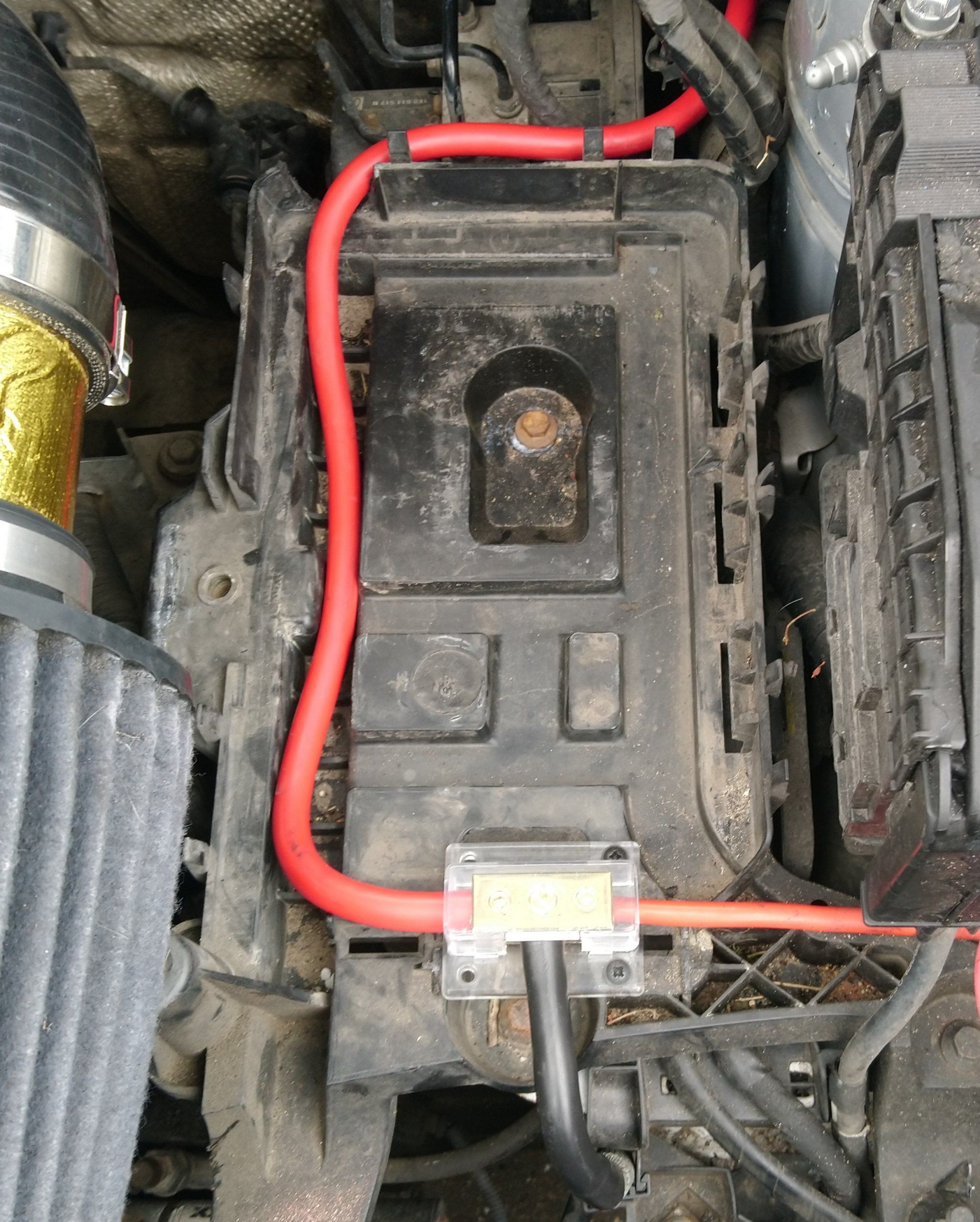

Battery relocation to boot, cage is being welded in today and have to fig out how I want the wiring to go next weekend
Finally finished off the boot, so have moved battery to the boot little sub and amp I had lying around, room under the bonnet now to make brackets up for snow performance kit
