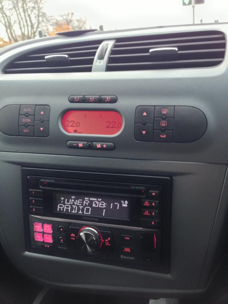

Here's the finished install....
Only issue i've been having is the radio reception isn't great... I got the FAKRA cable but there didn't appear to be anything to connect the blue cable to as the corresponding blue cable was already linked up through the ISO block?
