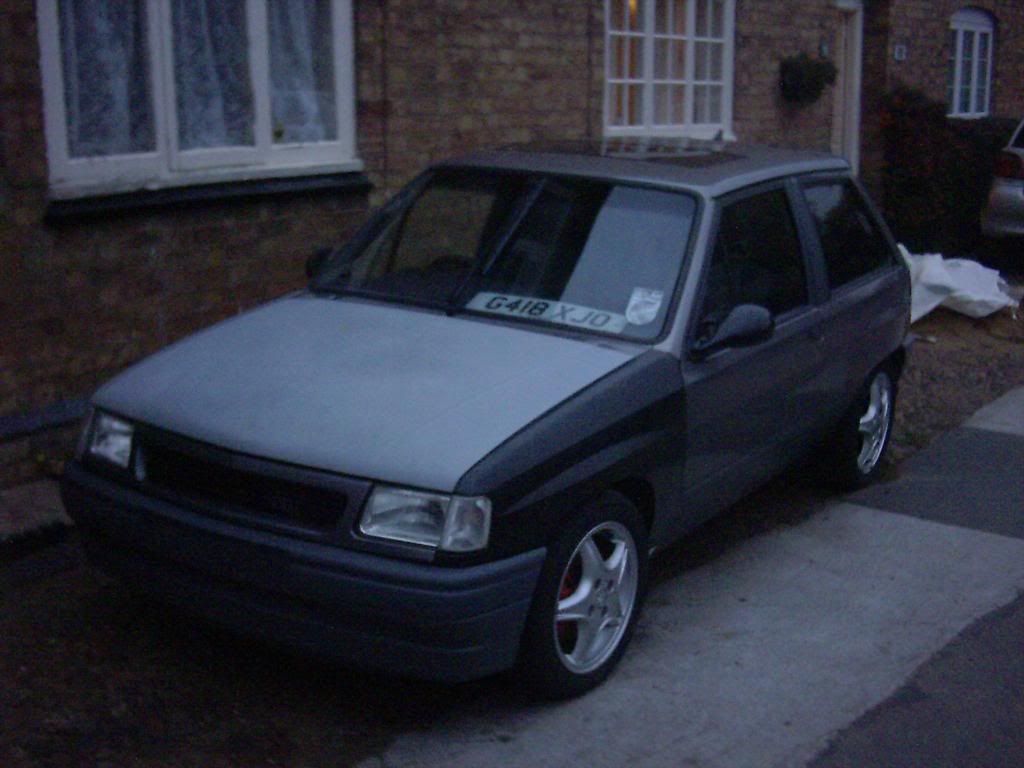

My first car was a Vauxhall nova (i make no excuses for this) it started life out as a tatty 1.3 sr and ended up as a 1.6 running a fully built engine on webber 40's, the chassis was seam welded, full polly'd suspension etc and rear disc conversion to list a few off a long list of mods... sadly it never say paint lol.

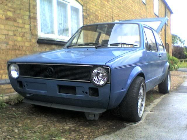

Then followed one of my faveriots to date... My mk1 Golf cl. this started out life as a rather tidy 1.1. with the offer of a free 1.3 litre lump this changed rather shortly after. various evolutions of this car came about but she ended up as a built 1.6 on a set of BMW e30 bbs rims... as with the nova fully polly'd etc but with all the usual mk1 chrome refinements.
unfortunately i dont have a digital pic of the car in its full glory but here's a mid point picy
i shall endevor to find and scan in a good one later in the thread

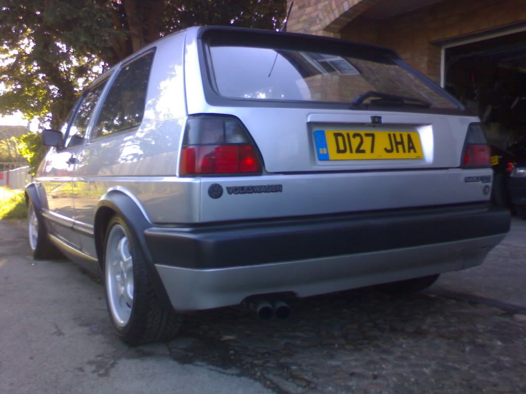

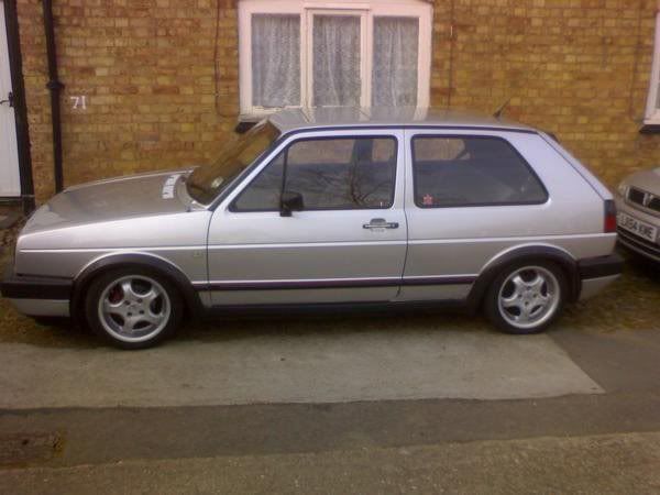

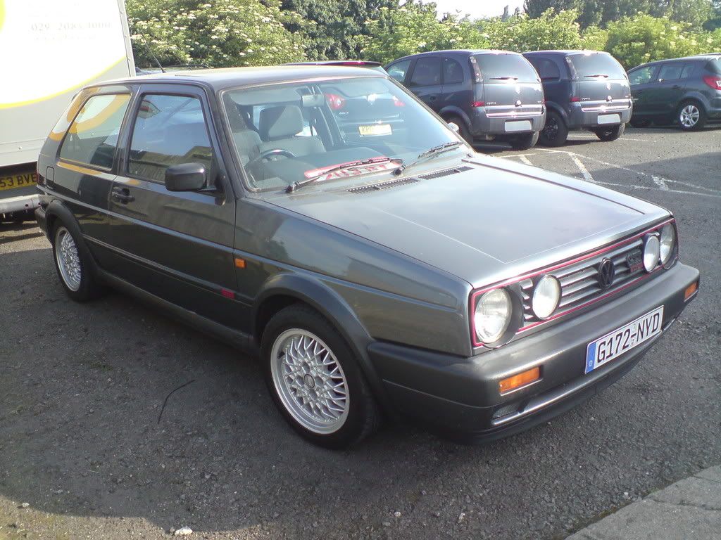

Next followed a pair of mk2 Gti's. A 1.8 8v and a 1.8 16v. the 16v was an absolute steal and i couldn't resist it. it did however need 4 calipers, solid brake pipes all round a clutch, a gearbox and the top end rebuilding! i set about this with great enthusiasm and built my first and last fully standard car. was in stunning condition!!!

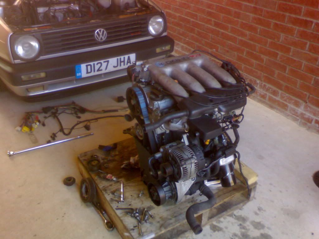

The 1.8 8v was less of a steal with some of the work already done but wasn't as fast as i'd have liked. that was soon sorted with a yet again built lump (2.0 8v from a mk3 gti) this was awesome and gave some serious machinery a run for its money but again i wanted more and fitted a 2.0 16v lump. unfortunately my current motor isn't currently as fast as the insane motor but it is a work in progress.
2.0 8v golf on dished rims mmmmmm :bleh:
2.016v rebuilt ready to swap.

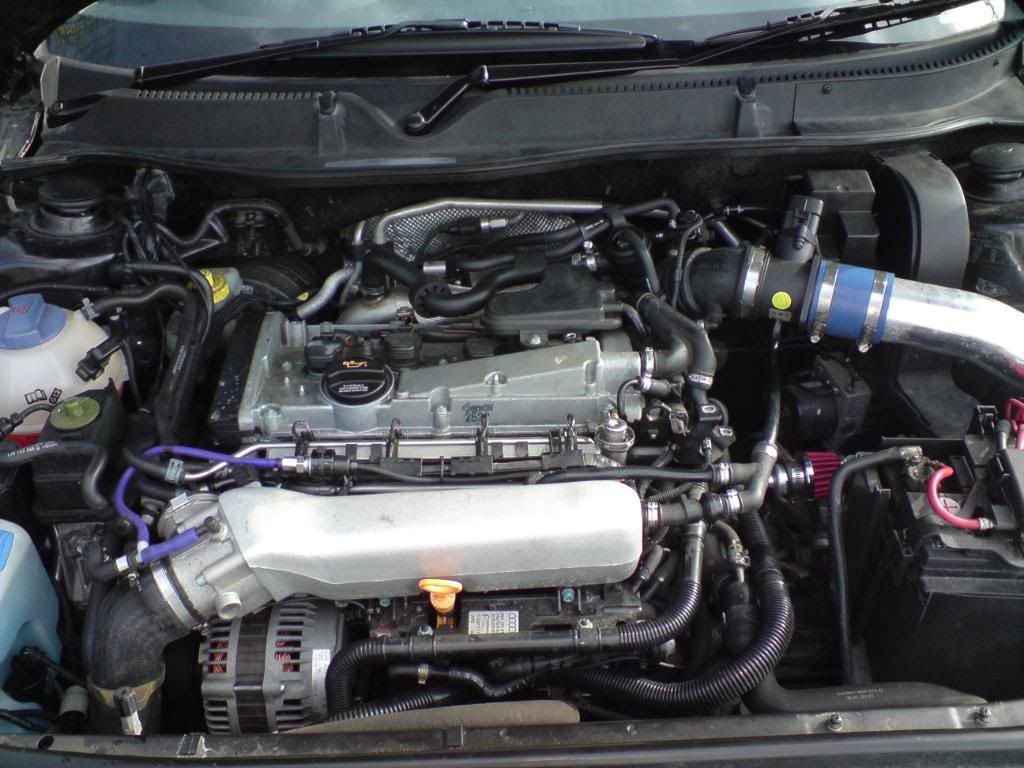

now the turbosmart atmospheric dump valve didnt really cause me any noticable problems to speak of but the induction kit was killing mass air meters. after a few race weekends working for Racingline in the Volkswagon Cup i realised the errors of my ways and what worked best on the 1.8t's and so the valve/induction kit went in tehe parts bin (Ebay) and a Forge 007 was fitted and a named filter found its way onto the end of some custom induction hard piping :)

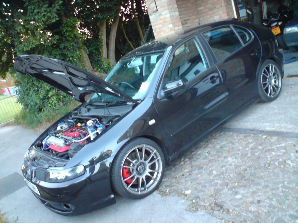

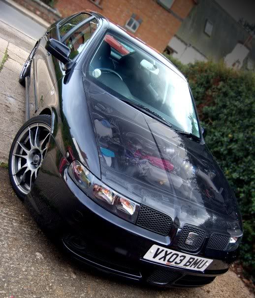

Next up came some play with paint and engine colour coding... the origional idea was for a candy red flip on the cover and some of the plastics... it kinda came out a pinky purple so painting stopped there for the time being for a rethink... the colour was different and i liked it... it was just the "its pink" comments that got a bit annoying! :cry:
A few arty shots...
its not pink... lol

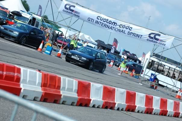

Anyways... GTi international 2009 was looming ever closer so with this in mind the aar recieved no more than a clean over the next few weeks!
i was quite happy with the car at the time untill this happened...
No i know it was second place (lmao... :lol:) but it meant lots of room for improvement!!!

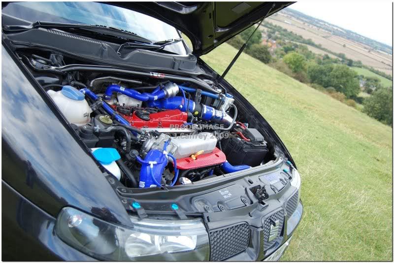

the very next day a from mount intercooler, 4 bar fuel pressure regulator and lots of other gubbins was ordered!!! project 300 was about to enter its next evolution.

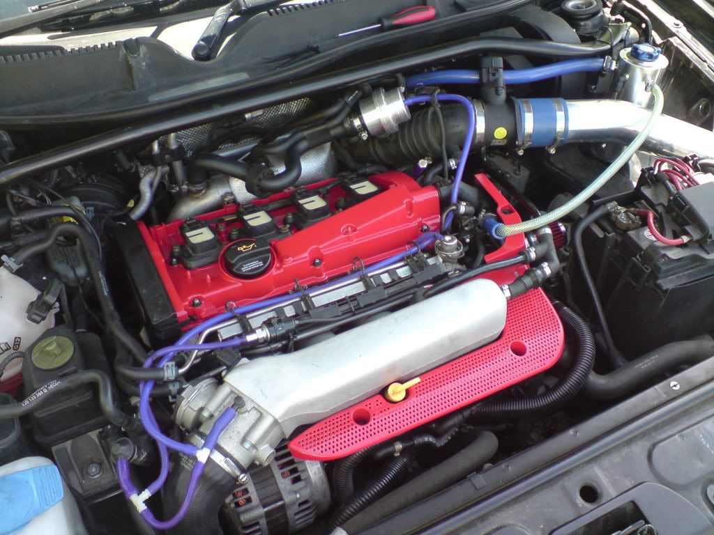

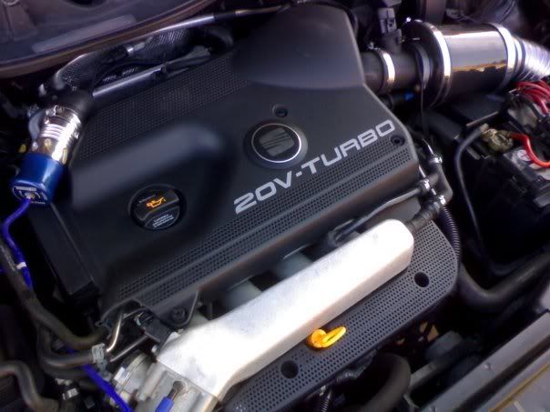

Cam covers and plastic engine trim came out to become red NOT PINK!!! and a new BOV whilst i waited... oh and N249 Bypass

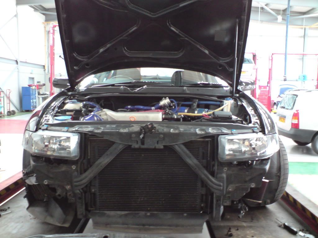

after what seemed a lifetime for my goodies to appear i bookeed a few days off work and cracked on with the job at hand!

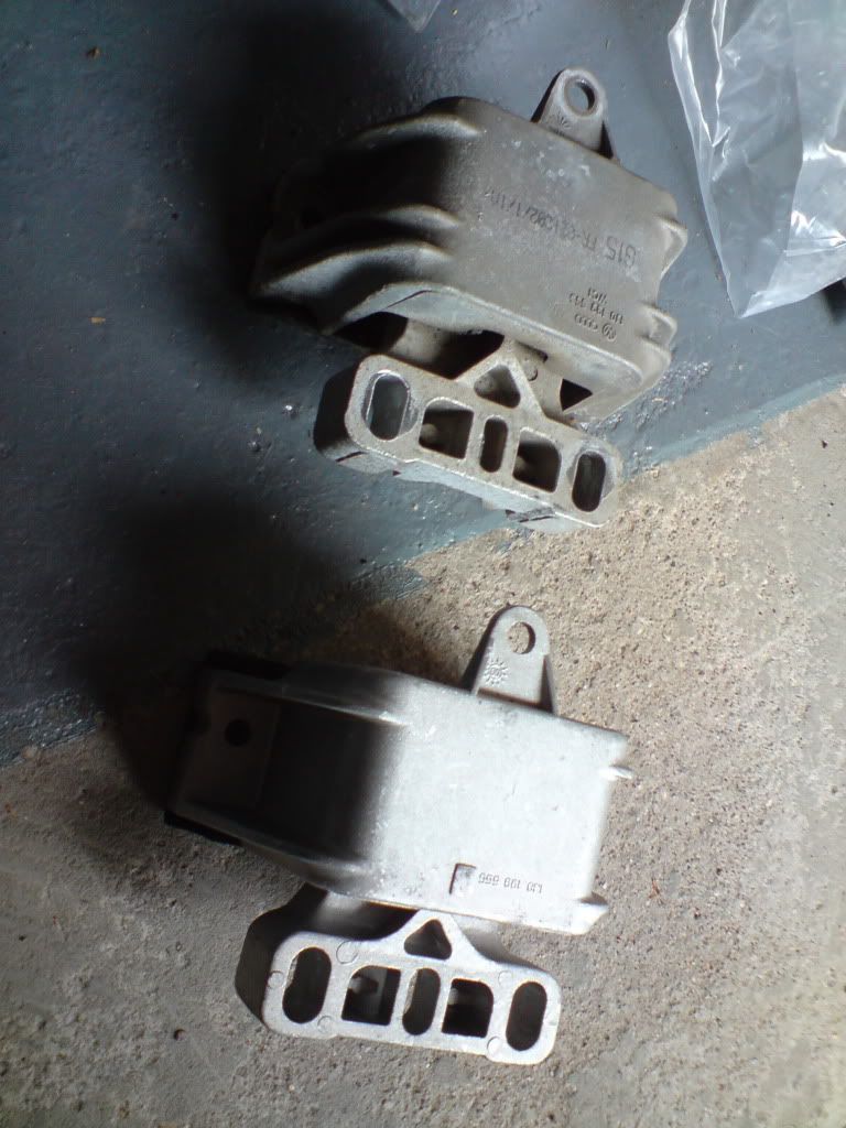

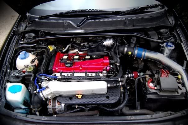

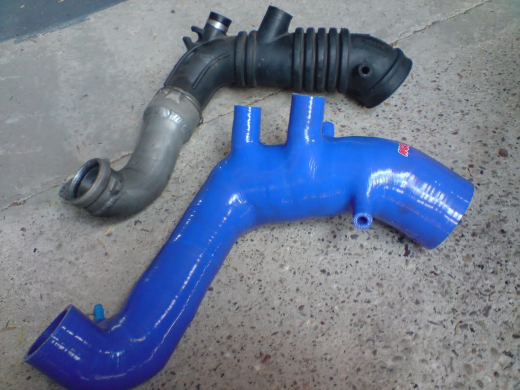

A new fuel pressure regulator, a new ITG filter, Awesome GTI TIP pipe, Forge silicone boost and coolant pipework, and a set of THS Performance engine mounts later the job was comming along a treat!

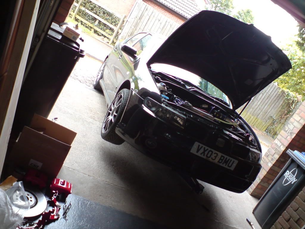

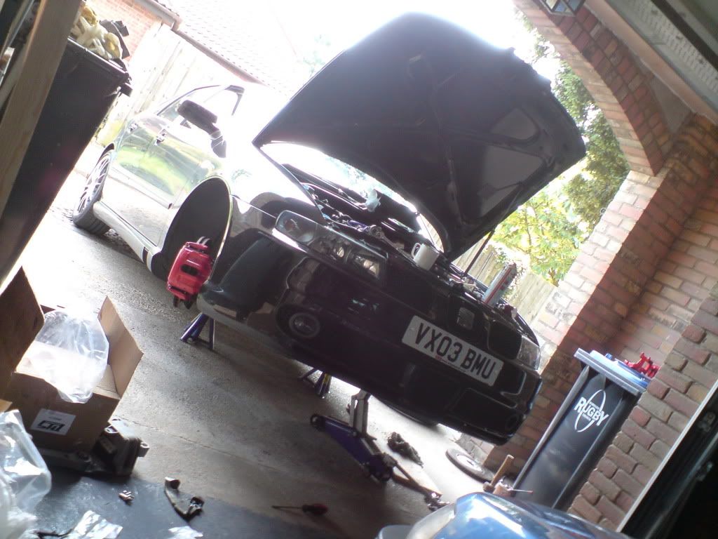

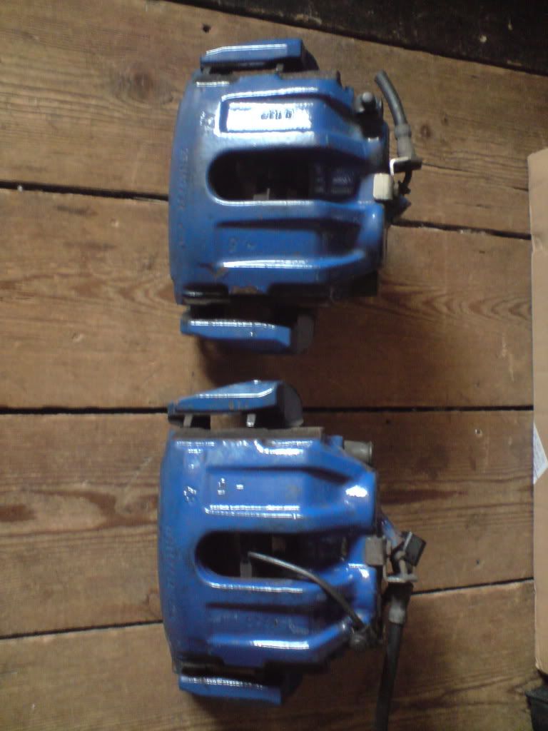

whilst waiting for the front mount to turn up i decided to invest in some stopping power... as everyone was doing Porsche brakes at the time and i was now skint i though i'd go down a different route. after a few mins scouring fleabay i found these beastys :wtf:
Golf R32 calipers
Perhaps a little contraversial i dont know?? i'm not sure anyone has been down this route with a leon either??
With this in mind i set about fitting them and turns out they are better than standard!!! RESULT!! although unsprung weight could be better here they are a good budget improvement untill my pocket is once again full enough to invest in some 4-6pots. on the positive i have 2 sets of discs and 2 sets of pads so they'll last me :)

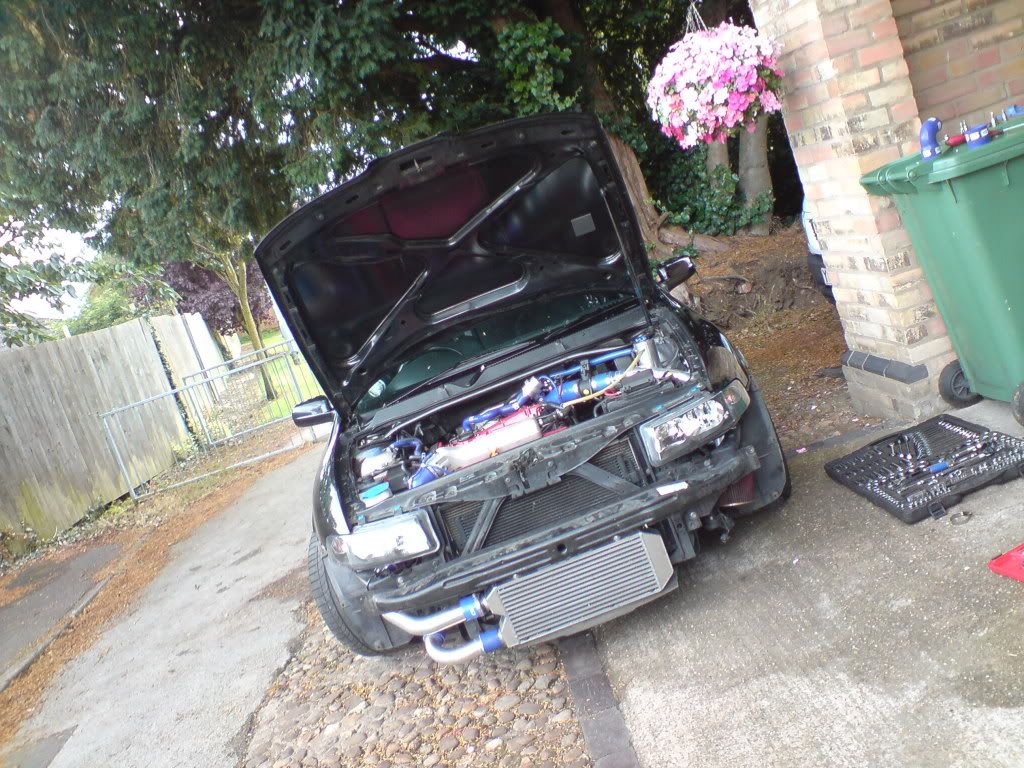

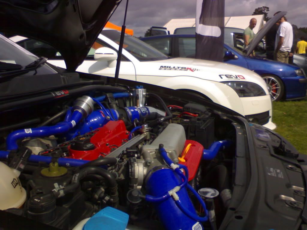

Next up -- you guessed it... the front mount :) this was also supplied by THS Performance and although not the biggest cooler in the world it has made a massive difference to the induction temps :D (no logs sorry)
its Naked!!!
home made coupling pipes whilst waiting for some Samco items.
Time for REVO stage 2 Software :cartman: -- The result... much better throttle response, improved acceleration, everything sounded better and felt much tighter!
Better yet those THS mounts (full set) really help lay the power down and eliminate wheel hop!! (one of my top buys)

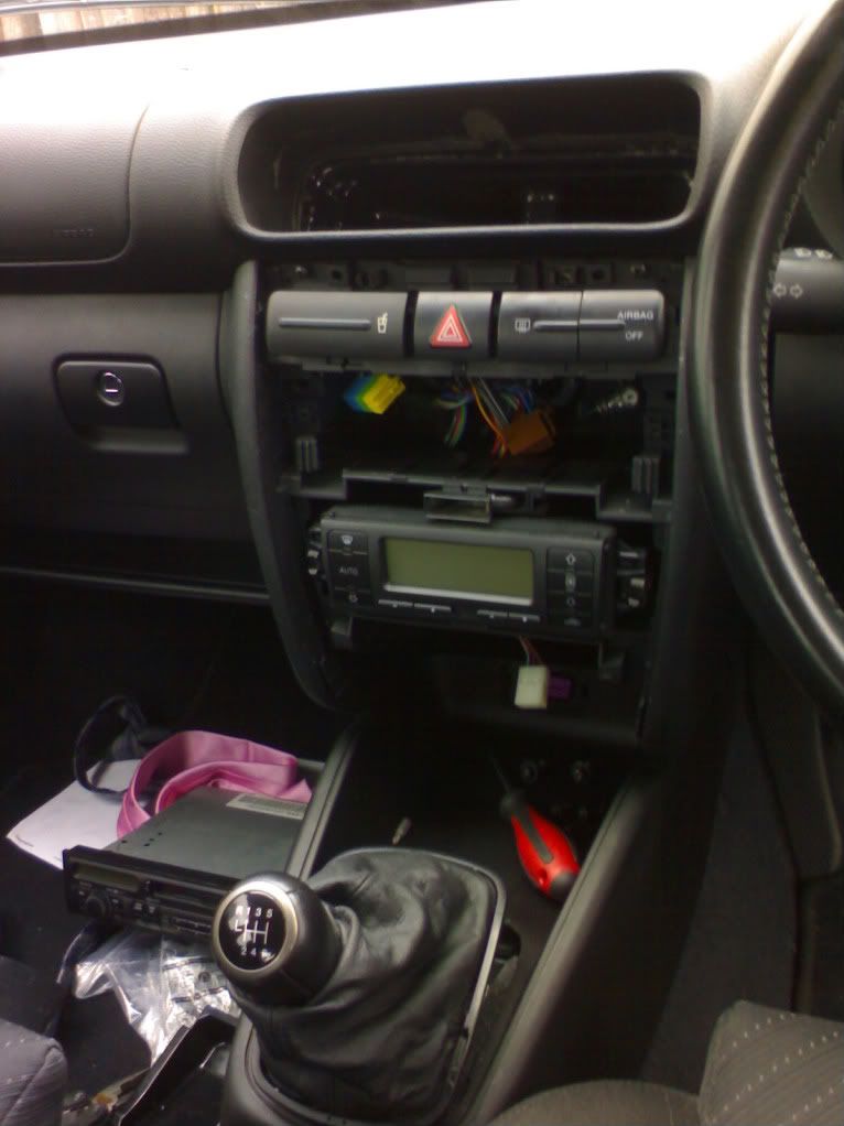

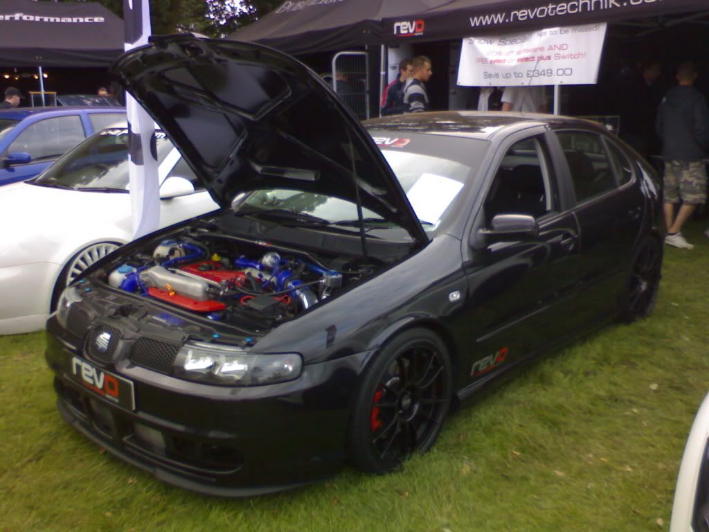

With the car starting to come along nicely Carl @ Revo asked if i would like to show my car on their stand at ED28 2009... what couould i say :clap: with this in mind and something a bit special up my sleeve i set about transforming The Little Leon for the show!!!
Wheels off
Standard dash (Mega Lame!)

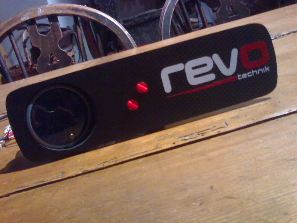

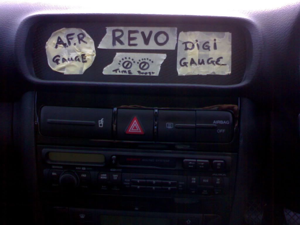

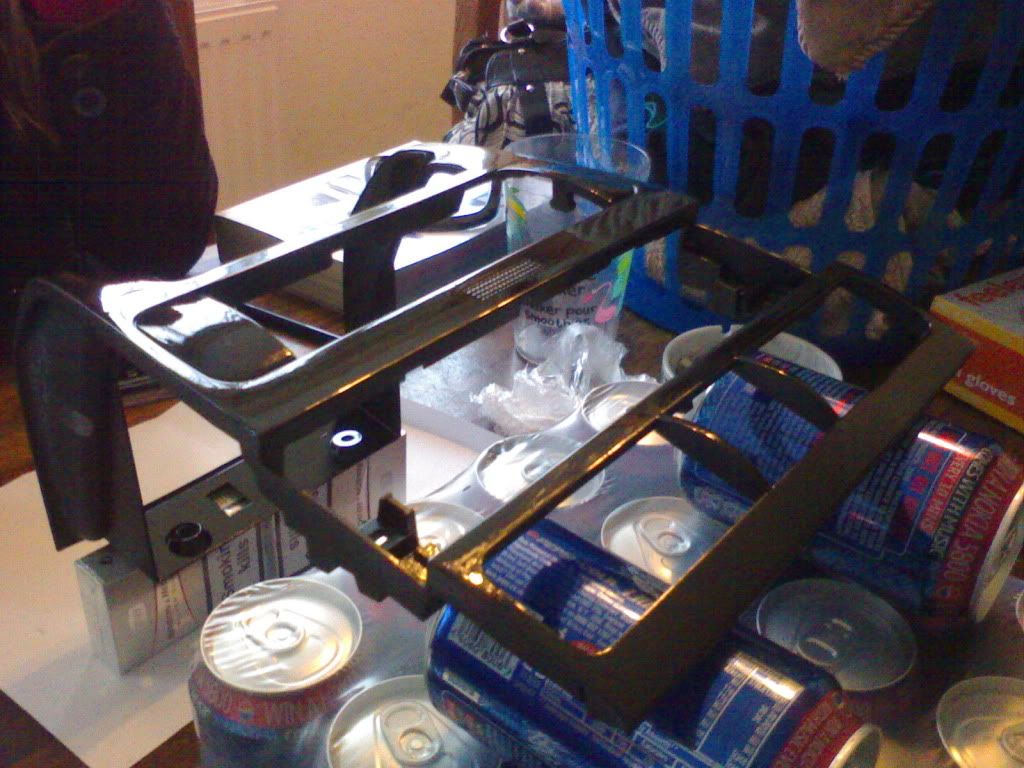

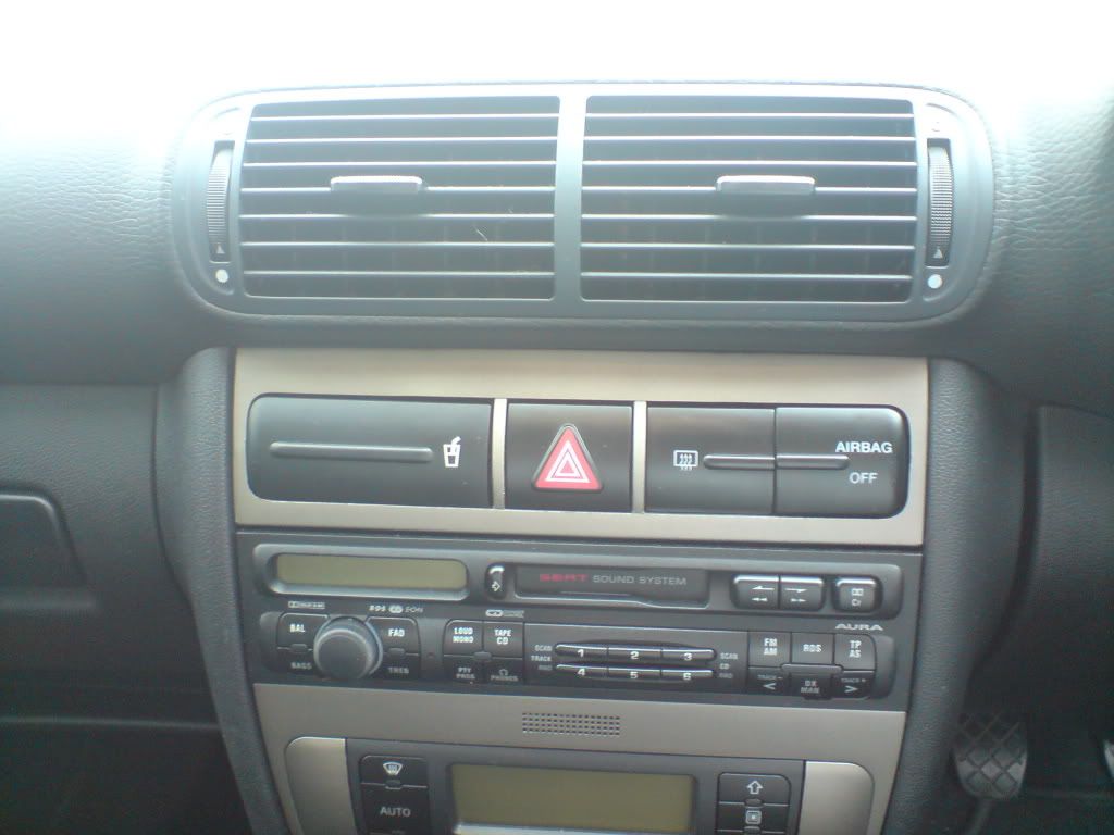

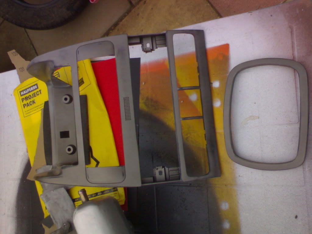

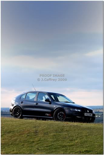

For those of you still wondering, after a sit down with Nick & Carl @ Revo it was decided that hard wiring would be perferfectly porrible so i set about my dash with a little courage, a little Carbon courtesy of a local F1 team, an sps switch and an air fuel ratio gauge... the result imho was something a bit different for my dash :funk:
the wheels were painted up in VW black magic (shiny metalic black) to match the newly re-painted dash! the result :-o
From the monent the wheels touched the ground again it was off to Revo technic for stickers for the show
A few other mods snuck in over night including de-wipered rear end (glass blank) cupra R splitter etc etc.

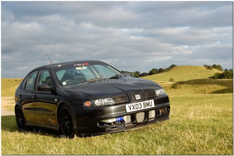

And a couple shot by my mate... although he asked to take the pics i dont get a copy so sorry for the low res and water mark...
So at this point the car has been reasonably modified (a little more than whts on here so far but no picys yet) and should be pushing between 225-235 bhp (no actual figures as there is a long way to go still... but it is faster than a standard LCR so thats a reasonable guide) next up, turbo (awaiting parts), awaiting some carbon shell bucket seats, got a set of 4 point LUKE harness's already in there, 1/2 cage, steering wheel and maybe some pollys for now. who knows what else 2010 will bring.
