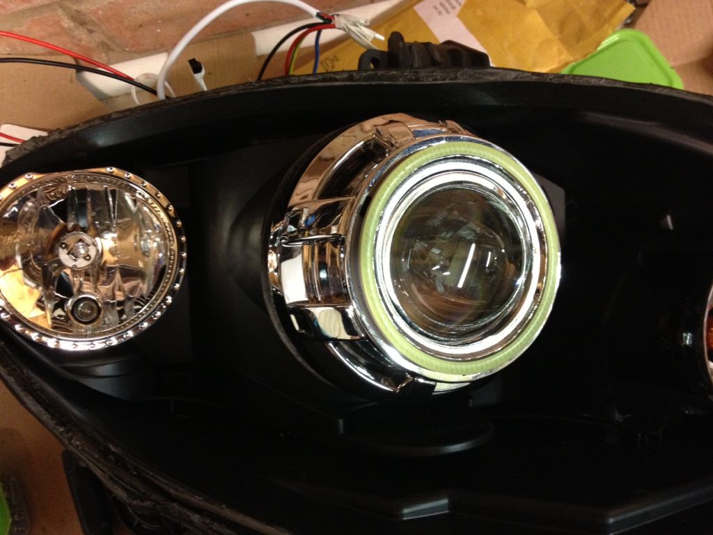

Give it a go...should be easy. I'll take a photo of an old set of headlights I hacked up to show you what the lens should look like inside and also the kickup piece....it's easier than you think!
By the way..here is an update on my lights. http://www.seatcupra.net/forums/showpost.php?p=4097504&postcount=4654

I got the projectors from China...took a month to arrive because I'm too tight to pay for express delivery!
As for how hard to do, I'd say 7/10 assuming you have the usual tools to hand and a bit of patience and time. If I had a good run at it I could have them made in a weekend but alas I don't have the pleasure of being single and childless!

Rob that looks like a fantastic job, mate. I love how the projector is just sitting there nicely inside the reflector and not 'over-done' like my previous, modified head lights. I have been having a hard time with the kick-up since it's truly annoying on my head lights, much more than the one on cars that come with OEM head lights and HIDs, for instance, and I believe they bother people on the right since that's where they are.
I was wondering if you can dig up the picture of how you eliminate the kick-up? And how do you do that by a coke can?

Yes they are, I've been In contact with the,m and the stuff they have is also from china....it's all made in the same factory so you can bypass one of the middle men by missing TRS. Also, useful help is on HIDPlanet...great website with people doing retrofits.
I'm sure a google search will bring it up or it may have been on HIDPlanet however I will have a look.
Also, it may have helped it I'd put a photo up in the daylight because I haven't used the reflector....went along the route of making a simple bracket which can adjust the beam position. Using the reflector basically pushed the shroud and projector too close to the front lens of the headlight. It all depends on the type of projector you go for due to size etc. here is a photo of it on my work bench to give you an idea of what it will look like.
Yeah! That's so much better, it looks like a perfect fit whereas the reflector does push it and makes it very close to the plastic cover of the head light, and as we all know HIDs and lenses get very hot which is bad for the plastic cover.
Hopefully in a couple of days I'll get my old head light units and open them. I am thinking of doing what you did, since I believe my lens and shroud (at least from the picture above) are exactly the same size but the shroud is painted black on mine, for some reason (the guy thought it would be cool, lol).
What's the best way to re-seal the head light? My friend sealed it using silicone (A LOT of it) but still gets condensation inside from time to time and we made sure everything from the back was in place so I don't know where it is coming from. I am most likely not going to be using it when I am done with it, but at the same time they will sit as a spare in case I unluckily break my current ones in an accident (hopefully not) or something rather than having to buy a whole new set.
What do you think? Is it going to be an easy process remove the reflector itself, cutting through the head light's plastic, and mounting the lens and shroud directly? And does the electric highness adjustment work properly?
Hey Rob, can you take pictures of the back of your head light? I am wondering since you mounted the projector and shroud directly in the head light (without reflector), is the rear of the lens perhaps sticking OUT of the head light unit? Or can you still put the cables and angel eyes' resistors inside and close the plastic cover fine?
Nice work Rob, can you please capture some pictures of the beams cutoff

Firstly, here is a link to a site where someone has adapted the cutoff. It's a similar principle on all projectors so once you get yours open you will see how they work. http://www.houseofthud.com/cartech/hids/
Tarek, don't use silicone to seal the lights but use butyl rubber sealant. Similar to silicone but the recommended stuff and also what most car manufacturers use.
As for doing your own, once you have the headlight lens off the reflector is held on by 2 small bolts which screw directly into the back of the reflector....very simple to remove. If you have a small projector and shroud then this will sit within the existing reflector once you cut the back of it, however as you have mentioned, my projector (once it has the D2S adapter on the back) sticks out of the back about 10mm. I have therefor cut a hole in the removable plastic cover and mounted a small extension on it. This is fixed with epoxy resin and silicone.
As for the electric adjuster, this works fine as its quite a large part of the headlight which moves, not just the reflector....once you open it up you will see what I mean.
Ahmed, I'll sort this out when I get some time....forgot to take a photo of it last night!
Will, I was originally going to mount the projector and shroud inside the reflector however because of the sizes and that the reflector is slightly oval it just didn't look right. It also made the shroud very close to the headlight lens which I didn't like the look of. If I were to get a different projector which is smaller than the FX-R then the majority of shrouds would fit inside the reflector. I think a Morimoto projector would work but they have a H1 bulb and I wasn't sure if that would cause any issues with the car....I stuck with the FX-R due to it having a H7 bulb.
I've made a very simple bracket to hold the projector and also fix using the original reflector mounting holes. The way I have done it is to make the projector easily adjusted befor finally setting it in place, I.e. up/down, left/right and also turning on an axis so the cut off beams are straight.
To hide the back of the projector and mounting bracket I will use a piece of DVD case heated and curved to the shape of the shroud. It works perfectly (I did a quick trial) and a perfect colour match to the headlight plastic.
Hope this answers your questions!
