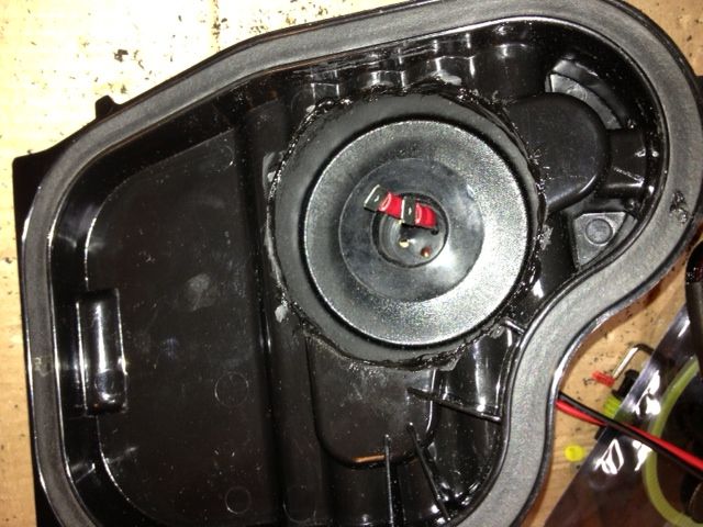

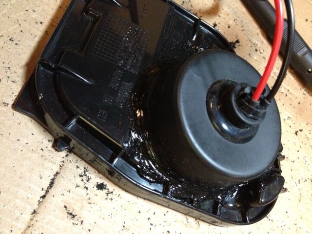

Practically yes, Will, that's all you have to do. However, it is technically not as easy as it sounds. Drilling a hole that would be perfect for the lens will not prove easy, and you'll also have to overcome the fact that the back of the lens will be sticking out of the headlight's rear, which means you'll not be able to properly fit the back plastic cover and will have to create something to close the head light with.
Also it would be better if you would point the head lights at a clear wall in front of you (rather than a floor), mark the alignment, and then try to match it with the lenses. Do it from a distance as it's different when you're doing it from a close distance.
When you're done with all of that, just clean the headlight on the inside, clean the cover really well, re-seal them back together and let them dry, and then install them to your car and do your alignment magic. Afterwards you're good to go. I'd buy the FX-R lenses because they are very good quality, look good, and have a great alignment if done right. I believe those are the ones Rob purchased as well.
Good luck, Will, and don't be lazy, just get on with them already!!
Tarek...here is the back of my headlight....extended and all sealed up with epoxy and some black silicone.
Rob thank you very much for the pictures. That looks very efficient and well done, in fact they look much better than the back of my retrofitted headlights (that don't stick out of the back), lol.
