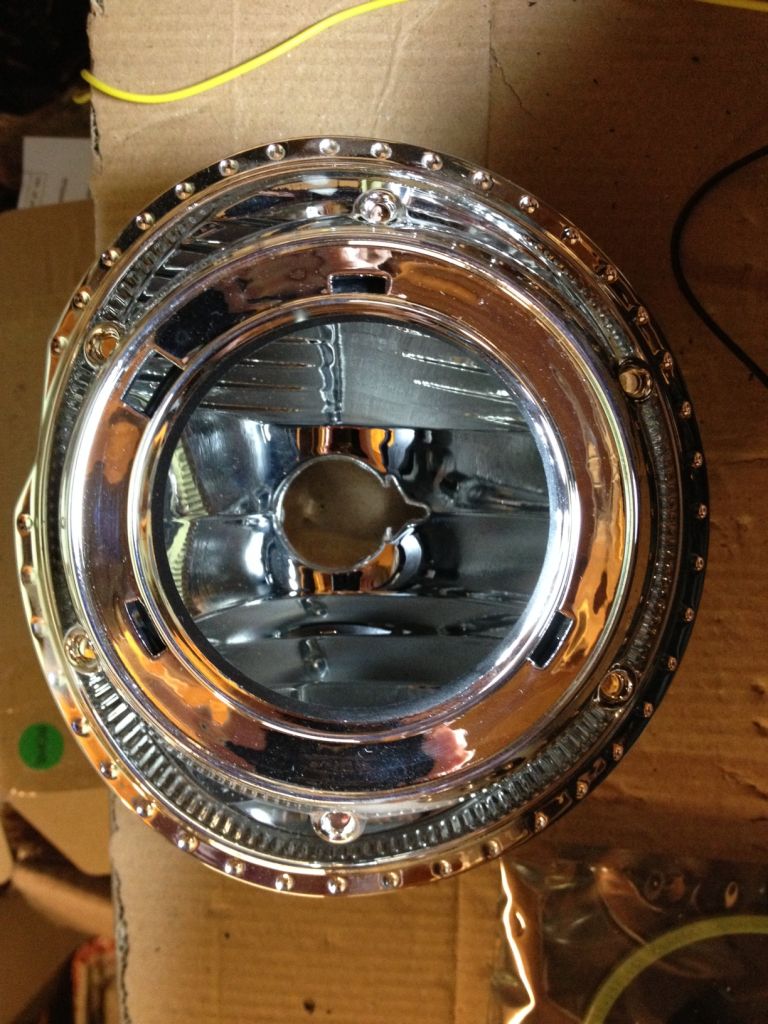

Just took this photo with a different shroud placed in the reflector. As you can see the reflector is slightly oval however this particular one fits inside the reflector. My projector housing (not the lens) was wider than the shroud which is why I didn't use the reflector, however the projector kit you have mentioned should be fine.
looks good rob,
I might actually split my current headlights, if i dont find any OEM projectors soon.

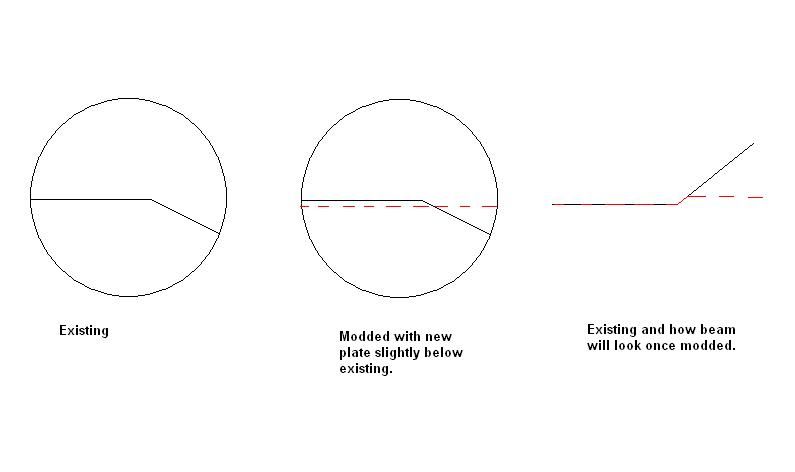

Is there a specific standard for the new piece of metal to creat the cutoff?
I mean is it just a straight piece which goes on the back of the original cutoff plate?
Because i noticed that there is a slight kick up on OEM xenons. So do we make a plate which goes like this? --> -------\______ OR like this? dead straight? ---------------
Sorry but its best way i could explain it^^
And sorry for asking so many questions mate! =/

Picture i quickly sketched up to explain.
Circle = Projector Lens
Solid Lines = Cut Off Plate
Dashed Lines = Standard Cut off plate behind the new plate being made
Which Option is correct? Option 1 or 2?
Hope the picture helps :D
Appologies for all the questions!!

@Willz I am pretty sure Option 1 is how OEM projector lenses are done, however if I opt to do mine it'll most definitely be Option 2 because it just looks much better, especially when you look at the alignment on the back of the car in front of you.
I am not sure why the kick-up is important, but I am guessing that the car could fail the MOT test without it? You'll have to ask about this.
That's the thing, though, Will, do we completely remove the old plate and insert a new one or do we, perhaps, add something in front of the old plate in order to make it a straight line or create whatever kick-up is desired? And how do you actually access that plate? Do you take the projector lens itself apart or is it easily accessible once you have access to the lens?
Will, you're nearly there with your drawing....I've done one on the PC so you can see it a bit better.
Basically, there is nothing wrong with the current cutoff you have, its simply an asthetics thing. In fact its probably safer as it lights the pavement side of the road more.
As you already have a kickup all you need to do is add a straight price of metal to bypass the cutoff angle but retain a small section of it (I think the diagram show this well enough).
With regard to how to do this as per Tareks post, it all depends on how your particular projector is made and fixed together. I have one set in the garage at home which is two halves of the projector (front lens section and rear dome reflector) literally held by 4 screws. Once the two halves are seperated a piece of metal comes out....it's that simple. Here is a photo of the one I have lying around with some notes on it.
Once you have pulled your headlights apart and then removed the projector you can see how it's made...it may be easier to screw a modded plate to the front or make a complete new one if its as easy as the photo above.
Finally, with regard to MOT, the lens will need the cutoff and will fail otherwise. There are also certain criteria with regard to the distance between the two cutoff lines (both left and right headlight with 3-4 feet in between) but there are loads of guides explaining this on the web however here is a good one. http://www.edgedp.com/retro/STEVO210RETROFIT.pdf
Anymore questions?!?!?! :D
