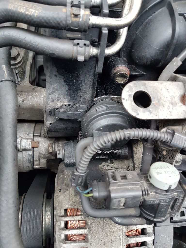

Been a while since Ive had to post on here. Basically was driving pulled up at a car park when the engine just cut out. Started the car back up but as soon as I pressed down on the accelerator pedal the engine would cut out again. Managed to coast it into a parking bay for further inspection.
As you can see its lost oil somewhere. Fortunately I managed to get it running again before it completely cut off and, ended up getting towed home. I have yet to plug VCDS in but with no warning lights showing, not sure what I'll find. Ive rang SEAT just to check for any outstanding recalls on the car with no luck. Has anyone every ran into this problem before? Before this the car was running perfect, no symptoms what so ever. Any help or advice would be greatly appreciated as always.

Where the oil residue looks to be is beside the inlet manifold if I'm not mistaken? These are quite bad for the actuator not staying sealed properly and let's gases and oil residue out, but I'd think you'd see a lot more carbon and soot all over the bay. Could possibly be swirl flap failure? If they're jammed shut when you try to rev it, they won't open to allow enough air through and it'll just stall.

I think you need to pull the inlet manifold off and check the condition of the swirlflaps, they maybe showing up a function but my FR had similar oil weepage, I ignored it like a fool and then a swirlflap was injested into the engine.
In there is probably caked in crud and it may need a clean out using carb cleaner or similar. You can blank off the swirl flaps and do an EGR bybass if it's bad....

I think there was about 10 splined bolts and another 4 on the egr, I did mine in 2012 and nothing jumps out in my memory as being a mare when I did it.....just beware when you get in there it will like a jar of bovril **** itself, it's not a pretty thing to look into. You can get a manifold gasket and it would be worth having and changing while in there
