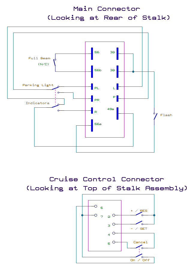

Well, I've just replaced my indicator stalk using the first part of this guide, and thank you very much for that - it's an excellent walkthrough! I was having the funky clicking issue with the relay, and eventually the bloody thing started indicating right constantly. All's well now though!
As a thankyou, I took the liberty of doing the pinouts of the stalk, since a couple of people seemed interested... Enjoy :)
Actually, it seems I can't post here since I don't have enough posts made yet... But copy and paste this into your browser and you'll have the pinouts:
robthenerd.com/misc/leonstalk.gif
Edit: Someone else feel free to embed it in a post if you like! Oh, and sorry, I didn't get the wire colours... And I'm fecked if I'm taking it out again :p
Nice pinout, one of the on/off pins you've identified will be 'cancel'. You can hit cancel with a flick towards 'off' but without going the whole way
You're right - I did dissect the old stalk, but wasn't sure why one of the sets of contacts disengaged before the other. In this case, it's pins 4 & 5 that break first so I guess they're cancel. Didn't realise that was a function! :p I've updated that diagram now to show the different functions.
