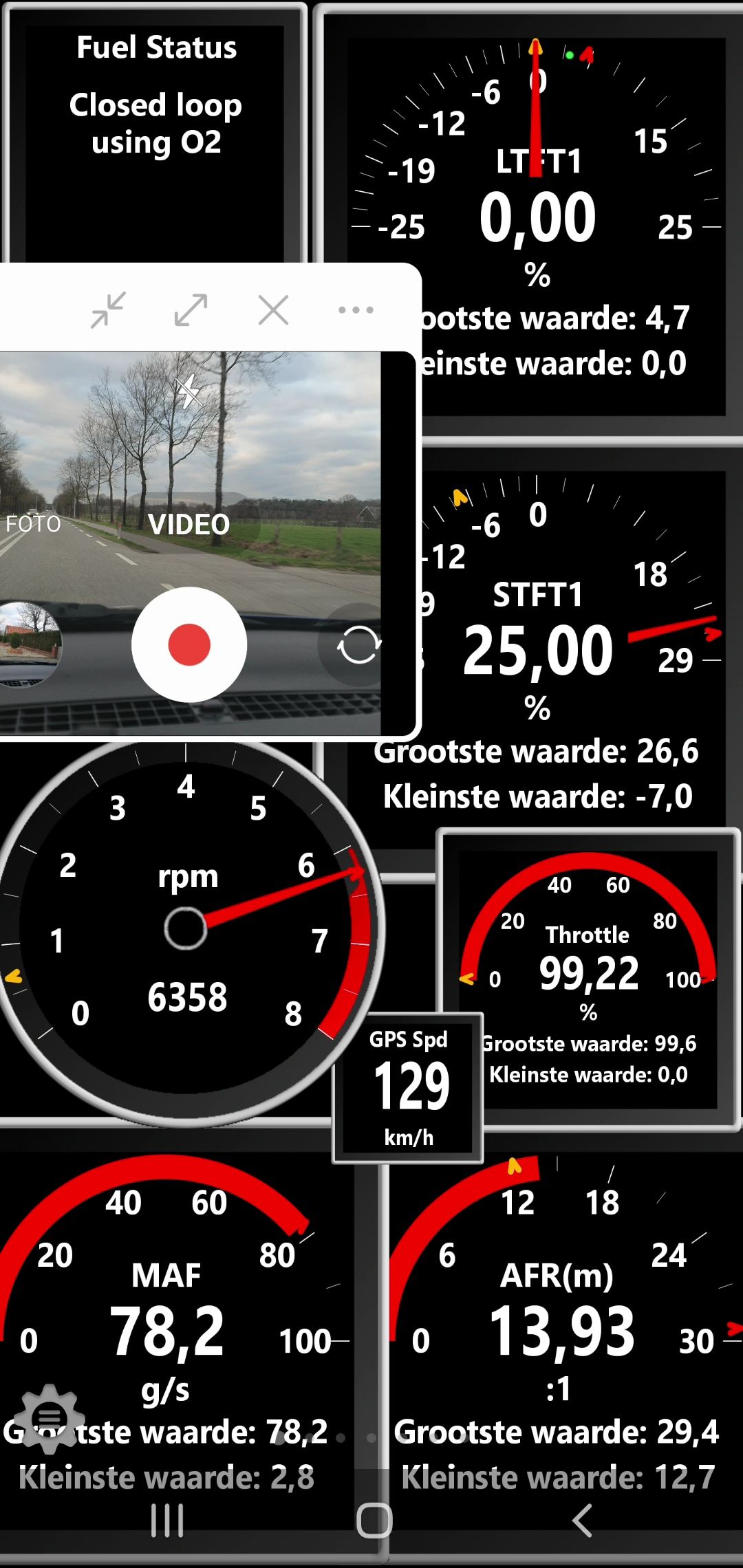

Well.. did a full run to redline in 3rd gear..
Do those maf readings look okay or was i in the wrong gear?

Looks quite complex. But perhaps there is a duff sensor input throwing the fuelling calcs out. It's a computer, therefore GIGO.

could it be the MAF? (as mentioned, at redline, 3rd gear, 78,2 g/s)
I did try an new delphi MAF but i've read on multiple forums that u absolutely should NOT go for aftermarket?
(my car was behaving weird with that delphi MAF, sort of limp mode @50 km/h and did not go above certain RPM)

back of fag packet, 1200g air is 1m3, 1000 litre,
78,2g/s is (78.2/1200)*1000 l/s
that's 65 litres of air a second,
Is that believable?
6000rpm, 100 rps,
engine, 1800cc? half the pots breath per turn, pumps 0.9l per turn.
pumping volume 100x 0.9 litres a second.
That's 90 l/s at 100% no losses breathing.
Breathing efficiency 65/90 = 73%
It's believable.
Best check the figures, as I am having a couple of beers.;)

Does that mean the MAF is good or bad ? Wasn't good at math lol
I've heard of the formula that your maf reading should be around 80% of the HP of my engine, in this case;
125HP / 100 x 80 = 100 g/s

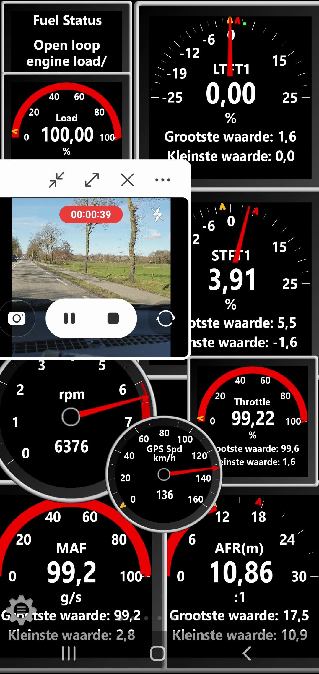

Well.. i think i found the problem
New full redline run with a new BOSCH MAF.
Here's the video:
(Starts on 0:22, 3rd gear pull)
Going to top of my fuel and see what mileage I get (instead of around 300/350km on a full tank)
Looking at the video, seems you heard dead right!;)

Glad you got to the bottom of it in the end. That's quite the difference in maf readings.
Yeah, but let's see the fueltrims on the end of this week.. there's still something wrong tho.
STFT don't spike up at all on throttle so that's good, but currently the LTFT is at around 12% positive.. I do hope it doesn't get higher so it doesn't trigger the CEL (for selling purposes)
