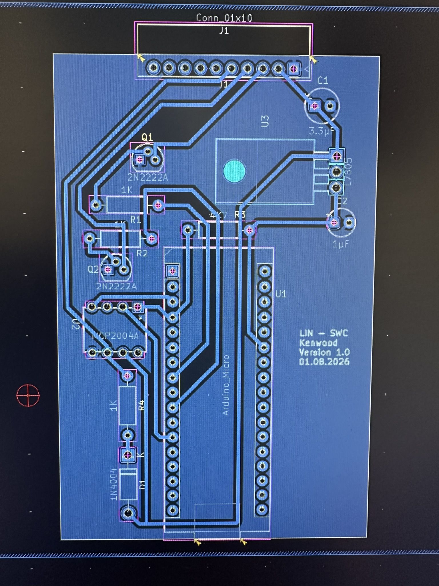

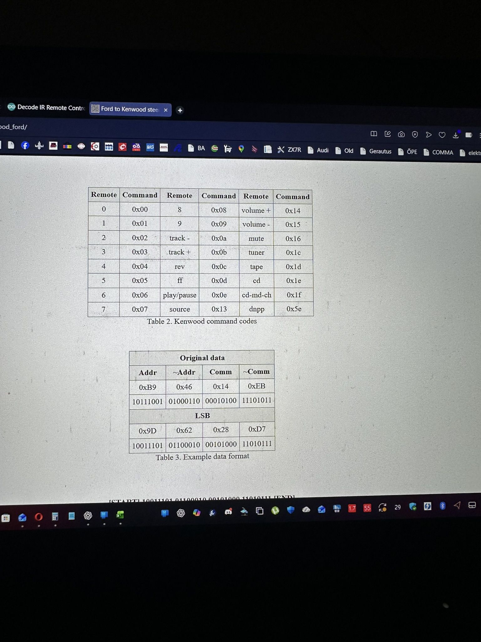

Finaly steering wheel buttons are working. Headunit changed to Kenwood and custom adapter in between steering wheel buttons and Kenwood.
Horn is also working through this adapter.
It took sometime to test and make it all work, but I am proud to not to give up.
