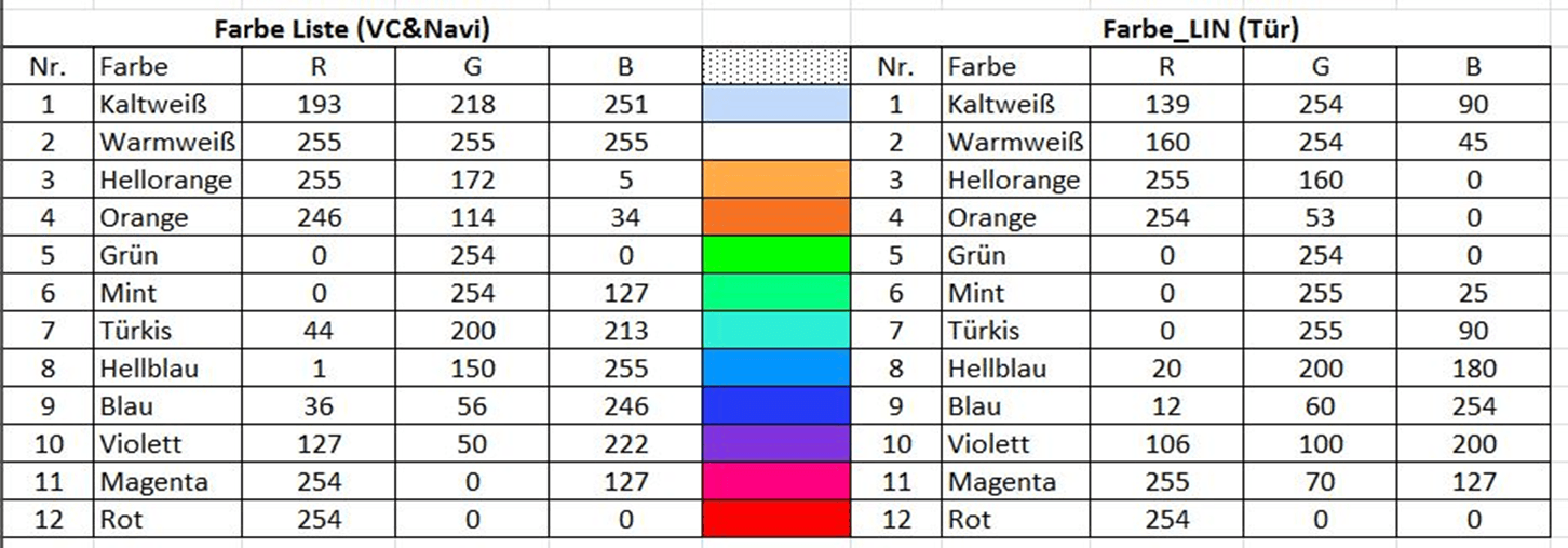

There are two sets of colour "maps" one for the infotainment and one for the physical LEDs, sounds like the LED Colour channels have not be set after the green channel.
For Example Colour no 1
these channels set the LED Values
IDE12412-ENG154733-LIN Ambient light color list-Rotwert_Farbe_1_lin
IDE12412-ENG154645-LIN Ambient light color list-Gruenwert_Farbe_1_lin
IDE12412-ENG154526-LIN Ambient light color list-Blauwert_Farbe_1_lin
These Channels set the Infotainment Values
IDE11714-ENG126825-Ambient light color list-Rotwert Farbe 1
IDE11714-ENG126826-Ambient light color list-Gruenwert Farbe 1
IDE11714-ENG126827-Ambient light color list-Blauwert Farbe 1
You would need VCDS or OBD11 or Carista to set these values correctly.

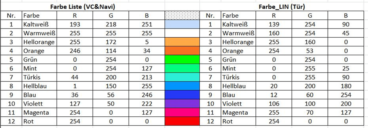

These Channels set the LED Values
