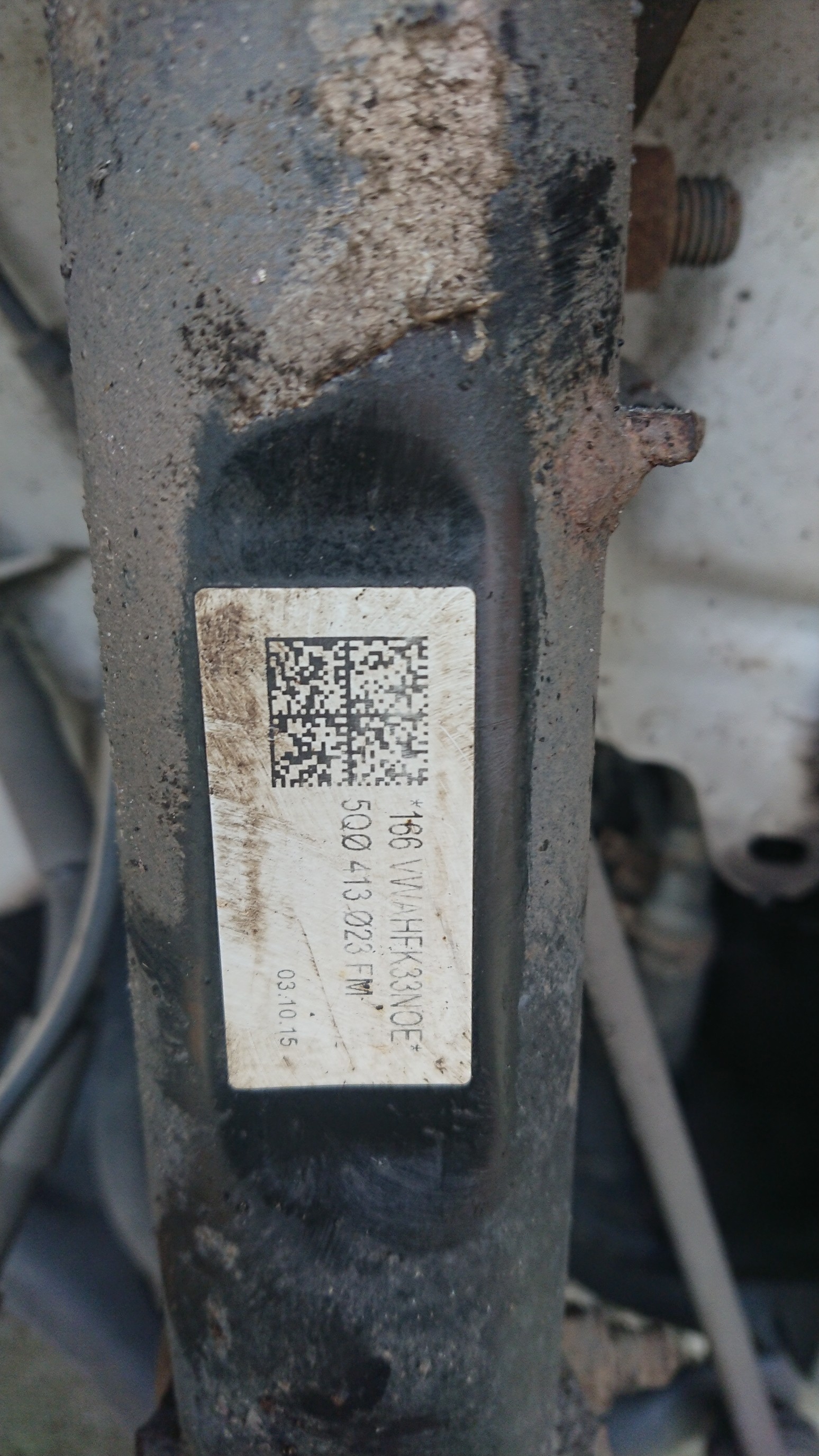

I couldn't work out what the original ones are manufacturer wise, perhaps someone can confirm?
From what I can tell most of the VAG shocks in general, normally SACHS ones are interchangeable as same fitments but different strengths and stiffness, my mate has a GTD and and I wanted the same shocks on my FR as he had as mine were two soft. Called up a company that supply genuine VAG parts and just gave them the GTD reg and ordered genuine shocks that they recommended, they were SACHS, but yeah I changed them all, fronts and rear as otherwise front won't have been stiff and backs soft. Which would not have been good to drive.
The GTD shocks were 85 a shock for fronts, 68 for rear. When I gave them my fr reg they wanted 50-60 for fronts and rear (obviously different rated shocks).
