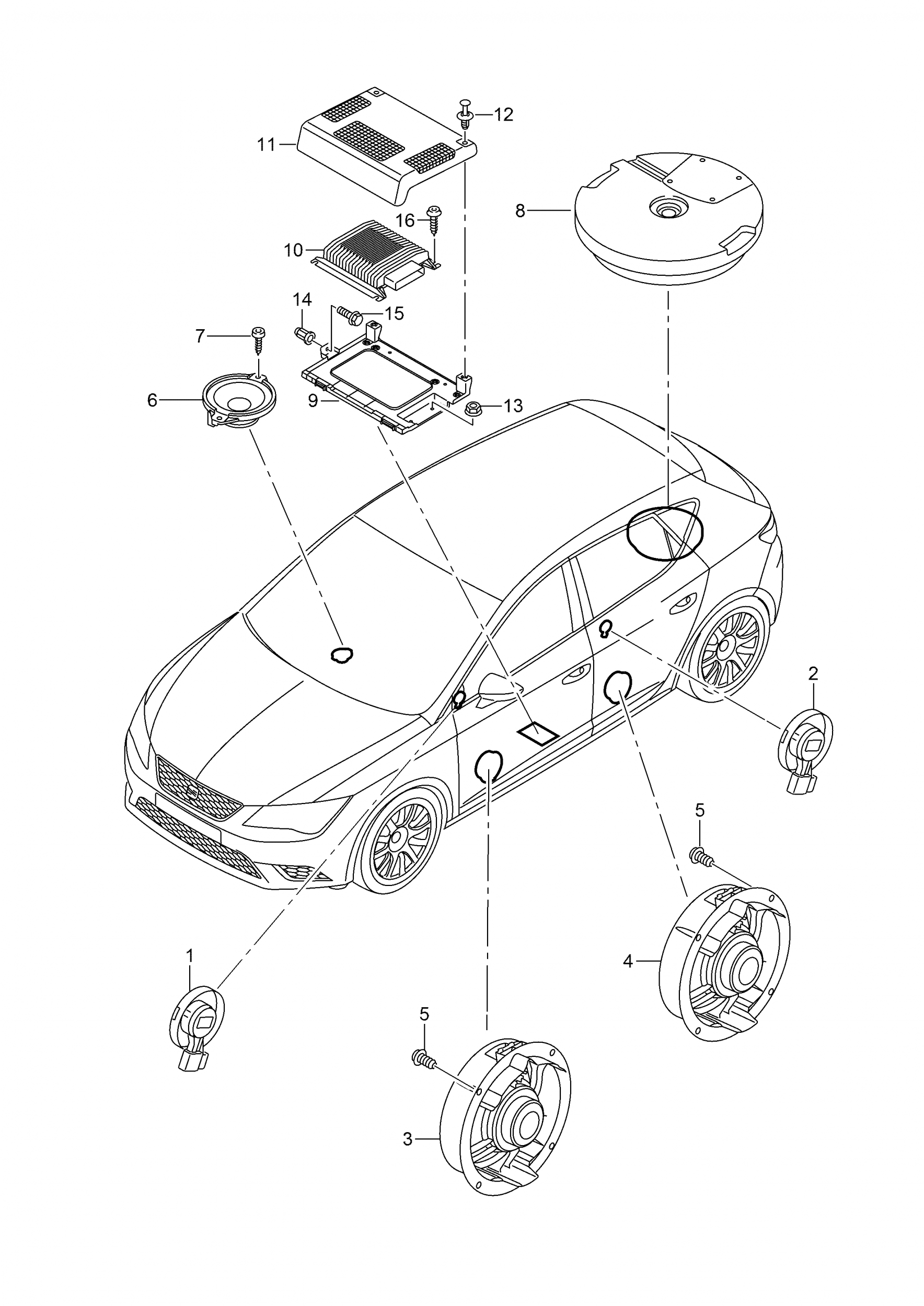

I can confirm that is the case. There would be no room for the sub in the boot. I would love to take a picture and show the floor layout, but the car is currently at the dealers with an electrical issue ?☹️.
Indeed, the Subwoofer goes into the boot but there's no room because of the battery. See#8 in the attached image (ignore car model, it's the same system and same placement in mk4)

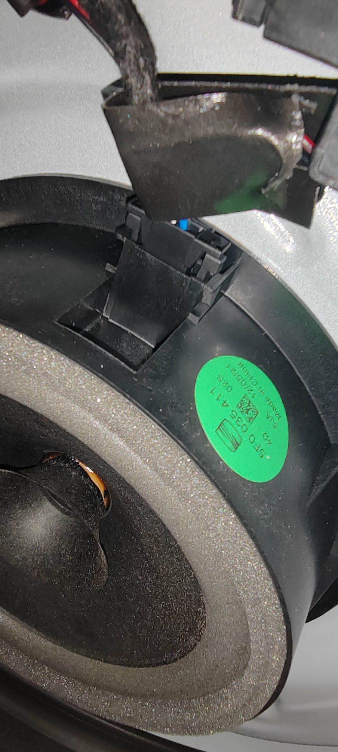

Does the hyrbid has 2 tweaters in the back, i looked with a flashlight and it seems that they are in, but no sound is coming out?

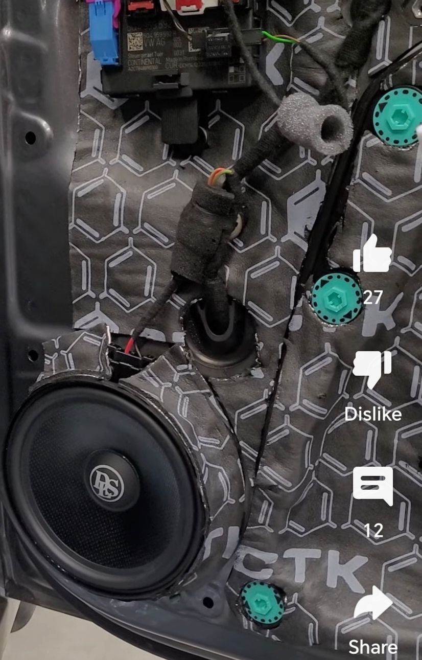

There is no tweeters in the back door on standard radio system, and base speaker at rear doors are cheap dual papercone ? there is no much out there to fit standard connector (same as Audi or leon mk3) bonus is they are 6.5s and fronts are 8s plus nice to have is dash center speaker.
I have added vw tweeters to the back and will replace standard dual cone with audi base units 6.5s hopefully will sound little better, door cards are bit hard to remove as just the handle has 3 or 4 elements that needs removing.
As you there fitting sound deadening will make stereo sound 2x better so I highly recommend.
Speakers... I think they are 20w each and 4ohm .
