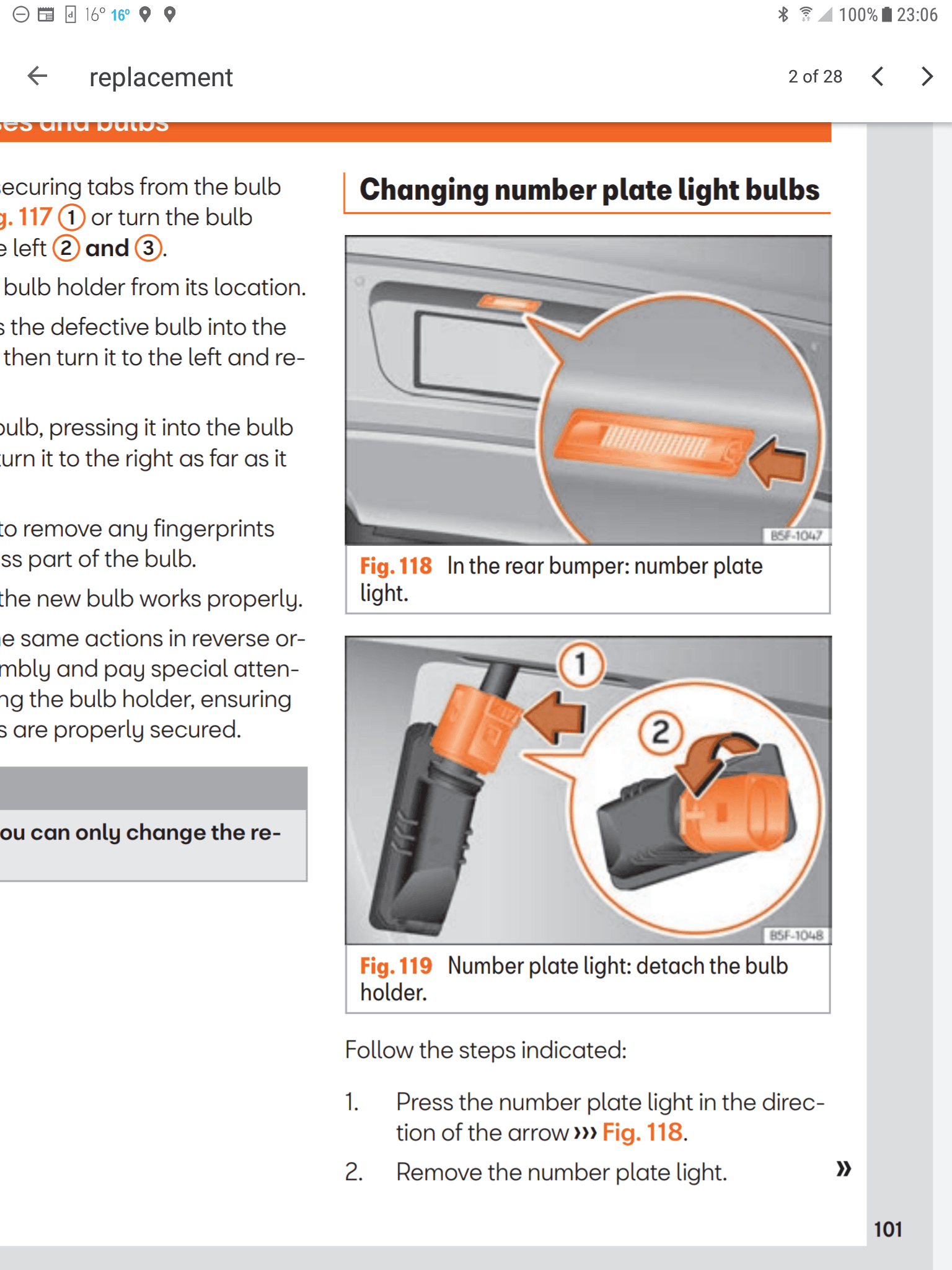

Hey Guys,
Anyone got the instructions on how to replace the back license plate led lights?
Thanks
Hey Guys,
Thanks
Here from the manual:
Reactions: hamst
Hey Tell,
Thanks, thanks for the info. I just checked. Mine are LEDs they are not dead, but somehow water came inside from a very heavy rain week, so now there's like risk i think so ill just buy a replacement and change it myself. Its just plug and play kind of thing.

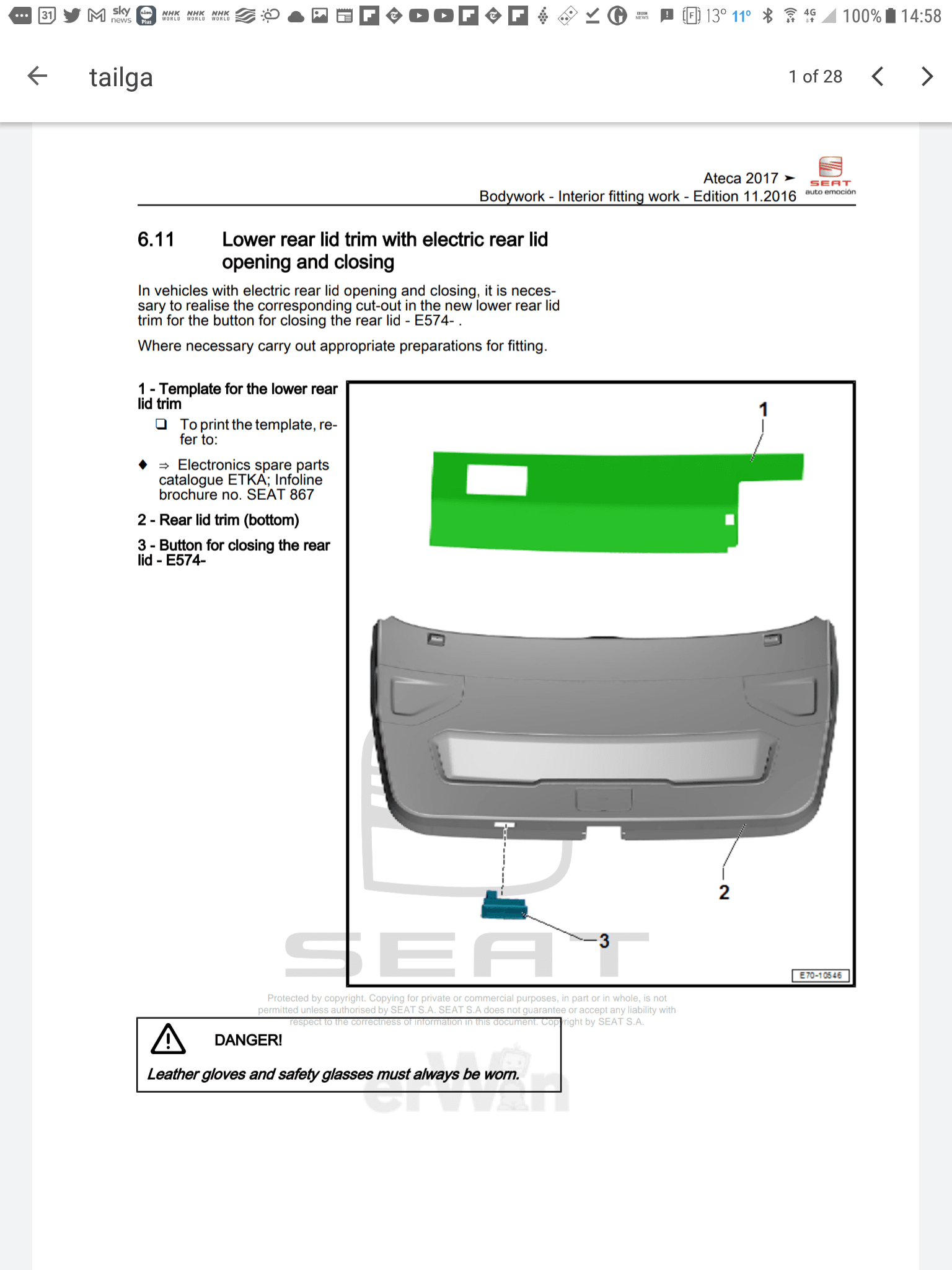

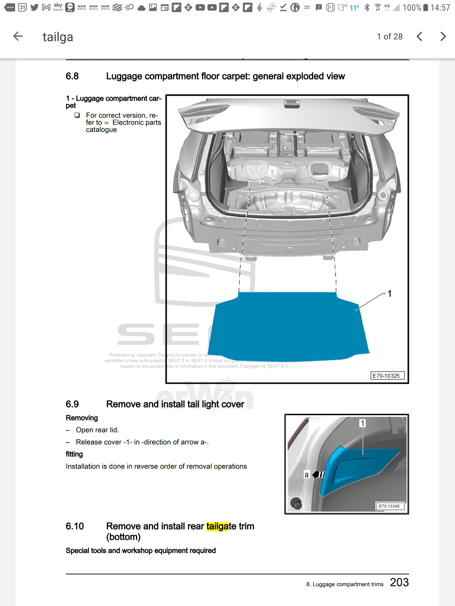

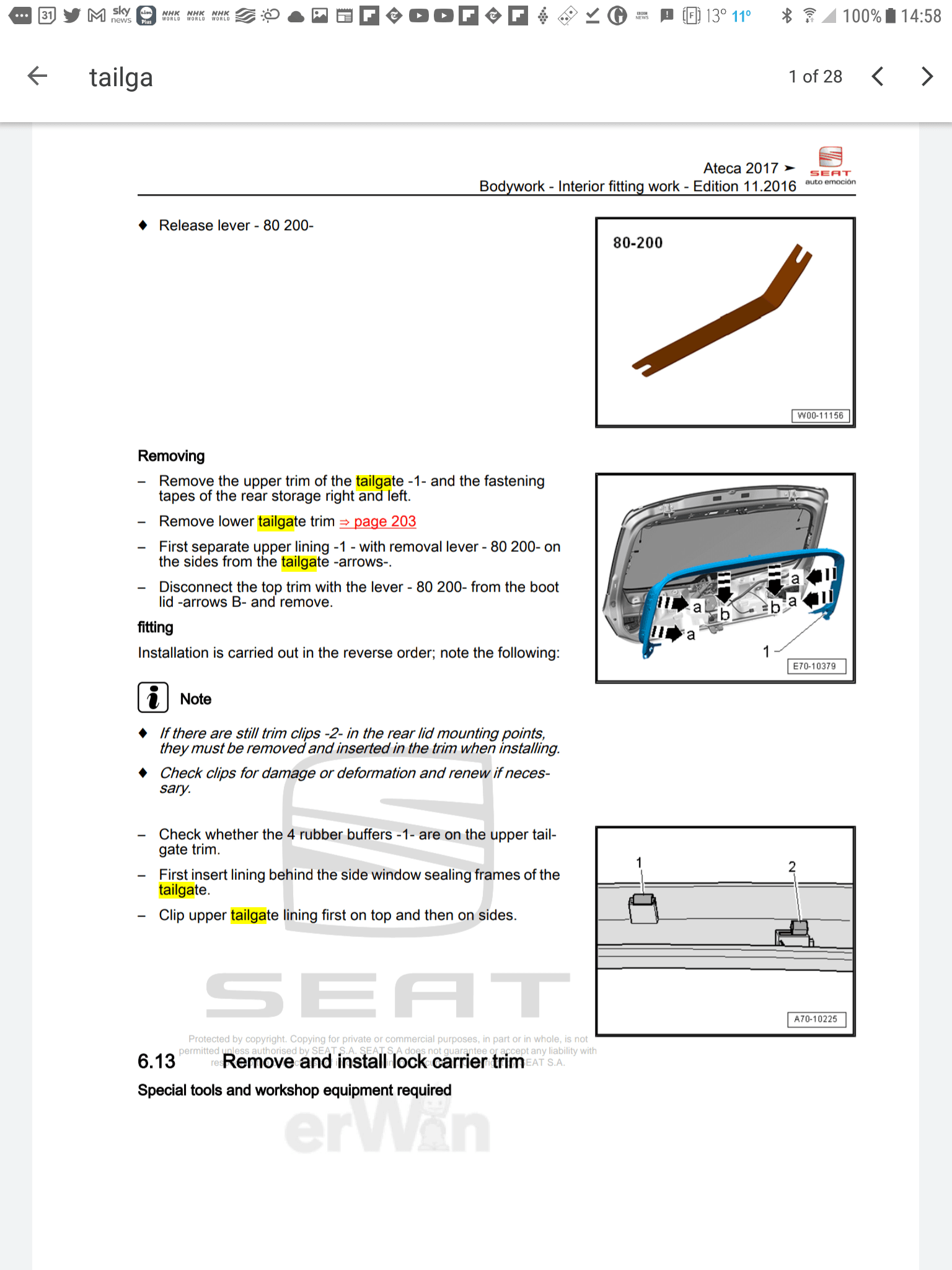

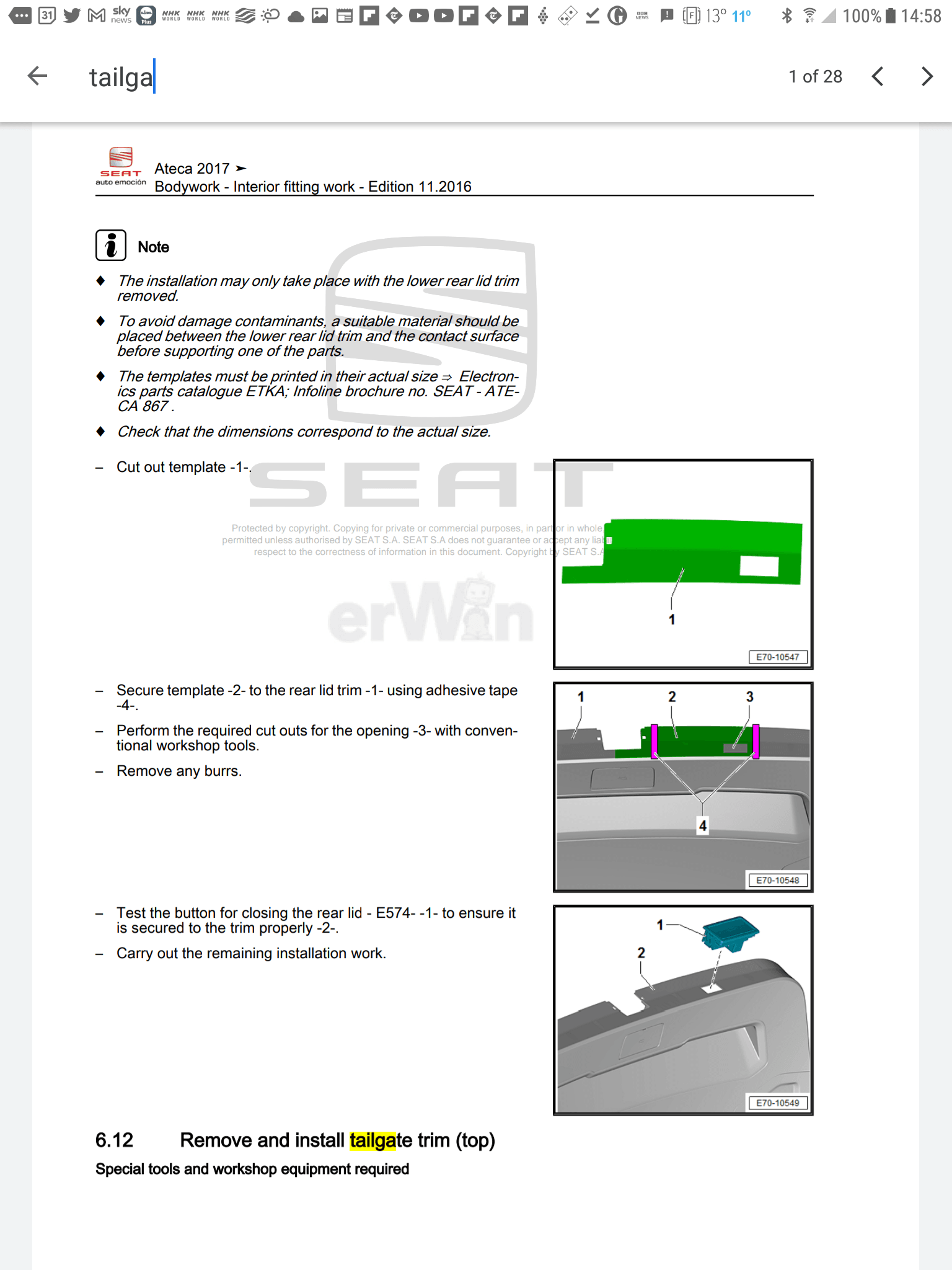

The whole interior plastic cover thats attached to the tailgate. Basically I want ro have access to the camera from inside the car, to be able to replace it(its the camera, button and washer all same unit)
Thanks
It's in the Erwin download of pdf manuals. You buy 1 or 2 hours of time, 7 euros an hour and download all the pdfs of interest plus the SSPs plus the build codes off your VIN, then you have the same information as the workshop. It's worth it.
