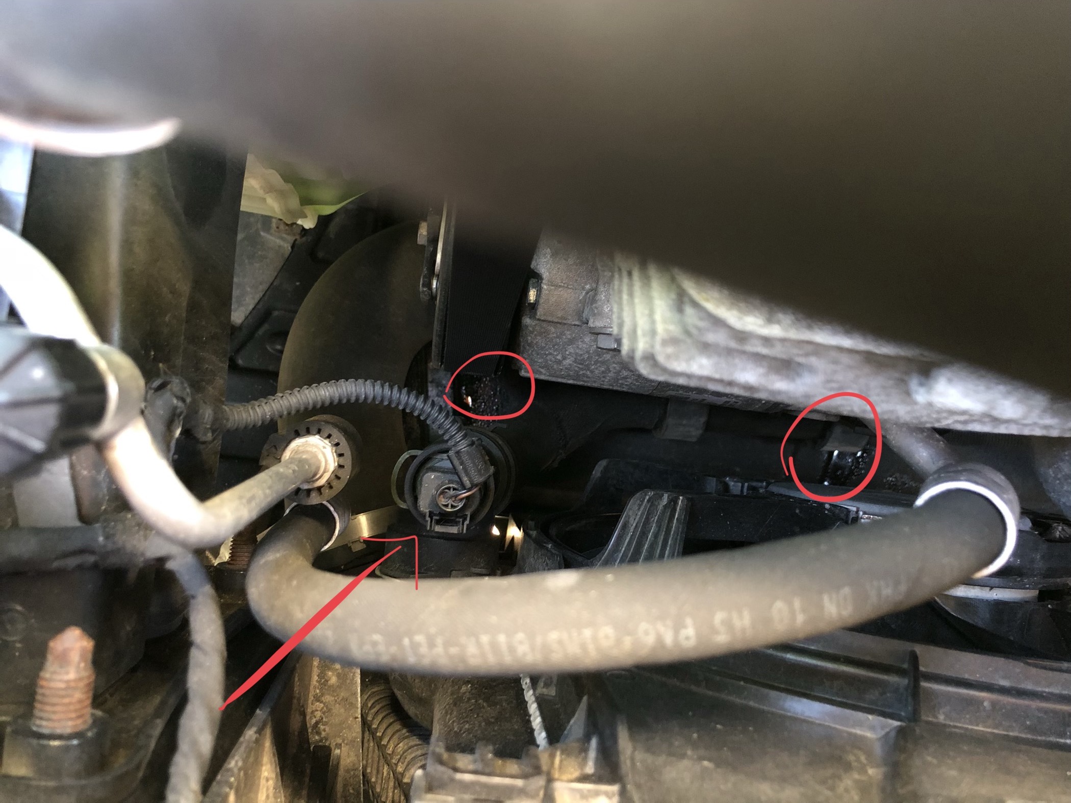

So last night i had a proper look around for this leak, and basically i cant find anything that appears to be leaking in the engine bay! i mean i am only looking from the top of the engine as i cant get under it but absolutely nothing!! everything was tight and dry, most of it looks still brand new.
Am i right in thinking the Thermostat is the thing i have pointed at in the image attached? if so then this is squeaky clean with no moisture at all! also circled a couple of the puddles down on the under tray. (image taken from the front of the car looking down behind the radiator)
Took the car for a 20 minute blast and parked it on the other side of the road (so leaning to the passenger side slightly, opposite to the way i found it with the puddle under it, drivers side) and have come out this morning to fine a tiny spot of fluid under the drivers side again (the side i found the original puddle and the higher side with how its parked)!
its gonna need a check i think but gonna take it for a 60ish mile blast on Saturday to get it hot and give it a proper drive, maybe the short runs has something to do with it!

zeffania
Nov 4, 2016
479
159
Could it be your AC, was it warm when it happened? They usually let some out under heavy use, I forget the technical term, but it isn't anything to worry about.

Yeah it was hot, hot enough for the AC to be on full whack when i got in the car! thing thats troubling me with the AC theory is the liquid i found under the car the other day felt slippery! not like water and its left a bit of a stain on the road from the original puddle! so it cant be the condensation can it? unless the condensation thats dripped down has mixed with something on the under tray and thats why its a bit oily feeling!?
