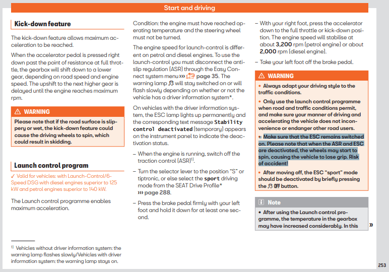

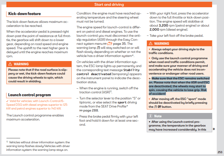

As in the screen shot I posted you are supposed to leave ESC ON - otherwise the manual says you can get wheel spin!

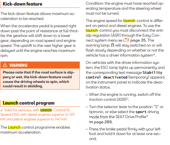

The manual says to turn off/disconnect ASR (Anti Slip Regulation) - NOT the ESC (Electronic Stability Control)!
And says if both are turned off you'll get wheel spin.
Are you saying you can't do this? Turn ASR off and leave ESC on?
ASR and ESC are two different systems.

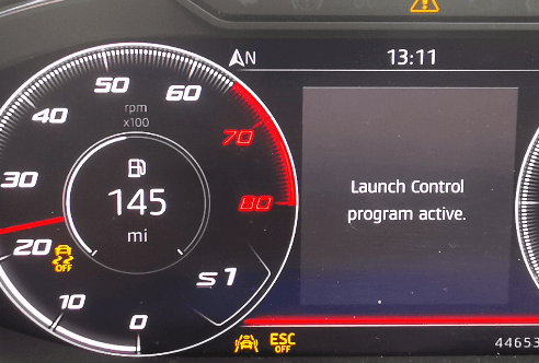

So i see your point here and thought i would go and have an actual; look, aaand the plot thickens
here's the dash in the only setup that I can do launch control with (or at least i thought that was the only way).
ESC Definitely off..
but in my manual it says the same as yours only turn ASR (which the manual defines as traction control) off for launch control to work.
However I have no settings in the Easy connect system contrary to the manual for my model to do this which is what I think the confusion is. I only have ESC settings :unsure: I think the software has been updated and the manuals haven't, or the cupra is wired differently to the leon.
though would be intrigued to see if this is the same on anyone else's 18 plate cupra.
If I do not do that highlighted in green, and have the car in cupra mode (though admittedly i have never tried it in sport) the LC will not activate. as it now looks like for some reason this is the only way I have to disable ASR completely
That being said, it still means that even according to seat you have to turn off traction control to make launch control active. when surely launch control is supposed to be a slightly more involved traction control. You cannot launch if you are not controlling the traction. or am I missing something here. Also stupidly this turns off the other esc systems one of which is the electronic differential which seems even more counter intuitive.
Im gonna find a carpark tonight and see if i can get it to work in other modes because now you got me thinking. think my neighbours might object to me doing it on my street..
Nub of it is though whatever the settings are it's utterly useless.. you spin the wheels like mad and go nowhere

I stand corrected, well sort of as it seems its not as straightforward as you'd think it should be. I found a quiet carpark and did some messing (will be quite odd if the warehouse looks at their CCTV and see someone one in a car launching themselves up and down the carpark like a pleb)
So here is the way I thought is the only way to get this to happen. But i was wrong (a rare occurrence! :p)
Pull up to line, switch to cupra mode (I generally don't drive on Bolton roads in Cupra mode as I have vertebrae that I would like still intact..), press and hold the ESC/TC button on the dash for 5 seconds - ESC OFF. LC activated. Tyres melted..
Here is what i tried and failed
Pull up, switch to Cupra, tap the button to go to ESC Sport only, LC did not want to engage. No switching modes etc seems to make this want to work once stopped
Pull up in Cupra mode, tap the button to go to ESC Sport only, LC did not want to engage
And now ladies and gents, this is what worked...
Pull up, switch to Cupra, switch esc sport using the easy connect menu, not the dashboard button . LC engaged < why the button on the dash and the mib setting is treated different I have no understanding. I can only think a little bug in the software or something, because when you press the button on the dash it changes the option in the menu so surely they are the same thing :rolleyes:
Pull up, already in Cupra, already in ESC sport (button or MIB), LC will engage.. every time < this is seemingly the best way to do it in my car.
Soooo, frankly after all of that it seems that if you press the buttons in he correct order well certainly in my motor you can do LC it with esc sport on...
Yeh again, if you plant your foot to the floor you bounce the wheels like mad but to be honest it does this in LC mode or not really, the tramping is more toward the top end as the power really spools up. However it now seems a lot more controlled in the first phase of acceleration which is always the ropey bit in the fwd with ESC off..
So there you go... I am still a bit confused as to the switching it on process being inconsistent. But thnk you SuperV8 for questioning it and making me look into it further as I have found a new toy to play with for a bit on the car and actually oddly it is simpler to do and better..
