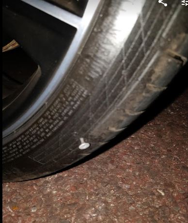

I got a pressure warning on my dash the other day and found a nail in the side - non repairable. The tyres were 2 weeks old! Annoying. View attachment 1962
Tyres shouldn't really be repaired if the damage is on the sidewall as this is the load baring part of the tyre - I think it's only safe if the repair is within the 75% of the tyre surface, so the edge or sidewall is out of the repair zone.
