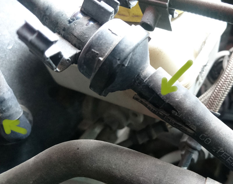

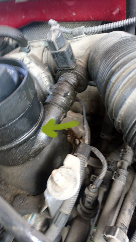

I was able to do a quick check yesterday and I found two hoses where the ends had started to split up. One goes from the top of the engine to a connector and it connects to the next broken one. It goes to what I think is the brake servo. When I had the engine on I could actually hear the hissing noise from that one.
So, are those the leaks I'm looking for? I'll change the hoses anyway, but maybe I should look around more in the engine bay, I haven't gotten any mirror yet to see those tricky places.

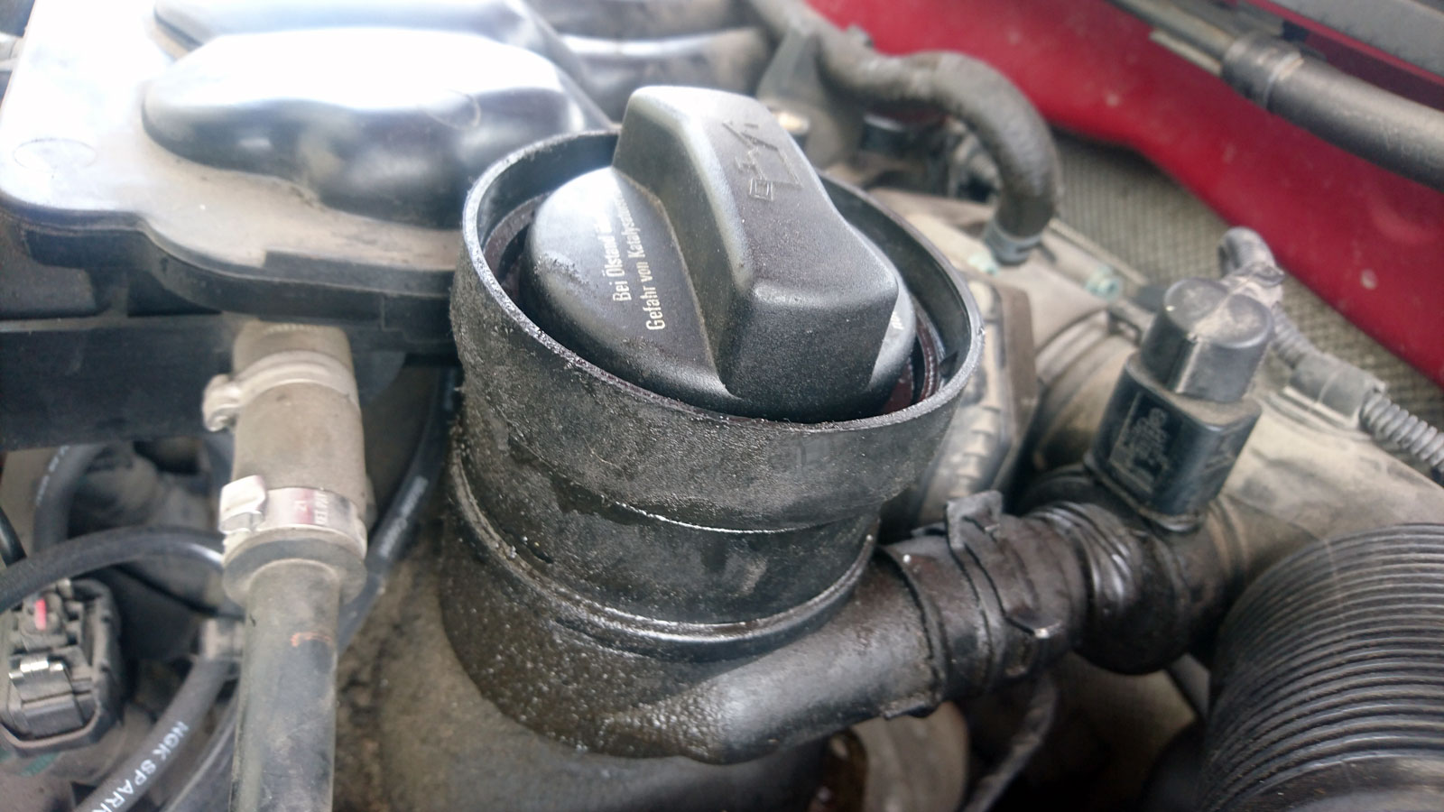

I also got a tip about PCV, crankcase ventilation. I was told it could also cause air and/or oil leaks. After some googling I managed to figure out where it's located and how it looks like. When I took away the engine covers yesterday I could see it looked wet and dirty around where it's located.
So, I suspect that might be part of both the problems.
Attaching pictures of both the broken hoses and the PCV.
Yeah mate, that was exactly the kind of thing you were looking for! :) A big leak on the brake booster pipe would definitely cause a rough idle and almost certainly that code too. The engine will be breathing in air which it hasn't measured through that split and that will be the cause of the issue.
I'd definitely replace that, and the PCV too if it looks like it's leaking. The brakes will still work fine with that kind of issue, but you may find you need a lot more pressure on the pedal to get the same amount of braking effect.
I would still look round the engine bay for leaks as these cars are getting old now and it's common to find more than one pipe split.

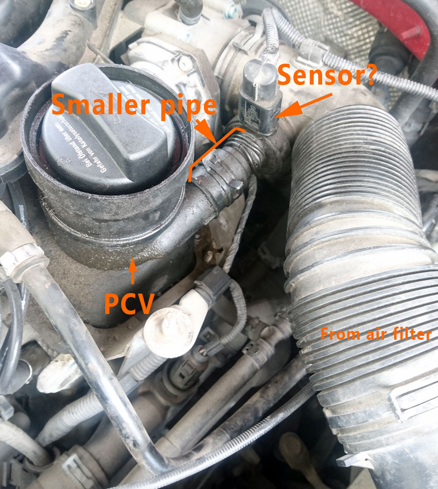

I've been looking more at leaks and at the PCV today and found what might be another leak.
From the hose/pipe from the air filter there is a small pipe going to the PCV and it seems like it might be a small hole in the ”accordion” like part of that pipe.
I've been looking around for the spare parts: the PCV, the hose/pipe from the brake servo to the engine and the pipe from air filter to PCV.
But I've ran into some problems finding the correct parts.
1. The hose from the brake servo, should it be with a non-return valve? Should it be for mechanical throttle or electric throttle control?
2. The air filter pipe. I can't find that smaller pipe as a replacement part, only the big air filter pipe with the smaller on it. In my car there is a electric connector on it, for what I guess is some sort of sensor. I can't find that kind except for in some original parts shop where it is too expensive.
Is that smaller pipe removable from the bigger? And what would be the part nr. to replace it with? Or can I replace it with any hose that would fit? I'm attaching a pic so you can see which part I mean.
3. How do I remove the PCV?
Thanks again for the help!

Hi again mate. To help solve all these problems you will need to look at your engine to find the 3 letter identification code. For example mine is AUQ. I'm not exactly sure where it is on the 1.6 but if you look around the top or possibly even the side of the engine, you should be able to find it easily enough. Here is an example of what you are looking for.
images
Once you have found that you will be able to use this site to help you indentify which parts you need. http://www.oemepc.com/seat/parts_ls...001/hg/1/catalog/se/drive_standart/205/lang/e
I would also be 99% certain that your engine was also used in one of the VW golfs from around that time, once you find that engine code you will probably find that one of these two haynes manuals covers your engine.
https://www.amazon.co.uk/Volkswagen-Petrol-1998-2000-Service-manuals/dp/1859607276
or
https://www.halfords.com/tools/gara...nes-vw-golf-and-bora-01-03-manual-597468.html
In the mean time
1. The non-return valve is the big black disc shaped thing that the split pipe on your brake servo is connecting to, you shouldn't need to replace that as well, just the pipe should be fine. Not sure if it's electronic or mechanical on your car. Finding the engine code may help decide, but if not you could have a look at the gas pedal and see if you have a cable that connects it to the engine (mechanical) or two electronic sensors (electronic).
2. Engine code should answer that too, although if the hole is very small you could maybe use some aluminum tape or similar.
3. Again once, when you have the engine code, hopefully the haynes manual should answer that. If not then if you give me the engine code i can look it up on a thing called Elsawin for you.
