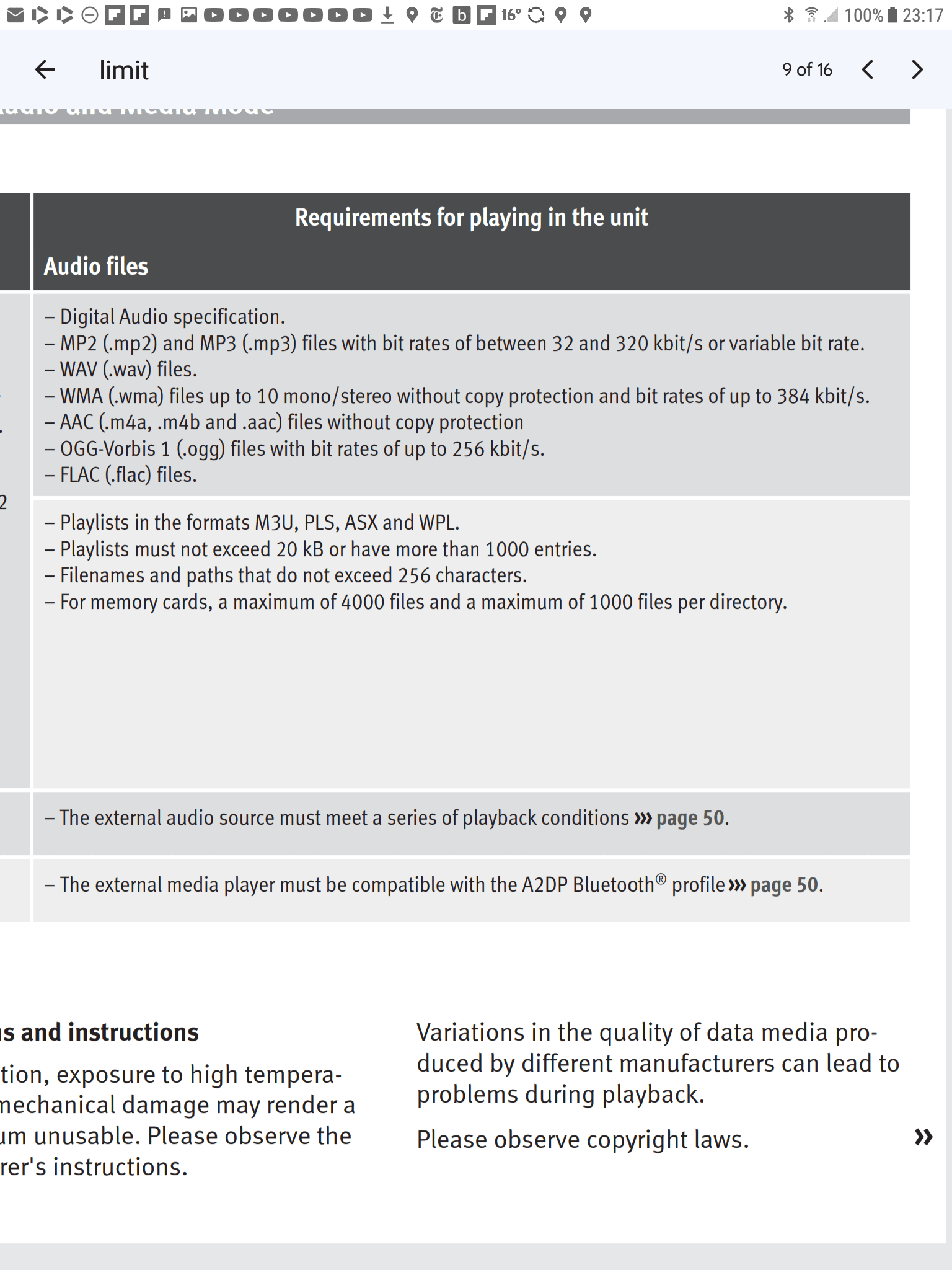

On mib2 I play them from the file menu, you can play them from the tagged file data. There is also a limit on the number of files you can have in each directory. Since it isn't a PC or Mac it just doesn't see beyond that limit so won't play the files. Some people get over this by splitting the files into subdirectories so they don't go over the limit. I only use FLAC so unlike mp3 I keep in those limits so I don't have that issue. Might be @Seriously? Who had that scheme. Someone did.
Hit the limit at 1,000 so if indexed you wont see anything above that. Then you have limits on the filename. See mib2 limits:
I seem to recall the mib3 limits are relaxed. Worth checking the manual if it's one of them. Mib2 is an old style program with list pointers and stuff. I wrote programs like that many moons ago. The array is a fixed declared length so you run out of puff which is the mib2 limits.

That was more about album art. mib2 if you want it you can drop your own 500x500 call cover.jpg. One per folder. Observe folder limits for mib2. File name limits etc. The issue is when people drop all their mp3s into one directory or it trips on file name limits. Those limits above. Start small and test.

I have checked the manual I have and all it says after giving a list of the file types it can play is:
● Playlists on any type of device.
● Multimedia streaming (online*).
● Multimedia search
Nothing about a limit of files or playlist size.
Though I am well under 1000 files and the playlists I have tried making are always around 4Kb , I have tried the files all in the root directory of the USB and leaving them in the artists folders but no difference.

If Cupra Ateca the FL one's from 2020 on have mib3, prior mib2 since that the period. SD card slots mib2 in the glove box. mib3 usb C. How you tell. ExFat for the big media above 32gb. Fat32 below. Do a disk check on the media in case it's got corrupted. NTFS is really for conventional hard disk drives and PCs.
As said you got those published mib2 limits that people hit if they pile all the files in one place or / and have long directory paths. Mib3 I think that's sorted out now. If mib3 reckon that's a media issue. Reformat to exFat.

I have been trying a 32 gig USB C drive and an 8 gig USB A with a C adapter both on FAT32. The player doesn't seem to bother about the 256 character file name limit as it is playing some tracks with longer names and it displays them on the screen.
