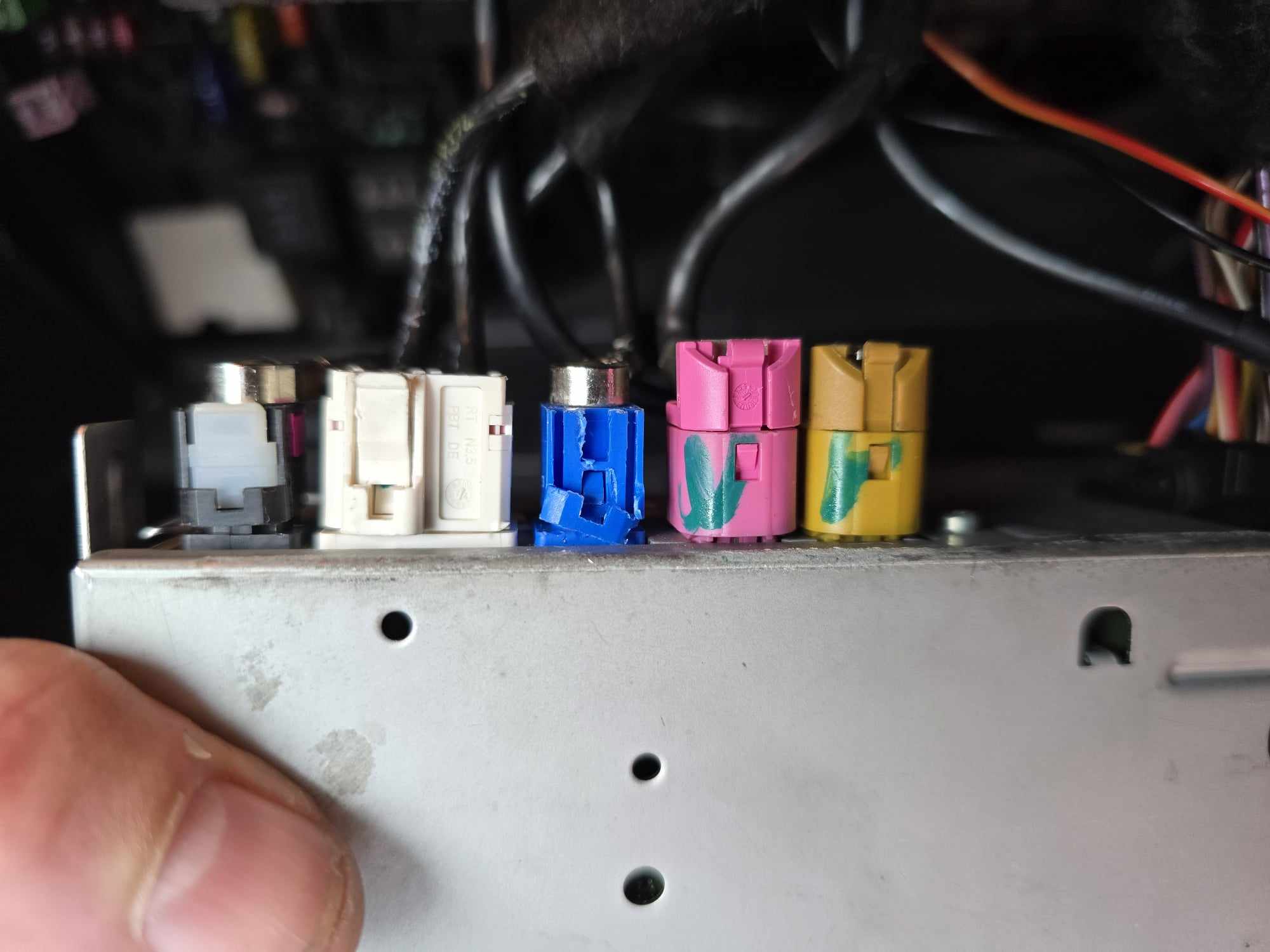

Hi All, I've got the above glovebox unit after swapping to a MIB2 unit, however the DAB reception has been getting on my nerves for some time, so I have bought an aftermarket aerial and just need to confirm which are the connections for DAB, FM and GPS on the pic below please? I've searched and searched, but can't find anything listed

I fitted it on the weekend, but haven't been anywhere in the car yet. I've got to go where the signal dropped out for ages on Friday, so will let you know if it's better afterwards
