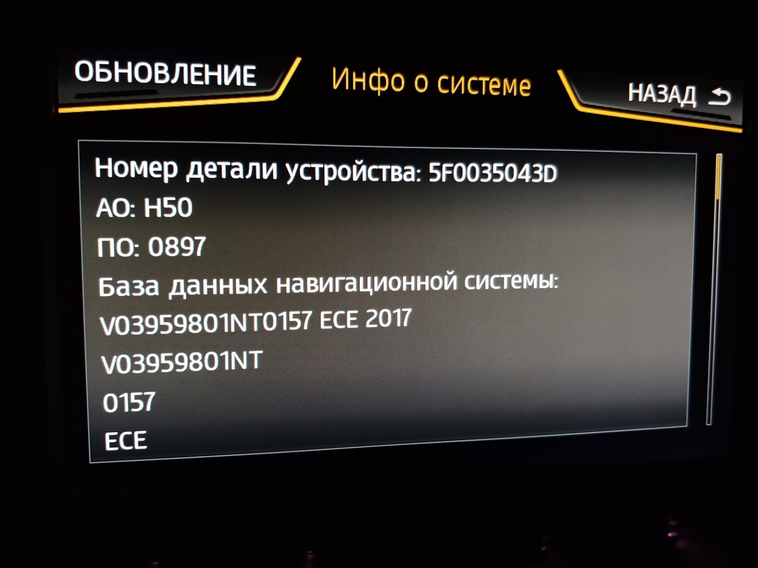

Hello!
After Map updating, I've got "b126c f2 009 - navigation database not enabled" error. Navigation works but after 1-2 minutes get pop-up window "Navigation data in Infotainment system is not valid. Check data". I have no MapCare.

That's a mib2 high. Without Mapcare you can't update that fully. You can get it converted to a retrofit dependent on finding somewhere to do it or may be able to buy Mapcare if it's supported in your country.
Presume you used the developers menu to get to the point you did. You need to revert back to the maps it came with or before to get the error to go away.

Thanks, bro!
I've downloaded my original map version and will try to install it back tomorrow.
Will inform You abt result!
So, after installing version which was installed by default - Navi starts work!
Another question, how to update maps in my situation?
You can explore the part number with your Seat dealer to see whether they can update the maps. Failing that you could look at retrofitters in your country. Mine took about 2.5 hours to update the firmware with modded retrofit firmware. You then update it via the same backend menu and it will work. There are risks attached of how good the retrofitters are. Mine was done on a service station forecourt on a meet after trecking 400 miles for it.
If you search locally for mib2 high retrofitters that are being sold they are most likely to be the people that can do it. In the UK there seems to be only one outfit whilst there are enterprises that fit the units once they have been made into retrofit.
The cleaner way is to get Mapcare enabled in the software if possible / one off map update but if that's not possible then the retrofit route. I'm thinking the part number now was just a one off for the latest map rather than Mapcare.
I followed after Walone on the Leon navigation thread who got his unit converted into a retrofit after I threw in the towel on DIY solutions. It's been long dug over on the Mib2 High and Mib1 High. The Mib2 High uses the same map download as the Mib1 High so the unit is fairly well understood by retrofitters that adapt the firmware to turn them into retrofit units.
You have to contact all these outfits till you find one that can do the job and you trust. The East basically which is where you are, are experts at retrofitting so you might not need to look too far. They need access to ODIS for part of the work so if they don't have that then you can rule them out. One told me that. ODIS was used on mine.

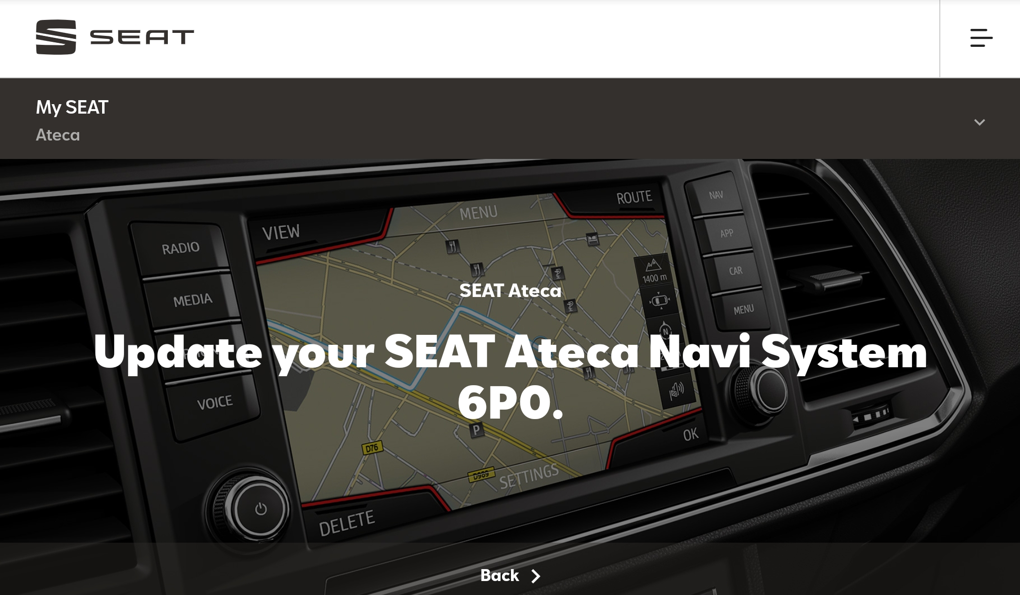

Did you try the speed camera thread. I'm looking for people who have had success with the Ateca standard wifi units. Since I seem to have become the Poinspector documenter via the developers link trying to clear up whether there is an issue or not with the recent Seat standard units or operator error. I can't check. Once set up Poinspector works really well.
https://www.seat.com/owners/my-seat/navigation/ateca.html Tell this is the site l downloaded version 1115 2019/20 which is now operational on my 6PO sat nav. But, included in the instructions is the warning that the maps can only be download if you have Map Care and if not you will need to buy another card from Seat. I haven't got map care but it still updated my existing card. Can you account for this because I can't.
